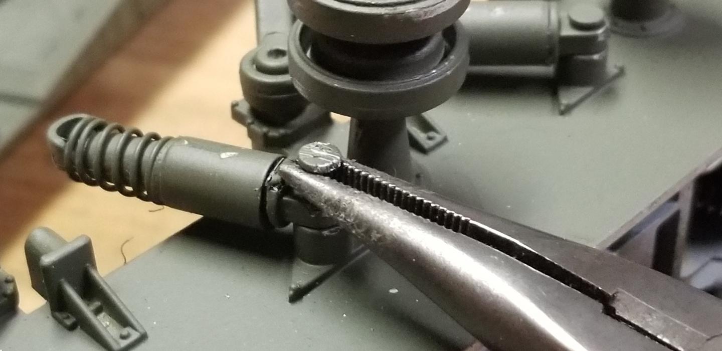

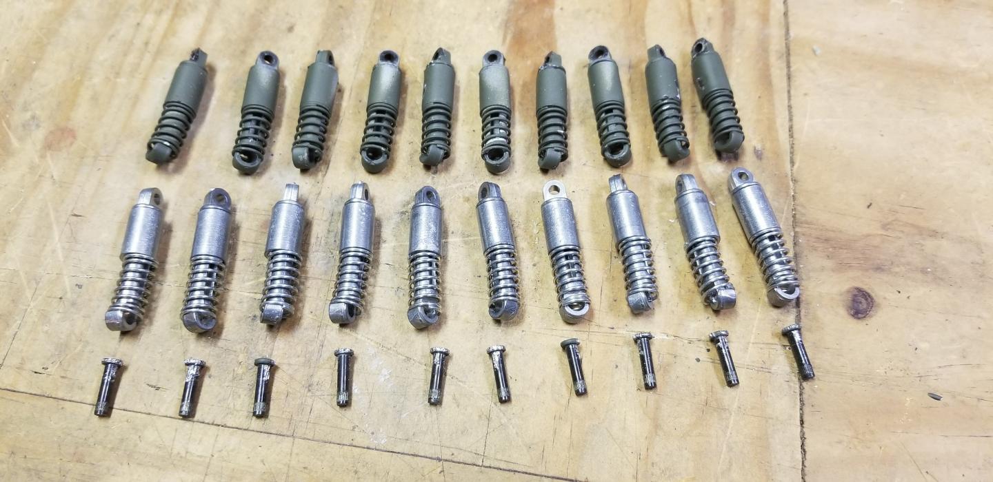

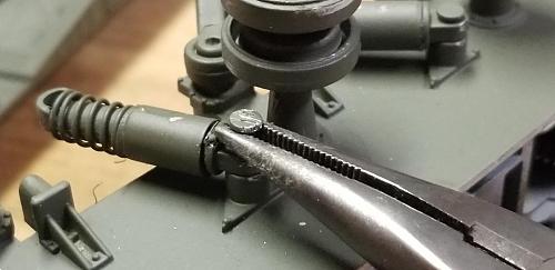

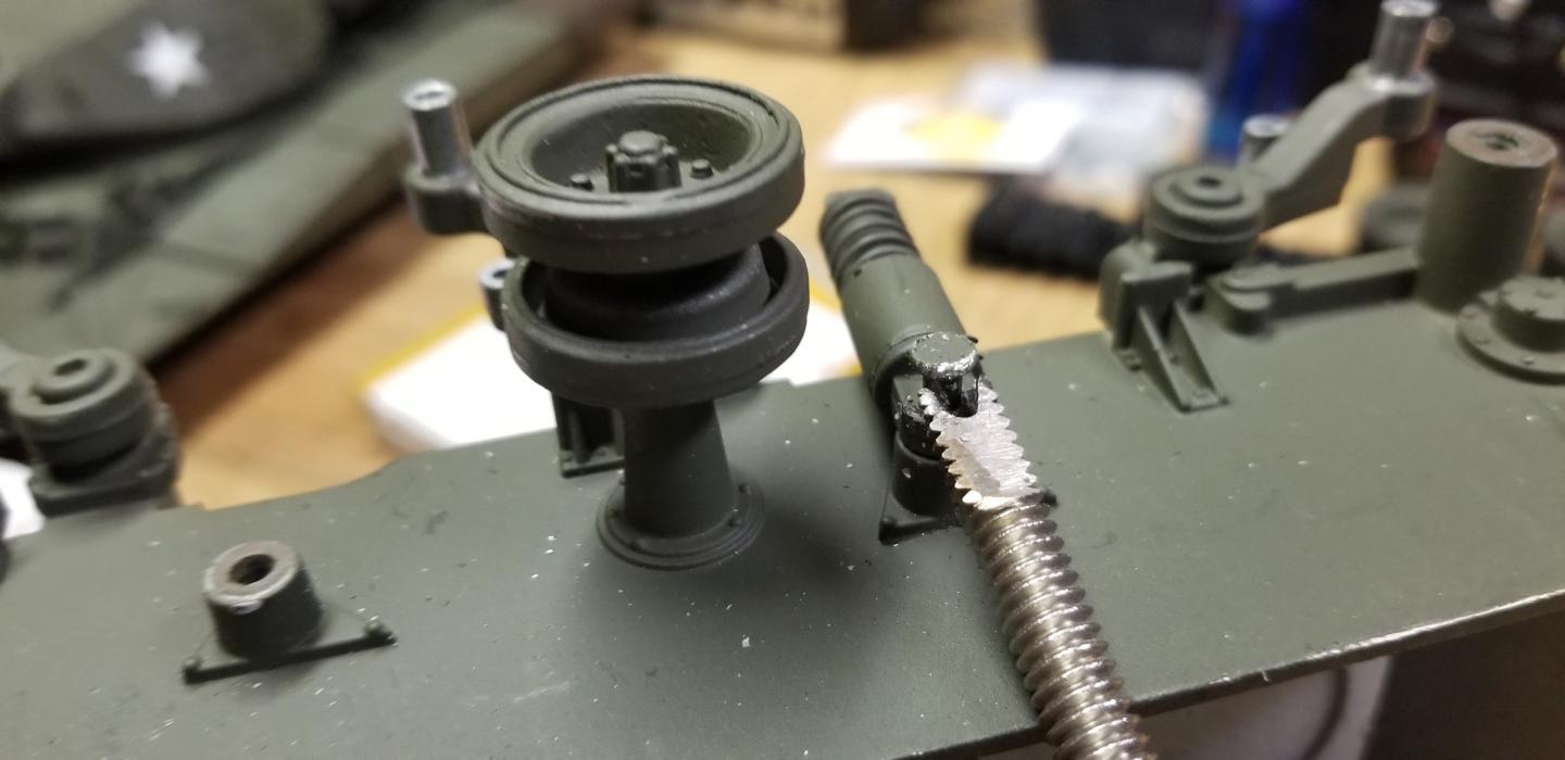

    Thought I would show an easy method for swapping metal shocks for the plastic ones on a Henglong Walker...
    After removing the idler & tracks, I take a set of needle nose pliers and twist the upper shock mount which is pressed fit into place. The Pin has splines which grips the boss in the hull:

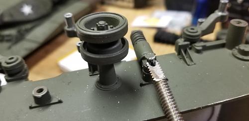

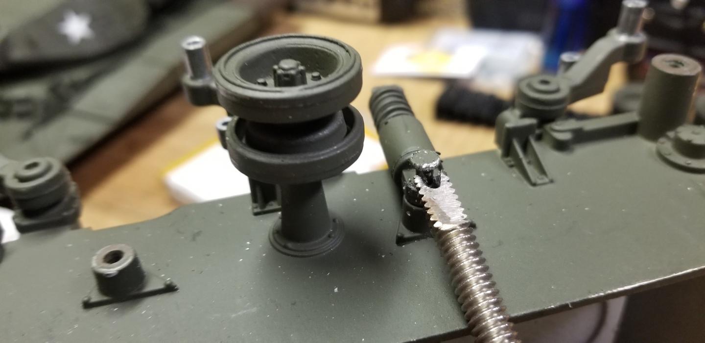

    By twisting the pin, it free's it up, and allows it to come out just a tad. Trying to grab and pull it at this point gets nerve racking, as its pretty soft metal, not to mention the hull is plastic. I made a wedge/fork tool out of a bolt, which gets under the tiny gap created by the needle nose pliers. If you have ever removed a ball joint on a car, you know where this idea came from.

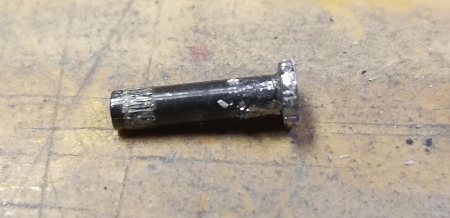

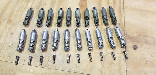

    After its out a good way, then take the needle nose pliers and finish the job...

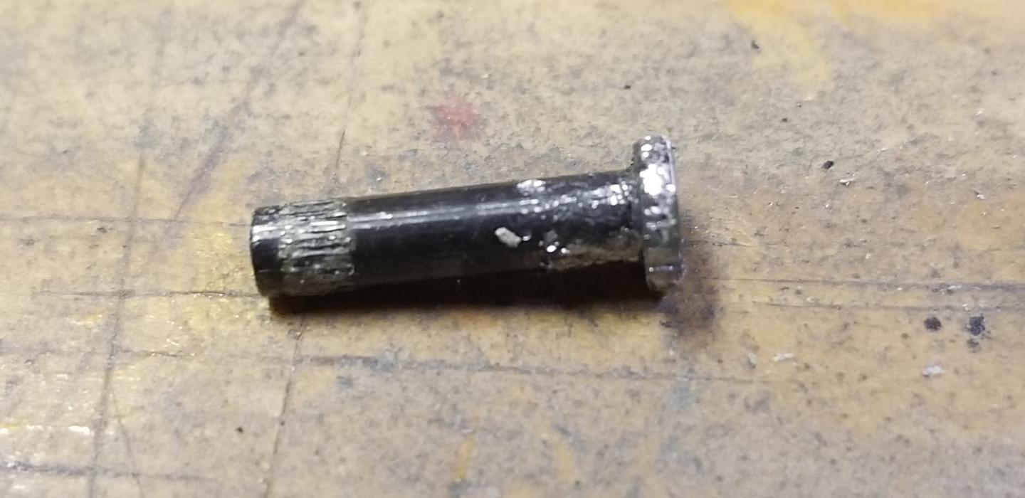

    The head of the pins get chewed up just a little...cant be helped...need the grip of the teeth to free them up.
    This is easily remedied by chucking up the pins in a drill, and hitting them lightly with some emery cloth...after which everything gets painted anyway.

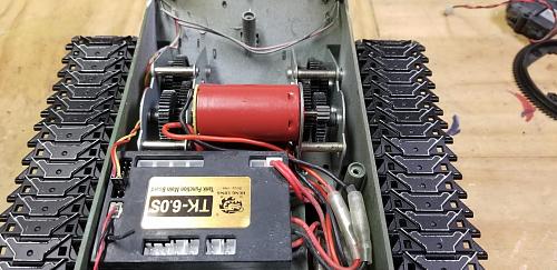

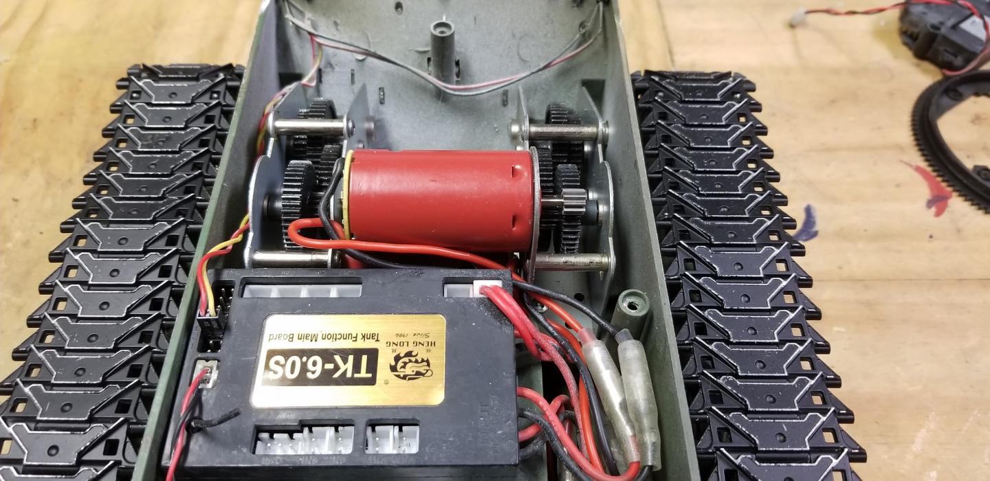

        The Bulldog got 2 new "Red" motors courtesy of Motion RC...good to go:

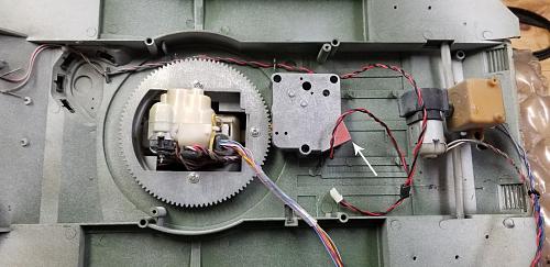

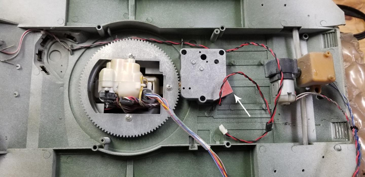

        Attempted to install Metal Turret motor & ring. FYI: If you put Red motors in, they are longer than stock (Duh). The metal after market turret motor comes with an extra Wedge as part of the casting. Why, I dont know. The extra wedge on the side of the motor interferes with the motor not allowing the lid (top hull) to close. I suppose if you were to only run a red motor on the bottom, and the stock shorter motor up top, you would be good to go....but would be stupid of course.
        I can't win for lose...So it will run a metal ring and a plastic motor for now...Once again, stupid.

            That is a very different metal turret motor gearbox setup then has been solid prior. There should not be any interference issues with the motor and metal turret gearbox. Unless it is the high torque one and not the high speed one?

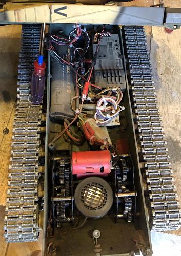

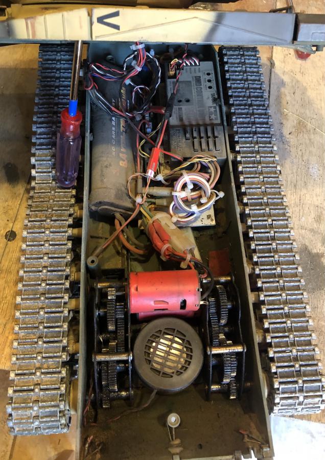

            Gotta say I almost forgot what a clean inside looked liked. Here is one of mine form the other day when I had it open replacing an axle shaft. Two year worth of dust.

                Jesus my friend, how do you sleep at night? My OCD would have me tossing & turning !!!
                Not sure about the type of Motor. Looking at the plastic vs metal, that wedge protrusion (which houses the actual motor) is a dealbreaker in the Walker. Kinda FUBAR if you ask me.

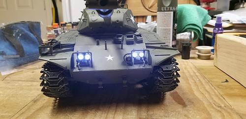

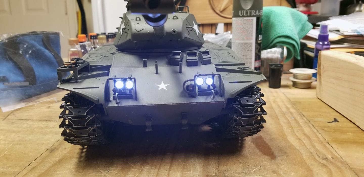

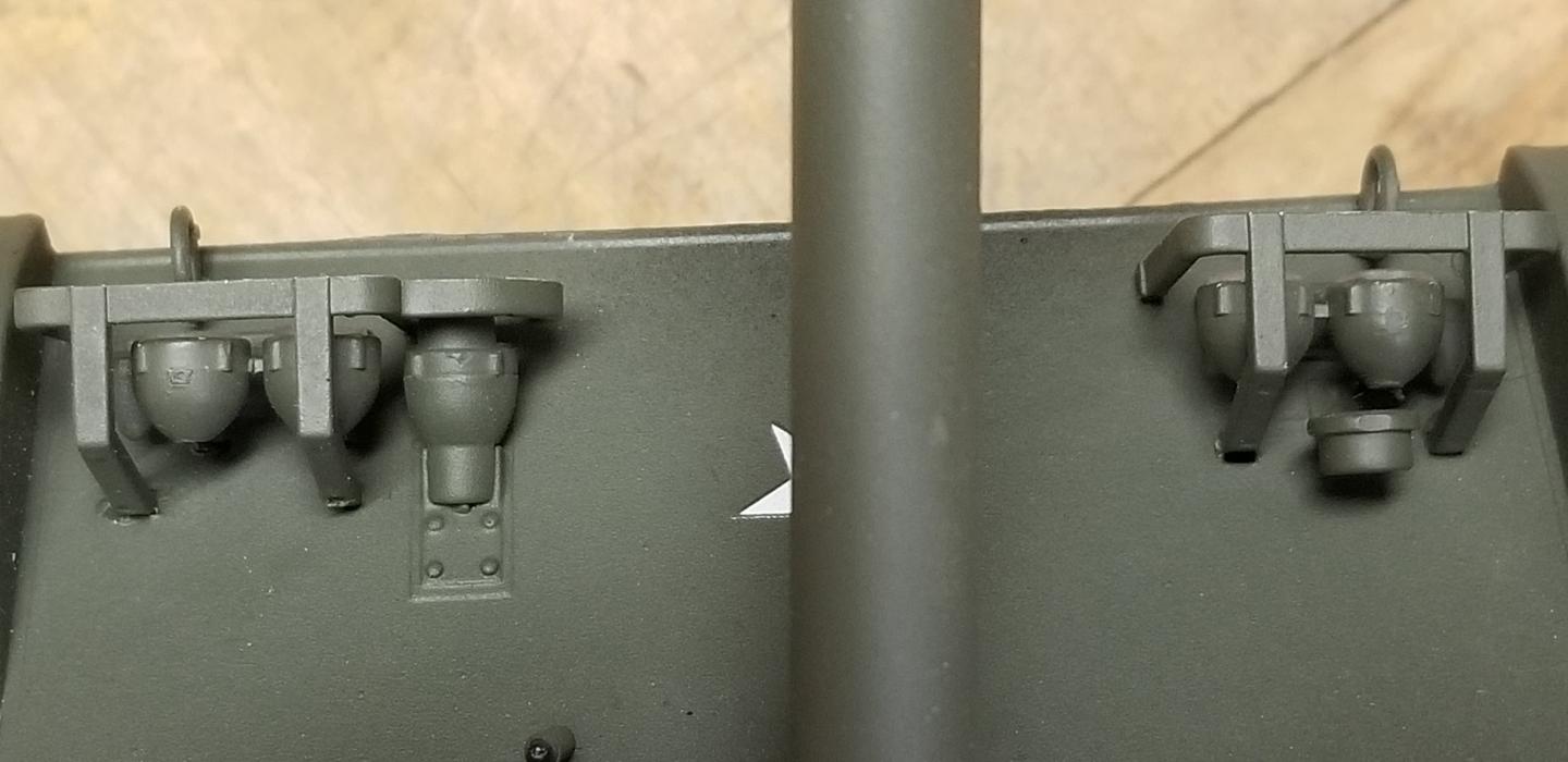

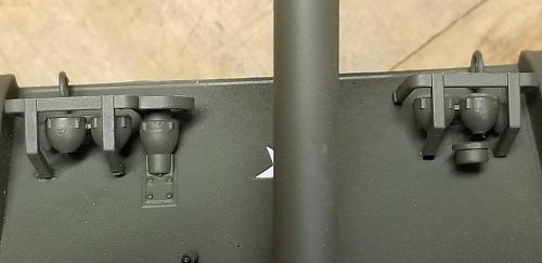

                          Headlights installed. Purist will argue that the inner beams should be dark due to infrared use, but I have seen a few real Bulldogs with dual beams...so I went with that..
