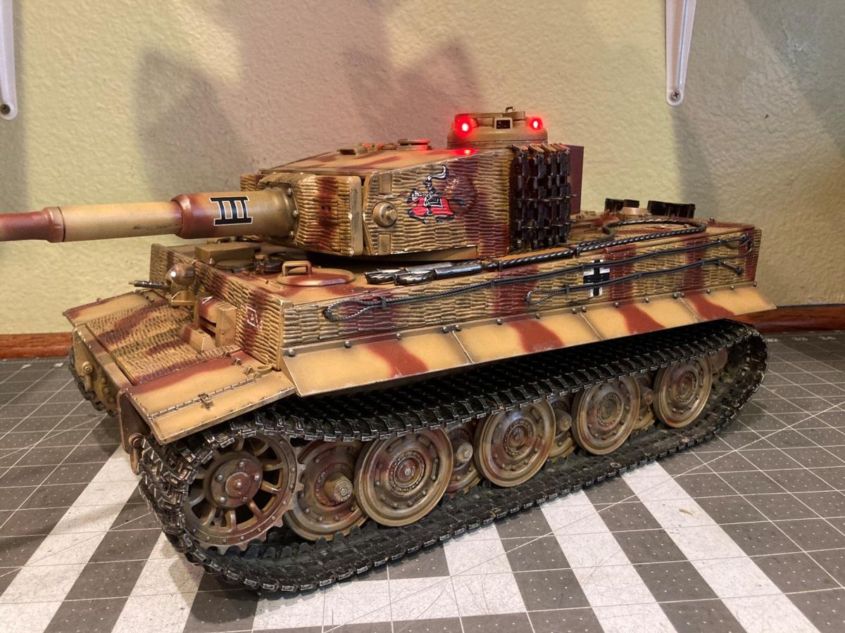

                  I got the Mako board and the IR Tiger-ring from a good buddy. It took me quite some times to figure things out. I finally have a Toro/Taigen IR tank to battle without the bulky IR receiver on top.
                  And I control it with me hobby grade Spektrum DX9 too :-) No MG though :-(

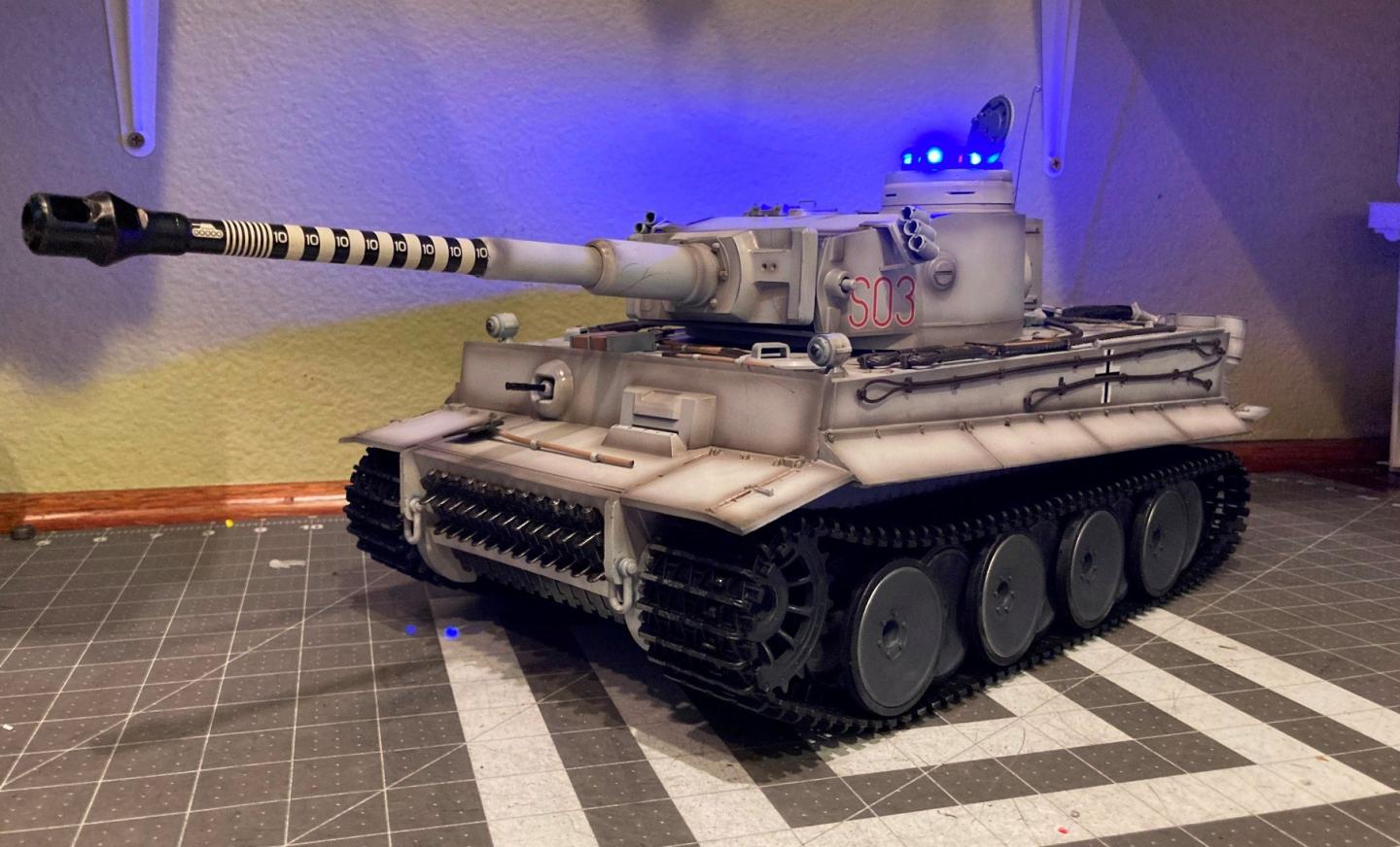

                    Another Tiger I was successfully set up for IR battle today. I installed the Clark TK80 into this HL Tiger I. It ran well. Then I got the LegoDEI IR receiver to set it on top of the cupola. I used the same HL IR bulb that was inside the hull of the tank. I just changed the other end to the correct sized pin to fit it with the port on the board. It worked. And I can also control this HL tank with my Spektrum DX9. As a heavy tank, it will absorb 9 hits. But the program in the board set it to delay the time for reload to almost 10 second :-(
                    Oh well.... anyway, no more HL black transmitter for this tank :-)
                    Now I know what to do with those extra HL IR bulbs that I have. I don't think I need to buy anymore IR bulbs in the future.

                      Happy to see you went ahead and used the HL bulb. It’s more then adequate for the LA “close in” battles. Like you said you have a bunch of them so now you can save the time and expense of buying others.
                      Also happy to see you installed the IR receiver much lower. Makes for a clearer more finished look.
