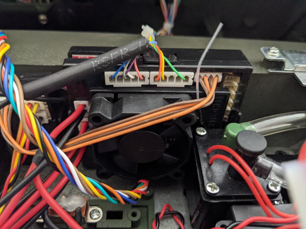

        Try shooting itself in a mirror. Check the 5 pin plug in the motherboard. sometimes they are loose in the socket or one of the tiny wires is broken.

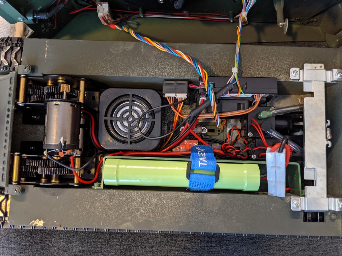

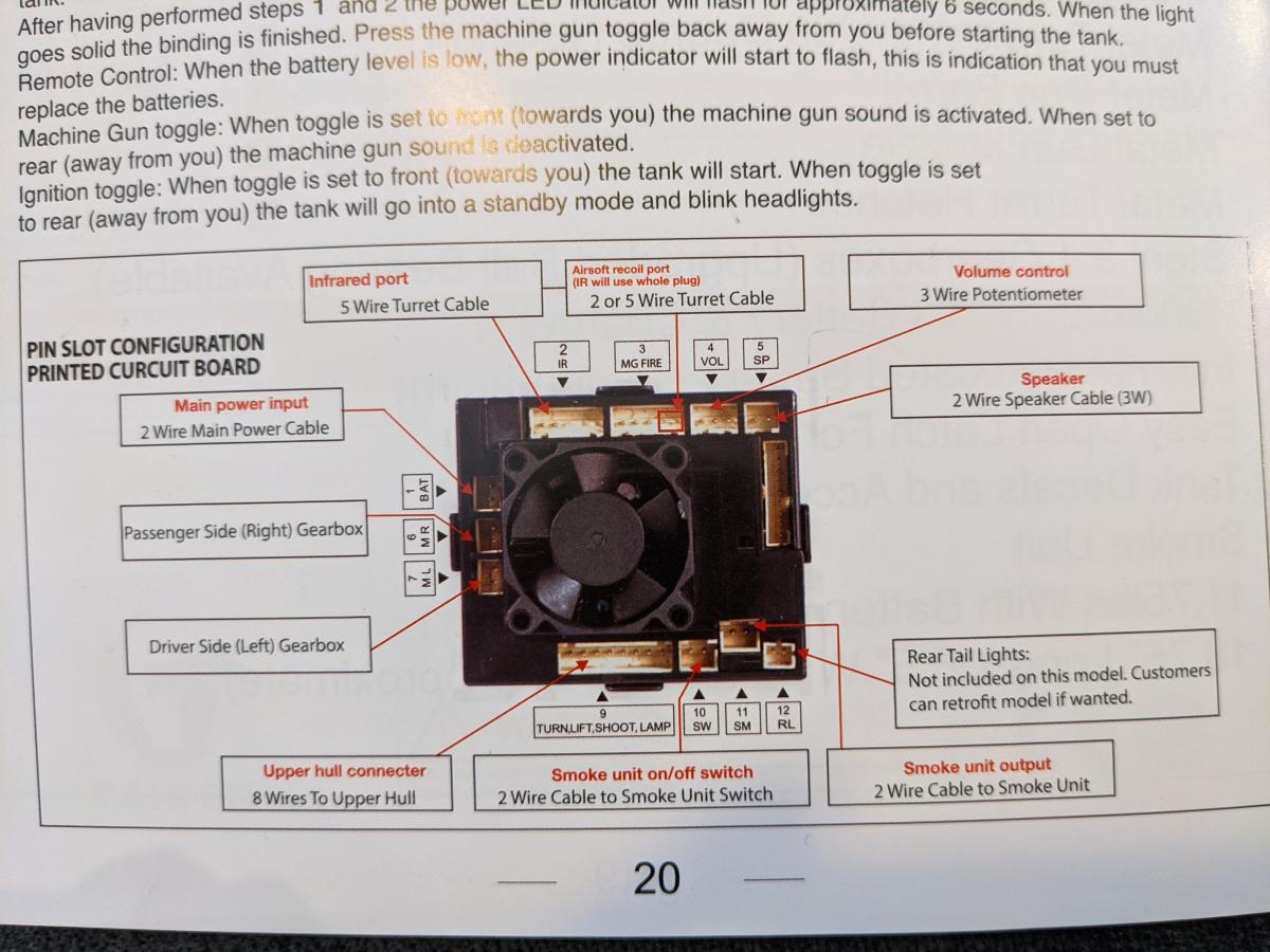

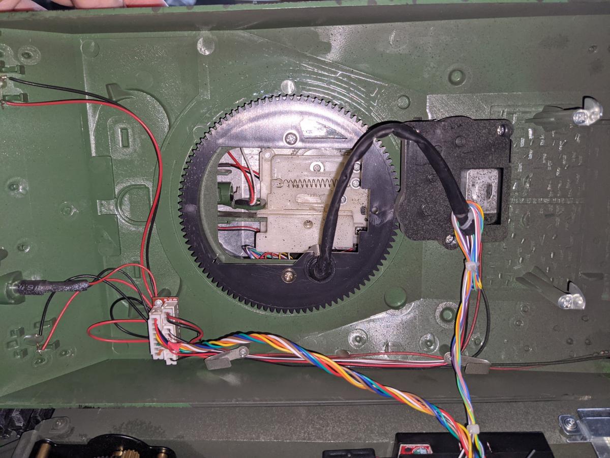

          When I first unpacked it, the turret wasn't making any sound effect when firing, doing the muzzle flash, or recoil at all. I took a look inside and noticed the "Infrared Port - 5 wire turret cable" was unplugged (see wiring diagram). I plugged it in and it fixed those issues but I still get can't the IR hits to register.
          Attached some pictures of the wiring, not sure if it helps. If someone else has the same model can you compare the wiring to my pictures and see if anything is off? I attached the wiring diagram also but it looks like it's slightly different in my model than in the diagram.

              What about the 5 pin harness in the tiger? You know the M4A3 is emitting and the Tiger is receiving. But you don't know if the Tiger is emitting or if the M4A3 is receiving. In your pics, the Sherman looks good, but you didn't post any pics of the Tiger. Did you try to fire either one at themselves in the mirror?
