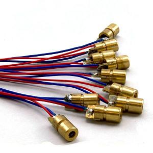

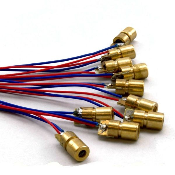

      There are small lasers which fit neatly into the back of the mantlet of the HL Tiger 1, shining through the hole beside the IR LED. They can be found on eBay (6mm 5V Red Laser Dot Diode Copper Head 650nm) for about £1 STG and elswhere. It's as well to order a few, as the focus can be a bit iffy, and you can choose the best one. The HL 6.0 and 6.1 MFUs do still have the 'Aiming light' (LED2 if I recall) output. The laser I fitted is now redundant as I binned the BB on my Tiger for recoil and smoke, but it still makes a nice red dot!

        Those can actually be focused. The front half is threaded and turns to adjust the focus. However, some batches seem to have been sprayed with clear lacquer and it seeps into the threads and keeps them from turning.

          So when does the laser light up, all the time or when the cannon button is depressed, or?
            Yes, exactly that.
            • #7
              Yup - the right hand top button on the 6.0+ HL controller switches it on when pressed and held down, so it's on when you press both buttons to fire.
