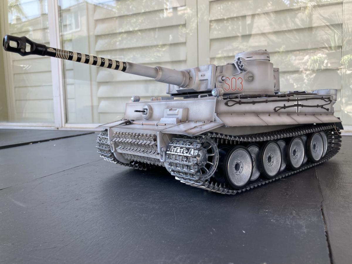

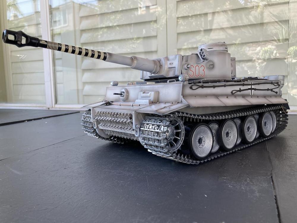

            Here is my Tiger I in winter scheme. If you find another better way, kindly share with me too.

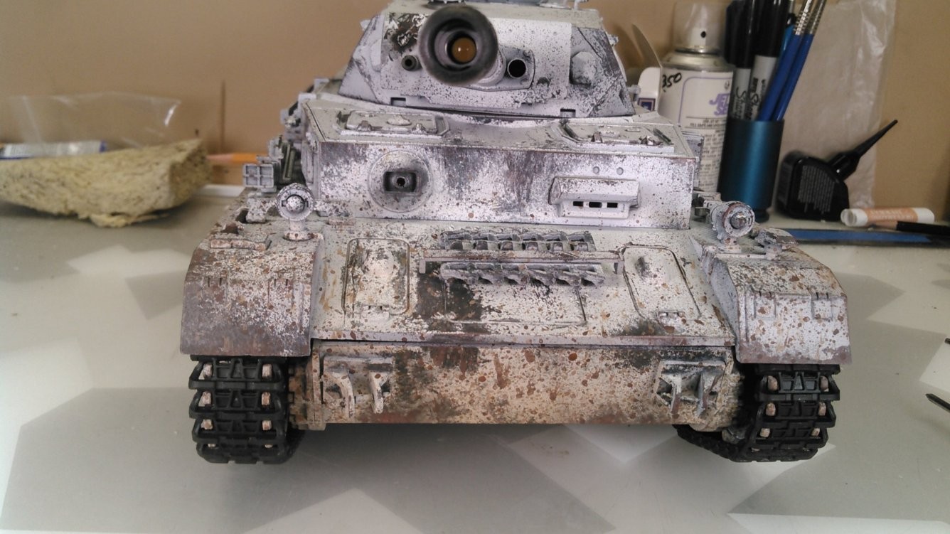

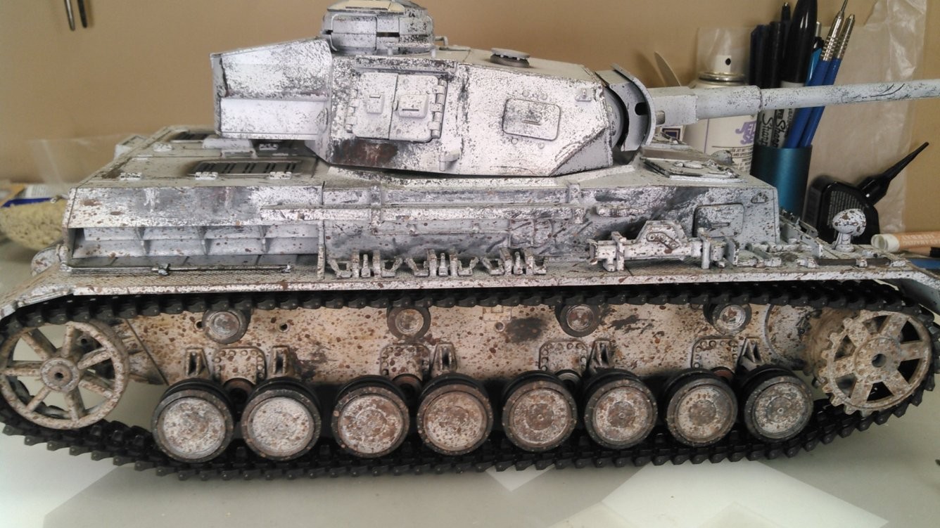

              I put down a base color in an enamel paint, for german, I use a red oxide, then spray it with hair spray one that dries. go over that with an acrylic panzer gray for example, then 10-30 minutes later, I use an atomizer sprayer with water in it to mist an area I want to work with to get it damp and strike at it with a stiff bristle toothbrush, the paint with flake off, the longer you let the acrylic sit the smaller the paint chips and flakes will be let that cure. I like to use a matte ename/laquer over that, light coats so as not to mess with the acrylics. hairspray again, and then using the winter scheme example do the same process over with your white. matte clearcoat over that, and then go through your other weathering processes, streaking, washes, pastels, pigment dusting etc.
              • Vaseline
                • 290
Name:	Travis PZ4 2.jpg
ID:	323563 this is an example of that technique, in addition to a splatter tip on an airbrush for spring mud. Click image for larger version  Name:	Travis PZ4.jpg Views:	0 Size:	209.5 KB ID:	323562
