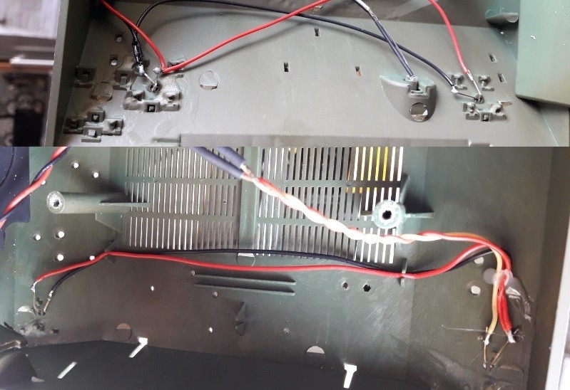

          There's no programming involved that I am aware of. It just does what it does. Maybe you have a wire crossed or touching? Heng Long is not the best at insulating wires or the long leads of the LEDS. Maybe the lead of the MG is touching the lead of the head light.
          As you can see in this HL Sherman, they like to leave them bare...

            Hi Thanks for your response however I have now removed the machine gun from the tank but left it plugged into the 6.0MFU and the same thing occurs, I will try the machine gun without the headlight plug in the LED4 connection and see if that makes a difference, but i'm thinking my 6.0 MFU must be faulty
