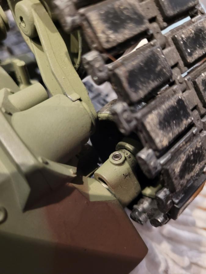

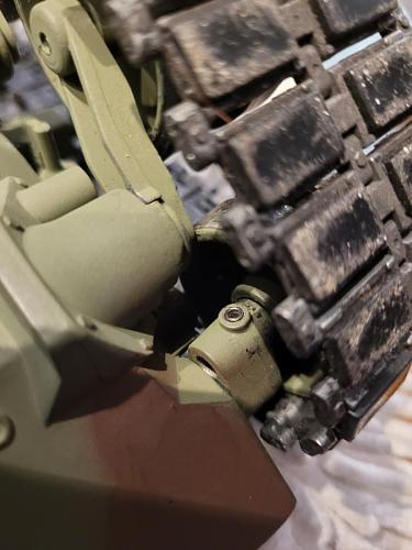

ID:	326778 Or remove the idler from underneath the axel (allen set screw), wiggle the idler out with the front of track. Done.
