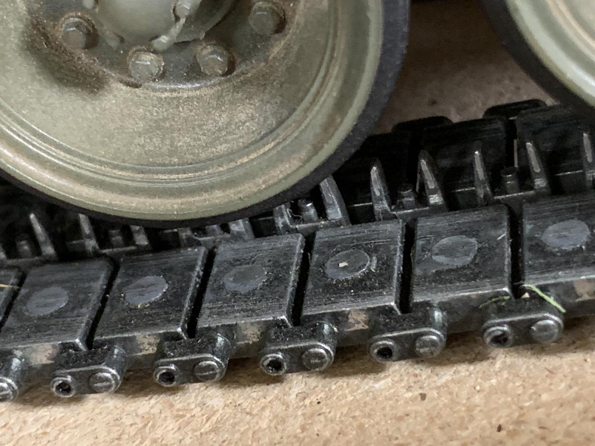

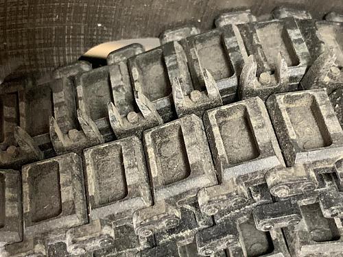

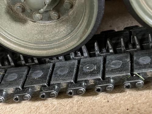

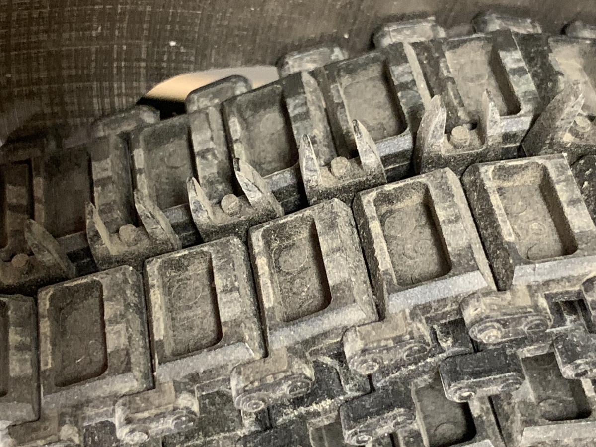

                    I bought the HL M26 metal tracks. They're heavy but are simply molded like the plastic tracks; each link is hollow. While driving through dirt, they would pick up small rocks and jam the sprocket or the idler. I reached out to Erik at Taigen Tanks. He sourced a set of Taigen M26 tracks for me. They are molded with solid links. So they no longer have the "shovel-conveyor effect". They are pretty great. The first pic is the plastic HL M26 track (same mold as the metal, I just didn't want to dig them out of storage); the second pic is the Metal Taigen M26 track.
                    Click image for larger version  Name:	IMG_5782.jpg Views:	0 Size:	206.0 KB ID:	327591Click image for larger version  Name:	IMG_5783.JPG Views:	0 Size:	156.6 KB ID:	327592
                      Thank you for the very helpful and valuable information. The Taigen track looks like the quality one that I am looking for. I will contact Erik in a few weeks to see if he can get me the M26 track.
                      My new order T34-85 tank and upgrade parts will start arriving tomorrow. It will keep me busy for a few weeks until I am done testing.
