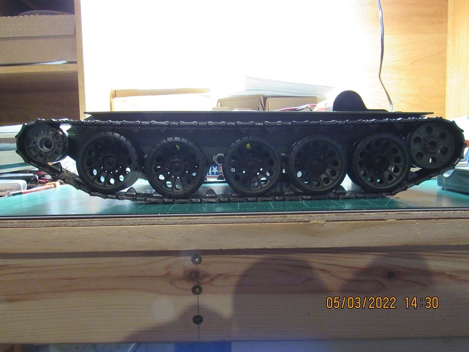

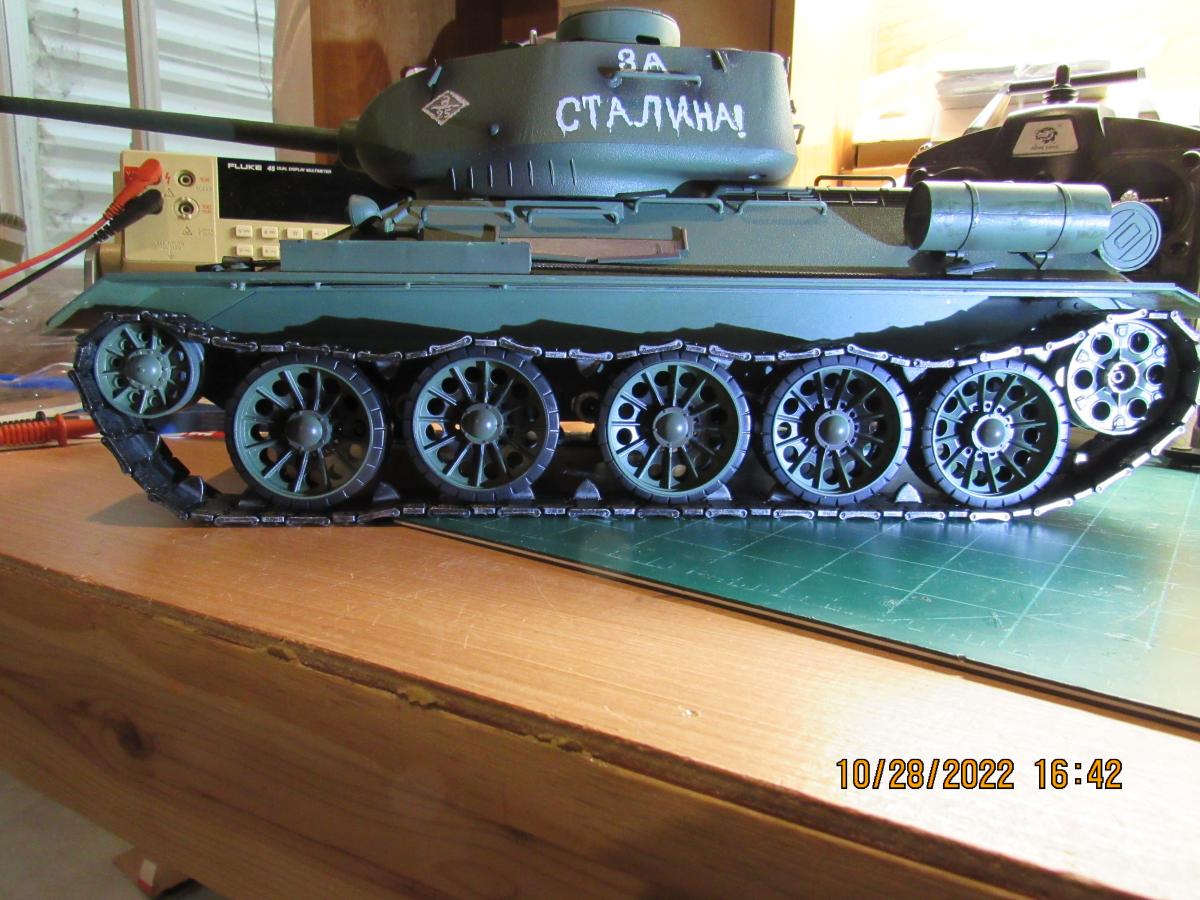

    ​My T-34/85 metal upgrade: Metal tracks
    The T-34/85 is my second recent HL tank purchase. I got the plastic version after disappointment with the Professional version quality of the German Leopard 2A6.
    When I looked at the HL T34 plastic track closely, I found that it is not a single pin design, but a much worse open pin loop. The HL metal and Mato metal track are the same unrealistic open pin. It is unstable and traps dirt easily. The 4 spare links on the front of the T34 is even more an eye sore and I replaced them with realistic looking closed pin links too.
    Click image for larger version  Name:	pins_quality.jpg Views:	0 Size:	63.0 KB ID:	361022 Click image for larger version  Name:	IMG_5103.jpg Views:	0 Size:	112.0 KB ID:	361023Click image for larger version  Name:	IMG_5104.jpg Views:	0 Size:	120.0 KB ID:	361024
    I decided on the Toro tracks sold at the Taigen Tank store. When I installed the Toro tracks, another problem showed up. They are too tight, making the track an U-loop. I found that the Toro track is 2 m.m. shorter than the plastic HL track. The Toro and HL track both have 68 pieces of links on each track. Since the real T34 has 70 links per track, the first thought was to add the 2 missing pieces. Well it did not work, way too long.
    Click image for larger version  Name:	IMG_5098.jpg Views:	0 Size:	149.7 KB ID:	361025Click image for larger version  Name:	IMG_5099.jpg Views:	0 Size:	164.7 KB ID:	361026Click image for larger version  Name:	IMG_5110.jpg Views:	0 Size:	151.8 KB ID:	361027
    Back to the 68 link tracks. I noticed that the T34 HL is very light weight compared to the Pershing and German Leopard. A good operating weight for the HL T34 is about 7-9 pound. The Heng Xin steel gearbox gave the front the right weight distribution. I added 2 pounds of lead weight to the rear and it seems to work correctly. I have a level looking track and a smooth moving tank.
    Click image for larger version  Name:	IMG_5095.jpg Views:	0 Size:	176.7 KB ID:	361029
    Click image for larger version  Name:	IMG_5105.jpg Views:	0 Size:	84.0 KB ID:	361028
    The next post will be on the Heng Xin steel, all bearing, almost fully enclosed gearbox.​

          The worse thing on mine are the decals.

                  #28
                  keilau Couldn't you have reduced the tension from the idler when using the 68 links?

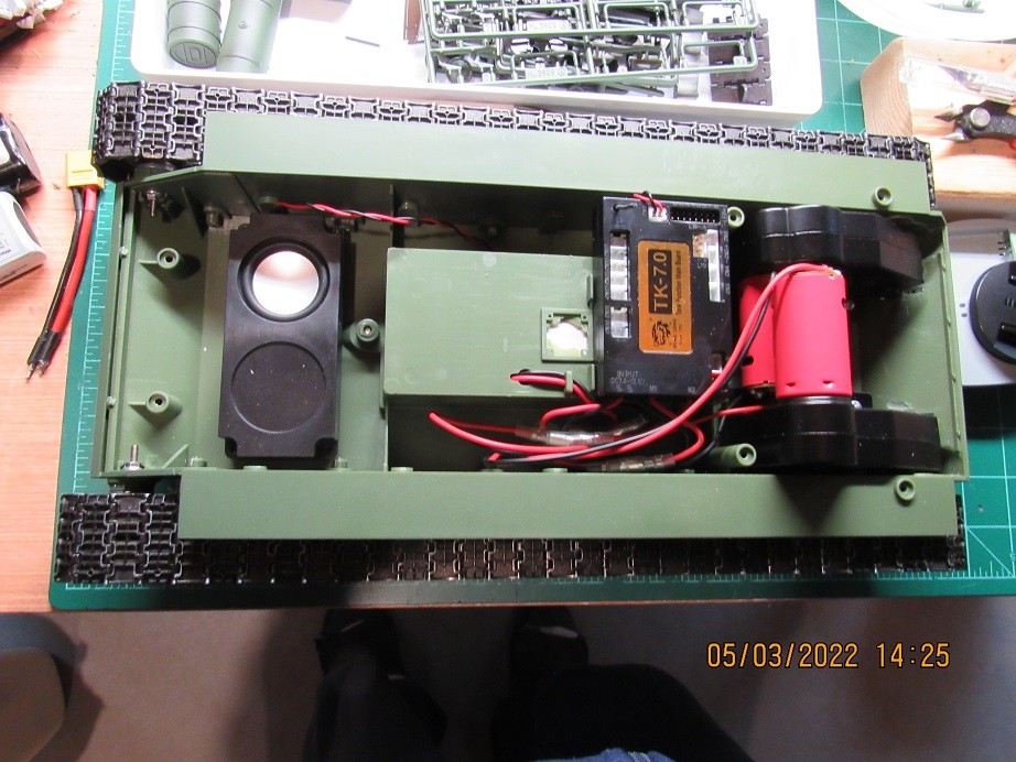

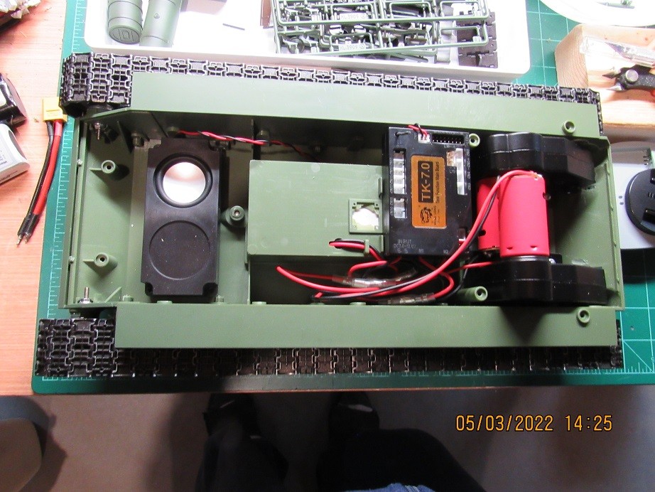

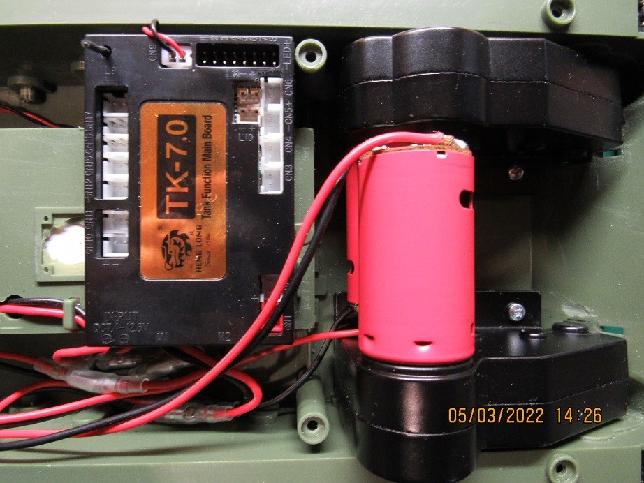

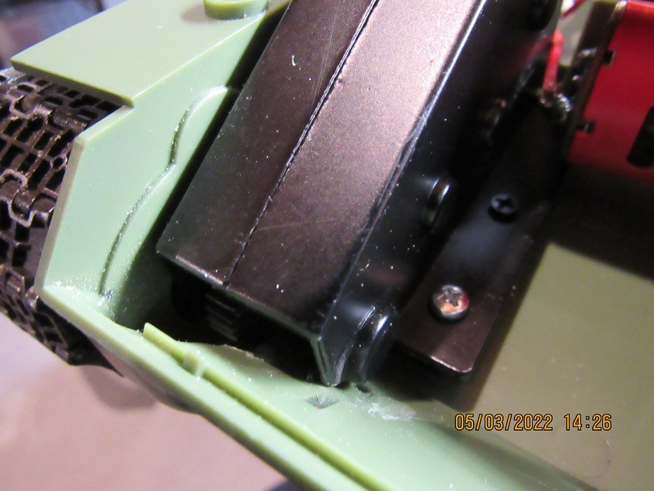

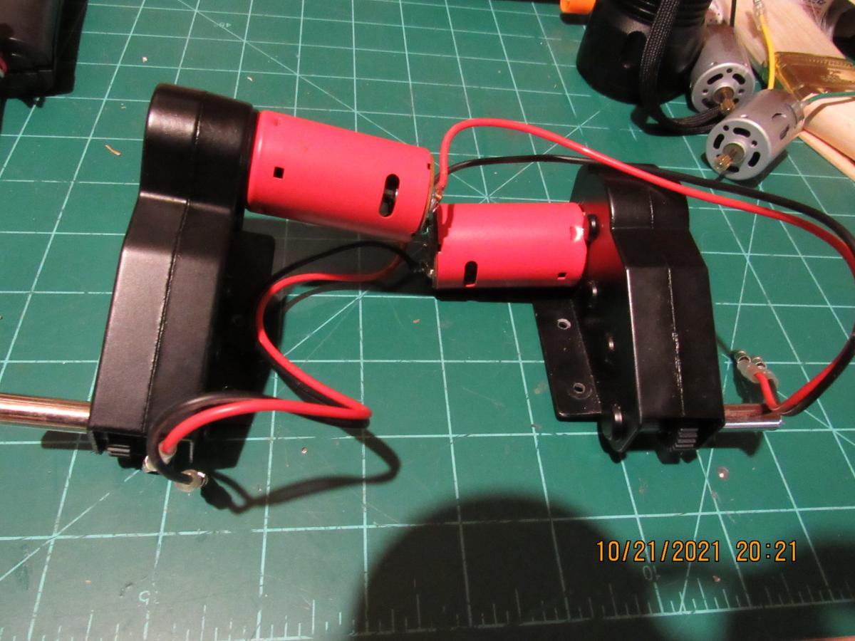

                      My T-34/85 metal upgrade: Steel/bearing gearbox
                      I have the Heng Xin gearbox on 4 Heng Long tanks, Leopard 2A6, Pershing, T-34/85 and Sherman M4A3. The Heng Xin gearbox appears to be well made. It is strong, quiet with tight tolerance. It uses a thick aluminum mounting plate which turn out to be a double edge sword. The plate strengthen the tank body to reduce flexibility and noise. But it makes the gearbox mounting a 2 dimensional (up and down, left and right simultaneously) motion. The tight internal space of the HL tank chassis can make this challenging and even frustrating.
ID:	361067Click image for larger version
ID:	361068Click image for larger version
                      The Toucan technical service person assured me that the T34 had sufficient room for the 390 red motor and he was right. But he did not tell me that the Heng Xin case interferes with the tank chassis front panel making it impossible for the gear axel to pass through the motor hole on the side chassis. I have to grid off a lower corner of inside case panel. But the gear axel still cannot pass through the motor hole until I also sanded off significant material from the gear wall of front tank panel. I sanded through one side of the tank panel and had to do some plastic repair. The plastic repair is not difficult, but is a delicate process that I would not recommend to inexperienced plastic modeler.
                      When mounted properly, the Heng Xin gearbox work as well as on the bigger tank. The 390 motor gives it very good scale speed for the T34. Is it as good as the Taigen/Torro lower metal chassis. Probably not, but at 1/3 the cost, I see nothing to complain about this metal upgrade. I will post some picture of the finished tank next time.

                        #31
                        The idler wheel on the stock HL is not adjustable. I consider purchasing the Mato tensioner, but did not do it. The T34 runs well now, but the look of the track is not ideal. Comparing to the real tank, my track is still too tense even with the added weight.

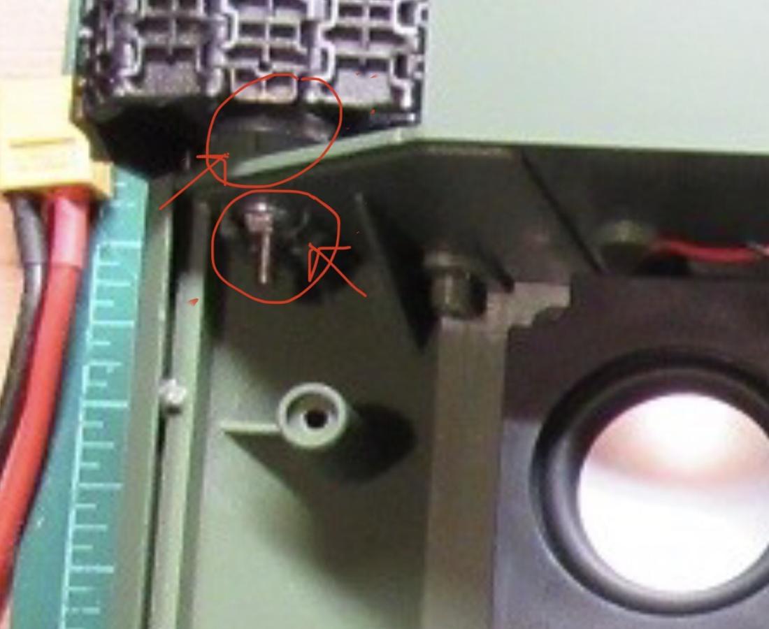

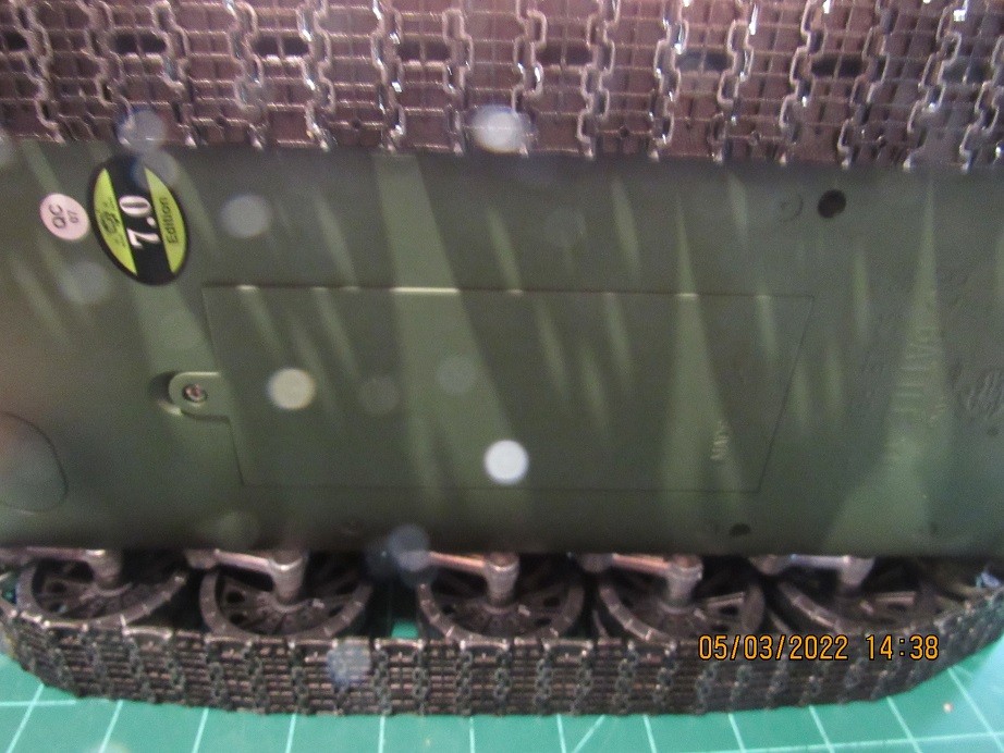

                          #32

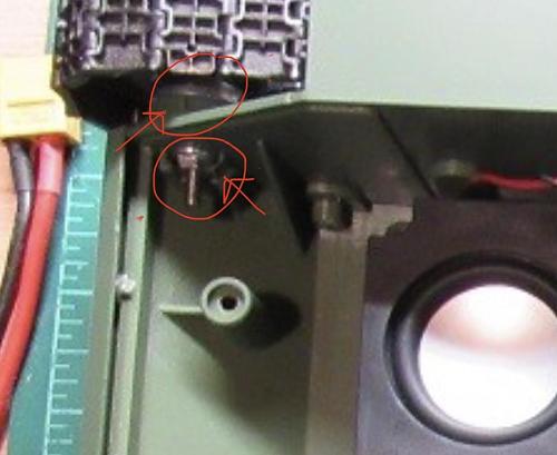

                          The idler wheel on the newer 6.0 and 7.0 T34s IS adjustable. I can see that yours has the feature from the photo you posted. You have to remove the idler wheel to access it.
                          Idler adjuster components circled in red.
                          • keilau
                            • Mar 2021
                            • 1815
                            • Windy City
                            #33
                            Click image for larger version  Name:	4DCAE7B6-F4F6-4E9C-87EC-EA4786A39058.jpg Views:	0 Size:	69.5 KB ID:	361074
                            You are right. I will have to take the T34 apart and try again. The question is whether an 70 links track is possible? Or I will have to stay with 68 links. I will test it out.

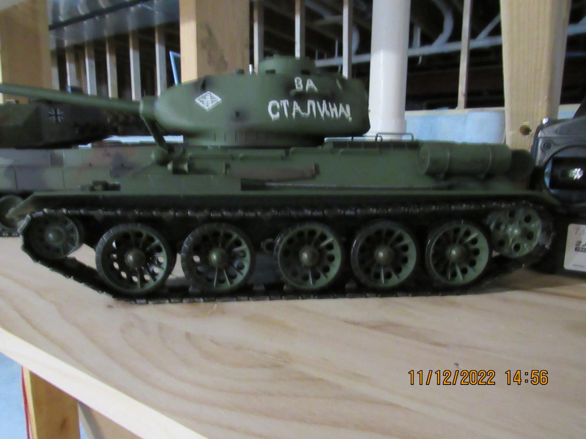

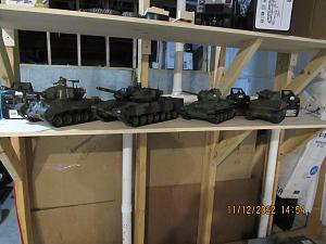

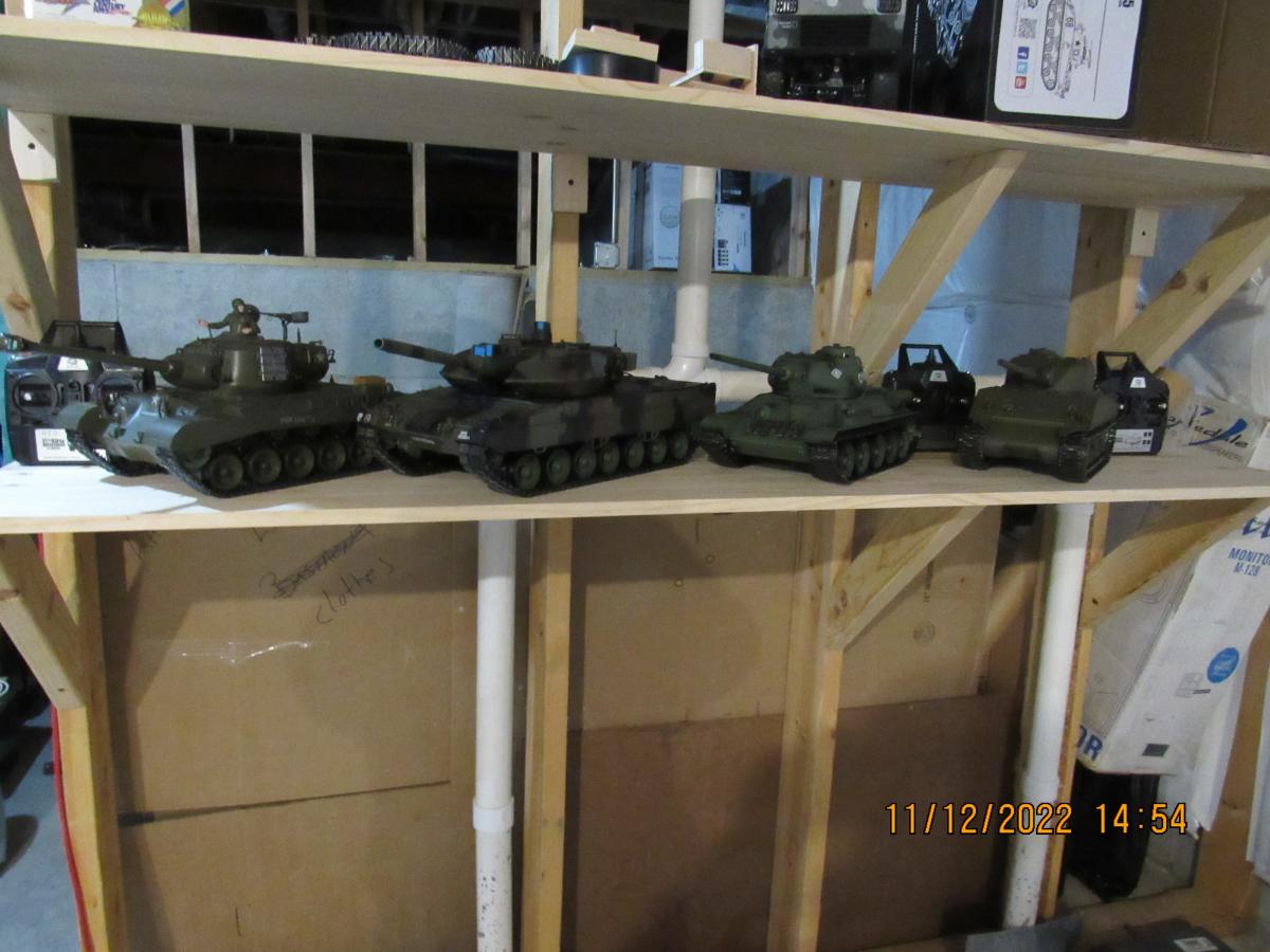

                                  #36

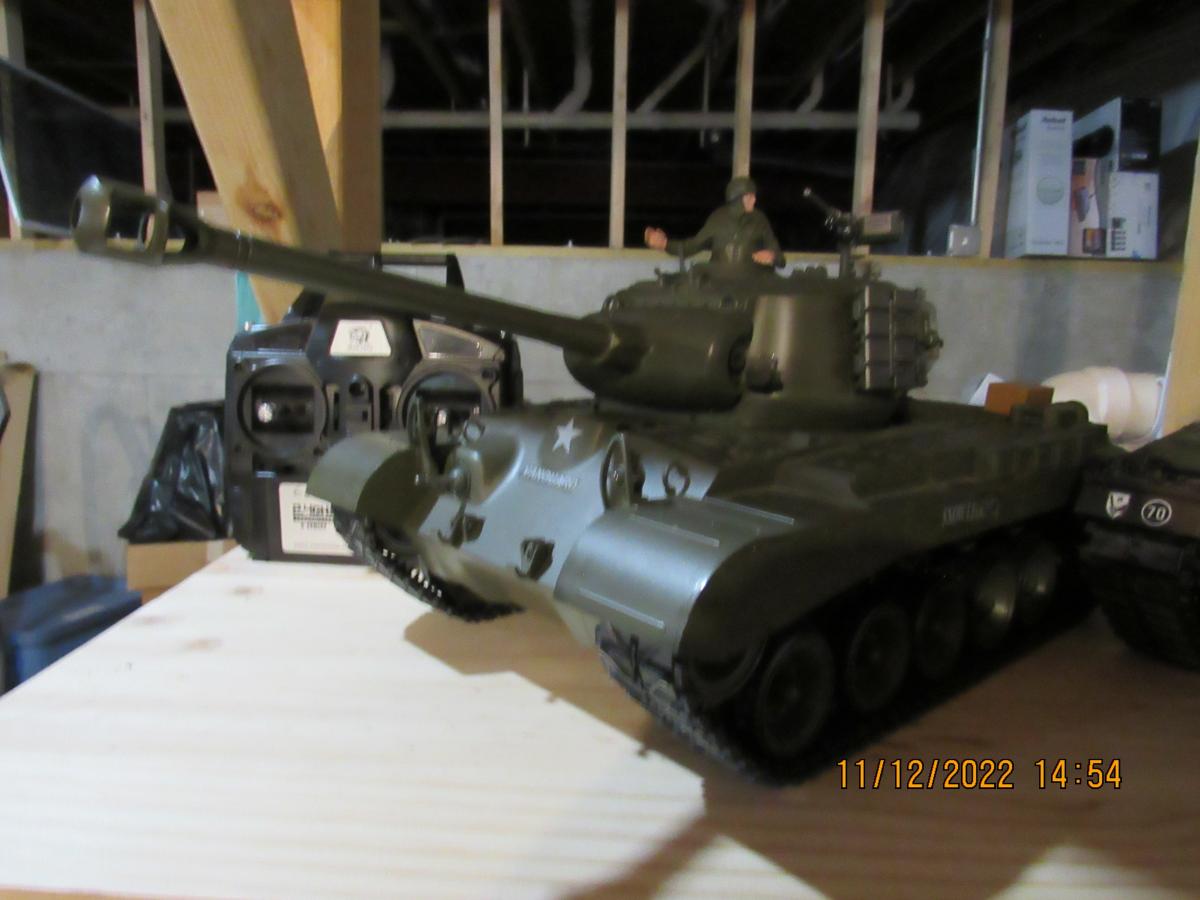

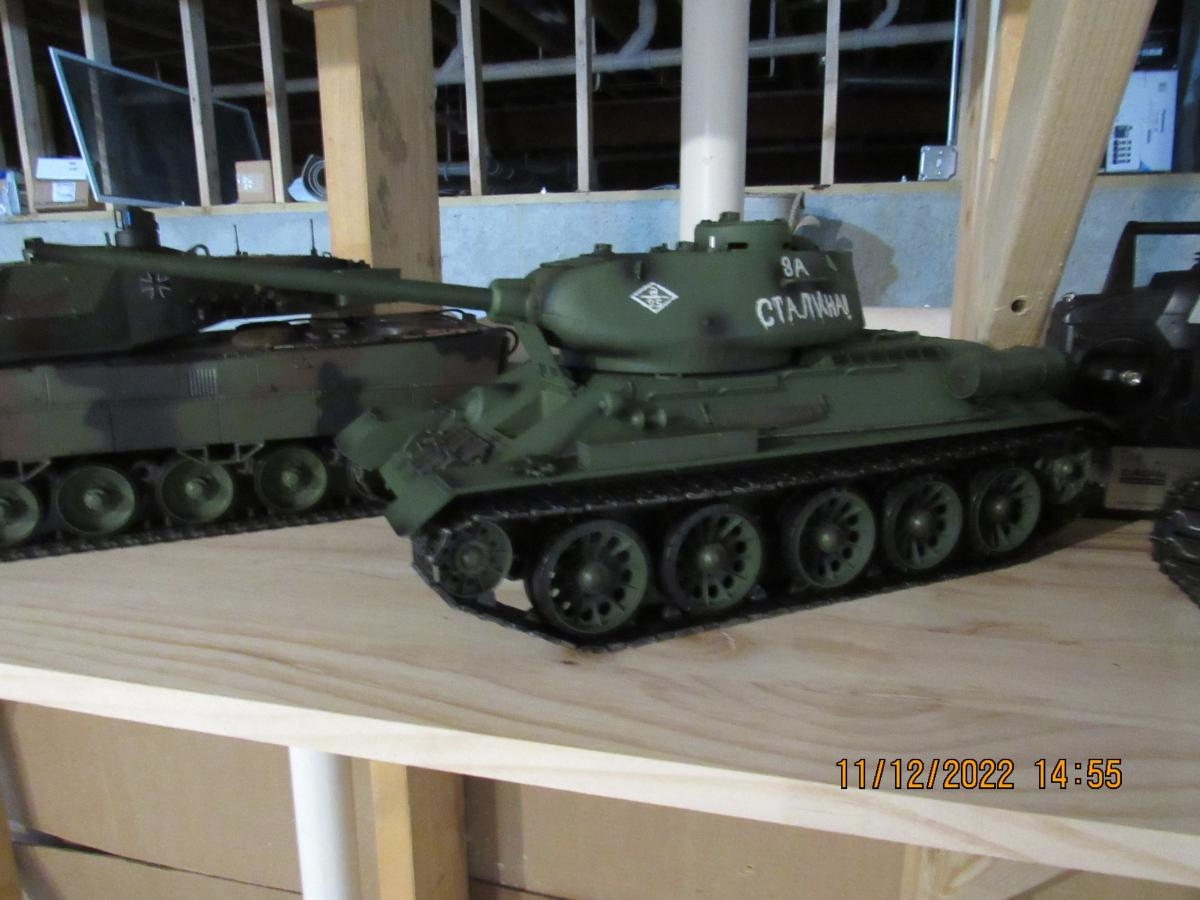

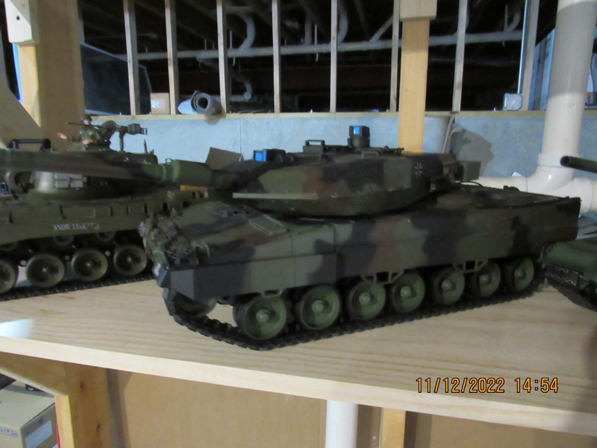

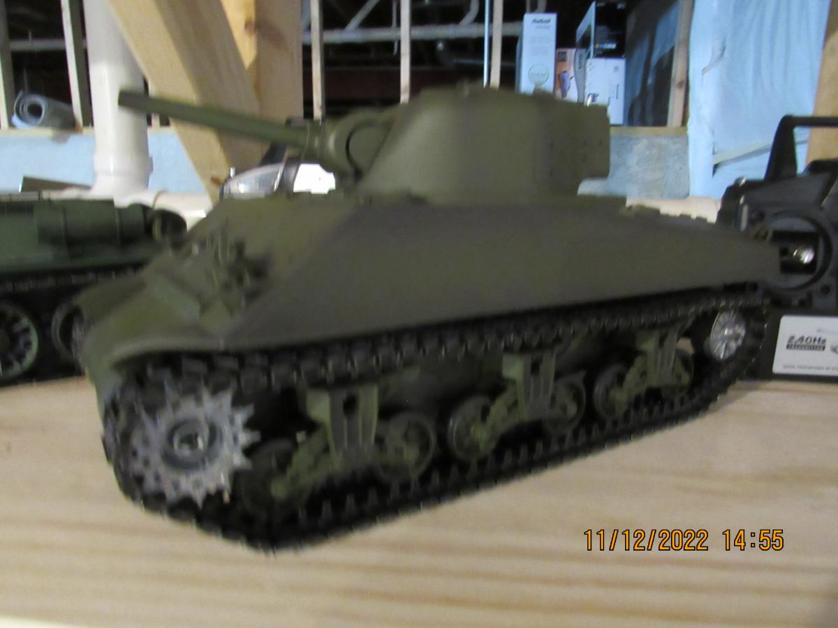

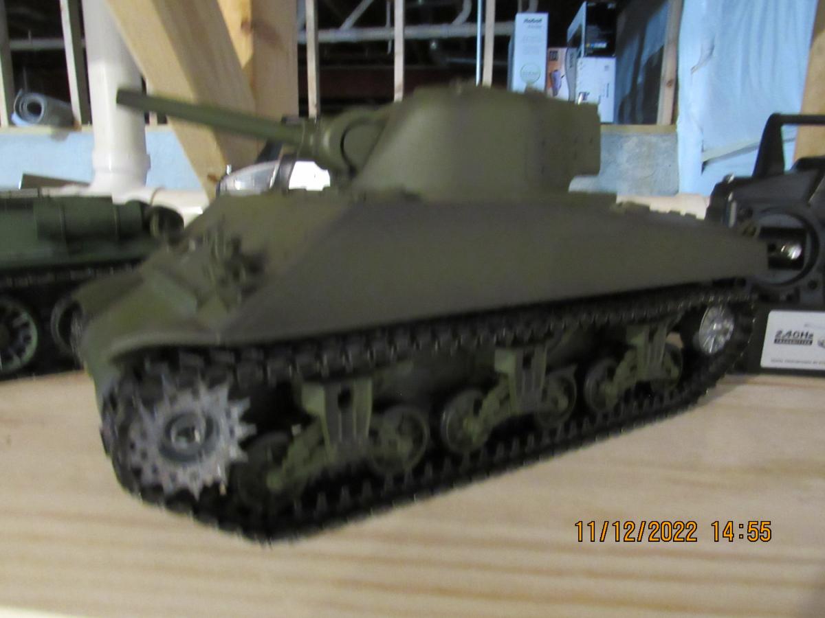

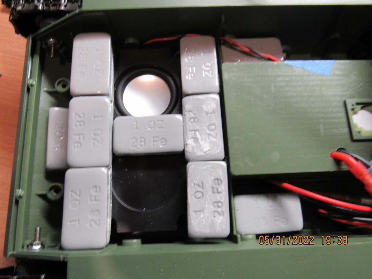

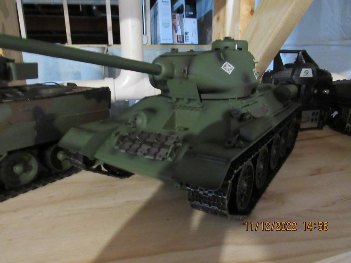

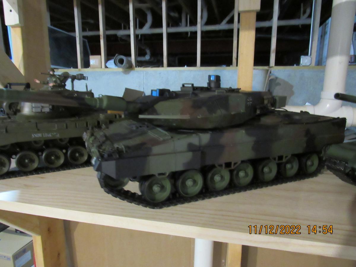

                                  My Heng Long line up as of November, 2022: Click image for larger version
ID:	361224Click image for larger version
ID:	361226Click image for larger version
ID:	361225Click image for larger version
                                  The Sherman is a new acquisition undergoing metal upgrade. More picture of the finished T34. I will try adjusting the T34 track tension in the next few days while waiting for the Sherman motor to come. The T34 looks fine and runs well as of today.
ID:	361228Click image for larger version
