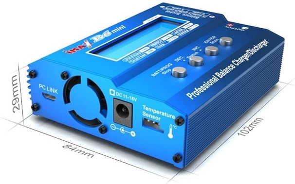

For the cost of a good battery pad, you can get a name brand smart charger that charges fast and give you longer battery life. -
This is the smart charger I use. This charger can be program to accommodate many different type of battery of different capacity. Make sure to get the SkyRC genuine charger. (There are many cheaper look alike knock-offs at e-bay which has mess up programming that cannot be updated.) At $40 on Amazon, it is an excellent value, but it needs an external power supply ($22). I like it running very cool and I have an extra power brick from my bench available. SkyRC also has an AC/DC version at $50 which runs quite hot due to the built-in power supply.
This is NOT a high charge rate charger for at battlefield use. It can charge the 1800 mAH battery that comes with most HL tank in an hour. My DIY 6000 mAH pad takes about 4 hours. I usually have a few spare battery pad on standby.Comment
