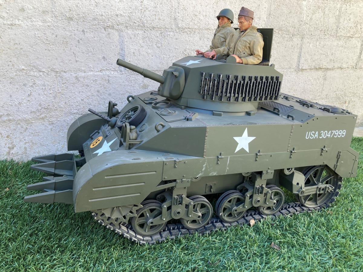

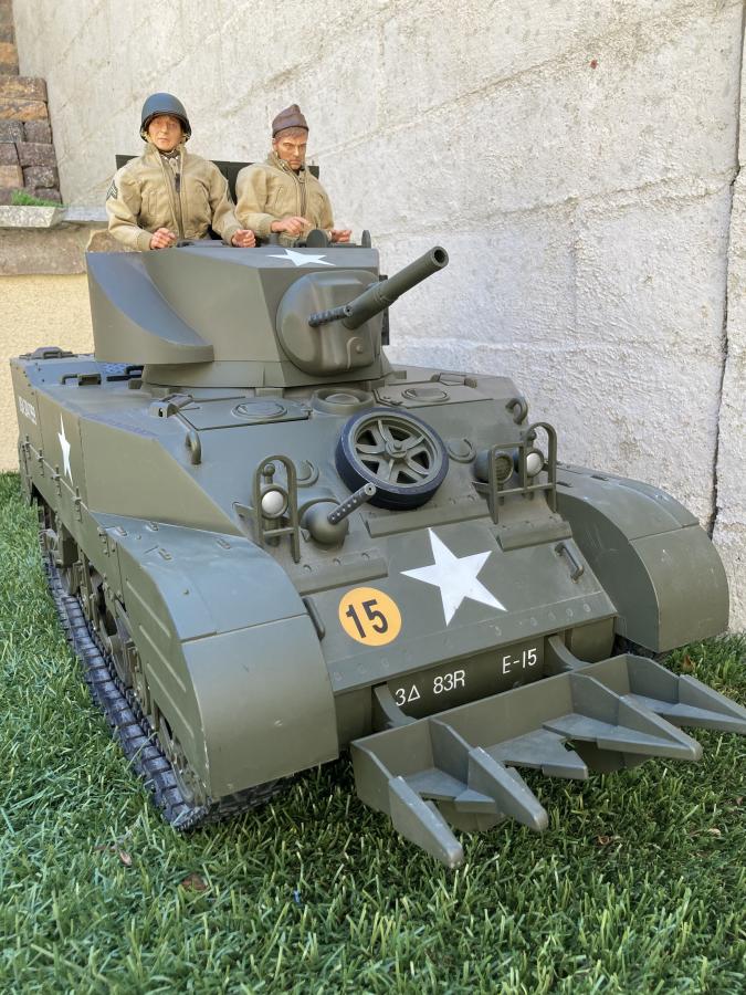

            I also have my M5 that I did not have to build, but I think mine is off the scale. In term of scale, it is missing a number "1" in front of the number "6", lol. If I remember correctly, I got this 1/6 scale tank 18 years ago. It is still running (with a new battery....of course )
