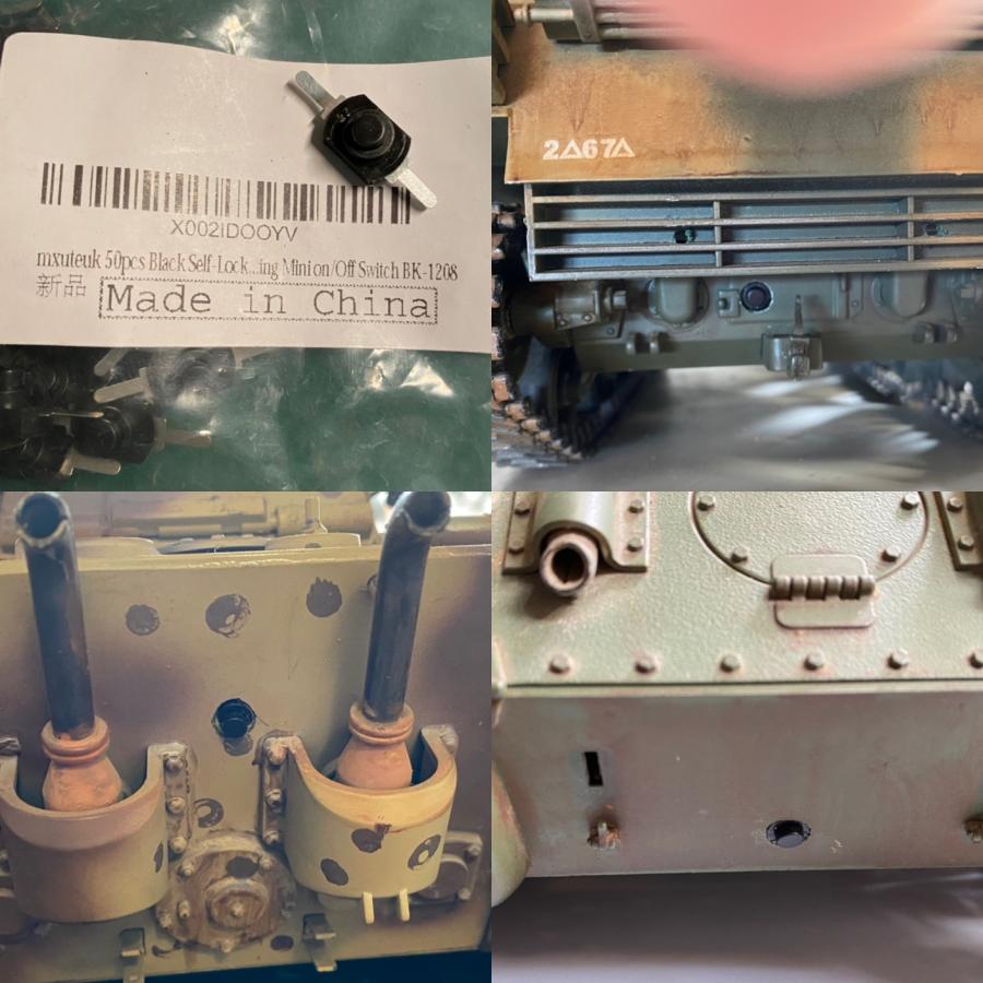

    There had to be a better way. I found some push on/push off switches (not momentary) on Amazon that might fit the bill:
    mxuteuk 50pcs Black Self-Lock Micro Push Button Switch DC 30V 1A for DIY SMD Flashlight Type Light Lamp Wall Outlet Latching Mini ON/Off Switch BK-1208
    50 of them for $10!

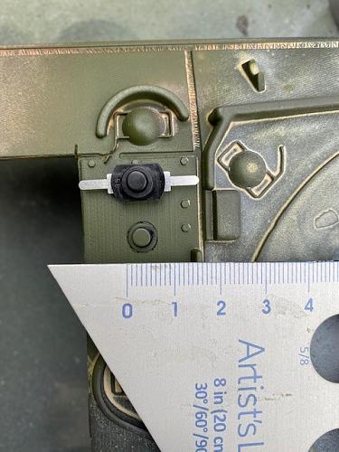

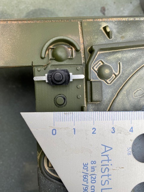

    I'm going to try them. They need a 7mm hole. 1/4" is just a hair too small, but can be reamed out for them to fit. I'll probably find spots on the backside of my tanks, somewhere I can reach but isn't very noticeable. The only concern I have is that they have to be glued on from inside. I've used CA to attach one on a test part, a spare Sherman hull. If the glue holds up to repeated presses, this could be a fix!
    One installed & one next to it.

    That actually looks very nice. The scale modeller in me wants to remove one of the fuel filler caps and put it right there, with the cap on top. How much travel do they need to work? Also; to make sure it stays put you could glue/weld a strip of ABS under it, possibly a piece of an old HL sprue. Then it won't ever move.

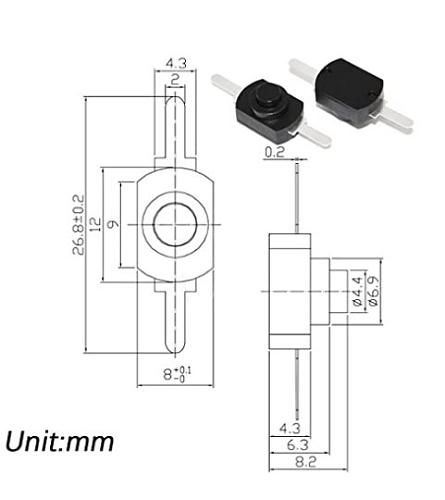

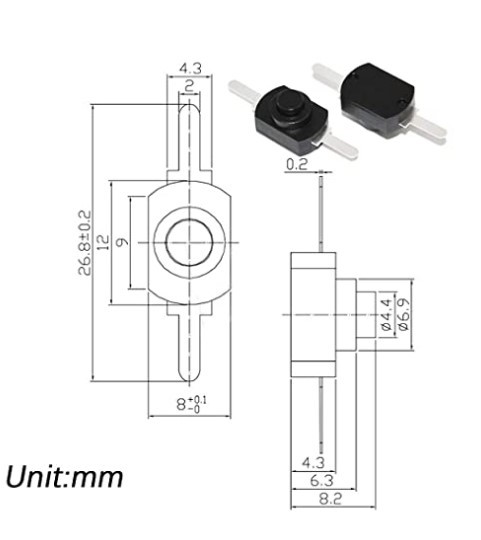

        I may have to put the switch on my Zik-20 on an upper surface. The rear is curved. If so, I'll heed Rob1970's thought and put it somewhere that makes it look like a real feature. Rob, if you haven't already seen it, here is a dimension diagram. The button (4.4mm) needs to be pressed nearly flush, slightly less than 2mm to activate.
        Click image for larger version  Name:	Button 02.jpg Views:	0 Size:	27.9 KB ID:	328821
        PS; apropos of Rich's post, for HL a non-momentary switch is necessary. They're commonly called "latching" online.

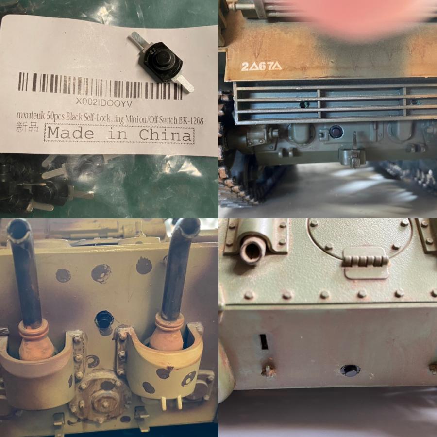

              I was asked recently how my “switch switch” has been working out. The answer is fine. I use them on my Heng Long boards in place of the slide switch undersides. I place them in the back, somewhere not readily visible. These are click once for on, click once for off. I’ve always planned to paint them to make them even less apparent, but it seems I never get around to it.
              The on/off circuit on the 6.0 & 6.1 boards do not carry power current, it is a relay. I don’t know if this is true for other board brands, but if the wire is thinner than the motor or battery leads, it probably is. Also, the momentary click activates the HL board. I don’t know whether it would with other boards.
              I don’t use them on all my tanks. Something’s there is a clearance issue, or a lack of a flat surface to place them. I drill a hole making sure it’s a tight fit, and superglue the switch on. So far I haven’t had any break the glue join when I use them.

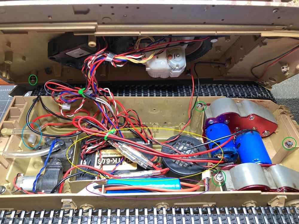

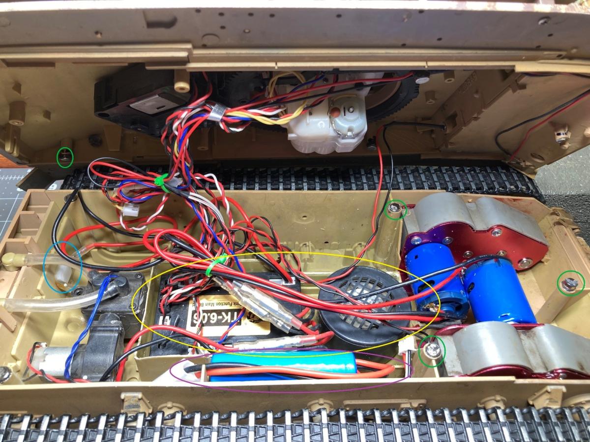

                      Bob! I added some more modifications on my Panzer III. Not only that I put the on/off button at the rear of the tank (blue outline), I replaced the screw connections to open the upper hull with magnets (green outlines). I also cut off the "wall" separating battery compartment (yellow outline). And now the board and the speaker are set nicely in that spot. I can easily open up the tank and hook the battery in (purple outline).
                      With this modification, there really is no need for me to turn the tank over :-) The nice thing is that the stock battery compartment for the Panzer III was really tight. Before, it was hard to put the battery and screw the cover in at the same time. Before, the space in whole compartment of the lower hull was also quite small. The wires and the board sometimes got in the way of the turret rotation mechanism. I experienced many turret rotations "stucks" while battling. Now.... no more :-)

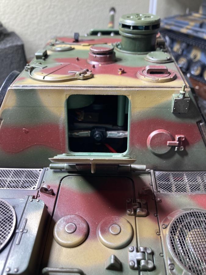

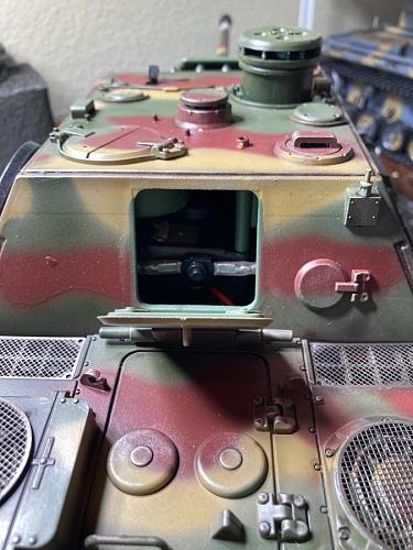

                        If you do not plan to ever use the airsoft feature then cut the gearbox off the bottom of the main gun breach. This will give you all the clearance you need and you turret will no long get stuck.

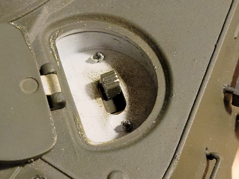

                          Yes I do.............Click image for larger version
