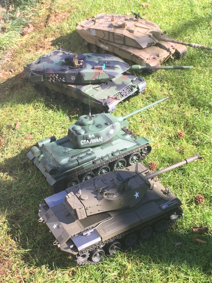

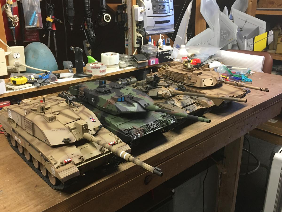

                      I tell you! I ordered my first one December 31st and now have an Abrams, T-90, Challenger2, Leopard, Bulldog and T-34. Except for the Abrams which I bought from a friend all are all metal with the 360 turret. I want a Mercava and there's talk that HL is coming out with one but may just get the King Tiger while I wait...
                      BTW when I say December 31st. that's just 5 weeks ago! :)

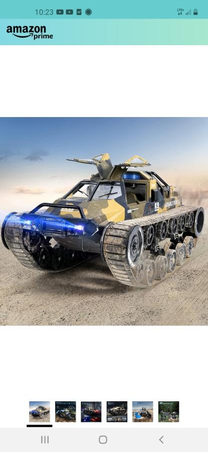

                          Haha same here except I got pick related first, the I got the m1a2 abrams upgraded with the metal tracks. I've been looking a crazy rc excavators on YouTube to which I'd live but my good are they expensive lol beautiful machines thoughClick image for larger version
