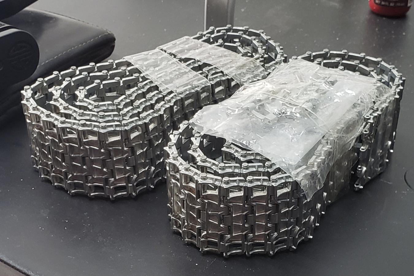

                      I was able to locate a set of metal tracks and they were delivered today...

                        I bought my friends T55 kit a couple days ago but won't be building it for a while after other projects. Can't wait to see your build.
                        Where do you find metal tracks?
                        Steve

                          From what I read the company that was making them quit..
                          I found them three places: the Hooben website, another site in Germany, and the Hooben store on Amazon..
                          The Amazon option seemed the easiest and was a few dollars less than the other two.. took around ten days to receive..
