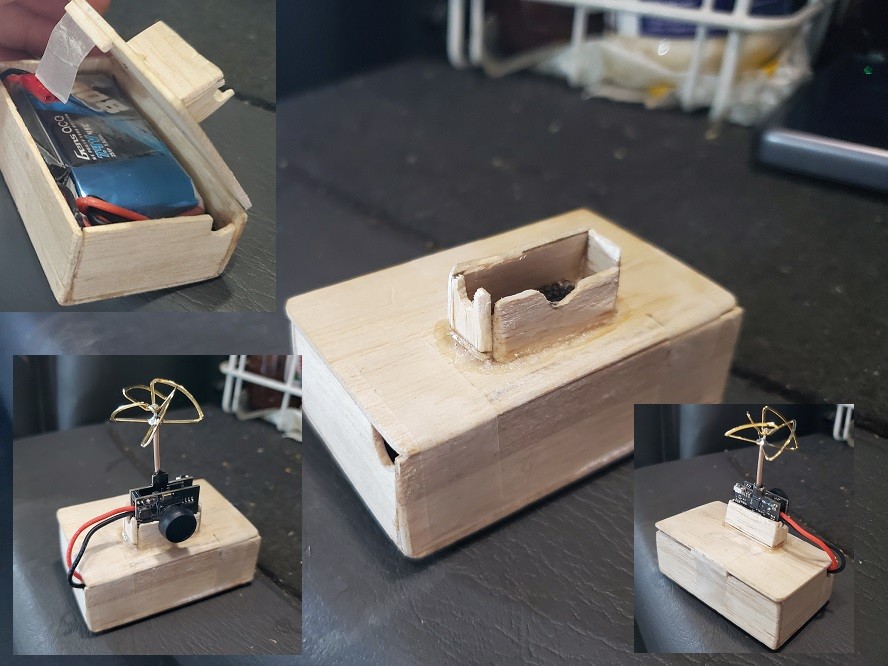

                  Here is my first ever Balsa scratch build.
                  Piggyback FPV box.
                  Yes its bulky but it helps with simply moving from one tank to another.
Name:	fpv piggyback box.jpg
                  Will take/post some on board vids later.

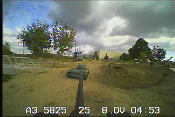

                      I just got a chance yesterday to enjoy some tank fpv driving after several small tests.
                      I will make a video later.
                      I was driving the two tanks simultaneiously while using my fpv screen.
                      That was quite challenging, need to get used to steer one tank with each hand.
                      It was extremely exiting nevertheless.

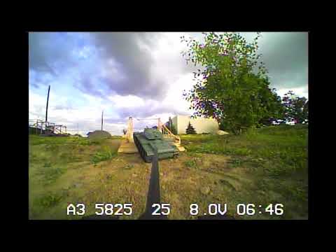

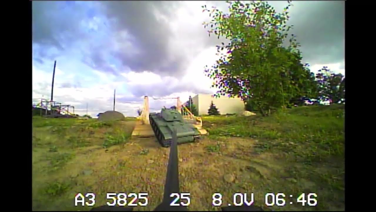

                            #33
                            Here it is, my first "real" FPV video creation.
                            Critics, comments and suggestions are welcome!
                            CCC
