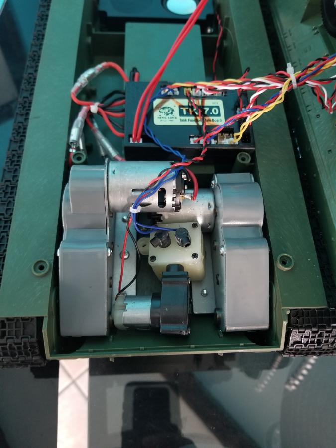

    Can someone shed some light here for me.
    I just received my t34 from motion and all looks and works great but I noticed the smoke unit just bouncing around in the tub. I dont see any attachment points. Is it normally like that?
    • SoCalBobS
      • 2754
      • Southern California
      #22
      The T-34 smoke unit directs the smoke out the exhaust vents on the top of the hull. It needs to be connected there so when you take off the top it stays on. I've glued the smoke hoses to the top deck and press fit the other ends to the smoke generator. So yes, it dangles! Other tanks that have exhausts through the lower hull will have the generator secured with screws.

        You're the man!!! Thank you. And yes I found the tubing rolling around inside. I attached them it's just hanging there but will surely come off again. I'll consider what you did. Good idea.

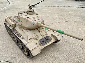

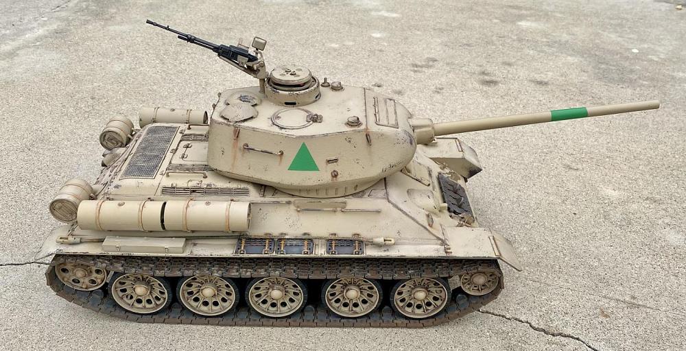

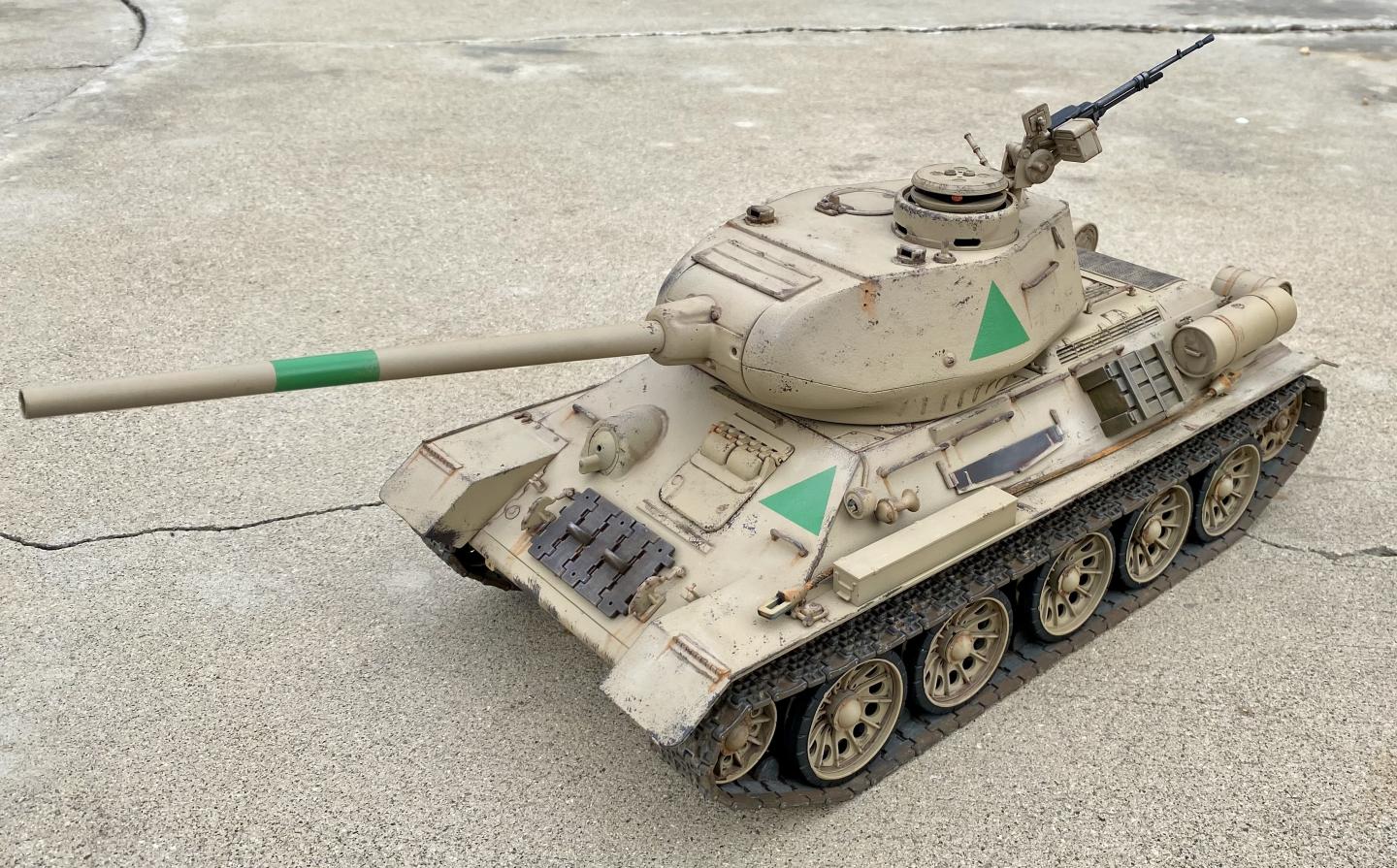

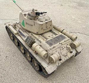

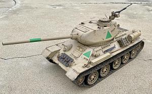

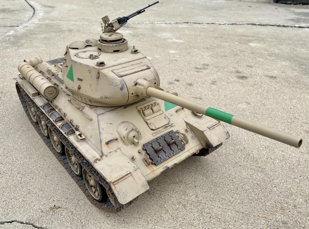

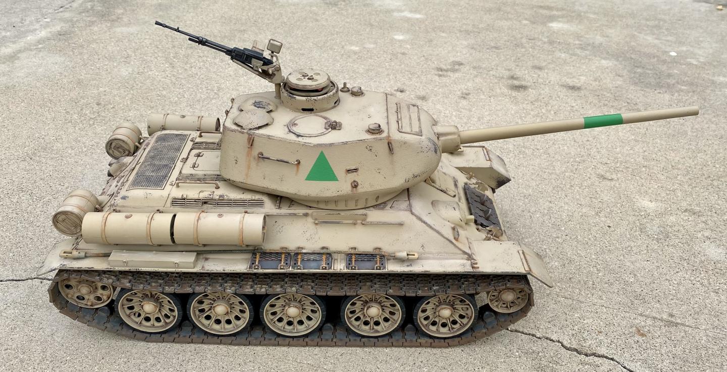

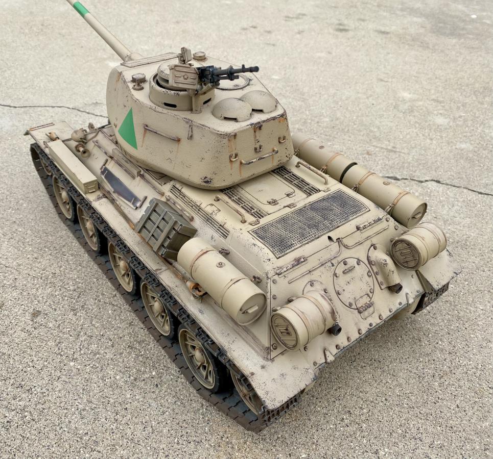

                Ok, back to T-34's...
                My Egyptian T-34/85 is "done & dressed up", ready for the next mideast battle.
ID:	359500Click image for larger version
ID:	359501Click image for larger version

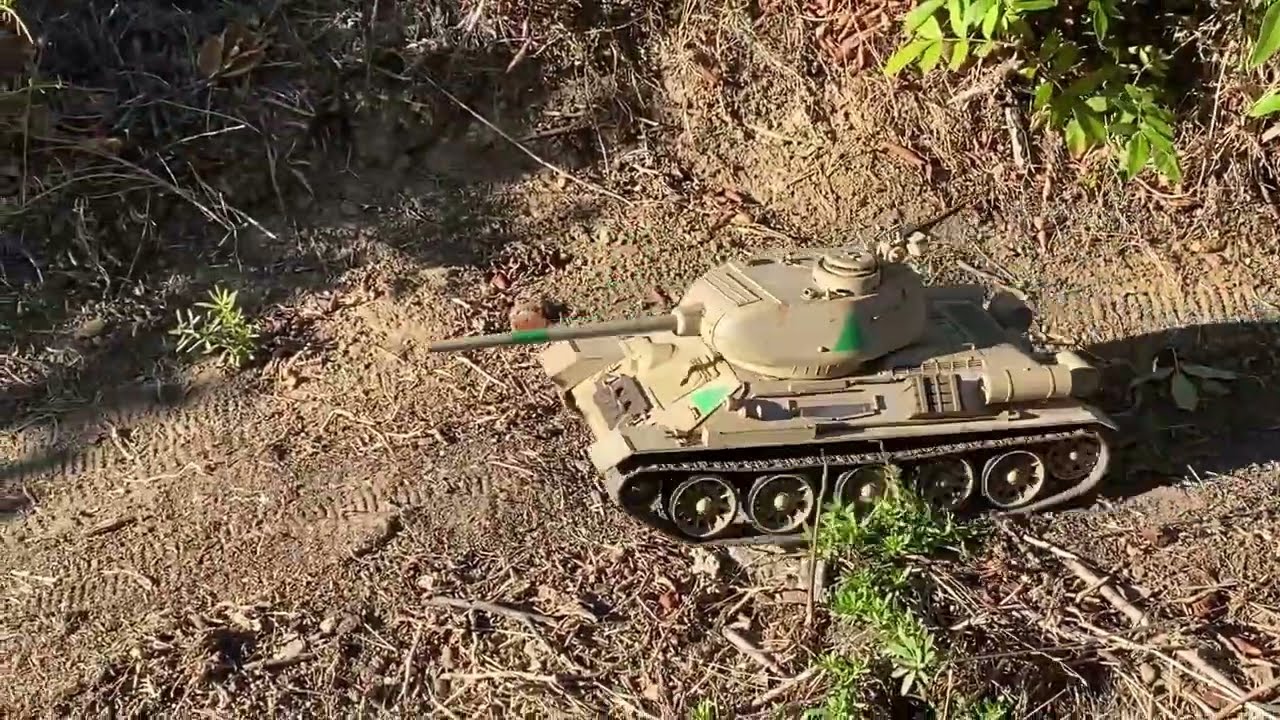

                                • SoCalBobS
                                  • 2754
                                  #36
                                  Drive testing my T-34, interspersing second and third person perspectives. No music or anything, so watch as much or as little as you want! (It's in HD, so if it looks grainy, run it straight in Youtube.)

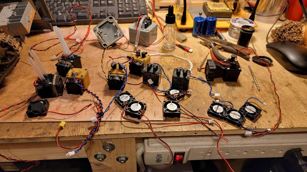

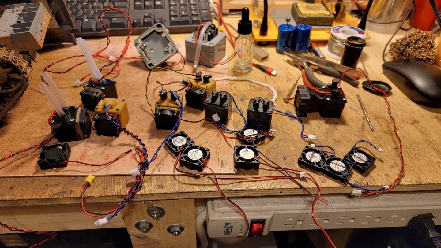

                                    Dont buy, make your own. 1. Much better performance 2. Takes up little room in lower hull.
