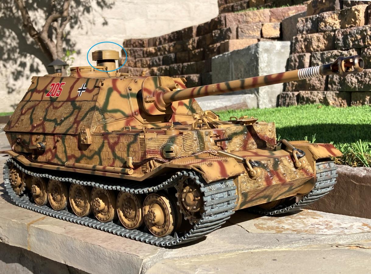

    My Clark TK80LW boards arrived a few days ago. One for the Toro Jagd KT (non RTR) and one for the HL Tiger I (RTR). I reviewed the info on the Clark-model website. I could only got the sound to work. I am trying to set them up for my Spektrum DX9 transmitter. Can any member, who owns one, kindly post a picture of the inside connections of your tank for me to follow?
    My Clark board expert buddy (Mr. E) is out of town until the end of March. I just eager to hook them up as much as I can at this time and see if I could get it run to impress him. Or bring the whole mess to him and have him connected them when he comes back :-(
    Thank you!

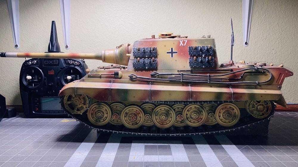

      After binding the Clark Board TK80 with my Spektrum DX9, I was able to make my HL Tiger I and HL Panther tank run and turn. I can rotate their turrets and elevate the barrels. I can control the gun fire and MG fire. The sound of the engine on both Panther and Tiger I were great. The work on the lights is next. It is also time to order some TBU and IR sets to get it involved into the battle. I will also turn back to work on the Toro Jagdtiger.

              I finally got my Clark TK80 board installed into my Toro Jagtiger. It is a beast. It is ready for IR battle. I can control it with my Spektrum DX9 transmitter. It could take up to 9 hits. It is also an IFA (invulnerable frontal armor). It will be fun to bring in to the May 14 LA battle.
