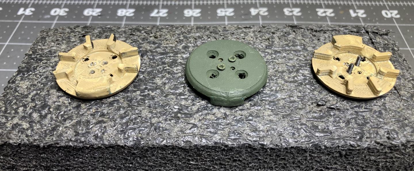

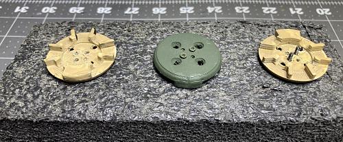

          LegoDEI made these IFA IR receiver sunshades just for me to use interchangeably on my Stugs and Jagds. If I receive complaints again about my IFA on our next battle, I will ask LegoDEI to give my $ back, lol.

            God bless Lego, but he is not great at testing the effectiveness of his own products in actual field use. San Diego club members have tested this type of set up and it did not equal the performance of the Tamiya set up. It tended to be much harder to hit which unbalanced the IFA intended purpose. That and the supposed rule change to IFA tanks coming for the LA Club and San Diego Club jointly switching to the twisted/45 off set IR receivers will renders them all but useless and they will need to be removed before play. This has been a long time coming and has been asked for by a large majority of club members well before the COVID closures.
            But these do look promising for the proposes new class of tanks that will be taking the fields soon. The Cold War and Modern tank class are getting the new Armor Invincibility Modern “AIM” upgrades that better simulate today’s advanced protection that make them only vulnerable to rear turret section hits when fighting against WW2 era tanks. When fighting other Cold War and Modern tanks they will revert back to 360 shades.
            Should balance everything out quite well, make the games faster, with more maneuvering which should encourage the younger players to stay involved longer.

              Sadly these LegoDEI IR receiver caps will not work as they are improperly blocked with thick plastic. I bet you did not know this.... The proper way the IFA block was applied was with black electrical tape. At a distance the IR beam cannot pass through the electrical tape, but closer in at 10 - 5 feet the IR floods through the black electrical tape and the tank can take a hit straight on from the front. Sometimes depending on brand of tape, one to three layers could be required to properly block a tamiya apple. Testing each roll on application by shooting it with a tank was necessary.
              These Lego shade caps being blocked with plastic the tank will not take a hit at all directly from the front so they would be considered improper to use and sadly useless.
              Click image for larger version  Name:	IMG_E0137.JPG Views:	0 Size:	219.0 KB ID:	344663
              The other problem we have found previously with LegoDEI receivers is that they have different angles than the Tamiya apple being that they have 4 IR receivers, one on each side while tamiya has one with a 4 sided inverse pyramid. Blocking a tamiya is relatively less blocked than blocking a whole IR receiver on the LEgo unit. Also, LegoDEI has offered now a couple different shades with different fins inside them at different angles which further complicates the IR pattern of reception and also muddles up the workings on regular turreted henglong tanks if they use a 45 degree shade cap on a 90 degree base, they then are effectively using the old TFA or tamiya twisted apple pattern. Some of our members have accidentally stumbled into this and I informed them when I figured it out.

                  Thank you RJ for taking the time to type in a great informative post. I now have a very clear understanding about the front blocking on IFA subject. The terms in your lecture was much nicer than my last professor :-) I will switch over to the electrical tape, test them again and toss the LegoDEi shades into the trash bin. I will share the history, the reasons, and the proper installation to others or the new members. See you all again on May 14 for the better prepared and more fun tank battles :-)
