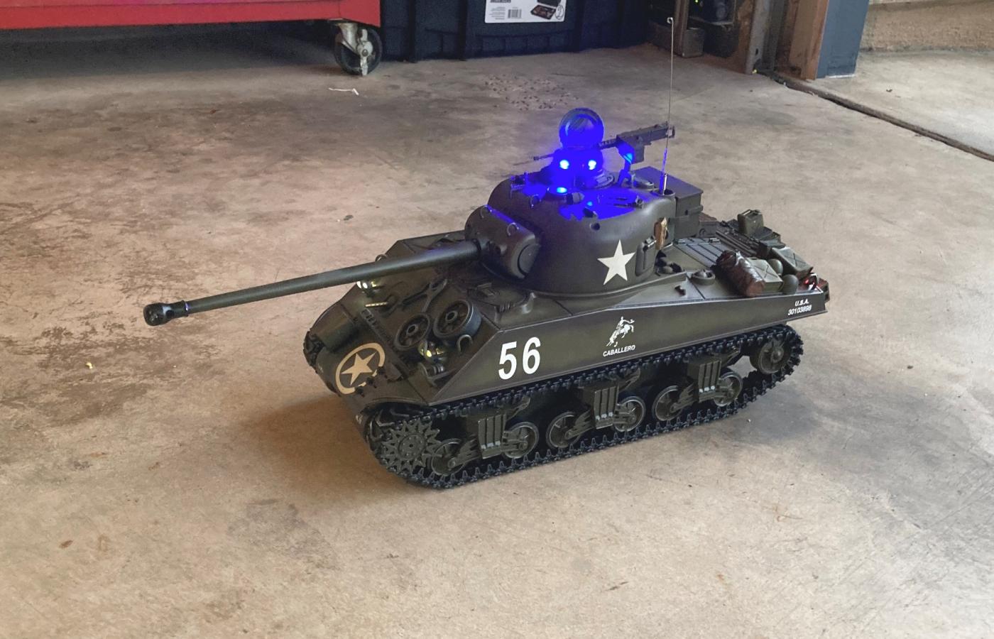

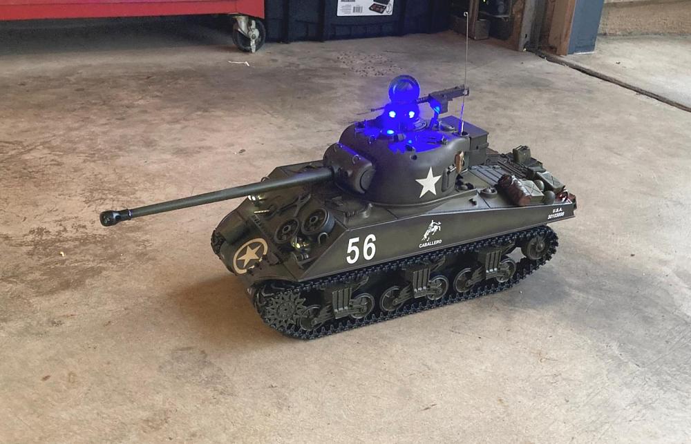

            I did. I think I got the last 2 of the batch. I am putting one in the HL Panzer IV and the other one in the HL Sherman.

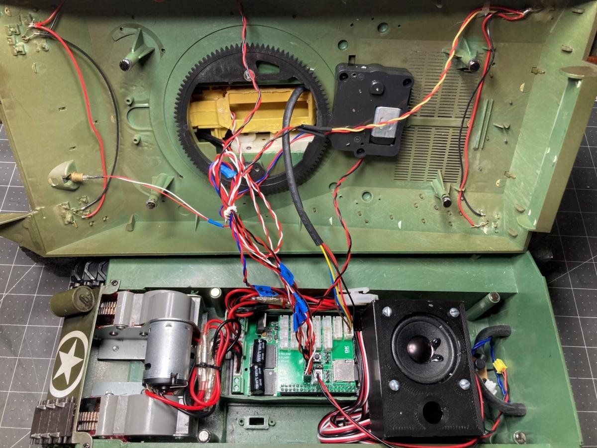

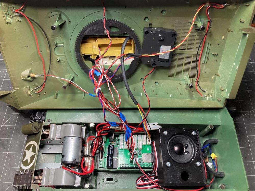

              I installed the DKT board from DKLMRC into my M4/76 Sherman. The IR emitter works. The IR receiver works. It can fight in an IR battle now. I still have 2 issues with this board:
              1. The instruction stated to hook up the volume function into channel 8. I did and the sound stays constant. I could not control the volume.
              2. The instruction also stated to use channel 6 for turning the tank on and off. I used channel 6 but it did not work. I had to plug and unplug the battery to turn it on and off.

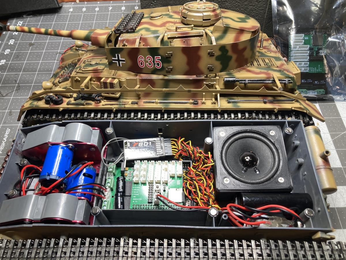

              I installed the 2nd DKT board the same way into my panzer IV. The same 2 issues occurred. In addition, the IR emitter did not shoot. I changed the IR bulb and it still did not fire.
              If anyone who know how to fix these problem, kindly inform me and show me the way. Thank you!

              • RichJohnson
                • 1276
                It doesnt matter what channel number on your radio you use for a function as long as the stick, switch or knob is appropriate for the function being operated.
                The battery should go through a power switch on the tank. Dont just plug it in without a switch. Then, the function number on the DKT board (I dont remember what function number it is) gets plugged into your receiver channel for any two position switch. It must be a two position switch. For me, its a top throttle cut switch which I have to flick down to start the tank. IF the switch is down when I turn the tank on, I have to flick up, pause, then back down. Engine starts. Flick up to turn engine off.
                For volume it can be either a knob potentiometer or a 3 position switch. I use a 3 position switch directly above my throttle and steering stick. Up is loud and down is quiet.
