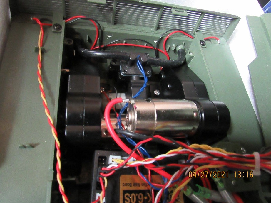

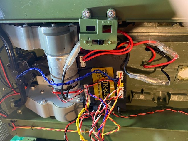

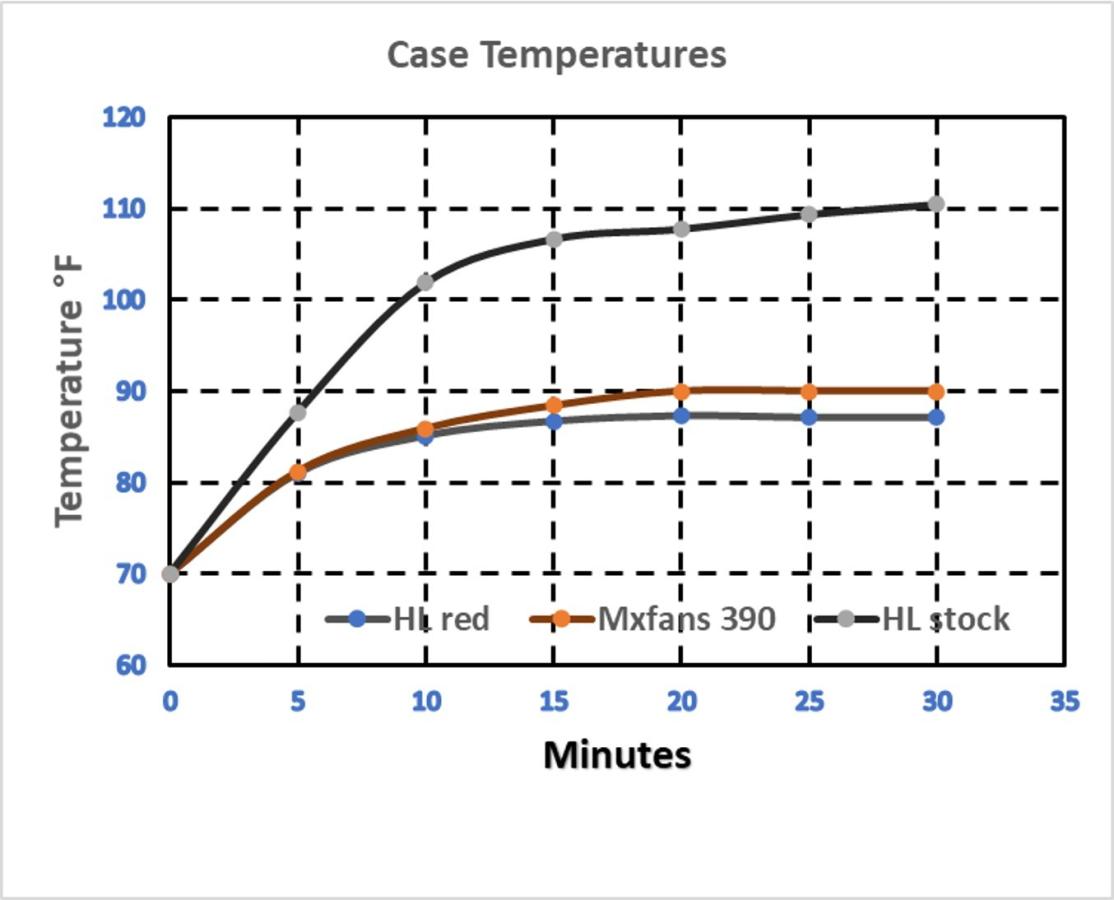

          I have a PRO version German Leopard 2A6 with stock HL380 motor, metal gearbox and metal track from factory. The grey stock 380 motor runs at 15,000 rpm and can drive the Leopard with the very heavy HL metal tracks to decent scale speed. The grey stock 380 motor runs very hot to about 40 degree F above ambient, not a good situation. I tested the red HL390 and MxFans 390 which runs above 22,000 rpm giving the Leopard more realistic scale speed for a modern tank (typically 45-50 mph). The 390 runs much cooler because it has built-in cooling fan inside the motor case. I also tested the Tamiya standard 380 which is slightly cooler and faster than the HL grey 380.
          The 2 pictures on the left show the stock HL drive/motor. The third picture shows the upgrade with MxFans 390 and Heng Xin gearbox. I use the Tamiya composite track which is light and strong.
ID:	345529Click image for larger version
ID:	345530Click image for larger version
          The bottom line is that I highly recommend upgrading to 390 motor for the HL Leopard 2A6. The Tamiya track is nice to have and much more realistic than the HL stock metal track.

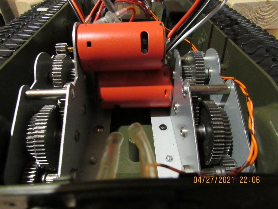

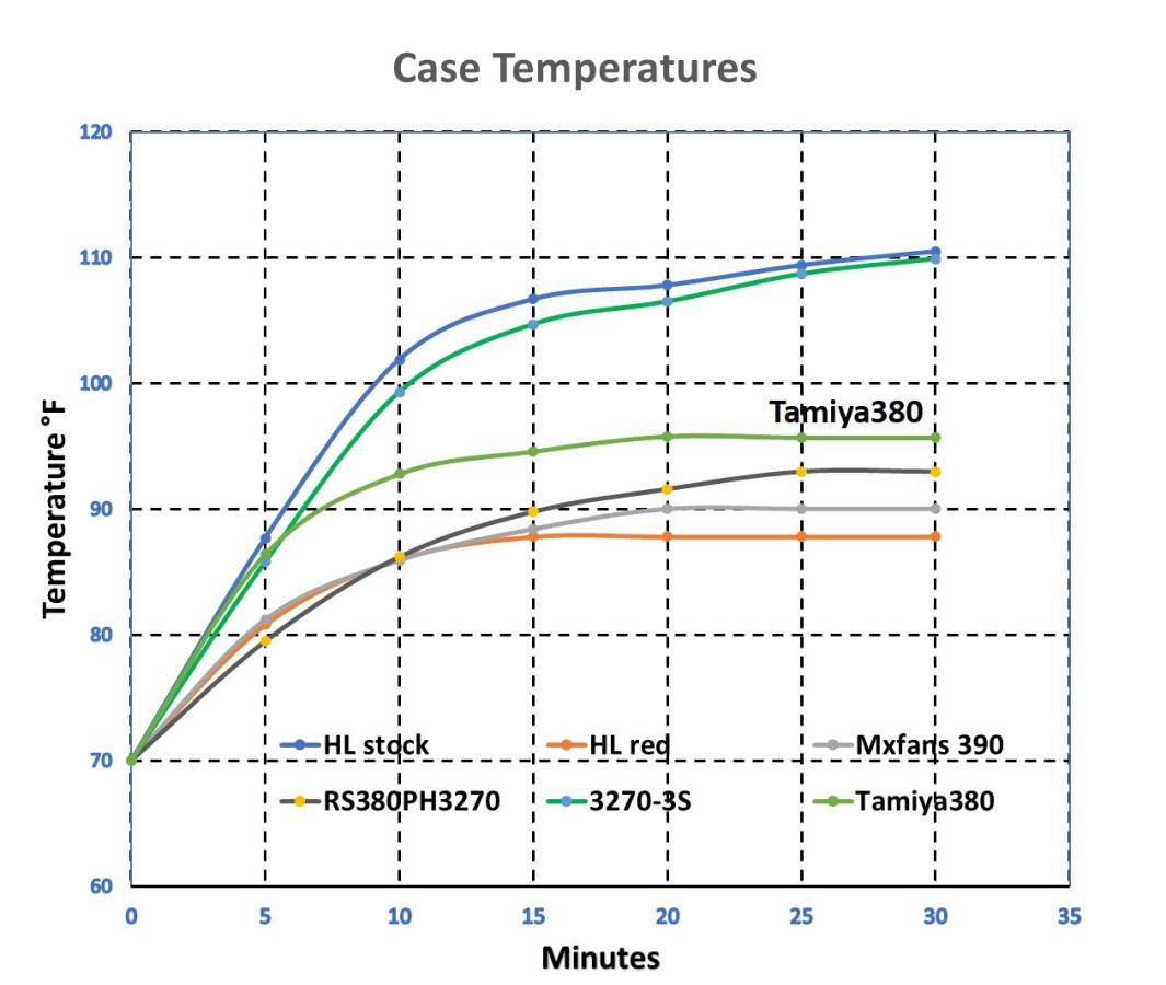

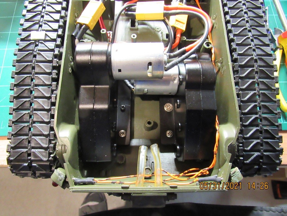

                The 390 motor is NOT a Mabuchi Motor design. It adds a cooling fan to the Mabuchi 380 which is a very good idea. But the implementation and manufacturing quality control is all over the map. Small motor like the 380/390 has fast moving parts using light machine oil for lubrication. Keeping them cool is ALWAYS a good idea and can reduce the need to oil. I survey the high end RC maker for 390 and found no conclusive result. I settled with MxFans 390 and is so far satisfied.
                I have a pir of Timaya Standard 380 on the HL Pershing because the Heng Xin gearbox does not allow the 390 to be fitted. The Tamiya 380 is made by Mabuchi, giving me the confidence on its quality. The Tamiya 380 runs warmer than the 390 for lack of a inside cooling fan. It does not go hot enough to kill a mainboard. The Pershing is one of the bigger WW2 tank so the tank inside is fairly open in the HL. I added a 40mm fan to help the circulation which is not necessary.
ID:	345654Click image for larger version
ID:	345655Click image for larger version
ID:	345656Click image for larger version

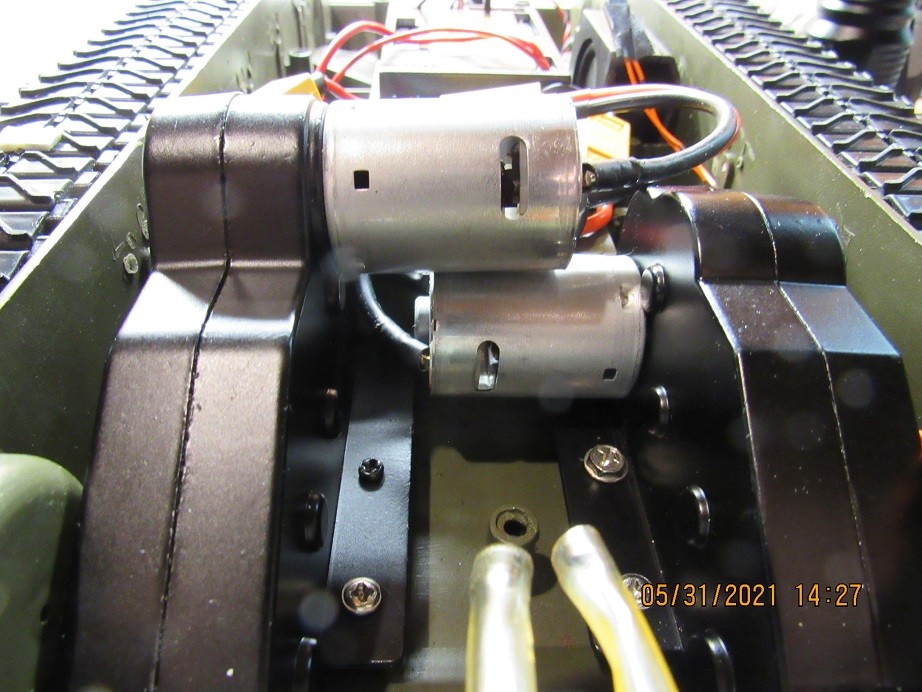

                BTW, it is possible to use the 390 on the Pershing (see 2nd photo above) if you use an open frame gearbox such as the HL Ultimate2, Taigen or the HL stock gearbox. I prefer gearbox with ball bearing for all gears which excludes the HL stock gearbox.

                  Is the Tamiya 380 so much cooler than the grey HL stock 380? How is it possible? Yes, the difference is real. It comes from much lower bearing friction of the armature shaft. The design and quality control both play a part.
                  No, I did not do localized temperature measurement to verify that. It is an educated guess. I was a thermal technology engineer working on hypersonic airplane in my former life.

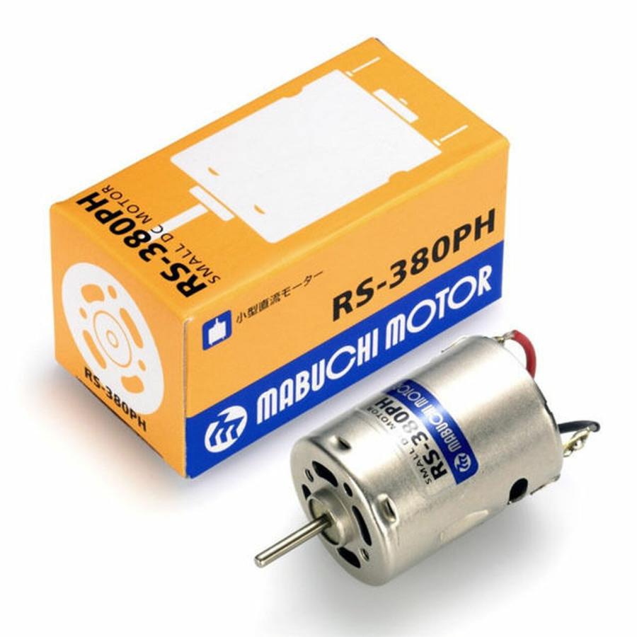

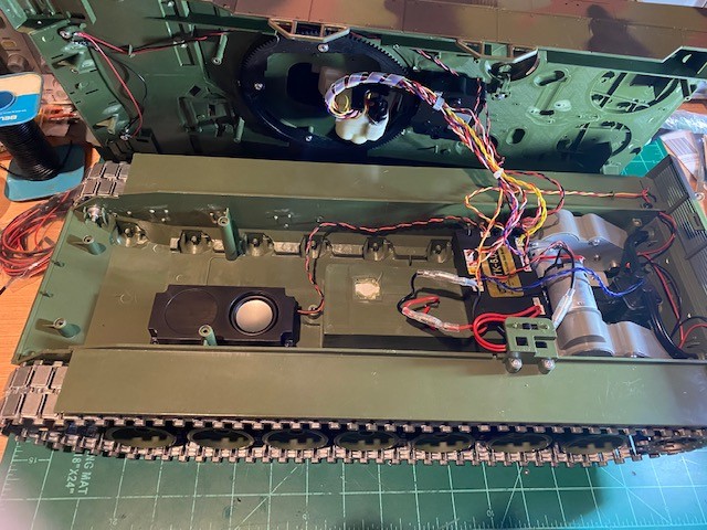

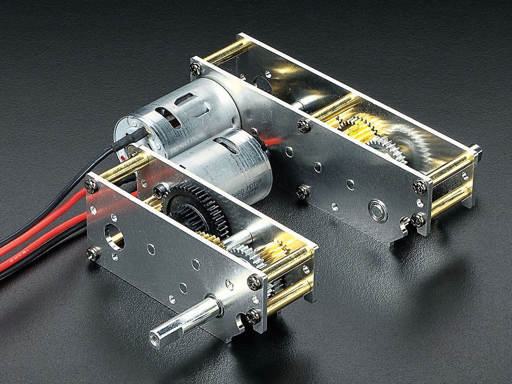

                            This is a spare standard Type 380-S motor included in some of Tamiya's smaller and mid-sized R/C kits. Use it as a replacement for worn out motors.
                            It is used in several of Tamiya's late WW2 and Korean war 1:16 RC tank such as the M551 Sheridan.
ID:	345788Click image for larger version
                            I measured the rpm at about 16,000 using a HL 1:39 ratio gearbox with 8.0 volts input. I use Lithium-Ion batteries for my tank which seems to stay around 8 volts the longest. I do not have my lab note on hand for the moment so the rpm number is not exact, but should not be too far off.
