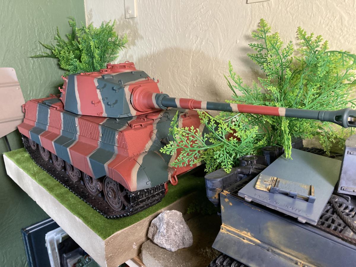

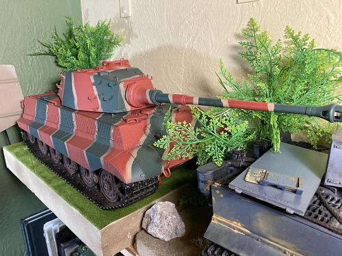

        How goes the KT progress? I painted mine with rattle cans. Color is bolder but I like it. Click image for larger version

          Looks good! I use a brown wash or pigments afterwards to tone down the colors.
          • #6
            Thanks SoCal. That is on the list. Ordered the Mega Steam today and put a sun sail over the diorama. It's getting hot now. I guess I will need more beer.
