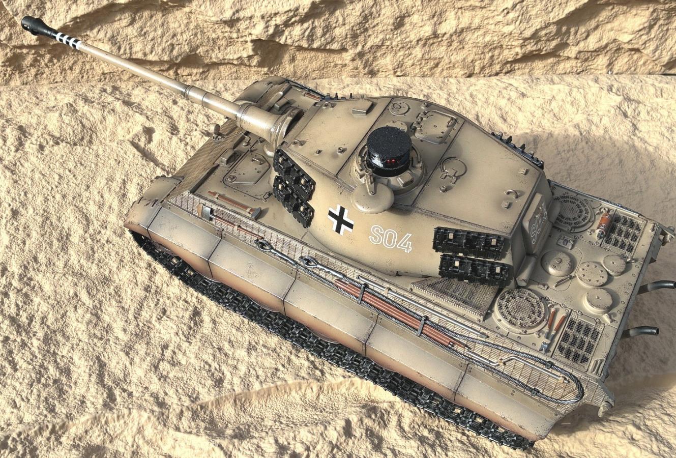

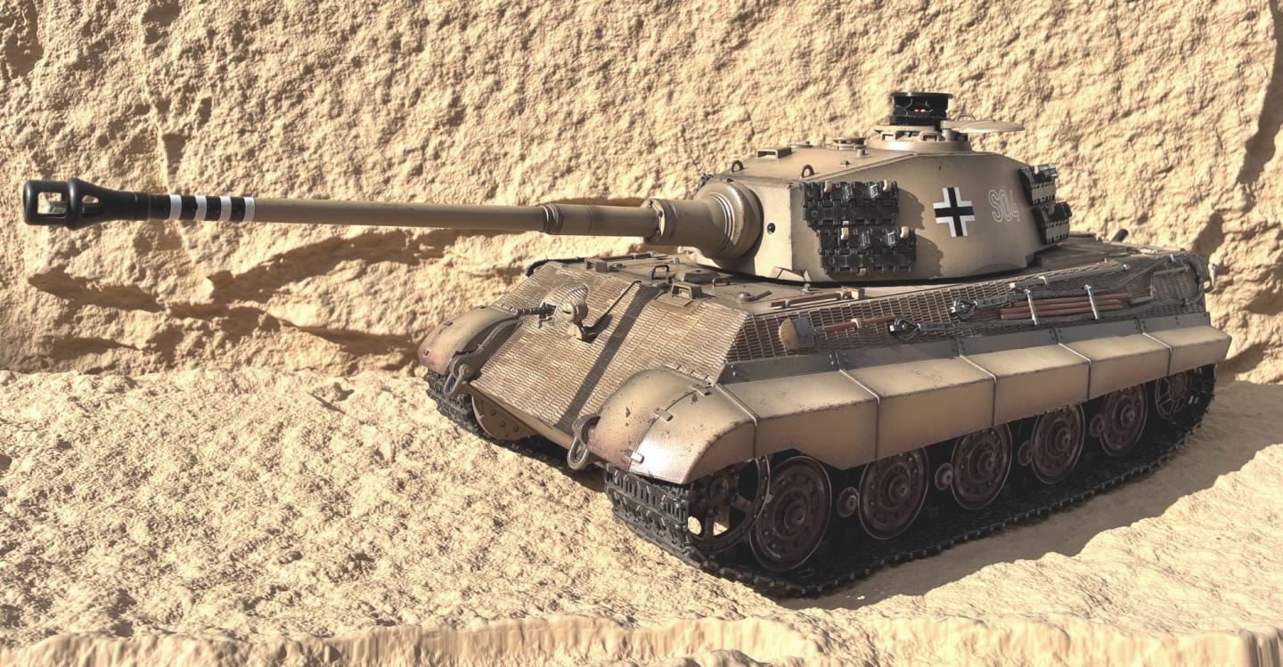

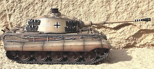

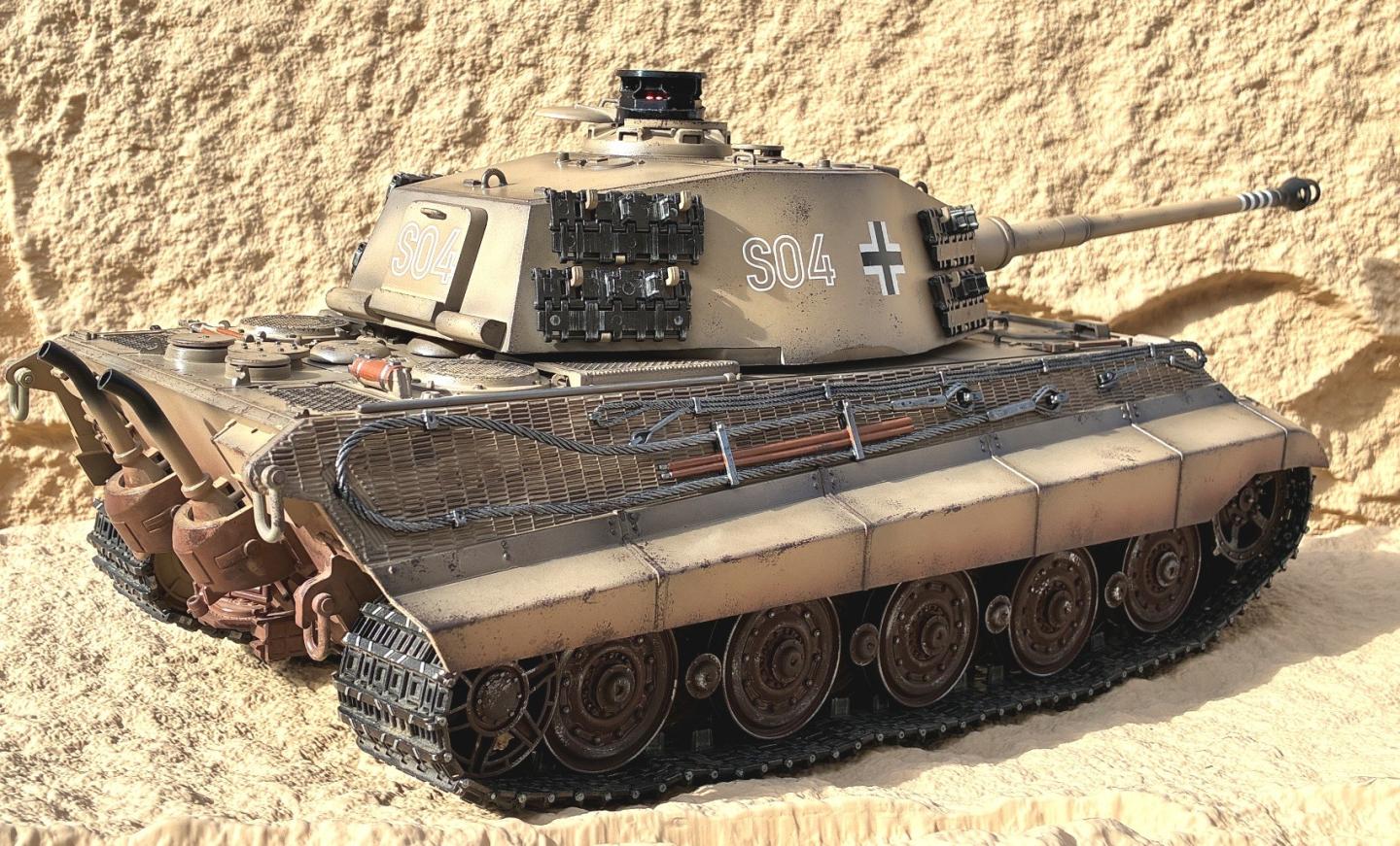

    Just added the Torro KT to the depot. Because of the 30 day warranty window I jumped right in to make sure all was sound. It will take the place of my old Tamiya KT. Also, have a Taigen Panther and Tiger 1. Like the Torro's because of the crate which is not offered in the Taigen package.
    I am just a casual armor hobbyist. About the time I entered the hobby the nearby club (Detroit Tank Command) was in the process of dissolving. As a side note back in my college days I was in a class that toured the Detroit Tank Arsenal back in '75.
    On to the Torro KT......
    First issue is the battery......
    In the manual it states not to use lithium batteries, I really don't see why as long as the voltages are equal and the correct charging profile for the specific type of battery is used. The problem is the supplied battery and charger do not provide any info on charge level. Have 2S batteries here but I thought I would ask first.
    Removing the deck.....aka, the deck follies
    Kind of funny here....not really hard to remove but the forward hull clevises interfere with the removal and refit of deck. Furthermore, the turret needs to be swung to access the deck hatch and switch. Then to place tank in crate the turret needs to be centered. Also the "charging port" next to the switch inside that same hatch is a totally different connector than that of the supplied charger, could be a 3-4mm barrel, which is not supplied.
    Like others around the web have mentioned, one must have a light touch with the throttle....way too fast.
    So far the only issue has been with the smoker unit. Both hoses were kinked and is not working. The fan runs but no smoke. Pulled cap to inspect looked ok. Don't get me started on refitting that gasket.
    Ah yes, the flopping barrel and turret....it's on the list.
    Overall, seems to be pretty good as a baseline....with plenty to do.
