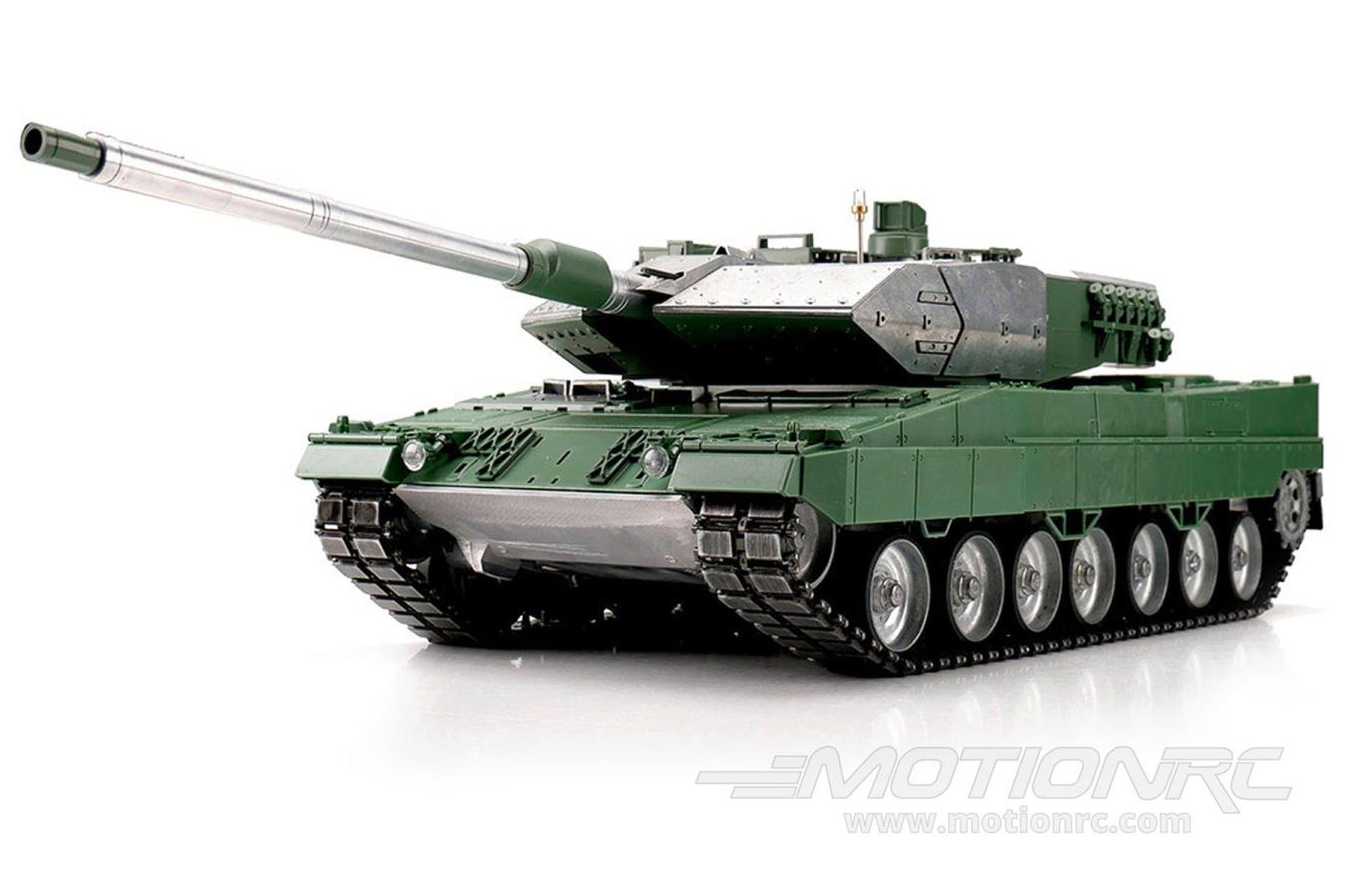

Official Torro 1/16 Scale German Leopard 2A6 Unpainted Battle Tank RTR Thread
    • 8233
    Unpainted 1/16 Scale German Leopard 2A6 Battle Tank from Torro - RTR - TOR1110038891
    The Leopard 2 is a main battle tank developed by Krauss-Maffei in the 1970s for the West German Army. The tank first entered service in 1979 and succeeded the earlier Leopard 1 as the main battle tank of the German Army. It is armed with a 120mm smoothbore cannon, and is powered by a V-12 twin-turbo diesel engine. Various versions have served in the armed forces of Germany and 12 other European countries, as well as several non-European nations.
    This version is delivered as RTR (Ready to Run), meaning it is fully functional out of the box, but it is UNPAINTED, giving modelers more freedom to detail, paint, and weather their model to their final preference. For the pre-painted version, visit here.
    All Metal Track System
    All of Torro's "Pro-Edition" tanks feature full metal drive systems. Single track links are connected with steel pins, propelled by metal drive sprockets and riding over metal road wheels and idler. Confidently conquer terrain with these durable metal tracks!
    High Torque Motors
    Reliable metal geared gearboxes are driven by high torque motors.
    Heavy Metal Castings
    Hoist hooks, spare track links and even simulated "welds" are reproduced in cast metal! The iconic "Zimmerit" coating applied by tank crews to repel magnetic mines is also molded into the plastic upper hull for additional period accuracy.
    IR Battle Ready
    Engage in friendly infrared ("IR") combat with other tanks using Torro's proprietary IR Battle System, both inflicting hits upon and receiving hits from opponents! Sounds and action signal each hit, until the 5th hit disables the tank. After 10 seconds, the disabled tank restarts and can rejoin the fight!
    Onboard Charging
    Torro's convenient onboard charging system eliminates the hassle of removing batteries after every driving session. Safely charge the onboard NiMH battery by plugging the included charger's plug into the tank's concealed charge port.
    Superb Scale Fidelity
    Molded details, metal cast parts, brass photo-etched parts, and functional elements such as opening hatches all elevate this RC model to the next level, making it a perfect display piece when it's not powering through the battlefield outside.
    360 Degree Turret
    Fully rotate the metal turret 360 degrees, and move the all-metal barrel up and down to train on your target. Torro's integrated drive electronics gives you complete proportional control to translate your precise inputs to all axe of movement. Drive, turn, traverse, train, and fire!
    Barrel Recoil and Muzzle Flash Effect
    The Pro-Edition of Torro tanks are distinguished by their synchronized barrel recoil and muzzle flash effect. When firing the main cannon, the barrel recoils at the same time that an LED inside the barrel flashes and a firing sound plays through the tank's internal speaker. Normally a costly aftermarket feature, this entire system is pre-installed.
    Exhaust Effect
    Glycerin-based "exhaust effect" simulates engine exhaust emanating from the two rear mounted chimneys.
    Torsion Bar Suspension
    Unlike simpler models with basic spring suspension arms, this Torro tank features a torsion bar suspension system that functions like the real tank! Torsion bars impart positive downforce on the tracks at all degrees of rotation, resulting in significantly improved traction over uneven terrain.
    Features:
    • 70%+ metal parts including turret, main barrel, tracks and drive system
    • 360 degree turret rotation
    • Barrel Recoil with Muzzle Flash effect
    • Realistic Torsion Bar suspension system
    • Metal lower hull, drive wheels, idler wheels, and road wheels
    • Single pad metal tracks connected with steel pins
    • Onboard charging system via charge socket
    • Proportional acceleration, steering, turret traverse, and gun movement
    • Realistic sound system and smoke effect generator
    • Fires an invisible IR signal to be used as part of Torro's proprietary Infrared Battle System, which disables other tanks when hit five times during simulated combat. Up to 20 tanks at the same time can battle each other!
    Includes:
    • Torro German Leopard 2A6 Unpainted 1/16 Scale Battle Tank - RTR
    • 7.2V NiMH battery with Tamiya connector
    • 7.2V NiMH battery charger
    • 6-Channel 2.4GHz radio transmitter
    • Infrared (IR) battle system receiver
    • Painted cosmetic accessory parts
    • Adhesive decal sheet
    • Set of small parts and accessories
    • Smoke effect oil (vegetable glycerin)
    • Complete instruction manual in English and German
    AGE LEVEL: 14 and up
    SKILL LEVEL: Beginner
    BUILD TIME: 1 Hour
    Scale 1:16
    Length 68.7cm / 27.0in
    Width 23.6cm / 9.3in
    Height 20cm / 7.8in
    Weight 8000g / 282oz
    Body Material Metal/Plastic
    Chassis Material Metal
    Track Material Metal
    Bearings Metal Bushings
    Gearbox Gear Material Metal
    Adjustable Gear Ratio Fixed
    Differential Type Gear
    Suspension Type Bogie
    Sprocket Metal
    Road Wheels Metal
    Idler Wheel Metal
    Adjustable Idler No
    Turret Rotation 360 Degrees
    Lights Yes
    Sound Yes
    Exhaust Effect Yes
    IR Battle Ready Yes
    Airsoft BB Launch No
    Track Recoil Yes
    Cannon Barrel Recoil Yes
    Required Battery 2S 7.4V 1800mAh (included)
    Required Radio 6 Channel (included)
    Skill Level Beginner
    Build Time 1 Hour

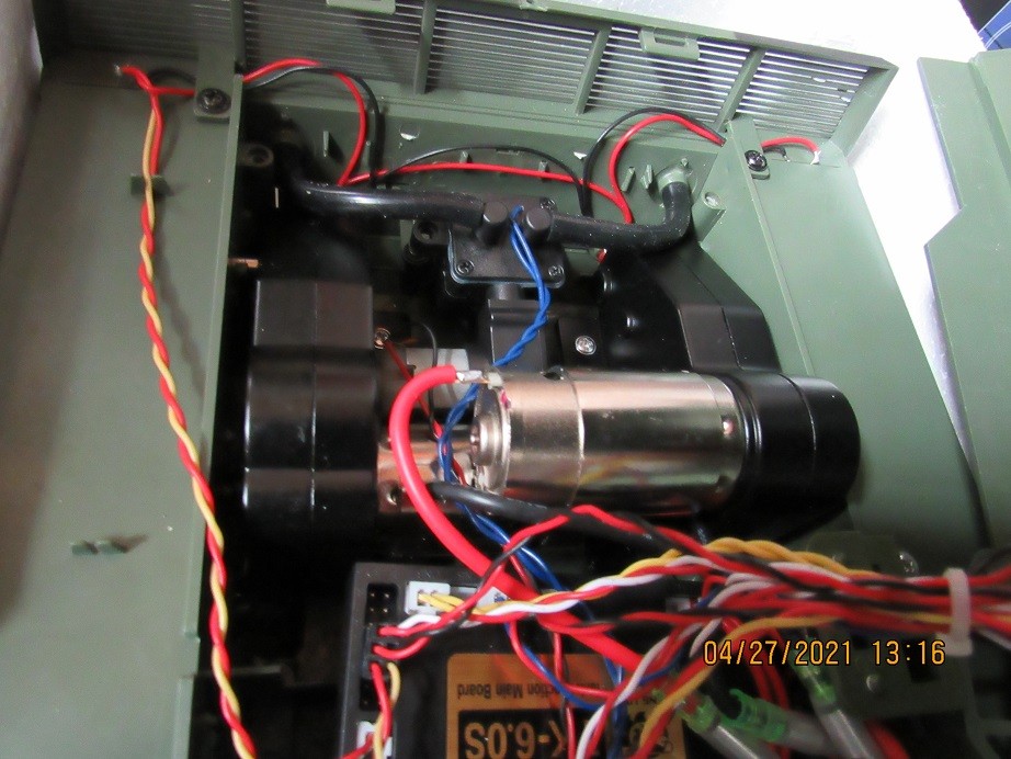

    I will wait and hope that Torro will offer a static version of the all-metal Leopard 2A6. For RC tank of this size and weight, I want to put a ball bearing gearbox with 390 or 550 motors on it. I also want the Heng Long TK-7.0 radio in it too.
    It is really a stretch to call the 380 a high torque motor even if you tet the best version directly from Mabuchi Motor Inc.

      Why wait when you can get the kit from Taigen with v2 gearbox? This runs great, especially with the Tamy tracks as suggested by Rubicon. I believe Motion is using stock (old) brochure and wrong pix for gearbox. My Leo, bought in 2020 came with v2 & 390's, granted those were branded Taigen.

        I do not have the budget for an all-metal RC tank now. Waiting for the static model is just an excuse. The Taigen website has much better information than MotionRC.
        I have the weakness of wanting to pick my own metal upgrade parts. I have the Heng Xin gearbox on my plastic hull Heng Long Geopard 2A6. The Torro version 2 gearbox is a downgrade from the Heng Xin. I use the Heng Xin with a pair of Maxhans 390 motors. They run quieter and with less vibration than the Torro gearbox. The track is Tamiya. My metal upgraded Heng Long weights only half of the 17lbs Taigen/Torro. I have a Heng Xin gearbox that was removed from my Pershing that can be used on the all metal Leopard if I ever save enough budget for it.
        Click image for larger version  Name:	IMG_4980.jpg Views:	0 Size:	154.0 KB ID:	388239
        Except the gearbox, the Taigen/Torro Leopard 2A6 uses good components. I particularly like the version 3 electronics that allows pairing with your own 6 channel PWM capable hobby grade transmitter. My main complaint about the Heng Long Radio is the very poor quality transmitter.

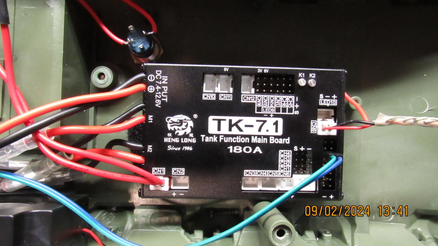

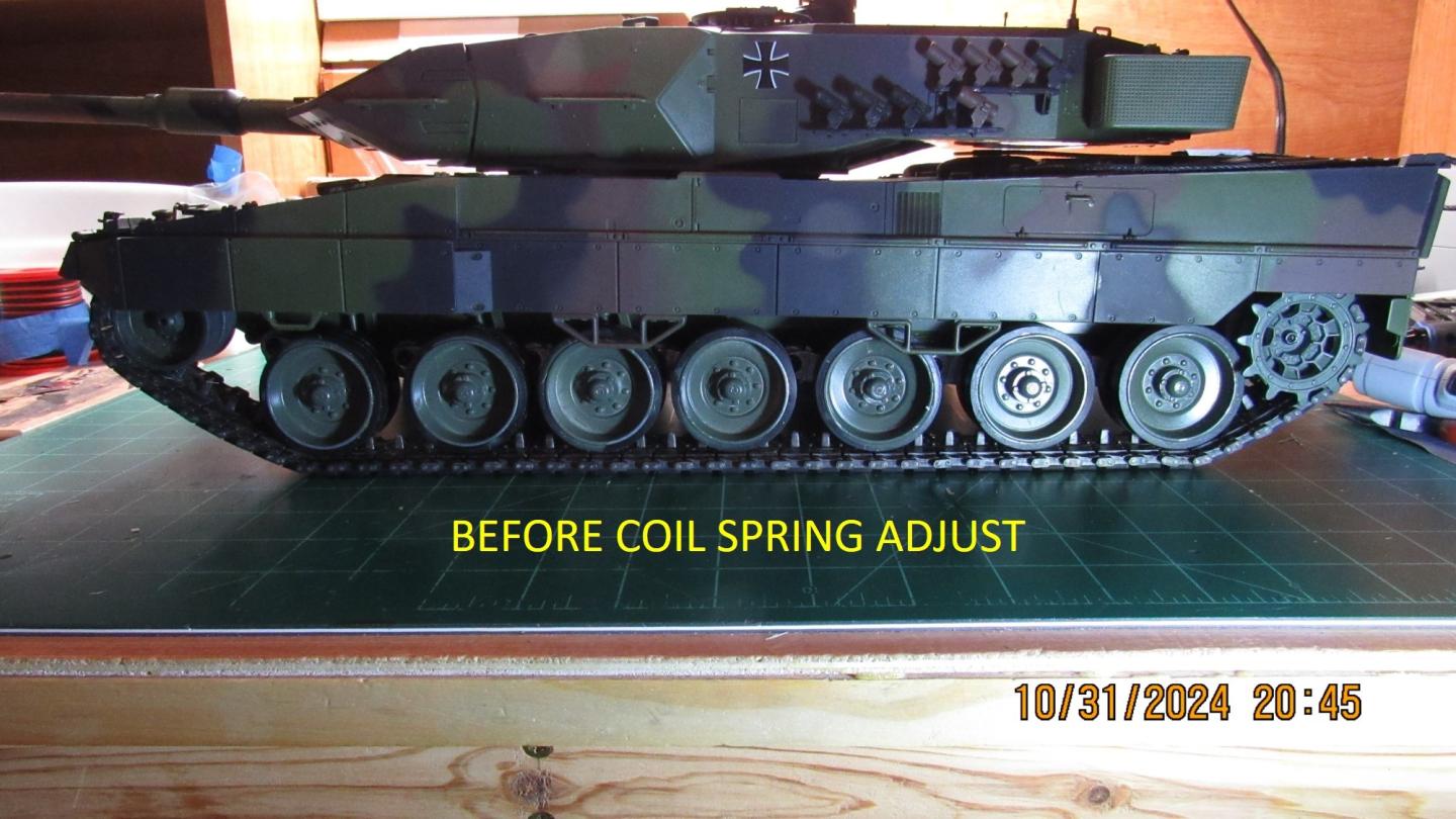

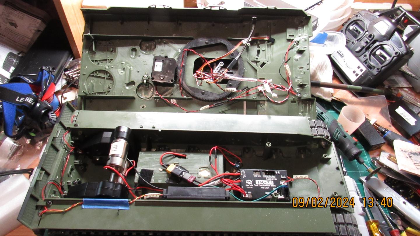

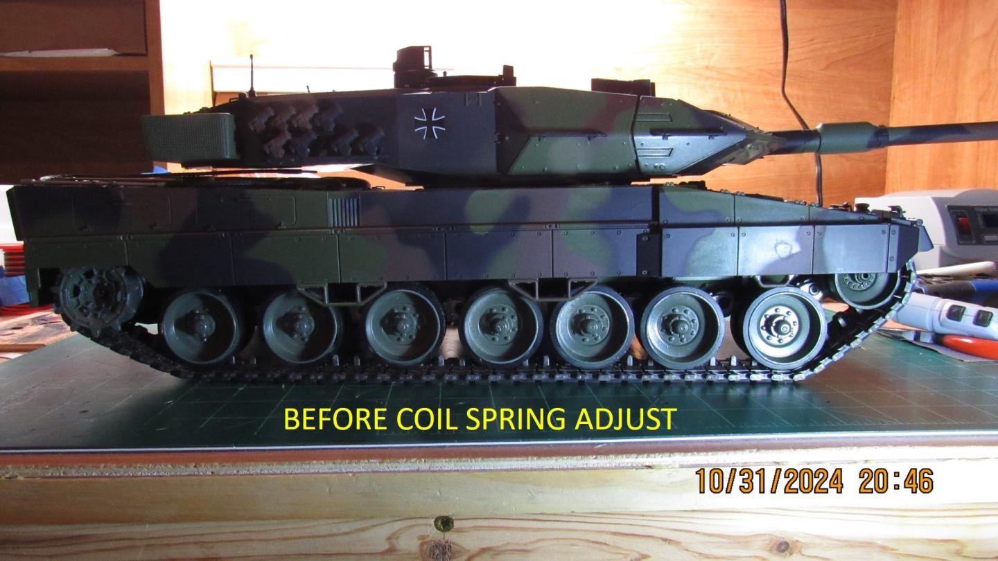

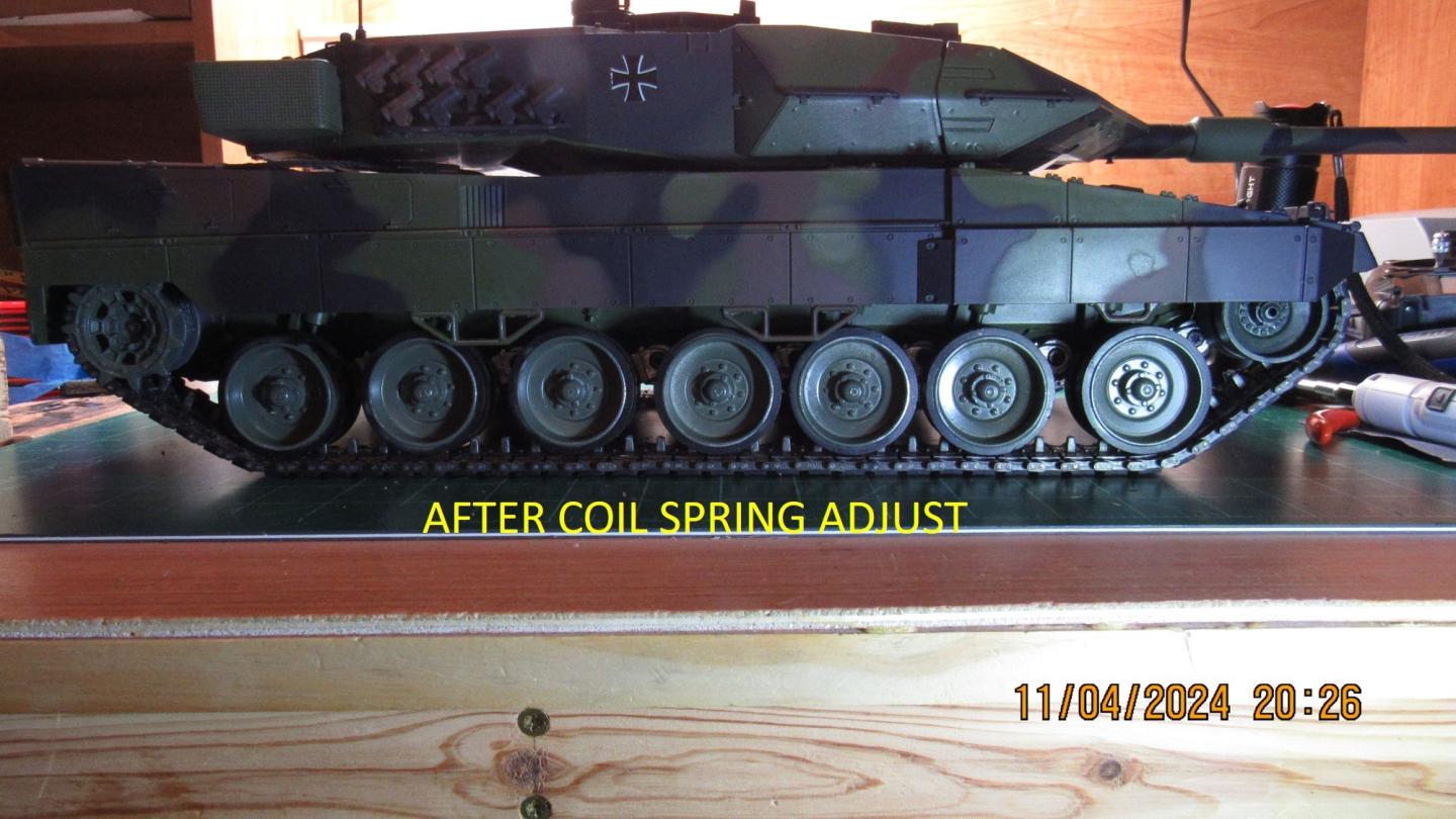

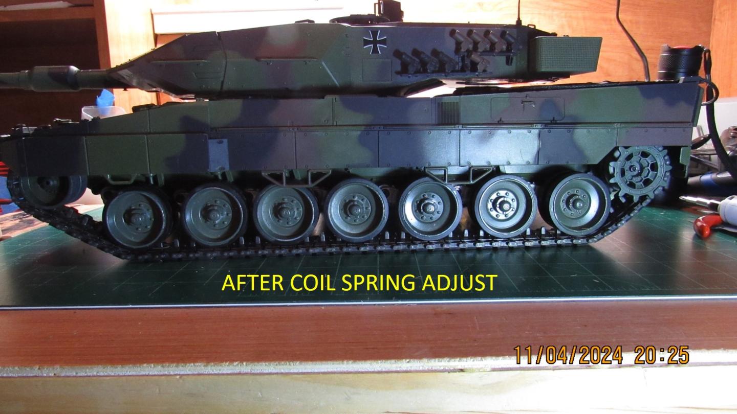

              After another 2 and half years, I finally concluded my Leopard 2A6 metal upgrade. The latest step was adding metal road wheels. The Leo total weight grew to 11.0 pounds. After I tailored the suspension coil springs, the HL design work very well. The Leo has servo recoil and elevation and the HL TK7.1 radio.
