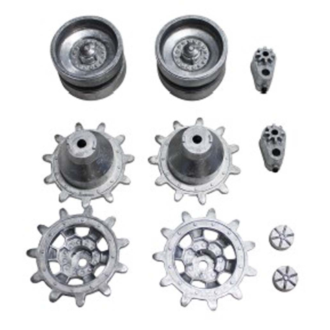

    You need these wheels because the heng long wheels do not fit also you heed the sprocket and idle wheel for the metal hull.
    Leopard 2A6 - metal rollers, set for the metal lower hull High-quality road wheels, each roll is mounted on ball bearings double! Delivery: 14 metal wheels
    Leopard 2A6 - metal sprocket and idler wheels with ball bearings Delivery: 2 metal sprocket 2 idler wheels with ball bearings 2 supports for the wheel

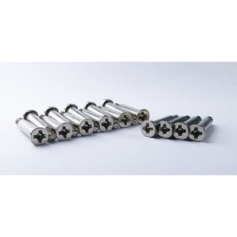

      In addition to the road wheel set, the user also needs the road wheel axle set.
      Leopard 2A6 - 14 metal shafts with thread, road wheels for full metal lower hull This axles are needed to retrofit the Taigen metal road wheels (metal road

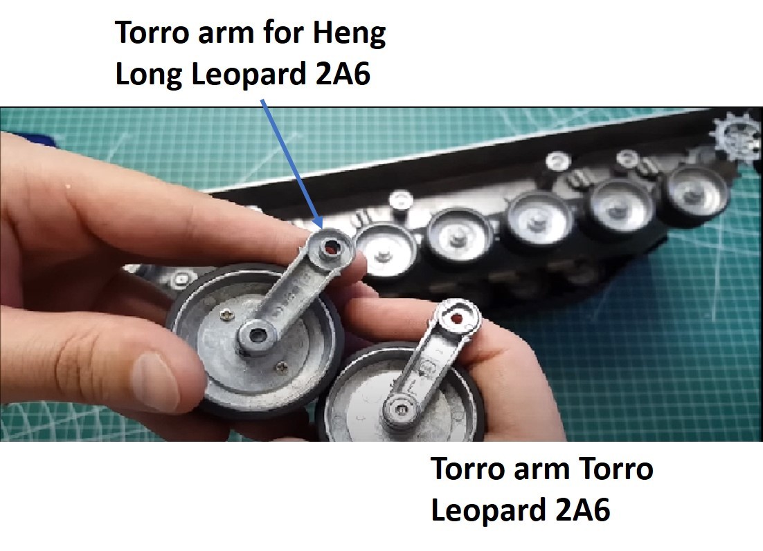

      Click image for larger version  Name:	Torro_metal_roadwheel.jpg Views:	0 Size:	145.8 KB ID:	419344
      Notice the circular ring for the HL arm using coil spring and the D-ring for the Torro arm using torsion bar.
      • #4
        I have tried the Torro metal road wheel set for the HL Leopard 2A6 (on the HL Leo2A6) with disastrous results. I ended up returning the set to MotionRC.
        Torro makes a set of metal road wheels for the Heng Long German Leopard 2A6, 3889. This set includes the metal road wheels with bearings and rubber tires, a full replacement set of metal suspension arms to connect the Torro wheels to the Heng Long Chassis. It is available from Taigentanks.com at about the same price as the HL
