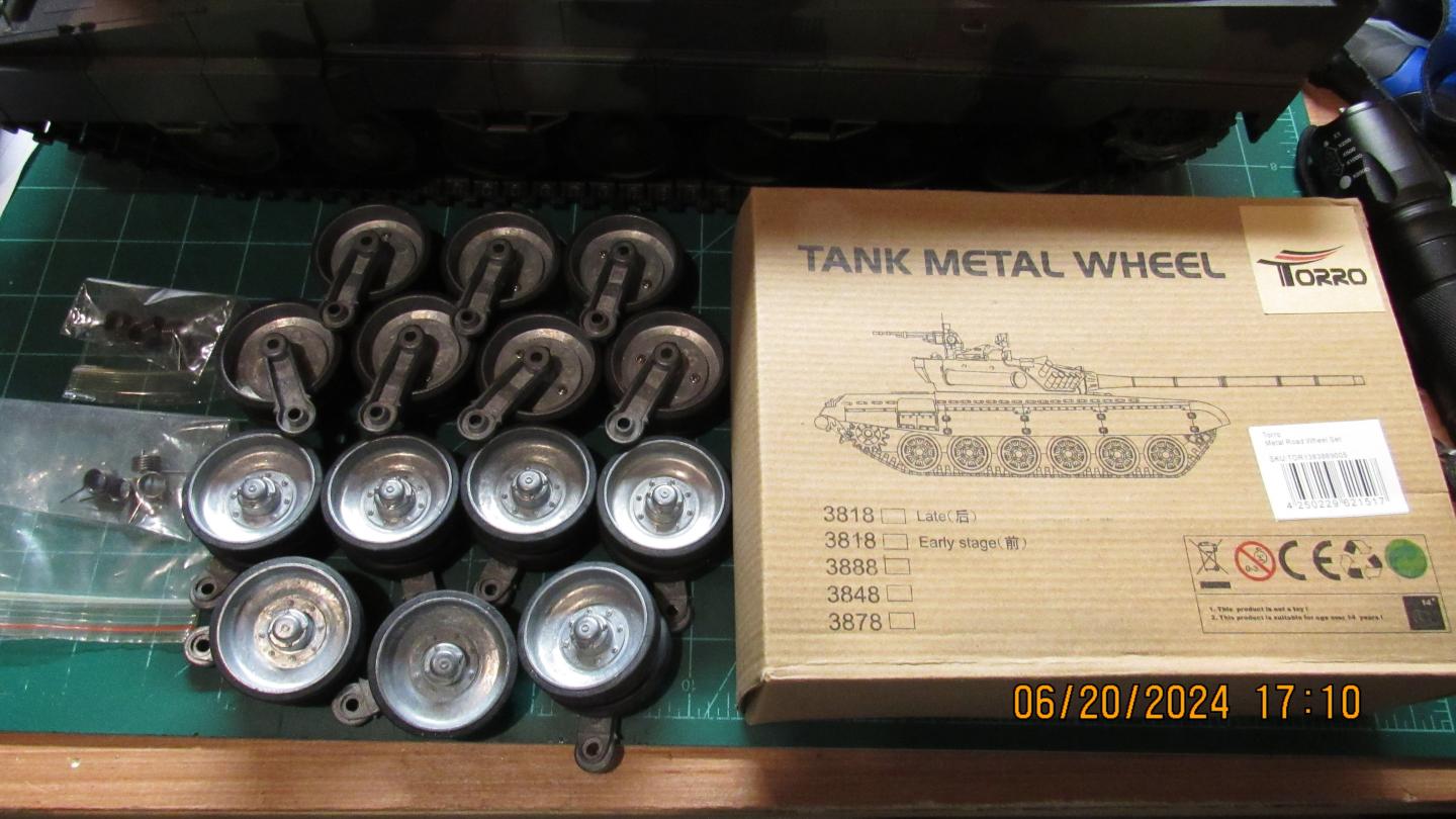

              Received the package from MotionRC just moments ago. I can confirm that this set from Torro is made specifically for the Heng Long German Leopard 2A6, 3889. Will find out how well it works in the next few days.

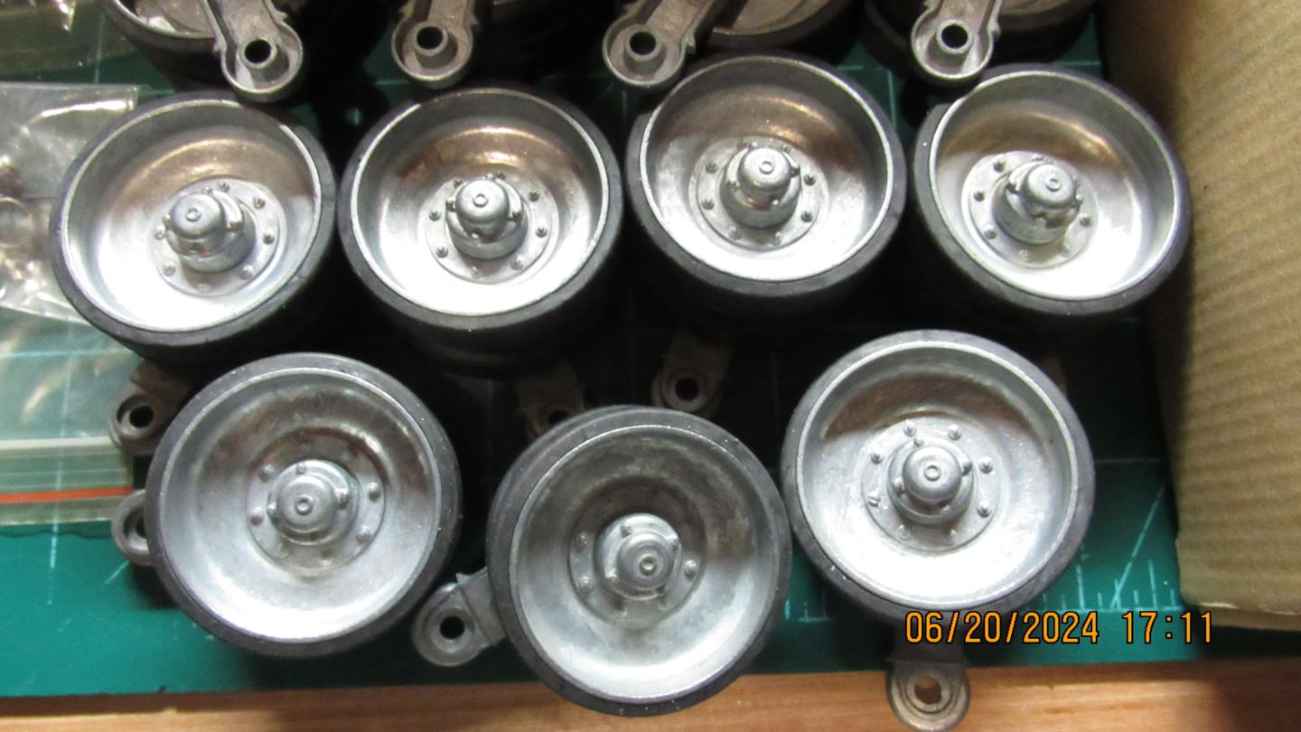

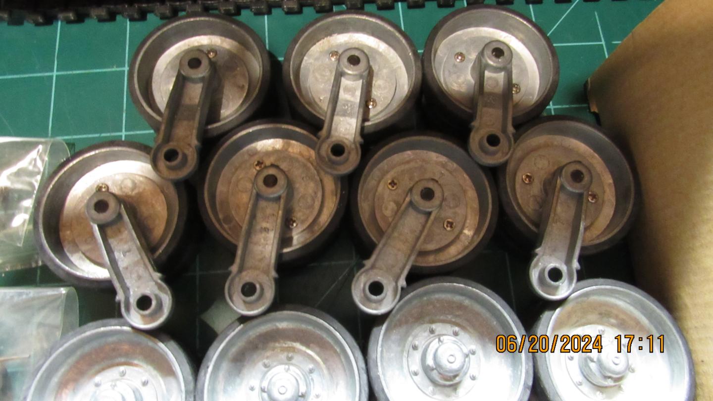

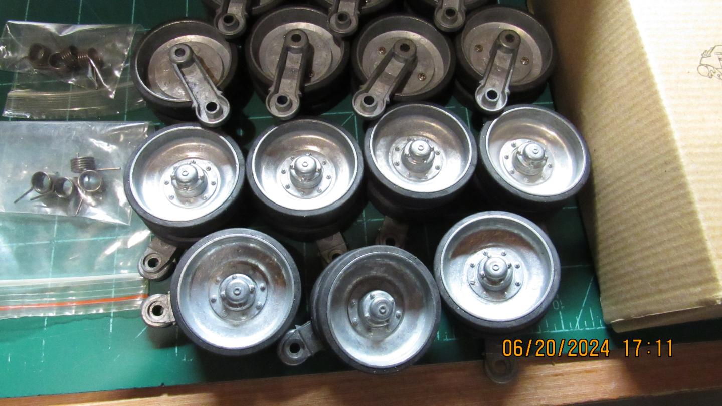

                The Torro metal road wheels set for the Heng Long German Leopard 2A6 comes with 14 pieces of assembled arm and wheel and 8 pieces of coil springs. Heng Long use stronger coil springs for the 2 front and 2 aft wheels which I suspect are the new coil springs meant for. The question is whether I keep the HL middle coil springs or move the stronger HL coil springs there. The road wheel rotates smoothly on the arm axle with no loose play. In that sense, it is much better than the Heng Long arms on the HL IDF Merkava.
                My first job is to paint the wheels. I remove the outer rubber tires to do the painting. I plan to use 3 coats of spray paint tonight. Installing the wheels will be simple and quick.
                Click image for larger version  Name:	IMG_5353.jpg Views:	0 Size:	148.0 KB ID:	405435 Click image for larger version  Name:	IMG_5349.jpg Views:	0 Size:	141.8 KB ID:	405431 Click image for larger version  Name:	IMG_5350.jpg Views:	0 Size:	151.4 KB ID:	405433 Click image for larger version  Name:	IMG_5351.jpg Views:	0 Size:	129.7 KB ID:	405432 Click image for larger version  Name:	IMG_5352.jpg Views:	0 Size:	129.9 KB ID:	405434

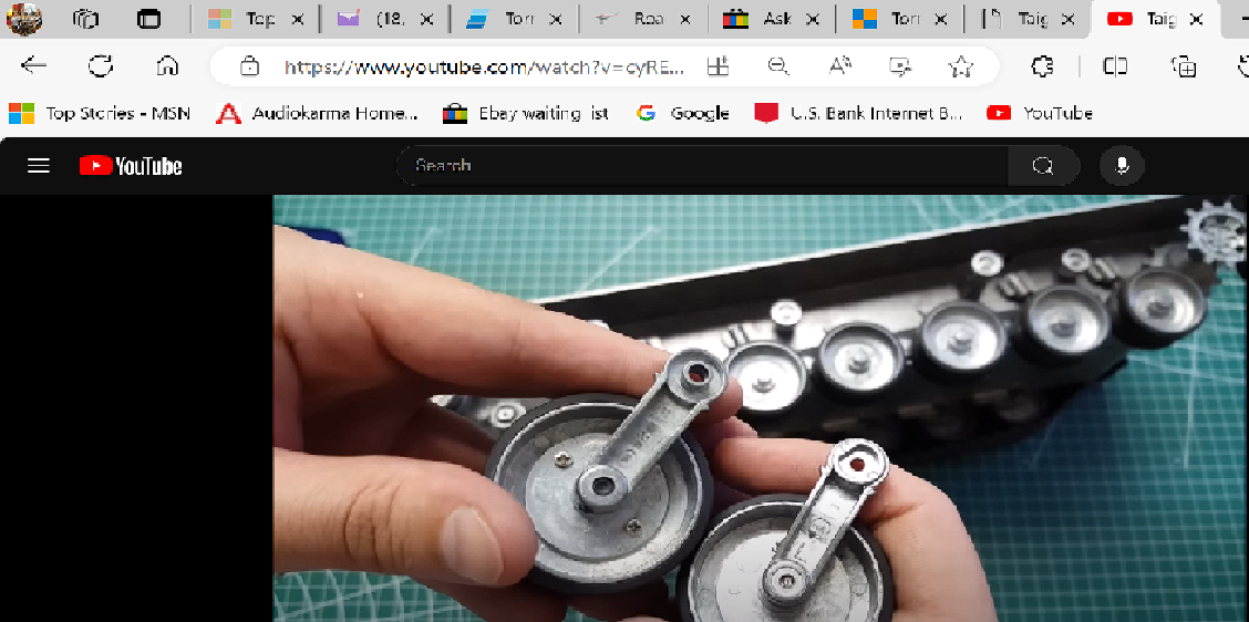

                  Torro does not provide any instruction on installing the metal road wheel. I found a metal road wheel upgrade for the Heng Long kit in German with English caption. It is applicable to the Torro kit.
                  Google or YouTube search are difficult because they do not understand the term "road wheel" or "coil spring".

                      The unboxing is uneventful. The package was delivered in very good condition. The tank works directly out of the box. No hicap whatsoever. I have only one pack of 2S 18650 LiIon. I tested it at 2300 mAh which should give decent run time. The 2S 26650 packs are too big for the Merkava battery compartment. When I first took
                      There is a little story on how I found the Torro metal road wheel kit for HL that I am using. I first saw this kit at the Taigen website and found the price high. While doing price shopping, I found the same kit at motionRC.com for $40 less. The picture showed the same Heng Long suspension arms, but no other description about being for Heng Long. In fact, the motionRC support answered several questions about whether the kit can fit HL. They specifically discouraged potential buyer from buying it for HL chassis. I know that Torro does not make plastic chassis and the kit must be for HL chassis only. I took a chance and disregard what motionRC support said. I won.
                      One problem with this Torro kit: It does not include any metal return roller!

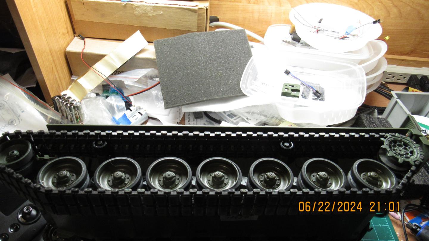

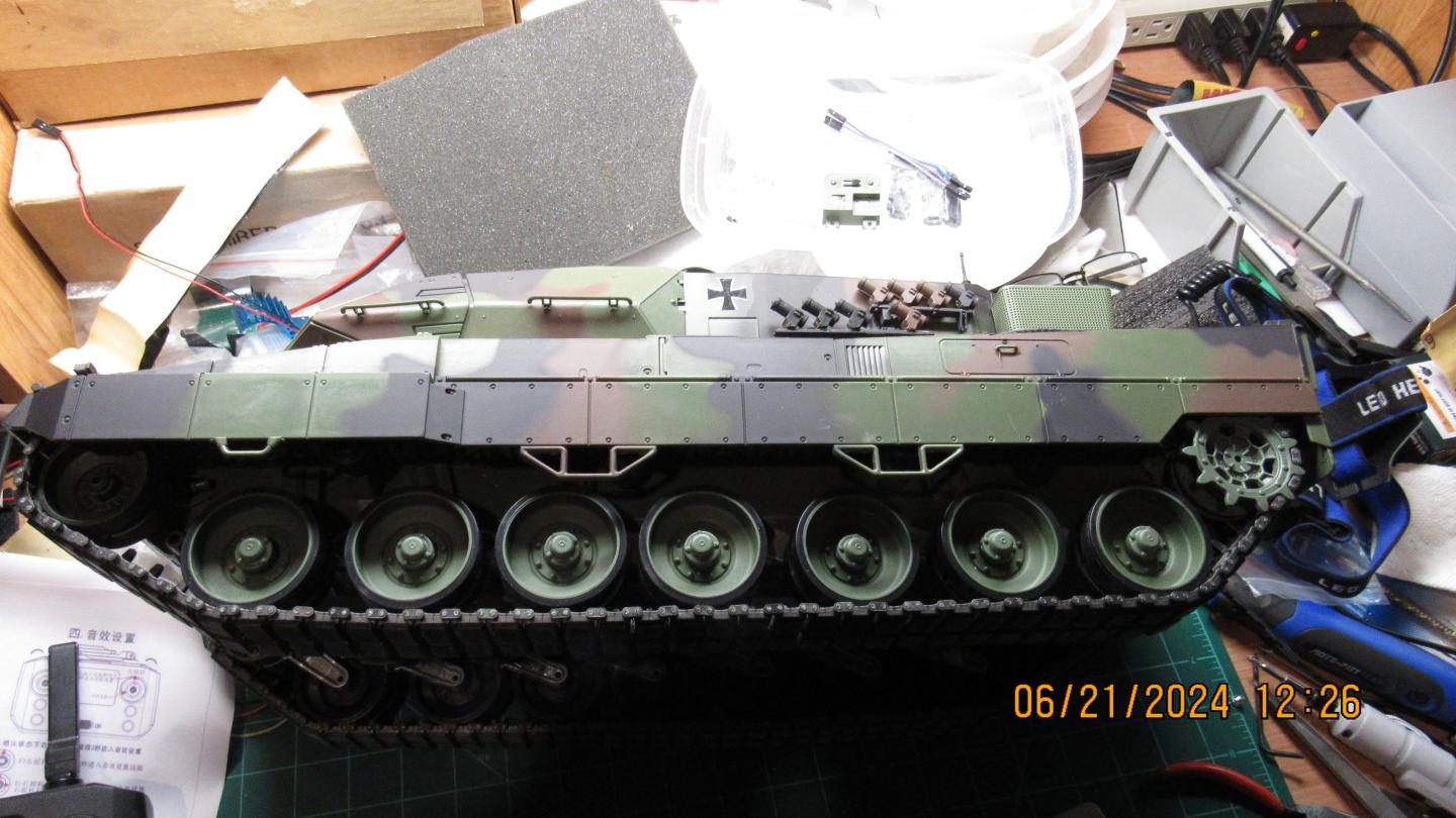

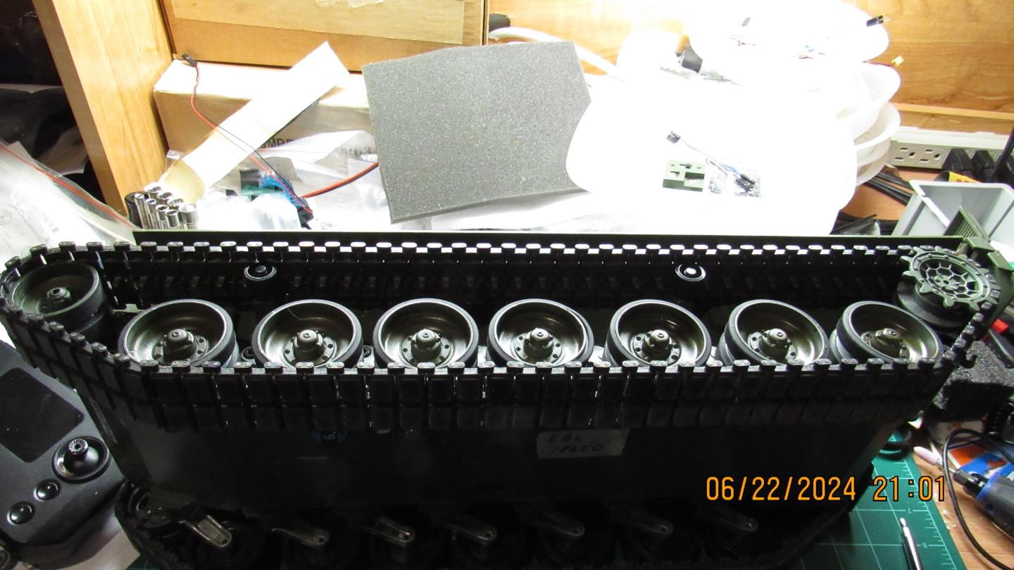

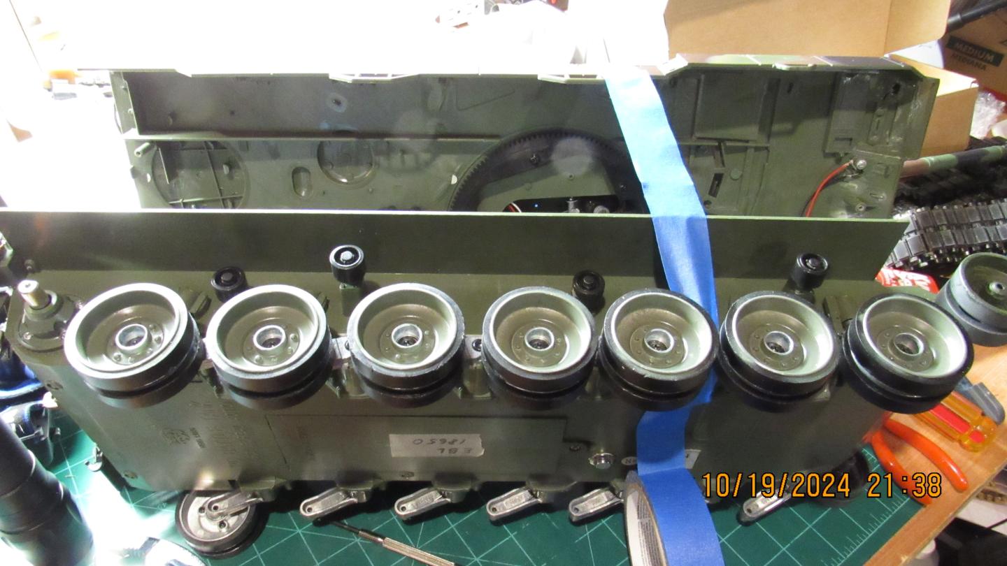

                        The Leo2A6 is the third tank that I did metal road wheel upgrade and is the first upgrade with coil spring suspension. (Previous upgrade on Tongde M60A1 and HL IDF Merkava were torsion arm suspension.) The Torro metal road wheel kit comes with the suspension arm and road wheel pre-assembled. I have to re-install the coil spring on 14 road wheels. It is not difficult, but a little trickier than doing the torsion arm suspension. The YouTube video I linked in Post #9 is very helpful.
                        I spent half a day on the left road wheels. Check and double check everything. The right side took less than one hour. I must remove the sprocket and idler wheel for the coil spring to install properly. This is the first time I regret using the Mato idler instead of the HL idler. I have both metal parts and the HL is much simplier.
                        The road wheels were spray painted 3 layers of Krylon COLORmaxx Satin Italian Olive​. (For better adhesion to metal surface.) The Italian olive is a very good match for WW2 tanks. It is a little too green for modern MBT. I brush paint a layer of Tamiya XF-62 Olive Drab on top.

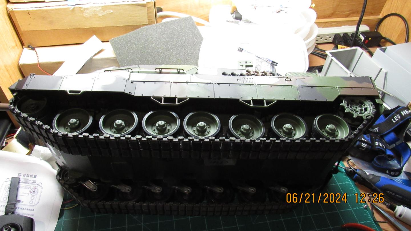

                        The original plastic road wheels.
                        Click image for larger version  Name:	IMG_5355.jpg Views:	0 Size:	139.3 KB ID:	405646 Click image for larger version  Name:	IMG_5354.jpg Views:	0 Size:	150.6 KB ID:	405647
                        The Torro metal road wheels. There is very little visible difference.
                        Click image for larger version  Name:	IMG_5359.jpg Views:	0 Size:	150.7 KB ID:	405649 Click image for larger version  Name:	IMG_5360.jpg Views:	0 Size:	141.9 KB ID:	405648

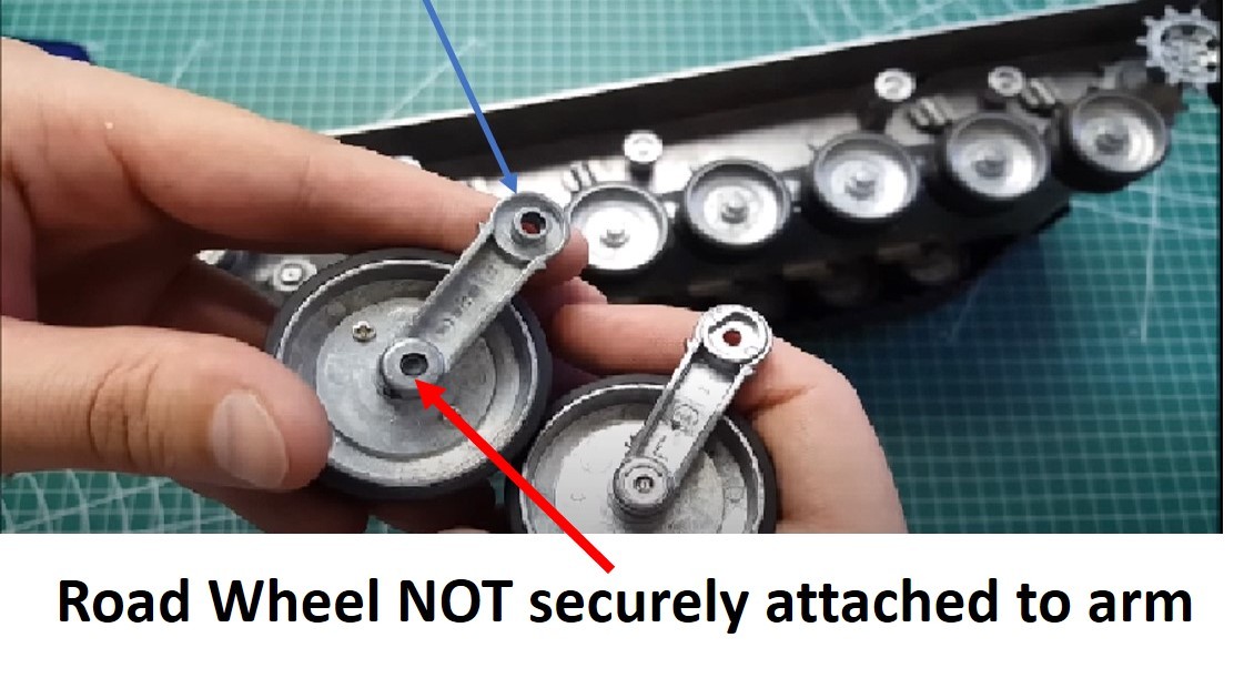

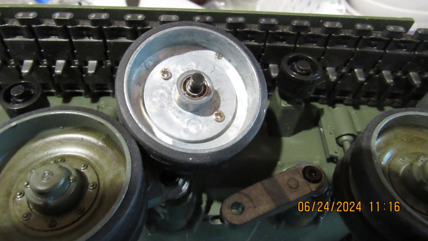

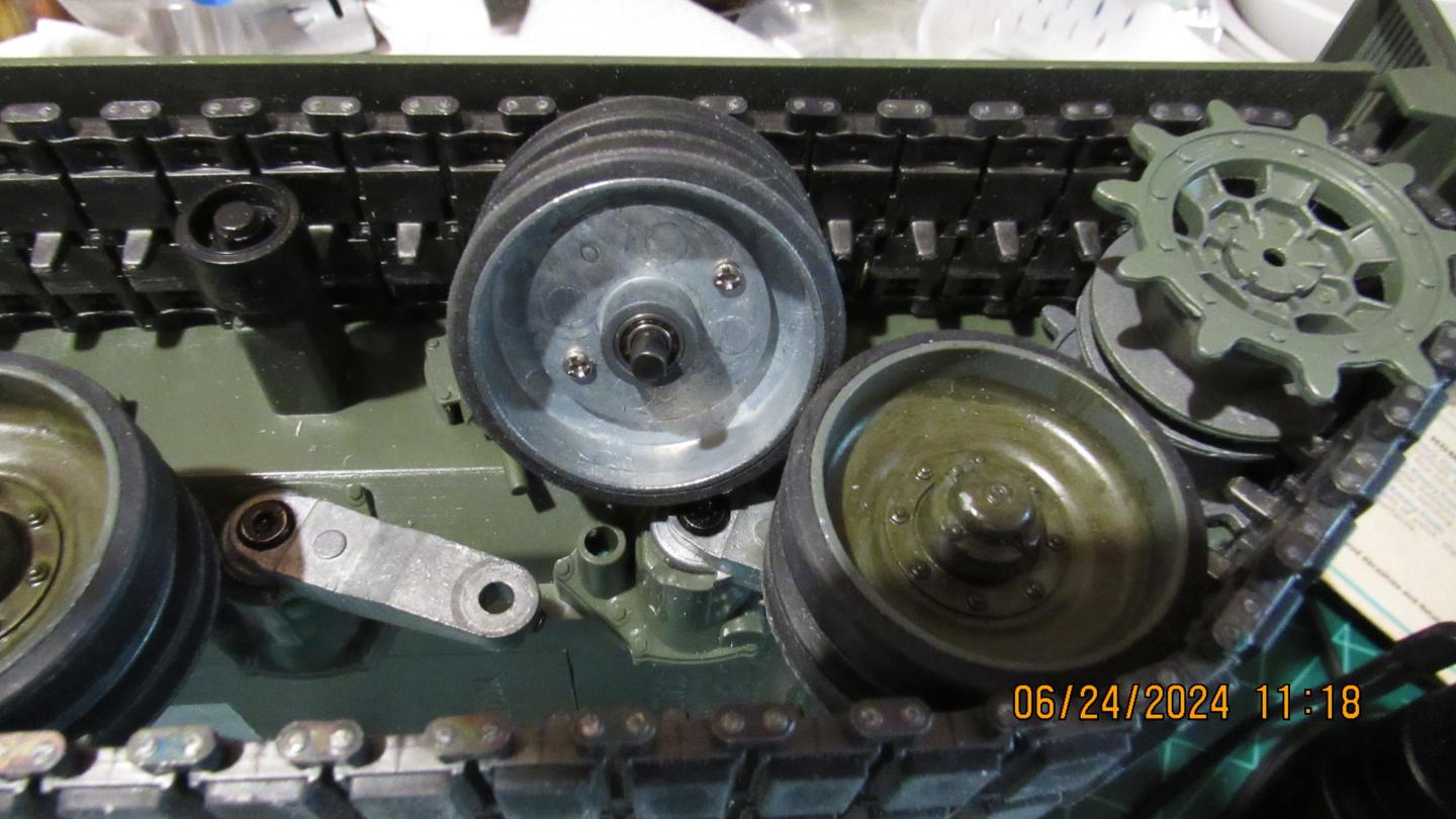

                          I lost big time. The Torro road wheel set is very poor quality. The axle of 2 road wheel fell off the arm in less than 2 minutes of running. The wheel axle seems too small for the hole on the arm.
                          Click image for larger version  Name:	Torro_metal_roadwheel-2.jpg Views:	0 Size:	135.6 KB ID:	405691
                          The axle seems to have lubricant on it so I am not sure if any CA glue or similar will work.

                          motionRC support is right. This Torro road wheel kit will not work on any RC tank, let alone the HL Leo2A6.

                            That strange that Torro (or whoever made these for Torro) didn't do like they normally do which is drill the arm, tap it, install a grub screw, create a small flat on the wheel axle, and tighten the grub screw. If it's just press fit, that's dumb. The Taigen/Torro T34/85 wheels attach as I just described. Just not sure why they wouldn't be done the same way from the same company.
                            • #15
                              It is a huge disappointment, but not surprising. Torro might have assigned the design of this upgrade road wheel kit to a junior engineer who has no experience. The road wheel axle is a very hard steel rod of 3.85mm. You can pressure press steel to steel or brass. But pressure press steel rod to soft nickel alloy as Torro did is going to fail terribly. I expect the axle steel rod to be screwed onto the arm and was surprised that it was not.
                              The picture that I post at #13 was captured from Taigentanks.com. The Torro arm for Torro tank has a very different road wheel attachment.

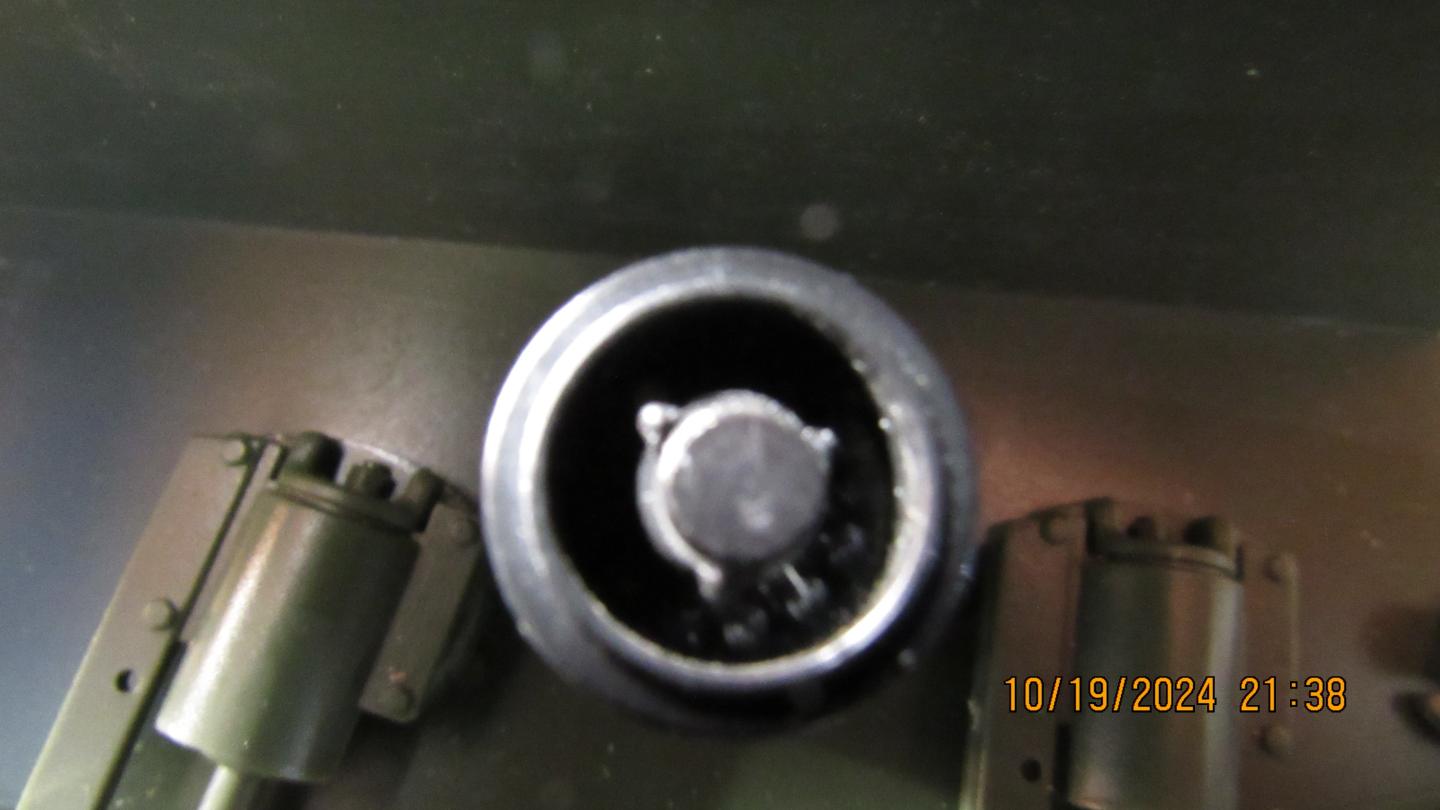

                                        I cannot figure out how the plastic return rollers were attached to the chassis. While I can remove the return roller's screw using an extractor tool. But it will ruin the screws and the road wheel kit do not come with any hardware.
                                        Click image for larger version  Name:	IMG_5384.jpg Views:	0 Size:	75.3 KB ID:	412383
