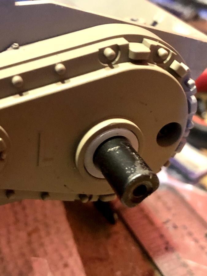

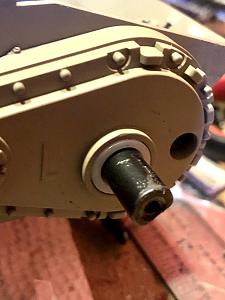

      I had a machist make new longer shafts for my okmo DKlM m60a3 I built 6 years ago. First I had screwed extensions to my shafts, soldered them on and then turned in a lathe and it worked ok until the new shafts were made for me.
      • keilau
        • Mar 2021
        • 1844
        • Windy City
        #83

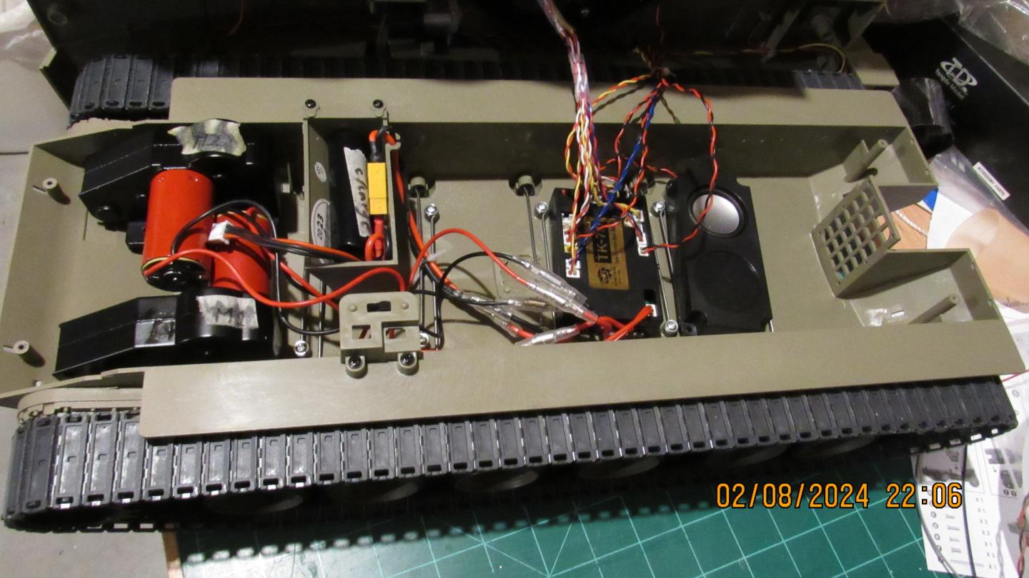

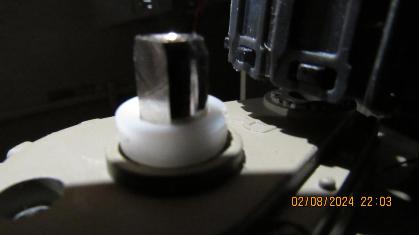

        The 2 nylon rings give me the right amount of extension for the motor shaft. I changed the M3 mounting screw from 8mm to 12mm for the sprocket. With these mod, the HL Merkava with Hooben track is running very well indoor. When the weather gets warmer and the ground drier, I will take the Merkava outdoor.
        I do not have access to a machinist so getting a longer motor shaft is out of the question. There are standard length motor shaft for sale on e-bay.

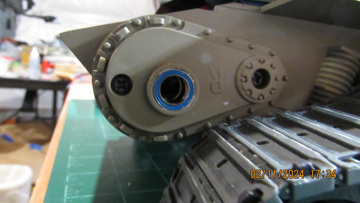

                The first stage of the Hooben track and sprocket modifications took 3 days to complete (Post #79). The Hooben track is a tangible improvement over the Heng Long plastic track. The Hooben track runs steadily, but the amount of micro vibration is more than the Heng Long German Leopard 2A6 with similar gearbox.

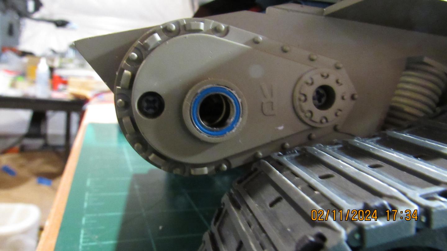

                After some investigation, I determined that the Merkava can be improved by a motor shaft ball bearing kit. HL put a nylon ring around the motor shaft. But it keeps falling out. I try to use RTV to fix the ring in place, but it did not work.
                Click image for larger version  Name:	IMG_5289.jpg Views:	0 Size:	62.0 KB ID:	397080
                HL does not have a motor shaft bearing kit for the Merkava yet. I order a set of 8x12x3.5mm ball bearings from Amazon.
                Get care and request prescriptions from an online or in-person doctor. Now offering ongoing primary care and 24/7 telehealth.
                It is a tight pressure fit to the motor shaft. I drilled a 3/8" hole on a 3/4" plywood to push the bearings in using a C-clamp. The bearings stay in place because of the tight fit. The Merkava now runs even smoother. The Merkava and the Leopard are the 2 best running HL RC tank in my small collection.

                I changed the sprocket M3 machine mounting screws from 10mm to 12mm. It makes no difference to the sprocket mounting. It is just a feel good mod.

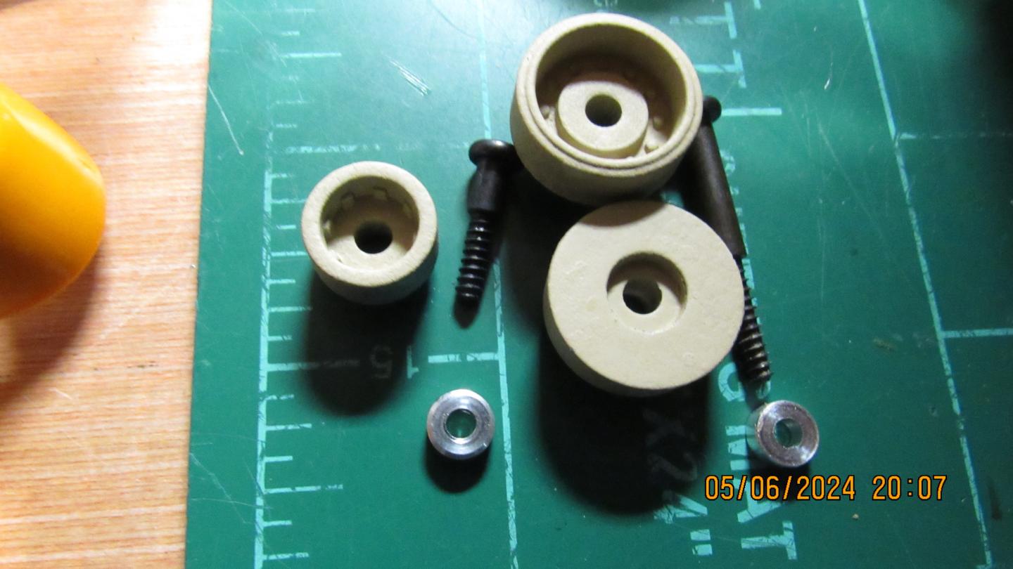

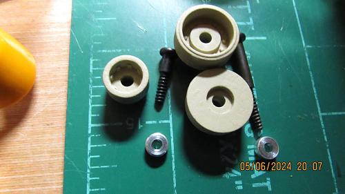

                              The IDF Merkava metal road wheel kit (3958 Tanks Parts TH23641) that I purchased from Heng Long RC Store on AliExpress DOES NOT work. The kit is only half of the problem. The Heng Long 3958-1 IDF Merkava Mk4 RTR tank from Toucan Hobby Store (TH22634-QC-DZN1) was not designed to work with metal road wheels.
                              1. I expect that the ball bearing ID to be pressure fit to the swing arm and the OD to pressure fit to the road wheel pockets. They are not. They are both very loose. In another word, the ball bearings are used as loose bushings.
                              2. I expect HL to use machine screw to mount the road wheels to the metal swing arms of the torsion bar suspension. HL used self-taping screw instead.
                              3. I cannot remove the screws to remove the return rollers. The screws just keep turning. Not sure how they are fixed to what.
                              I will like to hear from others who tried the metal road wheel upgrade on the IDF Merkava. Are other HL tank and road wheel kit similar?
                              I painted the road wheel kit pieces this morning. I guess I will have to write off the loss.

                                    1. I cannot remove the screws to remove the return rollers. The screws just keep turning. Not sure how they are fixed to what.
                                    Lesson I learned: I must use the correct tool to turn a screw.
                                    I tried many times to turn the return roller with a Philips screw driver. The return rollers are mounted on a hex head screw. I kept trying for 2 days without looking. Once I realized my mistake, the screws came off easily.

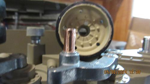

                                      30mil sticky copper foil on road wheel axle:​

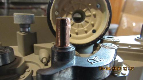

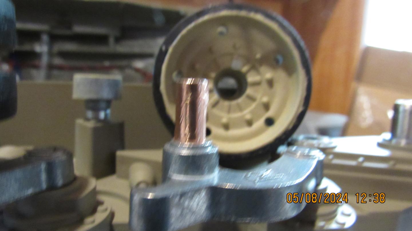

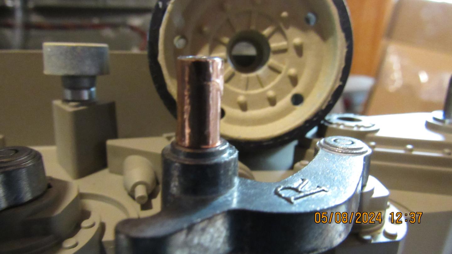

                                        The tip from Max-U52 works wonderfully. The road wheel bearings are standard 5mm ID ball bearings which needs a 5.03mm axle to fit properly. The HL suspension arm axle has a 4.85mm diameter for the plastic road wheel. The metal road wheel should come with its own suspension arms, but they did not. I found some spare suspension arms on AliExpress, but they are the same 4.85mm OD.
                                        I get a roll of 30mil (0.003mm) brass foil. I tried various number of layers. I ended up cutting 2mmx1mm pieces of sticky foil. Remove the backing and wrap the foil around the suspension arm axle. I get the slight pressure fit that I am looking for. The fit is very secure.
                                        Click image for larger version  Name:	IMG_5327.jpg Views:	0 Size:	99.5 KB ID:	403193
