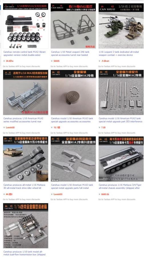

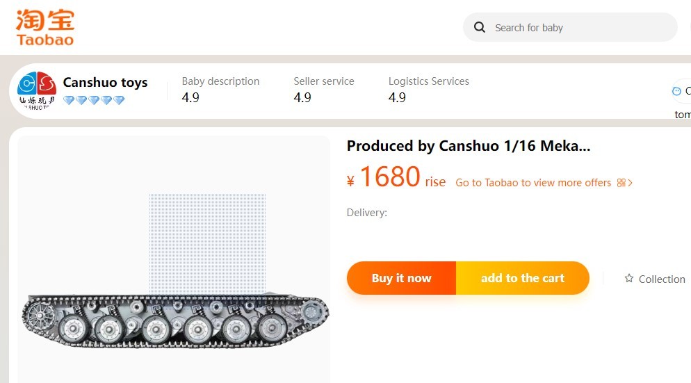

                                      Since this is just a general HL Merkava post, the folks on Inkor's Discord server pointed out there might be a new metal Merkava chassis from Canshuo and it ​​seems to have the proper spring suspension:
                                      Click image for larger version  Name:	Screenshot 2024-01-06 040153.jpg Views:	0 Size:	81.7 KB ID:	394205
                                      After looking at all the things on the Taobao site for Canshuo, I realized that all those new metal parts for the Abrams and such were made by them. The parts bags have CSxxxx on them...assuming for "Canshuo". The gearbox at the bottom looked interesting.
                                      Click image for larger version  Name:	Screenshot 2024-01-06 040815.jpg Views:	0 Size:	77.0 KB ID:	394206

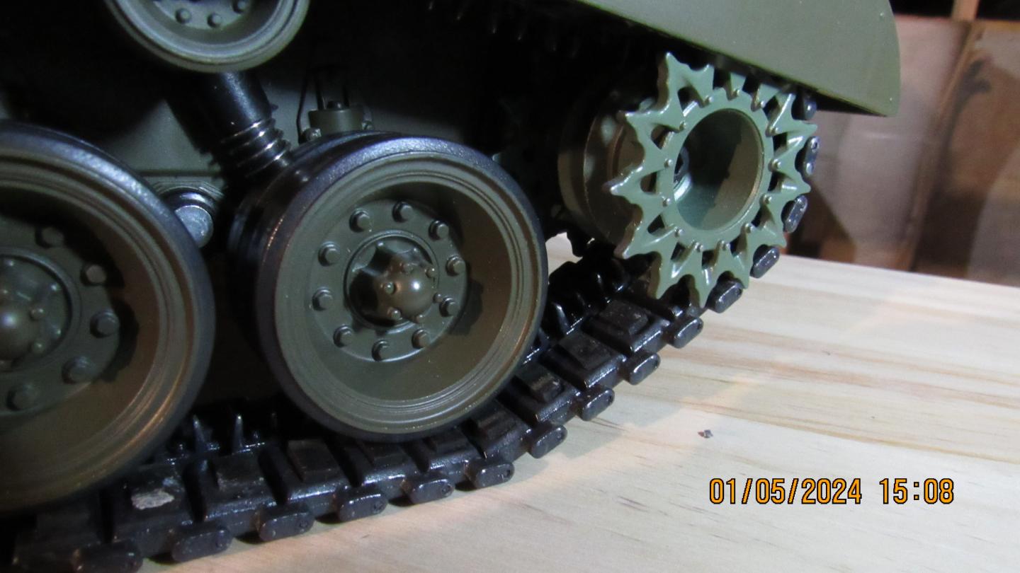

                                        I could've made the HL Leopard 1A6 sprocket fit my Hooben gearbox....issue was the sprocket was too wide to fit under the track skirts. The shaft can be easily shortened, but the threads on the end for the screw holding on the sprocket are usually not that deep. Shortening the shaft usually means the hole has to be drilled deeper and tapped.
                                        The Heng Long gearbox motor shaft uses M3 machine screws 8mm long. I replace them with 12mm M3 socket head for better attachment.
                                        The Taigen/Torro gearbox motor shaft uses M3.5 machine screws. I have to drill a larger hole on the HL sprocket to accommodate the M3.5. Otherwise, the HL metal sprocket fits perfectly on the Taigen/Torro Version2 gearbox. I have only a sample of one for this compatibility.
