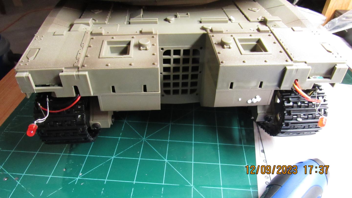

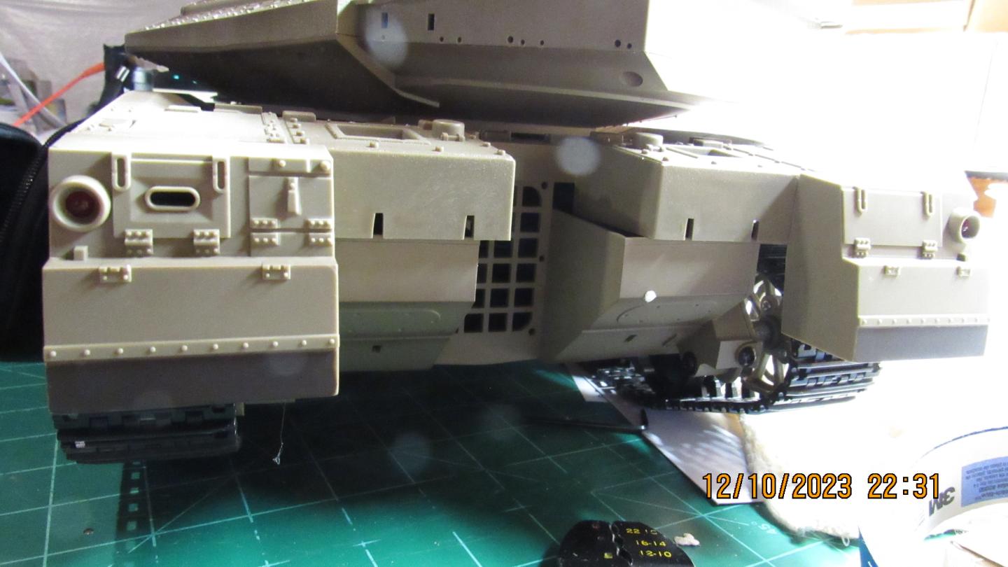

    When I first took the Merkava out of its foam packing, I was dismayed to see the tail light boxes missing and the red LED were hanging loosely. The soldering of the LED's looks unprofesssionally done. I corrected the problem and put some insulation around the bare wires. There is no mention of installing the tail light boxes in the instruction manual.
    When I tried to put on the tail light boxes, but couldn't. It became obvious why the factory did not install the boxes. They were molded incorrectly in the 3958-1 version Merkava. The mistake was minor and easily corrected by some cutting and gridding. Once the excessive ridge was cut out, the box slides in easily and securely.

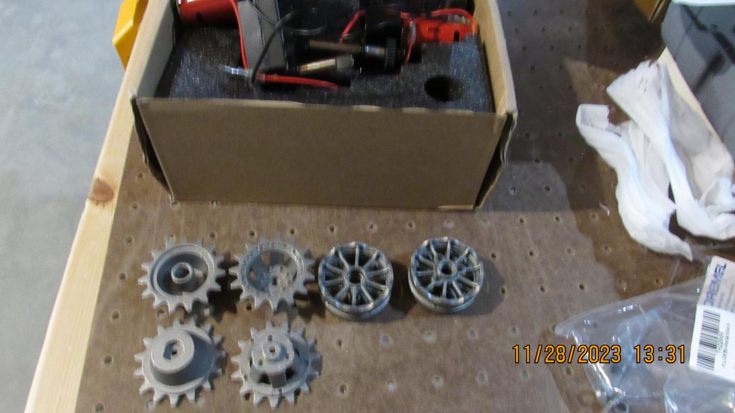

      The Merkava is a large MBT, making the metal upgrade very easy. The extra space allows the Heng Xin gearbox to drop into position easily. The metal sprocket is an easy drop-in replacement.
      The plastic idler wheel has a brass insert. The brass to nickel alloy sleeve makes smooth rotation. The 2 ball bearings of the metal idler makes it even smoother.
      No bearing are needed in the suspension. They are nice to have in the wheels though for longevity.
      To my disappointment, there is no provision to add bearings to the plastic road wheels. It is plastic sleeve over metal spindle, not a good combination. If you want bearings on road wheel, you need to get the metal road wheel set.

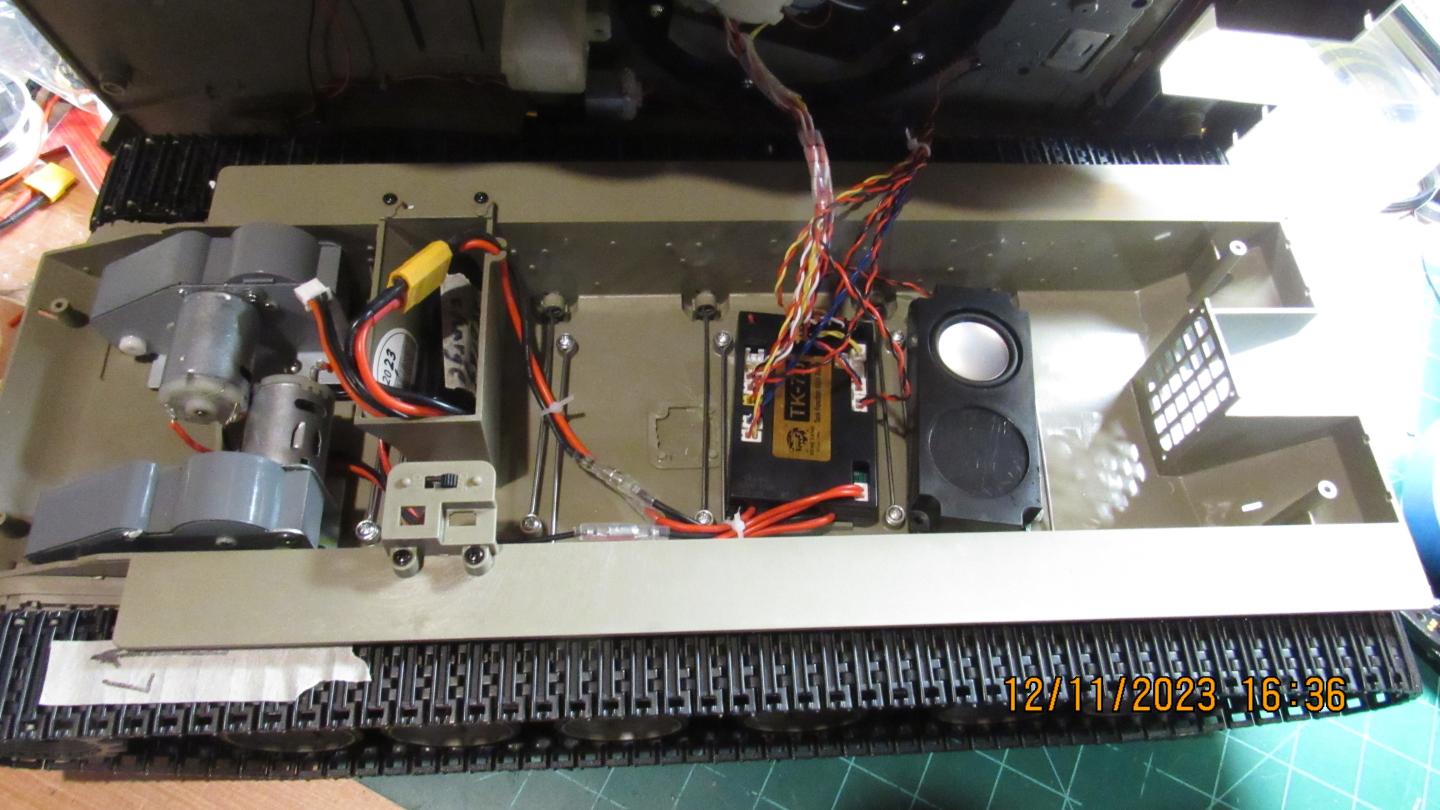

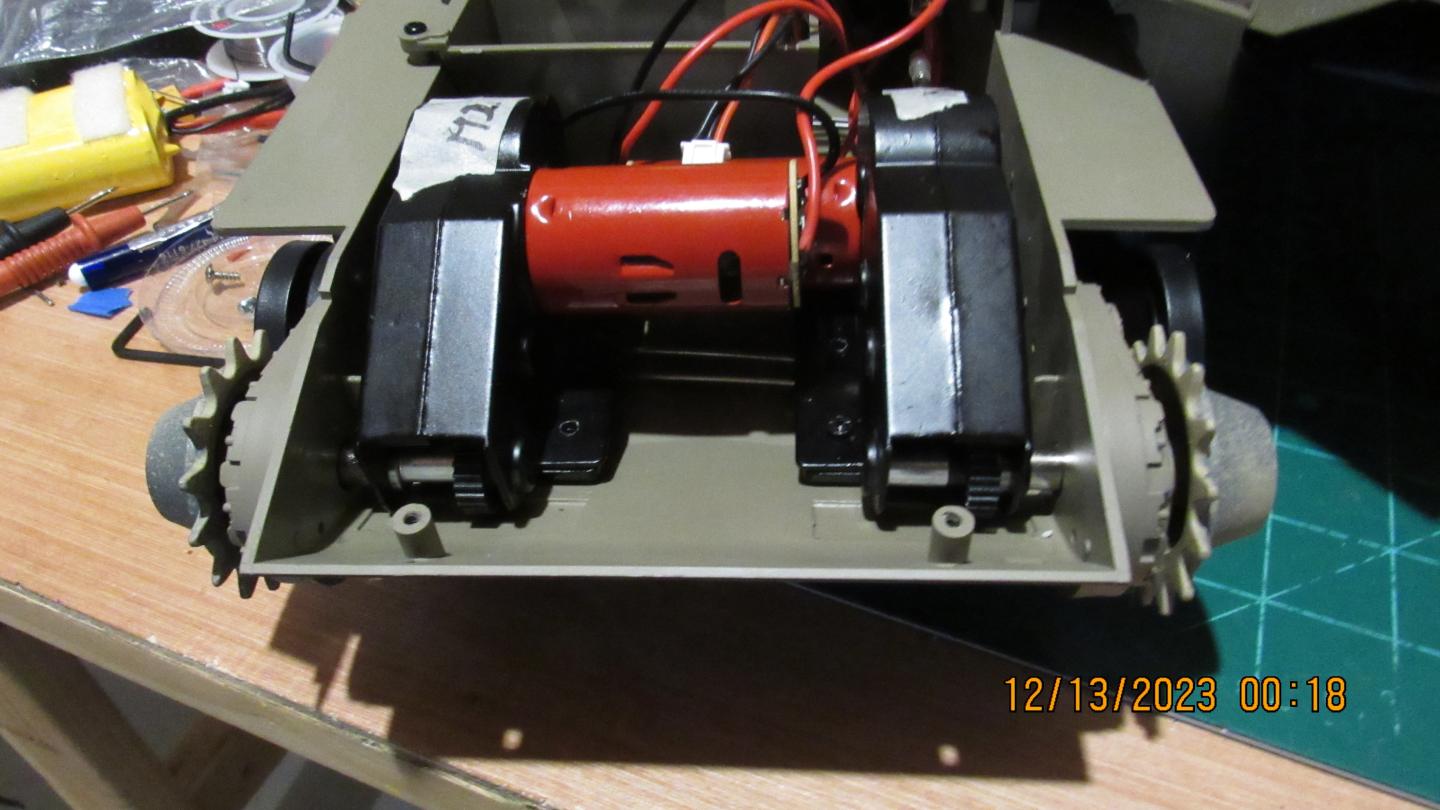

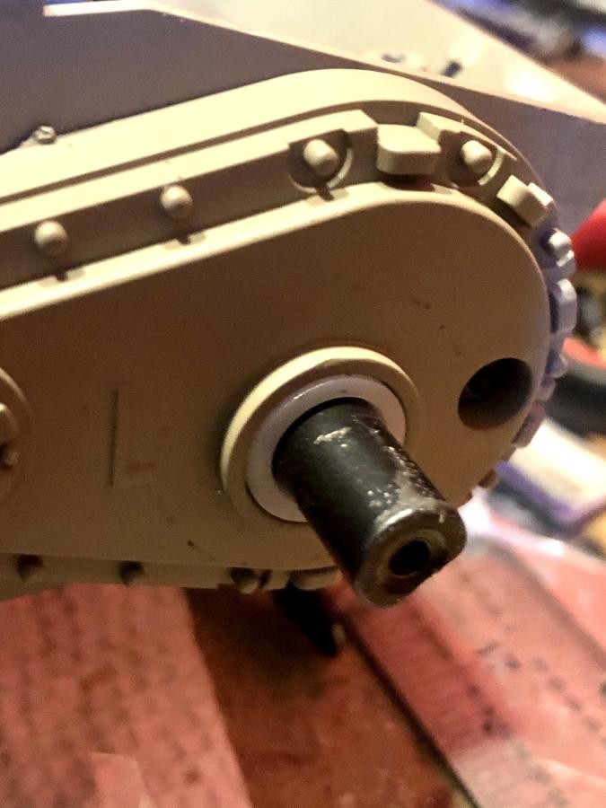

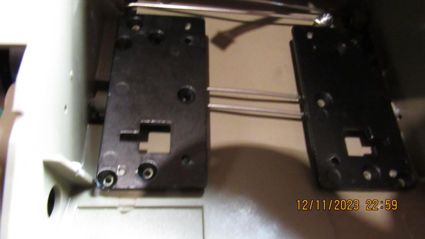

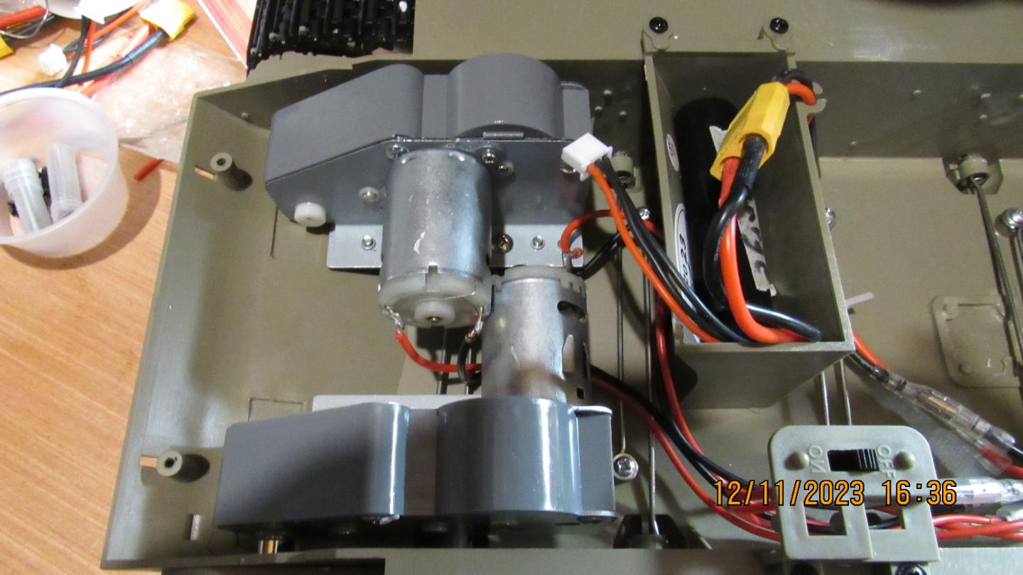

                  The HL Merkava has a very open chassis. I purchased the basic version with the plastic gearbox.
                  Click image for larger version  Name:	IMG_5265.jpg Views:	0 Size:	138.3 KB ID:	392750 Click image for larger version  Name:	IMG_5266.jpg Views:	0 Size:	124.0 KB ID:	392752

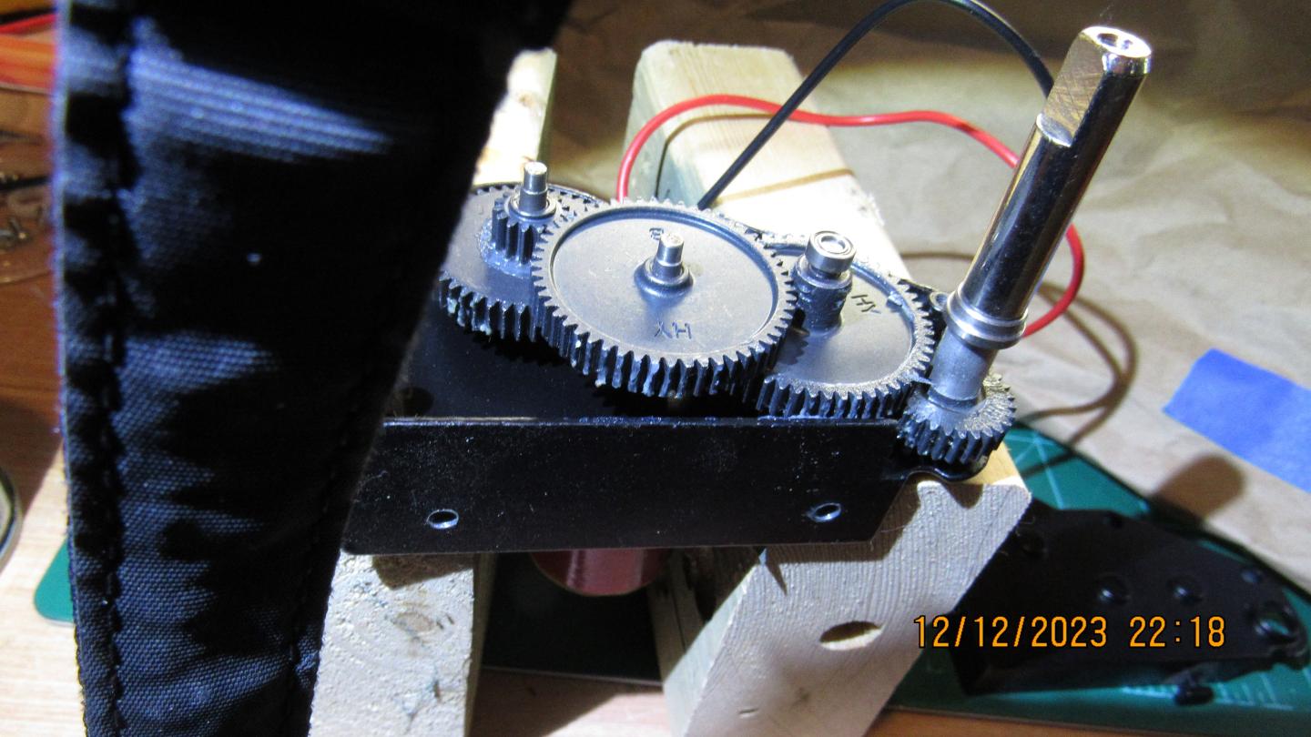

                  The Heng Xin gearbox is my favorite metal gearbox upgrade. It is smooth, quiet and feels very heavy. As in previous installation, I open the gearbox to check its lubrication. To my surprise, there is no grease inside the box. The gears look like metal powder formed and very precise. Is it dry lubricated? Without knowing for sure, I applied a small amount of Teflon lubricant to be sure.

                  With 4 screws and 2 locating pins each, the mounting plates are very accurately located. The nylon axle supports bushings provide excellent guide for the gearbox orientation. You must put the nylon bushings in place first. Insert the motor axle carefully through the bushing until the locking nut stops. Then tighten the final gearbox screw. I found the motor alignment as good as with the motor axle bearing kit. It feels wonderful.

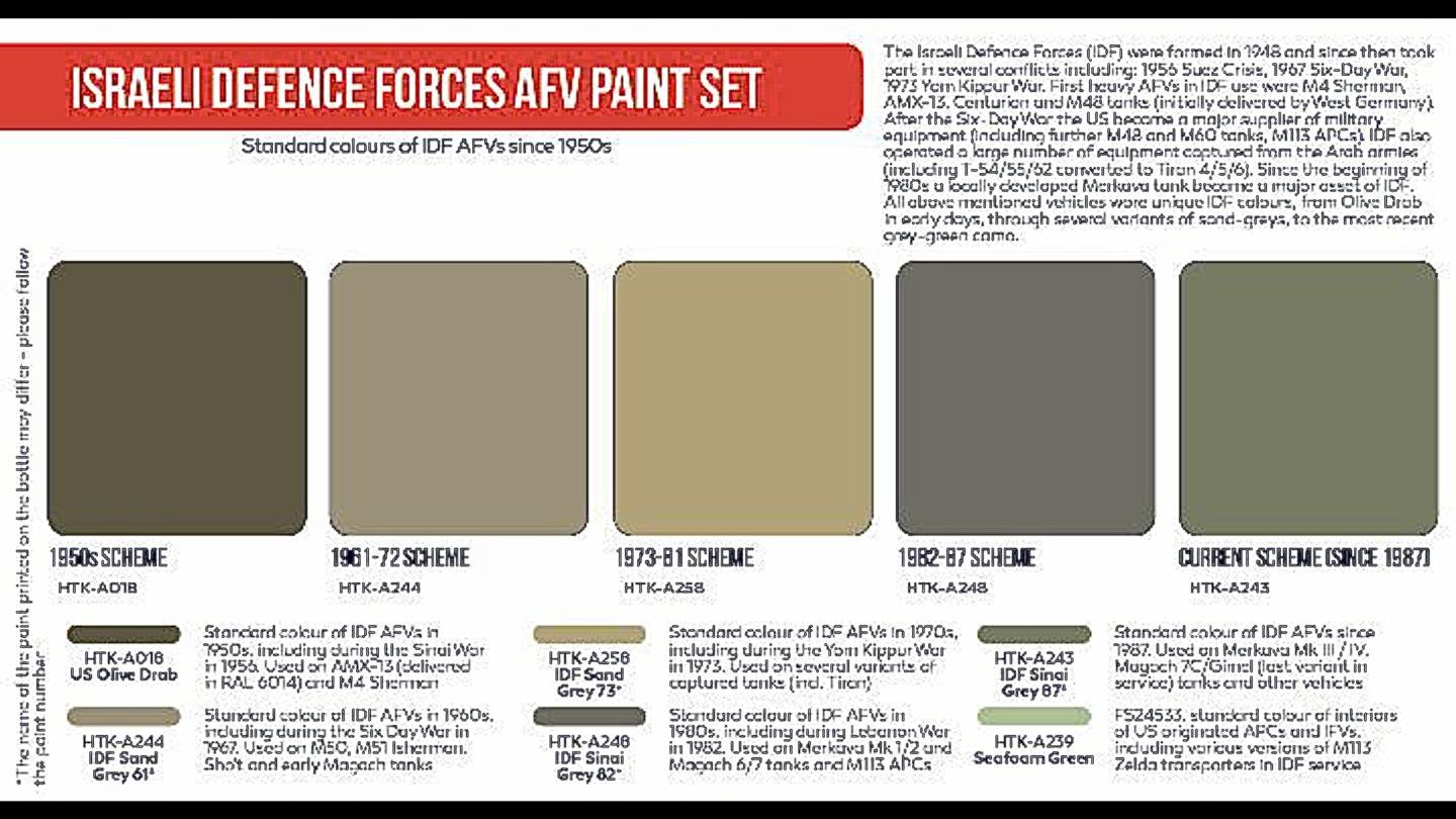

                            No definitely not. SG is the second color from right. Below is a helpful chart.
                            Funny thing is the preproduction models (show below) were finished in a more correct green color, but since the real tanks looked tan in photos HL changed to a tan color.

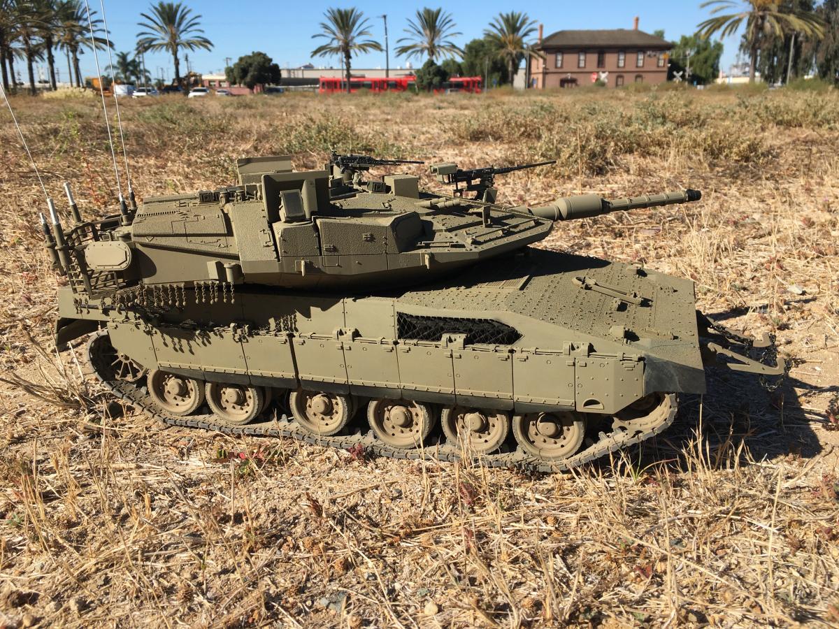

                            • RichJohnson
                              • 1301

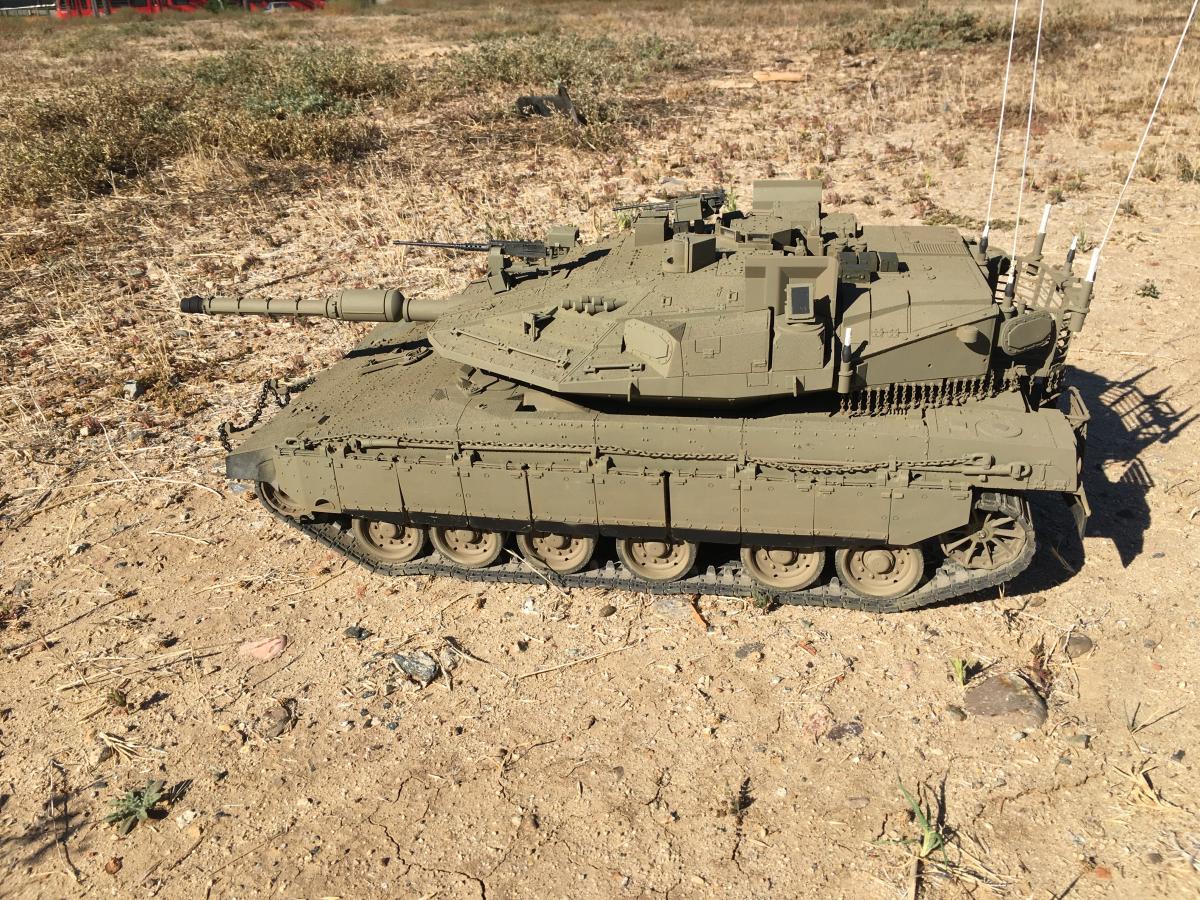

                              Merkava 4 tanks were painted a green color that the IDF used during the period they were introduced.
                              sometime around 2015 the color seems to have changed to a khaki green color.
                              one thing to note about that chart which I have and have shared as well, The dates are off a bit and in the 90s there was a dark khaki tan that was used, the green came after that, AK markets this dark tan as modern “since 1990” which only applies to the period before the green was adopted.
                              And all the colors are named siani grey since the 80s so trying to match the color for the era you want will literally drive you crazy. Rubicon can attest to my color color disphoria over this issue. I painted my hooben merk 3 times trying to get the current modern color correct.
                              I you want the early periods green a dark green is good not nato green, and then get it dirty with thick dust. I literally shoveled thin dirt in my tank after the last paint job and it looked perfect.
                              For the current color, a dark khaki mixed with 10-20% green gets you in the ballpark. Then get it dirty as there are no clean markavas lol.
                              I believe the brightness of the real merk in the photo below is a bit over saturataed which brightens the green a bit.

                                Rubicon99 and RichJohnson , thank you so much for taking the time to write the detail explanation to enlighten me. I am sure many other tankers will be helped too.
                                Where does the Vallejo IDF Sinai Grey 82 fit in the above color chart?
                                Amazon.com: Vallejo IDF Sinai Grey Model Air Paint Set : Arts, Crafts & Sewing​​
                                I believe the brightness of the real merk in the photo below is a bit over saturated which brightens the green a bit.
                                This is the simple receipt that I can easily follow.

                                  The Vallejo SG fails into the range of the second color from the right on the chart above.

                                    The Vallejo SG falls into the range of the second color from the right on the chart above.
                                    If I understand correctly, the Vallejo Sinai Grey 82 fits the color when IDF Merkava 4 was first introduced. RichJohnson receipt is for recent service color.
                                    The HL painted color on 3958 is good for nothing.

                                      Really any desert tan is a better overall look then what HL did. Whatever color you pick it will look much nicer then stock.
