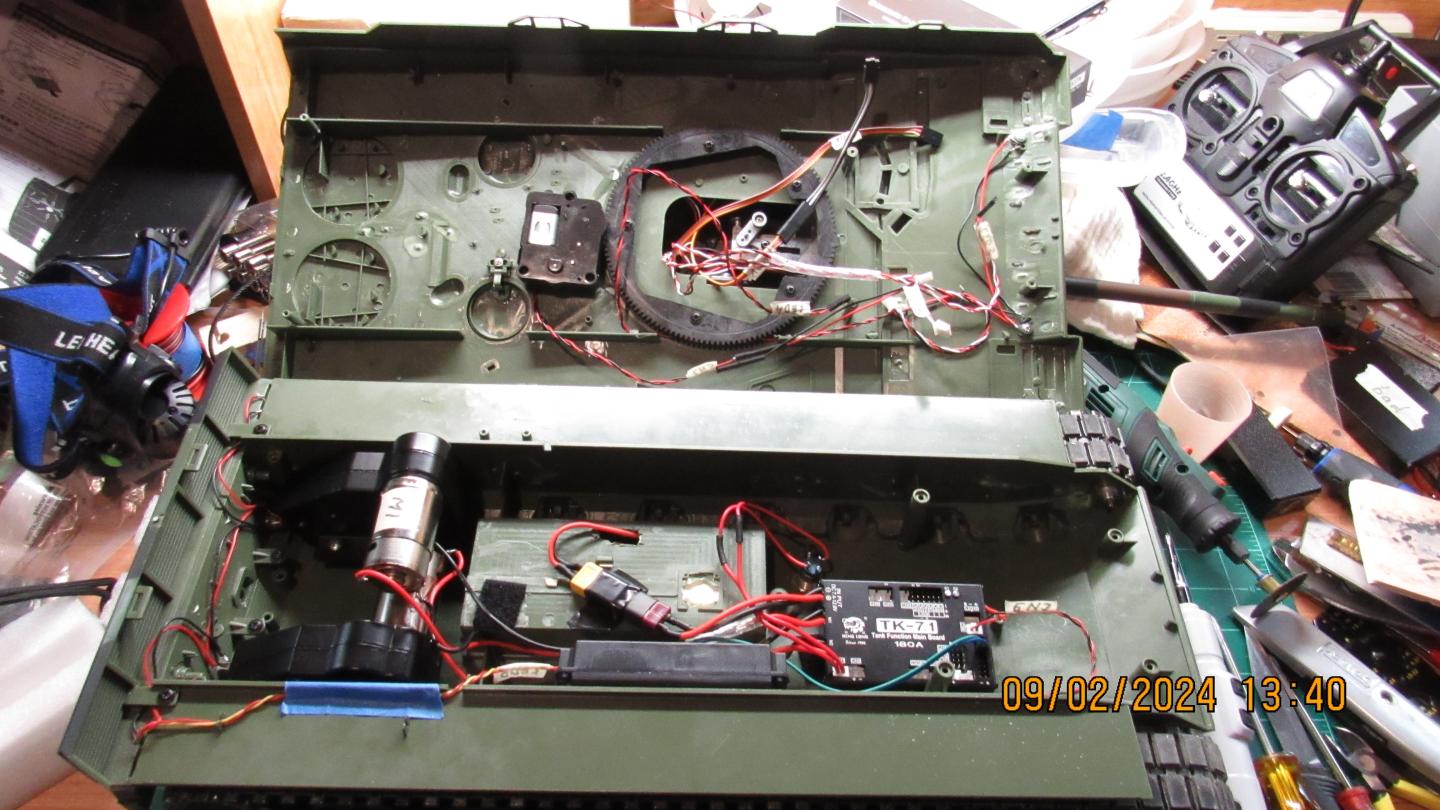

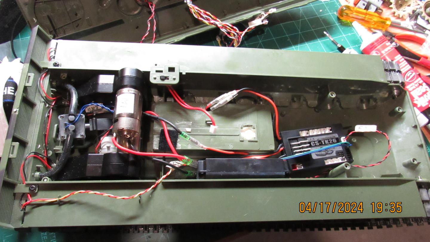

        I have been doing metal upgrades to my HL Leo2A6. Everything went well with the gearbox, track, servo barrel recoil and MFU.
        Click image for larger version  Name:	IMG_4962.jpg Views:	0 Size:	198.4 KB ID:	420489 Click image for larger version  Name:	tamiyaoriginaltrack1.jpg Views:	0 Size:	59.6 KB ID:	420488 Click image for larger version  Name:	IMG_5372.jpg Views:	0 Size:	139.2 KB ID:	420491 Click image for larger version  Name:	IMG_5371.jpg Views:	0 Size:	176.0 KB ID:	420490

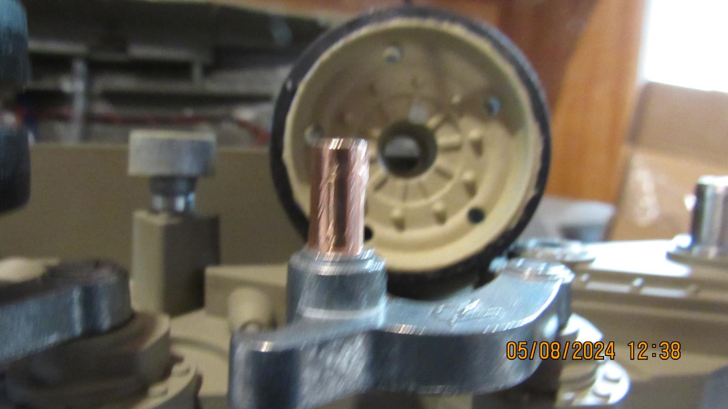

        I want to add ball bearings to the road wheels and found that the only way to do so is to switch to metal road wheels. I soon found out that the original HL coil spring is too weak. After some adjustments of the coil spring, I got it look ok statically.
        Click image for larger version  Name:	IMG_5395a.jpg Views:	0 Size:	146.0 KB ID:	420493 Click image for larger version  Name:	IMG_5396.jpg Views:	0 Size:	152.5 KB ID:	420494 Click image for larger version  Name:	IMG_5398.jpg Views:	0 Size:	142.3 KB ID:	420495
        But it does not run as smooth as I would like with all the added weight. I decide to go the all metal Torro lower chassis with torsion bar suspension.

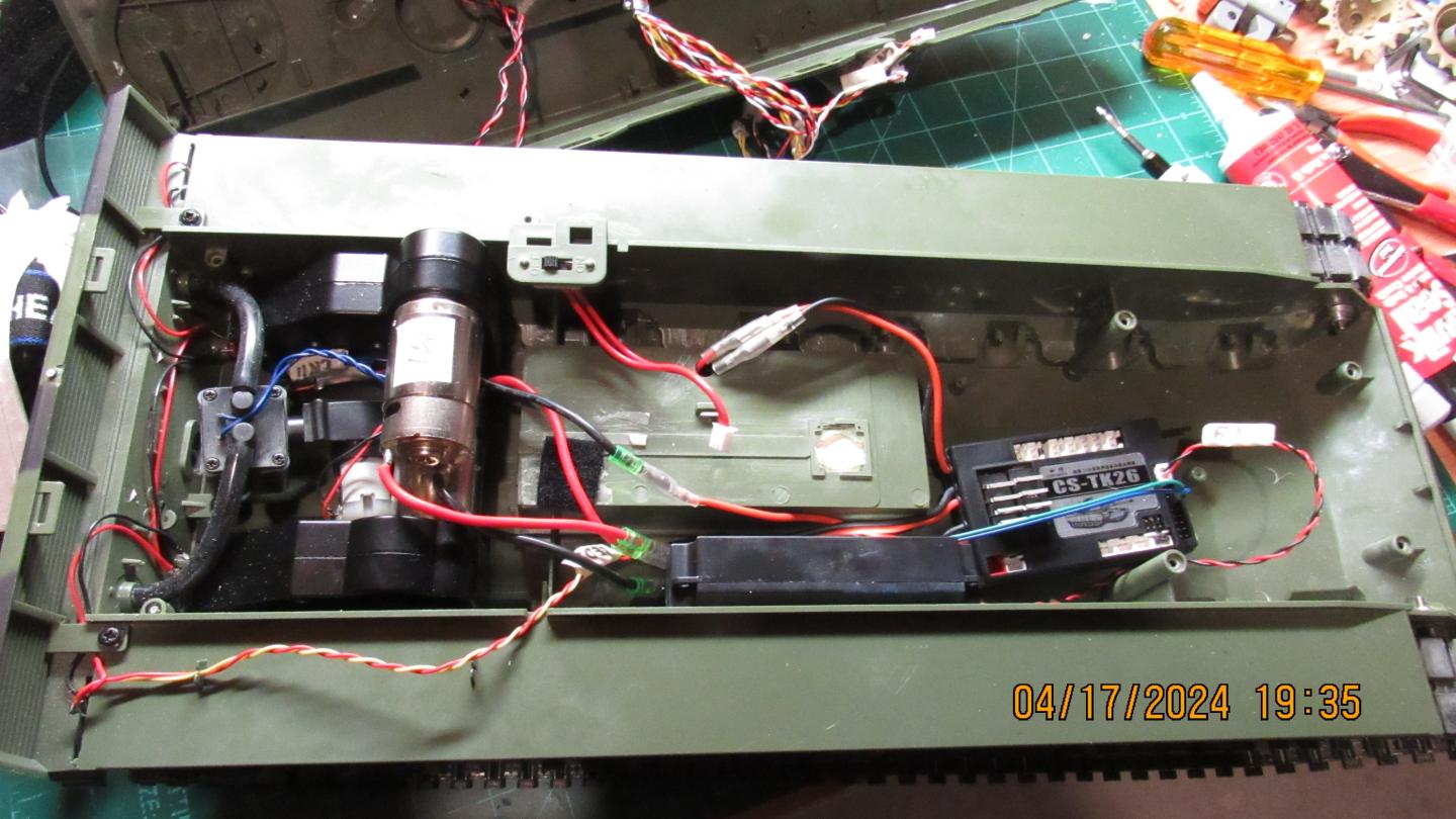

                An interim report 4 days after I received the Torro/Taigen Leo2a6 metal lower chassis. So far, it is very positive.
                I use olive green (Оlivgrün RAL 6003) as the base color. It takes care of most area except a small grey black patch on the lower front. The rear panel has lots of features that I took a few more coats to cover.
                The Heng Xin gearbox went in surprisingly easy. I put in the motor shaft ball bearings before I finally tightened the gearbox. No sanding or grinding. The alignment looks good. Final word is on how it drives.
                I use Mato sprocket and idler wheel. They both install easily as is.
                The HL upper chassis matches the Torro lower chassis very well geometrically, showing very little gap sitting in place. Finding a way to fix the 2 pieces securely is going to be a challenge. There is no pre-drilled hole to access the mounting screw sockets on the upper chassis.
                I put in the inner half of the road wheels on the left side. They rotates freely, but not as smooth as I would like. I am wondering about the quality of the ball bearings. I will explore the possibility of replacing them with Uxcell brand ball bearings tomorrow.

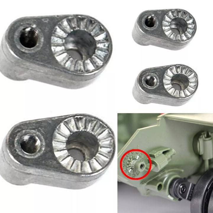

                  I broke one of the idler wheel adjusters while taking off the idler. It is careless and stupid. It will set me back many days while waiting for the replacement part.
                  Click image for larger version  Name:	idleradjuster.jpg Views:	0 Size:	85.2 KB ID:	420985

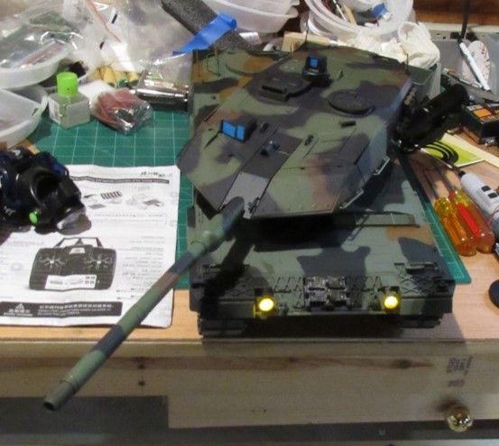

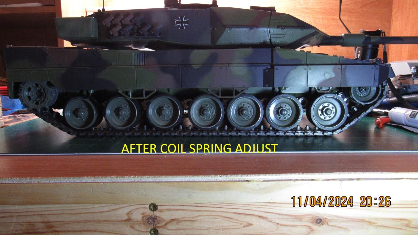

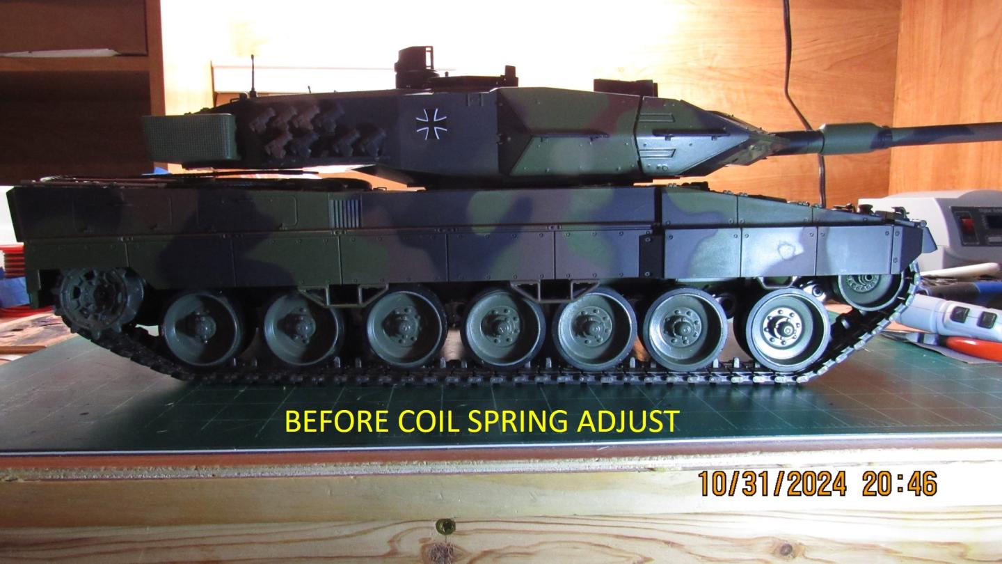

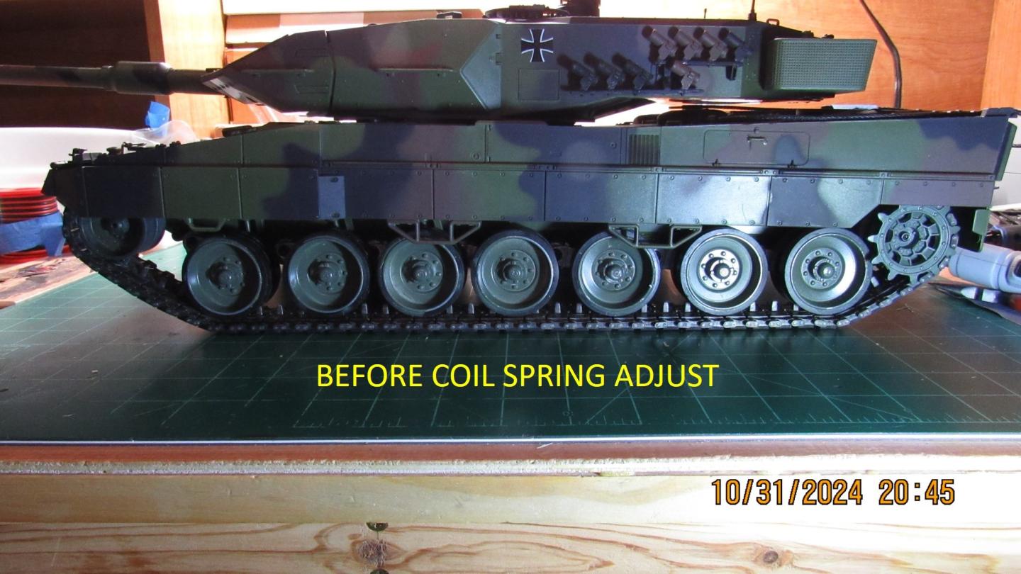

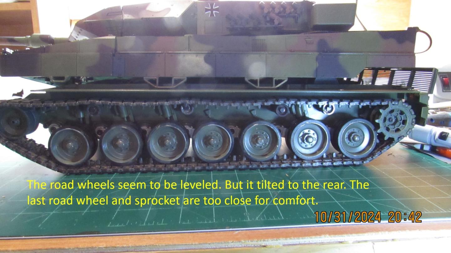

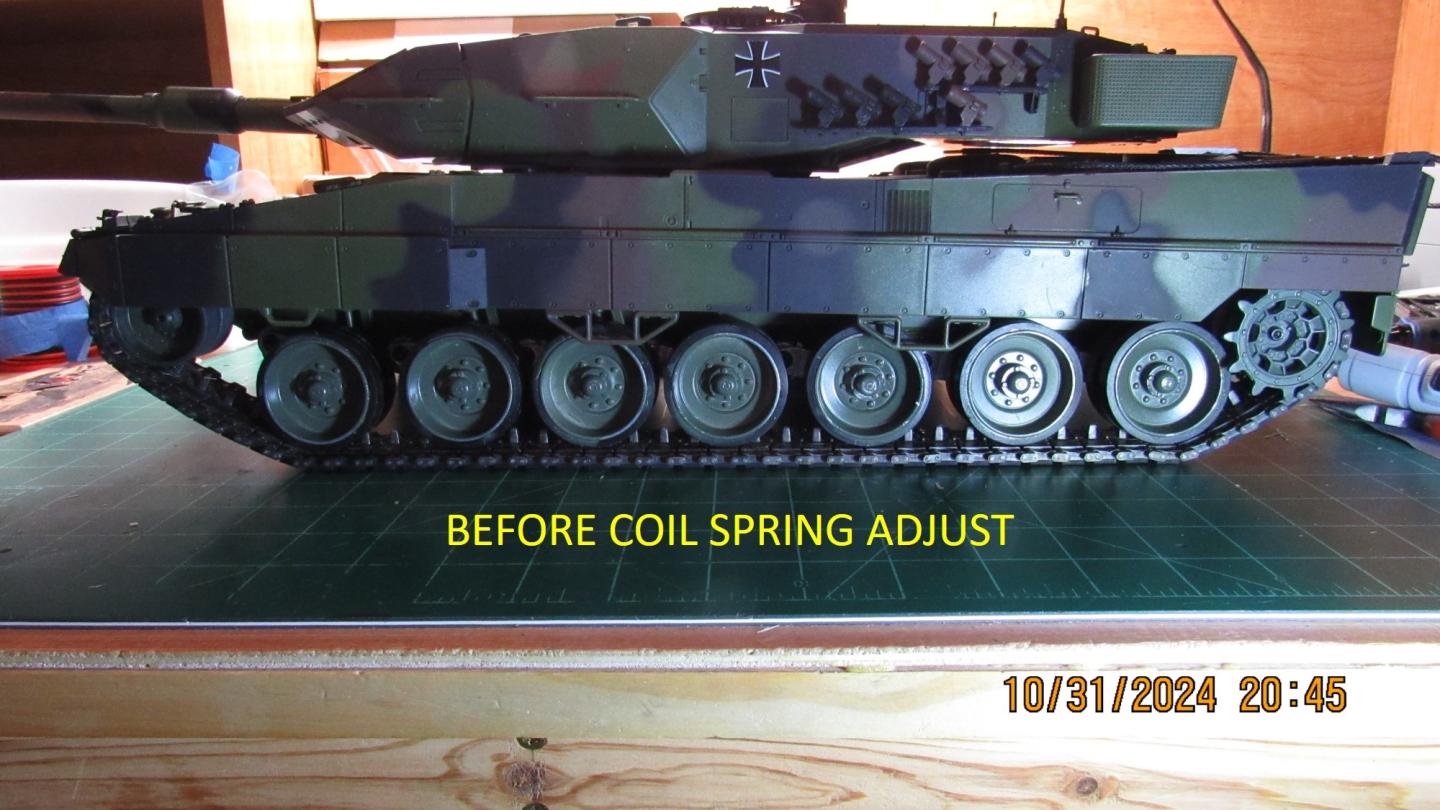

                    When I first started the Leo2a6 metal upgrade in 2022, I got both the Mato and the Heng Long idler set and used only the Mato one. After I broke one of the Mato idler adjuster, I found the Heng Long idler adjuster in my parts bin. The HL adjusters are drop in replacement for the Mato ones.
                    I installed the inner road wheel halfs on both side. The chassis looks level without adjusting the torsion bar springs. It looks good. Will continue tomorrow.

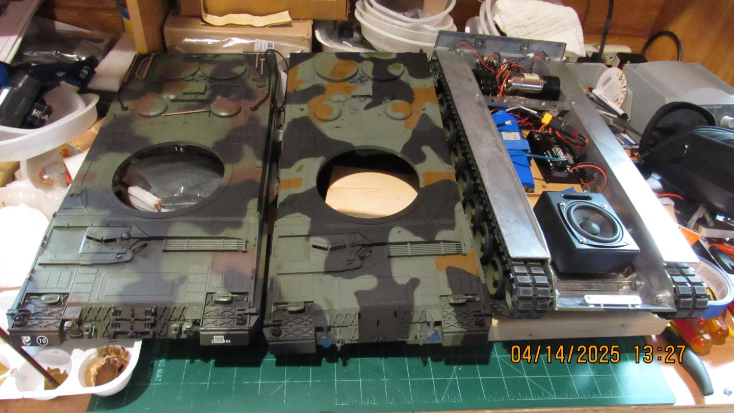

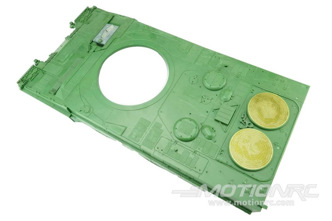

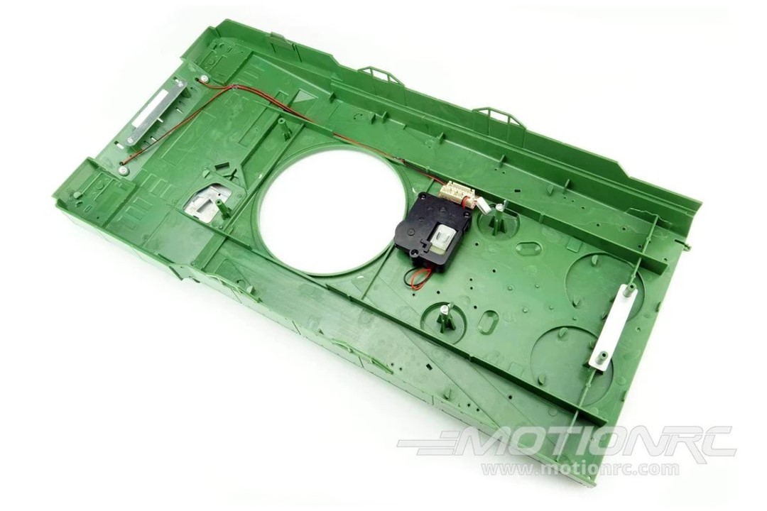

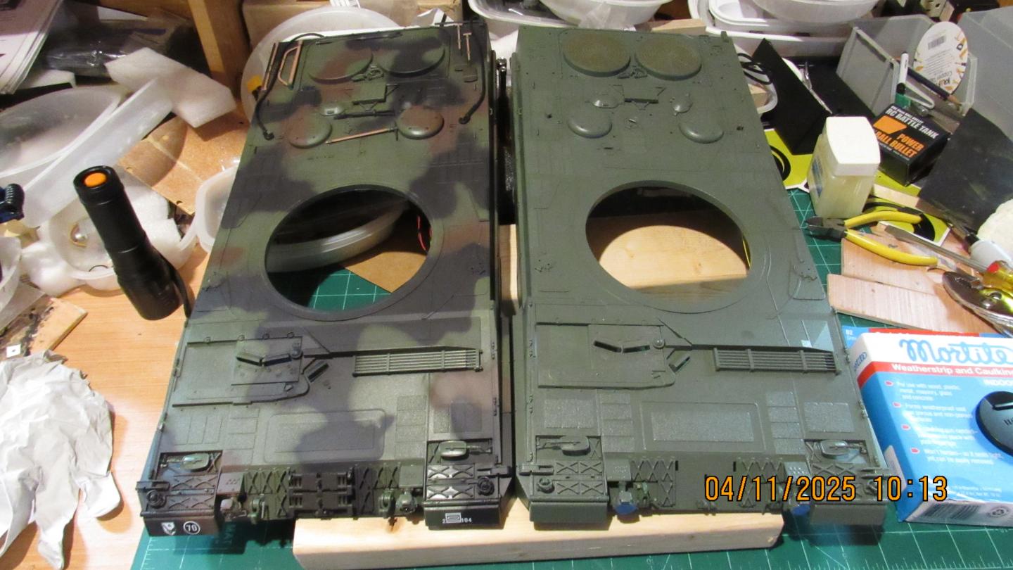

                      I cannot resist the temptation to order the Taigen/Torro upper chassis. It was delivered this morning. It comes with everything I need to latch it to the lower chassis. An excellent value for $40 shipped from Taigen Tank.
ID:	421246 Click image for larger version
                      The hole is a perfect match for the Heng Long Turret. It comes with the turret rotation motor and a accessary parts bag.

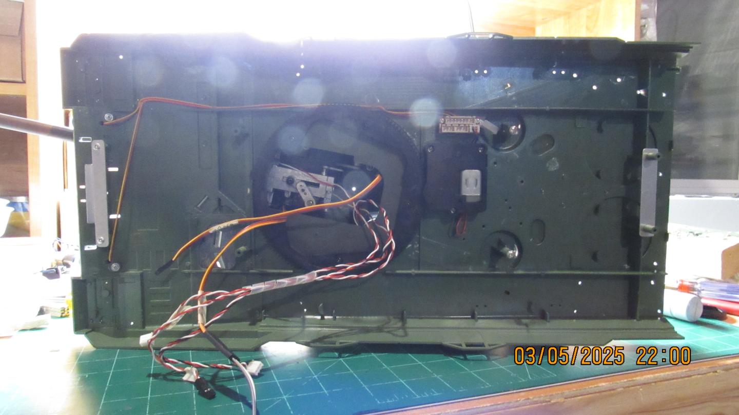

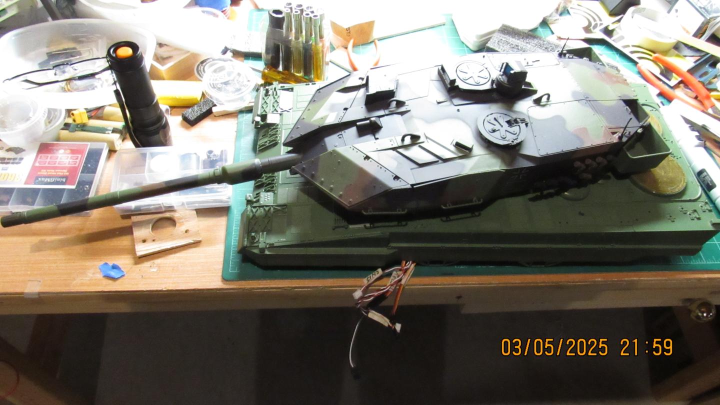

                        For the past 2 weeks, I test fit the Torro upper chassis to the lower metal chassis. Attach small parts to the upper chassis and tried to find way to improve the wobbling suspension arms. I had a major set back on Sunday. The HL TK-7.1 MFU stoped working. It refused to come online.

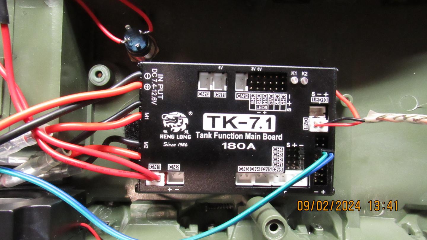

                        This is the second failed HL TK-7.1 MFU in 7 months. The first HL TK-7.1 MFU lasted only a few days. I don't remember any HL MFU failure until the 7.1. I am reluctant to buy another 7.1 MFU for its reliability issue. Returning to 7.0 means giving up on servo recoil and servo elevation. Your comment will be greatly appreciated.
                        The 7.1 is twice as expensive as the 7.0. It has a very nice metal case while the 7.0 case is plastic.

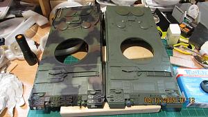

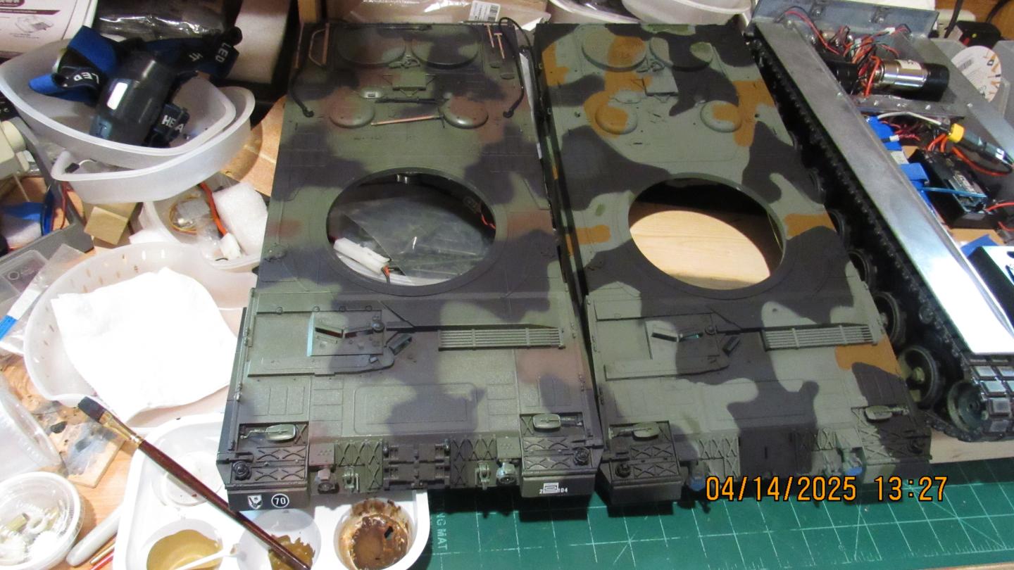

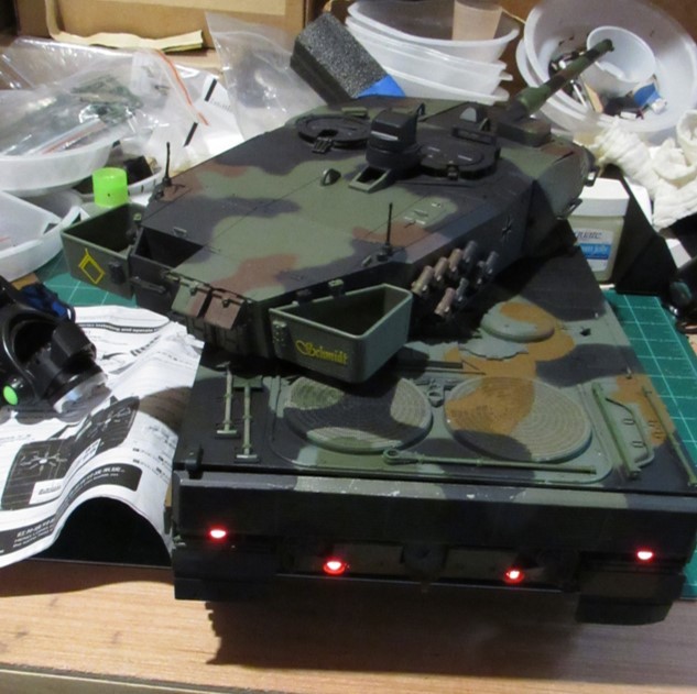

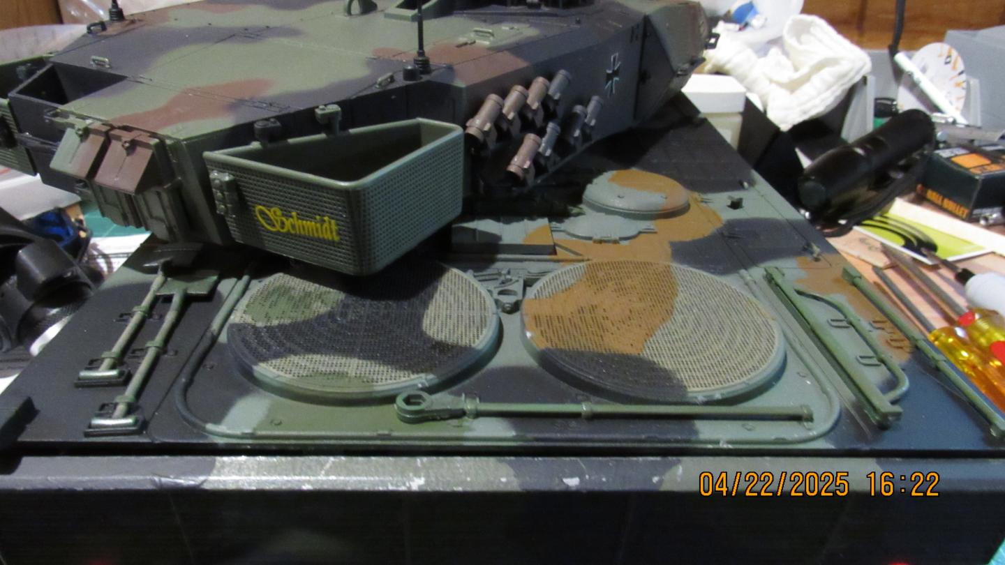

                                    Now I have a working Frankenstein German Leopard 2A6 with Torro metal lower chassis, plastic upper chassis and Heng Long turret with servo mechanism. I have a Valejo WWIII NATO Armour & Infanrty color set, but concern that the 17ml bottles are too little for multiple coatings of a 1/16 scale tank. I decided to use 2 spray cans for supplement. I used Krylon Colormaxx Italian Olive which is a perfect match for the NATO green. I cannot see any difference in shade when I used the Valejo NATO green for patchup correction. The Krylon matte black is too black because NATO black is a black grey. I hand painted the NATO brown using Valejo because the area is small. Now I get a Frankenstein painting too. The HL NATO camouflage on the turret is not accurate. The same paint on the plastic upper chassis and metallic lower chassis have slightly different shade too. After 2 layers of dull coat, they look good enough and I call it done. ​
                                    I use the HL chassis as my painting guide. Instead of playdough, I used caulking cord for soft edge marking.
                                    Click image for larger version  Name:	IMG_5500.jpg Views:	0 Size:	153.0 KB ID:	424065 Click image for larger version  Name:	IMG_5501.jpg Views:	0 Size:	144.8 KB ID:	424064 Click image for larger version  Name:	IMG_5502.jpg Views:	0 Size:	150.2 KB ID:	424062 Click image for larger version  Name:	IMG_5503.jpg Views:	0 Size:	154.7 KB ID:	424063
                                    I did not get a soft edge in the new NATO camo. I believe mostly because the spray paint can comes out too hard. I will need to go back to airbrush to get the soft edge effect.

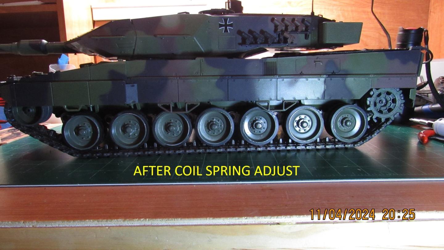

                                      After trying many time to press fit the 2 half of road wheel, I was never able to get the 2 halfs to be as parallel as I desire. I finally follow your lead to sand off the paints. After that, it works much easier and much better in alignment.
                                      Painting done. Road wheel alignment done. The final step is to mate the HL turret to the Torro upper chassis. The tank runs much better than the metal upgraded HL chassis. It is still cold in Chicago. I have not test it outdoor yet. I expect it to be much improved.

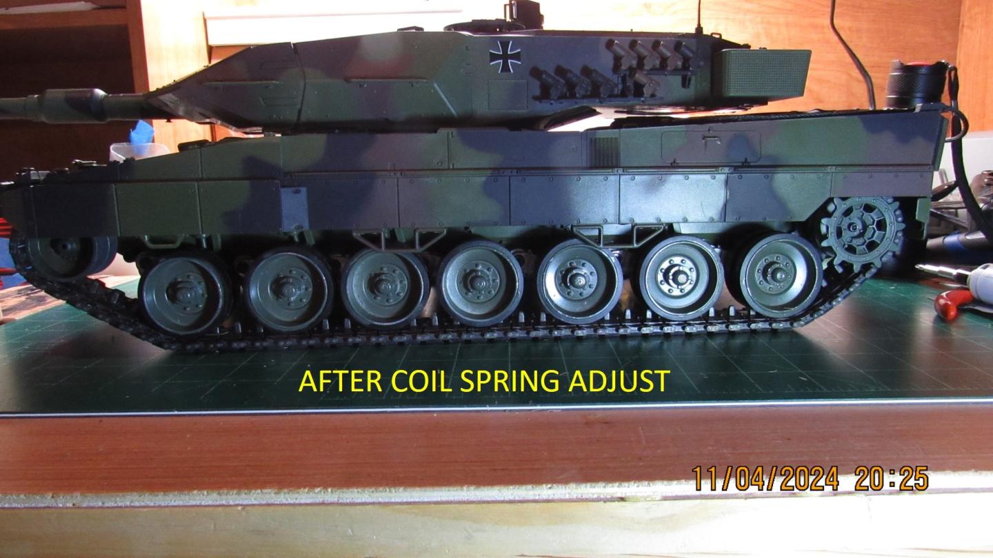

                                        #39

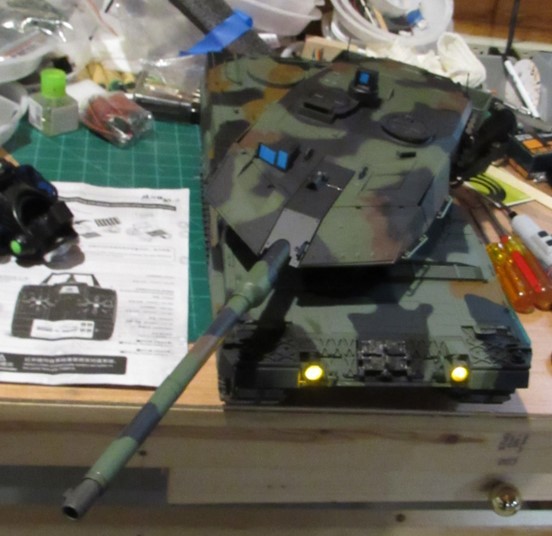

                                        The lower metal chassis upgrade took 2 months at deliberate pace. The total project cost is 241Euro for the chassis, road wheel and axle set from RCTank.de plus US$40 for the upper Torro plastic chassis from taigen.com. The finished Frankenstein Leopard 2A6 is the heaviest 1/16 scale RC tank by a long shoot (to the next one). Just waiting for the weather to get warmer for the outdoor test run. I do not remember the Euro conversion rate, but it was before the US dollar started dropping due to the tariffs.
                                        The overall alignment quality is a close second to the Tongde M60A1 and much improved over the Heng Long metal upgraded plastic chassis.
