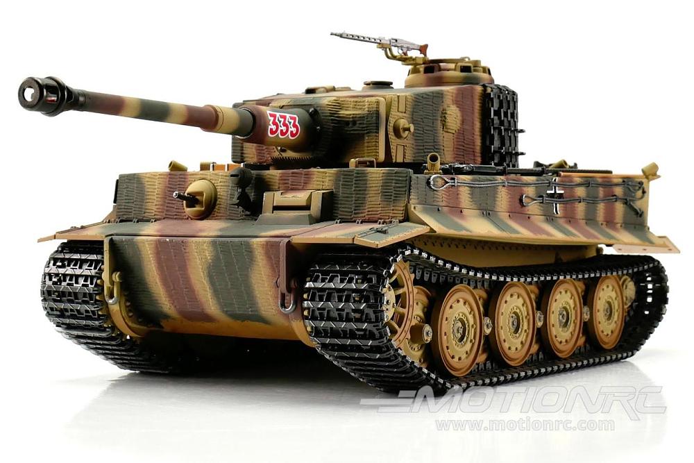

    The Tiger I, a German heavy tank of World War II, operated from 1942 in Africa and Europe, usually in independent heavy tank battalions. It was designated Panzerkampfwagen VI Ausf H during development but was changed to Panzerkampfwagen VI Ausf E during production. The Tiger I gave the German Army its first armoured fighting vehicle that mounted the 8.8 cm KwK 36 gun (derived from the 8.8 cm Flak 36). 1,347 were built between August 1942 and August 1944.
    Faithfully recreated in 1/16 scale, Torro continues to grow its reputation as a producer of high quality, high functioning RC tanks. This Pro Edition of the German Tiger I features more than 70% metal part construction, a 360 degree rotating turret, a realistic torsion bar suspension, and a barrel recoil and muzzle flash effect that fires in sync with the IR (infrared) battle system. This version is delivered as RTR (Ready to Run), meaning it is fully functional out of the box.
    All Metal Track System
    All of Torro's "Pro-Edition" tanks feature full metal drive systems. Single track links are connected with steel pins, propelled by metal drive sprockets and riding over metal road wheels and idler. Confidently conquer terrain with these durable metal tracks!
    Exhaust Effect
    Enjoy the added scale realism that an exhaust provides.
    Heavy Metal Castings
    Hoist hooks, spare track links and even simulated "welds" are reproduced in cast metal! The iconic "Zimmerit" coating applied by tank crews to repel magnetic mines is also molded into the plastic upper hull for additional period accuracy.
    IR Battle Ready
    Engage in friendly infrared ("IR") combat with other tanks using Torro's proprietary IR Battle System, both inflicting hits upon and receiving hits from opponents! Sounds and action signal each hit, until the 5th hit disables the tank. After 10 seconds, the disabled tank restarts and can rejoin the fight!
    Onboard Charging
    Torro's convenient onboard charging system eliminates the hassle of removing batteries after every driving session. Safely charge the onboard NiMH battery by plugging the included charger's plug into the tank's concealed charge port.
    Superb Scale Fidelity
    Molded details, metal cast parts, brass photo-etched parts, and functional elements such as opening hatches all elevate this RC model to the next level, making it a perfect display piece when it's not powering through the battlefield outside.
    360 Degree Turret
    Fully rotate the metal turret 360 degrees, and move the all-metal barrel up and down to train on your target. Torro's integrated drive electronics gives you complete proportional control to translate your precise inputs to all axe of movement. Drive, turn, traverse, train, and fire!
    RTR
    The convenience of "Ready to Run" (RTR) allows new players to join the world of RC Tanks with ease!

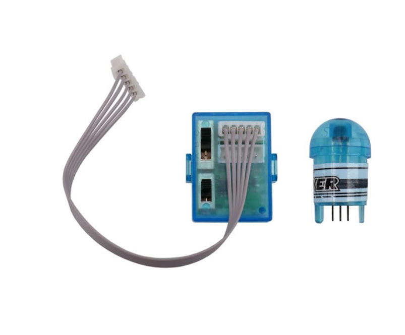

    What are the 2 switches on the blue box for?

      Inside the tank? You mean this blue box?

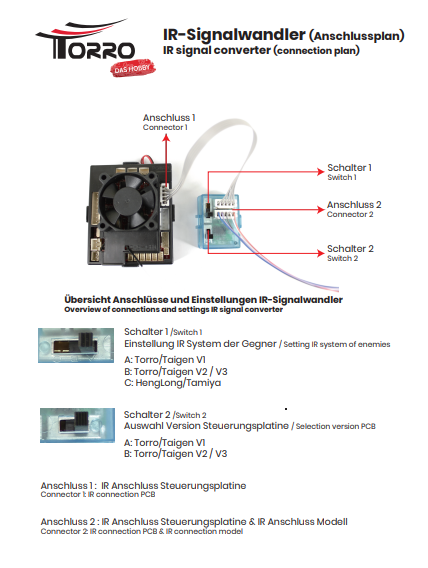

      If so, this is the instruction doc:

        tank_me shows the only blue box with switches inside the Torro Tiger I. It is for setting the Tanks IR battle send/receive modes. FYI it will work with Heng Long tanks but not properly or accurately. I can not attest to it working/registering with Tamiya though.

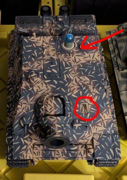

              The Tamiya protocol is the same protocol the HL is using now. I didn't do any long distance testing, but the Sturmtiger (V3 MFU) worked just fine with the HL using the Torro "apple". It's a smaller, newer version than the one that comes stock with the Taigen/Torro IR tanks. The emitter is circled in the pic and the small apple is pictured. I painted the green on the base of the apple just so it didn't look so dorky, but it doesn't block the sensor on top. The top sensor actually has no obstructions 360 degrees. I didn't change out the IR LED or put it in a tube yet as I just wanted to experiment with it on the field this past battle day. I was quite happy with the performance of the Torro IR signal converter. Eventually I will do some work on the Sturmtiger to make it a HL board, but it's low on the project list as it is a running tank and battle ready.

                I'll run some tests again before I do the TK 7.0 swap but the last time I messed with the Torro IR Vs. the Heng Long, The Torro would take 5 or 6 hits from the Heng Long and shudder spastically then shut down but the Heng Long would take up to 14 or 15 hits before it would register dead and shut down. This was at very close range indoors.

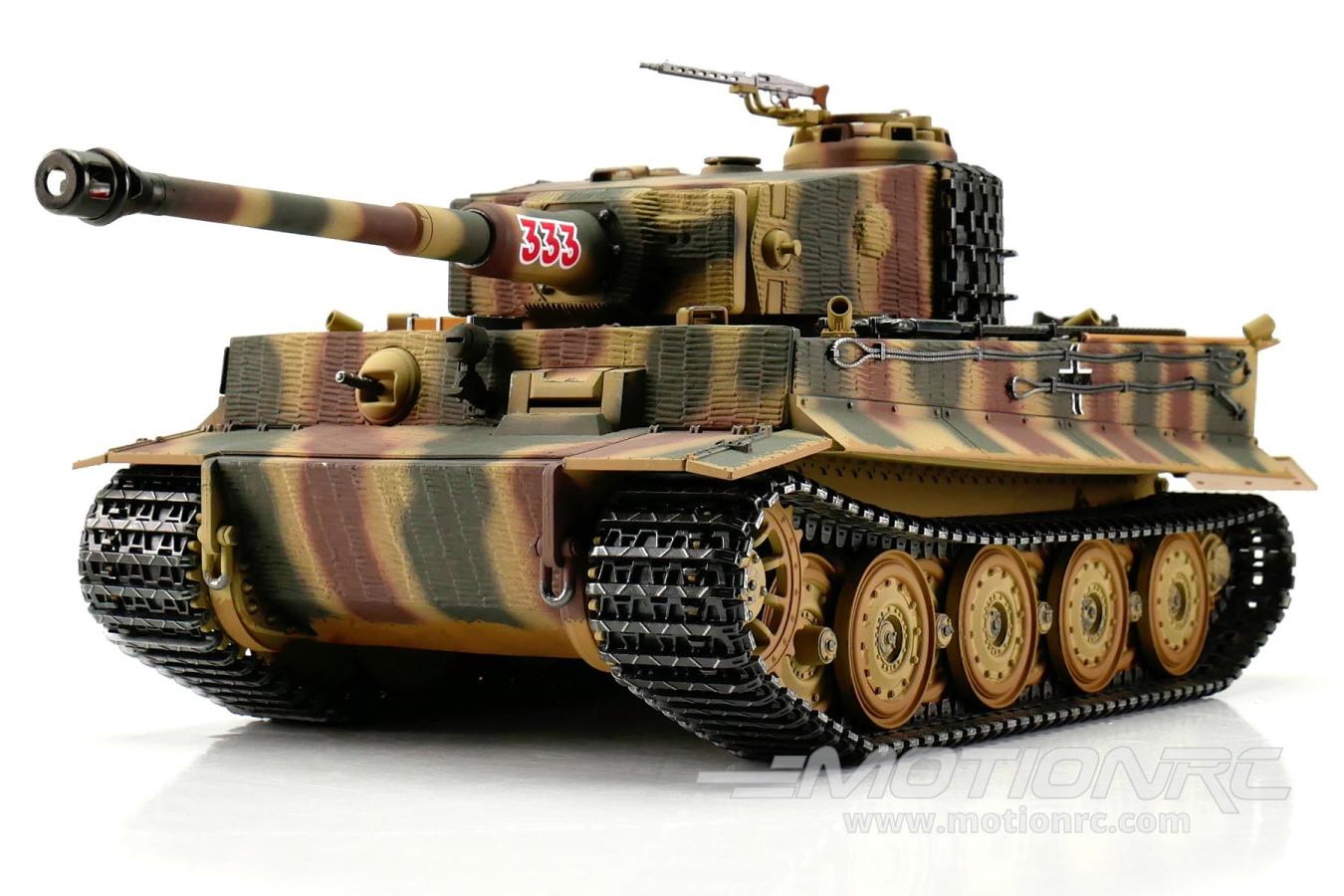

                    It's incorrect. All the running gear on this tank is metal.

                      I was just quoting the original Post #1 by Aros . I hope that this old 2022 Official post can be corrected.
                      My old 2004 Heng Long Tiger 1 is still in pieces to be fixed someday. It has non-HL metal gear and track.

                        Yeah unfortunately there's more than one tank on the sales site that have incorrect listings. And this one is still listed as you shared. I had a similar issue when I picked up the Panther G Pro from Motion and it listed metal road wheels and they in fact came plastic. I contacted Motion and they just said was a mistake.
                        I have this Torro Tiger I late from Motion RC so I can confirm that the road gear is all metal.
