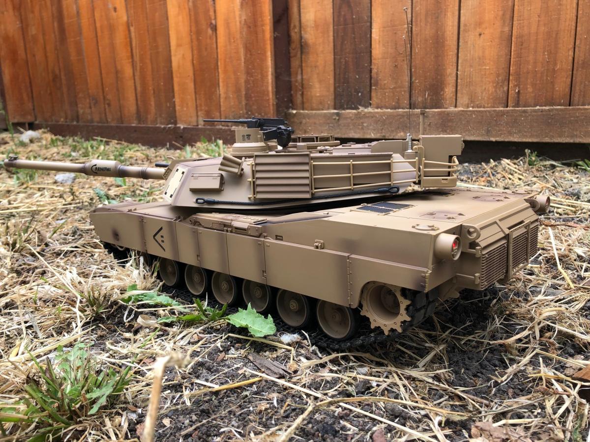

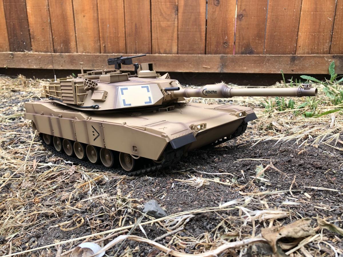

          The bustle rack deformity is bugging me for sure, and I've seen others (mostly on Youtube) that appeared the same from the packaging. I have been researching and researching parts and have some bookmarks to go through now that it's here.
          Thanks,
          Clay
          • #6
            I think I am seeing some sort of low voltage cutoff... I didn't think that these units had that but maybe the 7.0 board is different. Larger batteries on the way!
            Clay
            • #7
              You could take a heat gun to the bustle...very slowly heating it until you can form it back to where you want it. Personally I would leave it as is. Tanks take a lot of abuse in the field and having bent bustle rack rails is pretty normal. Add a spare Abrams wheel right there, or an Alice pack, or some spare track links and you won't even see it anymore.

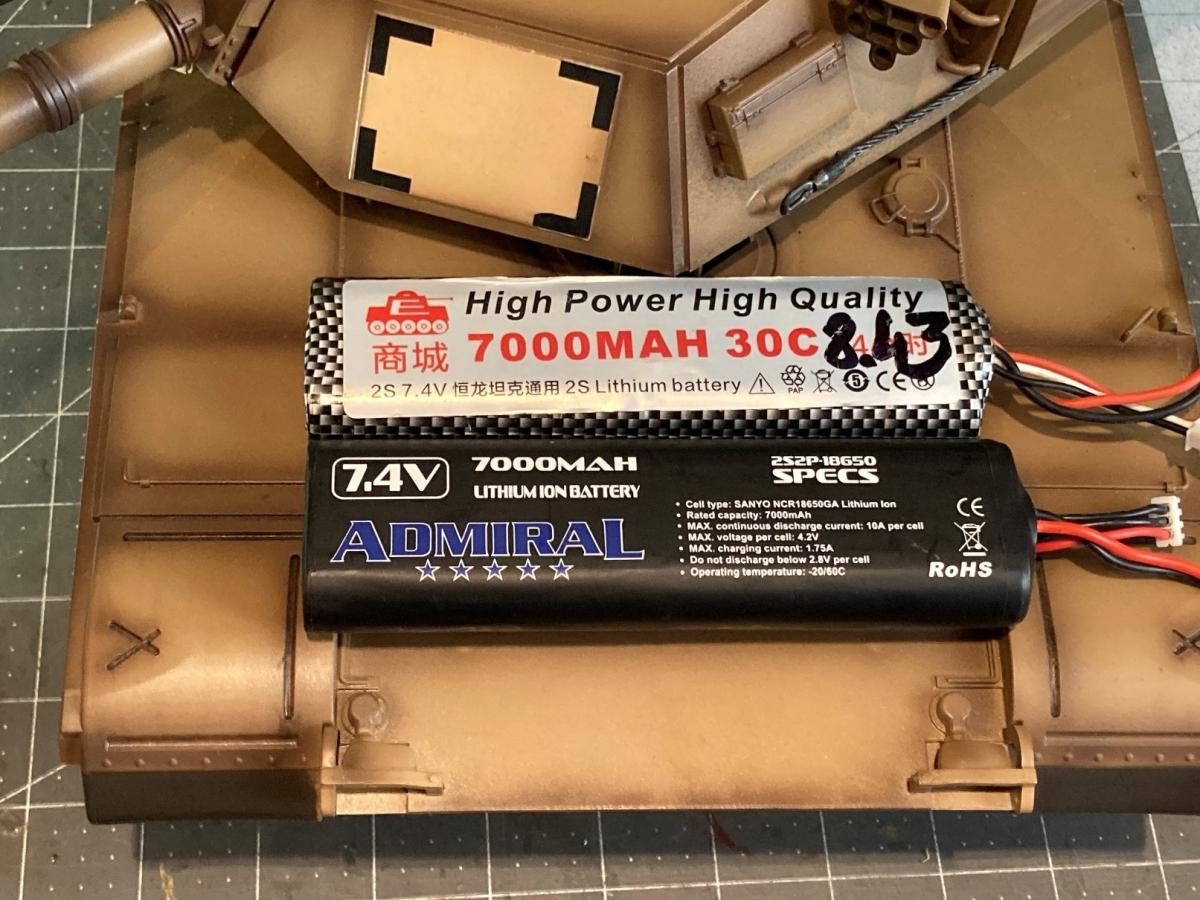

                Welcome. "I" have seven tanks though my wife has claimed the Abrams for herself. It is also the "plastic" version with plastic gear box (actually the box is metal and the gears plastic", plastic treads, wheels, etc. We use these LiPo's on all our tanks and the Abrams can run all day on a charge. They fit perfect in the battery box. I have swapped the connectors to T connectors, some call them Deans. Nothing gets hot at all but we run on packed dirt with a few tree roots to go over and some light vegetation. Carpeting as harder on the drive train than out course. I have had zero issues with that tank.
                Disclaimer- many will say LiPo's are bad, evil and don't use them and if you don't know how to treat and charge them I can agree. A 2S LiPo is 7.4V at nominal and 8.3, max 8.4 fully charged.

                  Thanks for the info Evan. I'm certainly not afraid of LiPo batteries as I also fly electric planes (and nitro now) and have seen first hand what *can* happen. Nothing like running across a field with a fire extinguisher to put out those torches after a plane crashes (although, it wasn't mine but I was the only one who could run). I've ordered something very similar to what you posted so I'm excited to see if the tank runs for more than 10 minutes on a charge.
                  It could be that the heat I'm feeling is relatively normal. Nothing super hot, just warmer than I thought it would have been but, again, after flying planes, usually there's not a lot of heat unless we're really pushing the throttle.

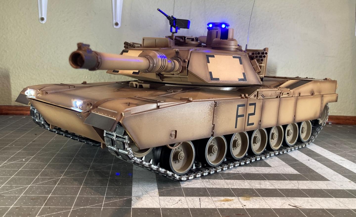

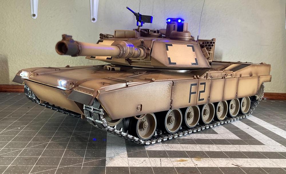

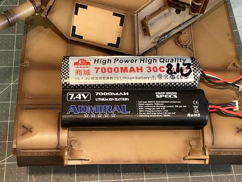

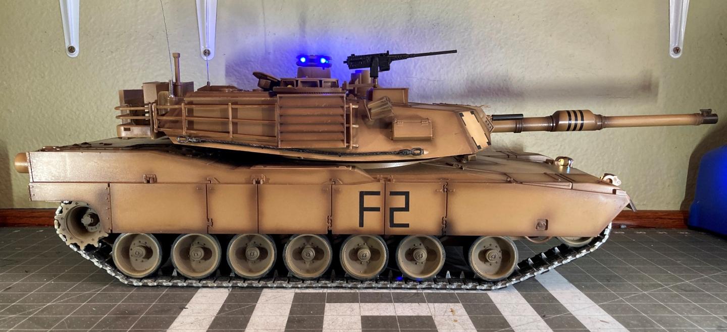

                      I have the same Abram tank with steel gears, metal wheels, idlers, sprockets and tracks. It is quite heavy. These are the 2 batteries I use to run it. One was from Toucan Hobby and the other one I bought it from MotionRC.
                      • #12

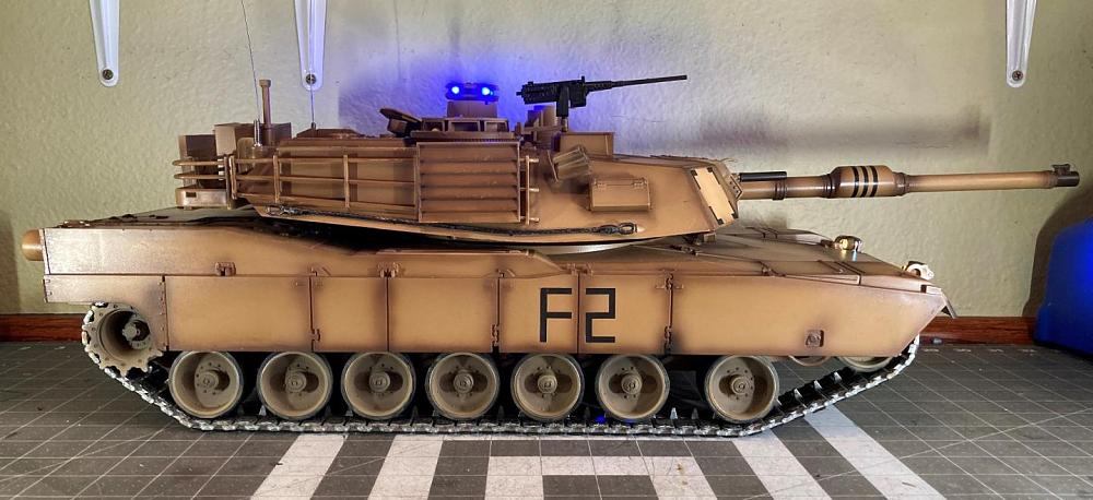

                        Here is my tank. I have just converted it to IR Tamiya protocol battle. I will probably bring it to the battle in San Diego at the end of this month (I hope gas price will go lower a little bit that weekend )
ID:	349399Click image for larger version
