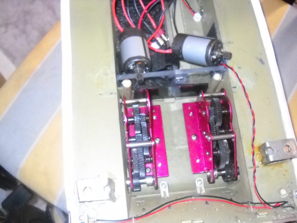

                Henglong ultimate gear box

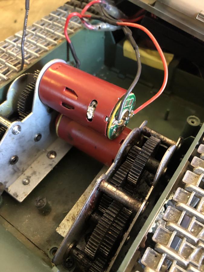

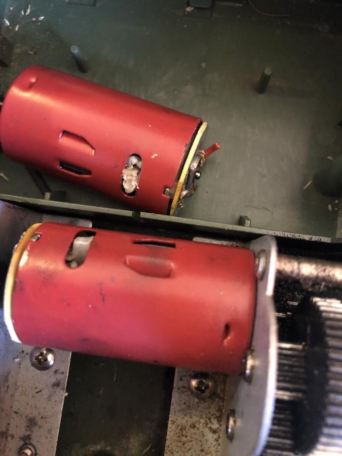

                              Yes red 390 fit nicely in the KV1, but not so in the Stug. Make sure you are buying real HL Red 390 motors because there are fakes. The fakes are not rated for the same voltage the HL 390 motors are and will overheat if you use batteries that put out more then 7.5 volts. Which means all 2 cell Lipos and Li ion 7.4 packs as these peak at ~8.4 volts output.
                              390 motors in KV1. Note these are fakes sold as the real thing. They overheated and burned up on their first run with an 8.4 volt battery.

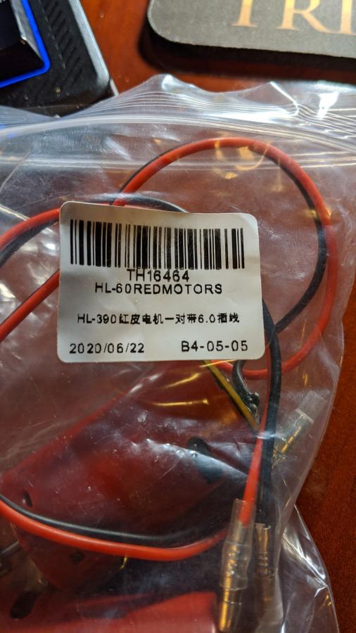

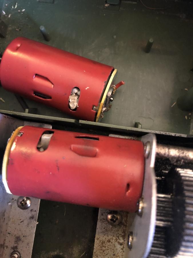

                                Here is a pic of the Reds I bought. How do you tell if there are correct or not.
                                      Nevermind, I don't know what the hell a "URL" is. It just won't let me copy and paste.
                                      Sorry

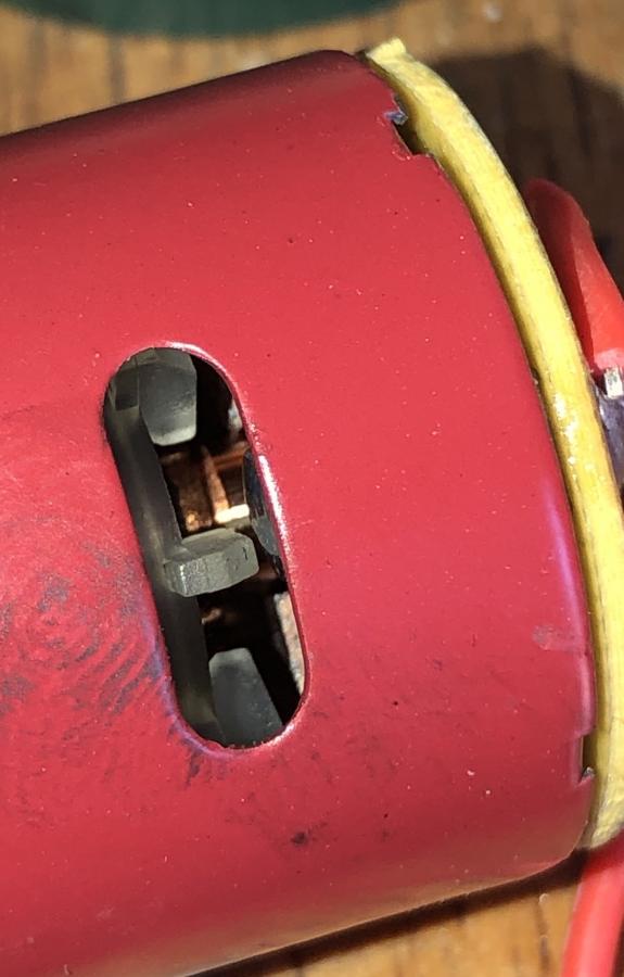

                                      Those appear to be the wrong color red. HL motors are usually a bright red those are a darker red similar to what the fakes tend to be. Another way to tell is if the small internal cooling fans are whiteish in colored. HL uses dark colored fans. Well at least all my do anyways.
                                      I posted a short thread about this topic not long ago so it might help to take a look at it.
                                      Here is one of the fake cooling fans that I am running in a lower powered set up. The fan is dirty but you can see it is light in color. Also is a photo of some fake fans that melted in less then 15min of running.

                                        Wow, you are RIGHT!! I have knock offs Red 390 motors darnit. I put these nasty things in both my Leopard and M1A1. I haven't run at speed too much since we just put them in last weekend. I have anther pair so that is why the KV-1 & Stug question.
                                        Now where do we buy the real deal. I didn't see any on the Motion RC site and they appear to be out of EVERYTHING anyway. I assume we go to a legit dealer like Forgebear or IMEX etc. Thank you so much for your insight and help. We're are fairly new at the tank game and we are just starting to do upgrades like motor swaps, 360 turret rotations and we have even added a targeting laser to one of our tanks. We are pretty much alone in Utah and haven't been able to locate or hookup with any clubs. So...we have stayed with Heng Long and resisted buying some of the higher end tanks to purschase and picking up more H/L's and hopping them up because we only play among ourselves. Between our family and grandsons we have 13 Heng Long tanks. We bought the first five from Motion and the rest from Ebay.
