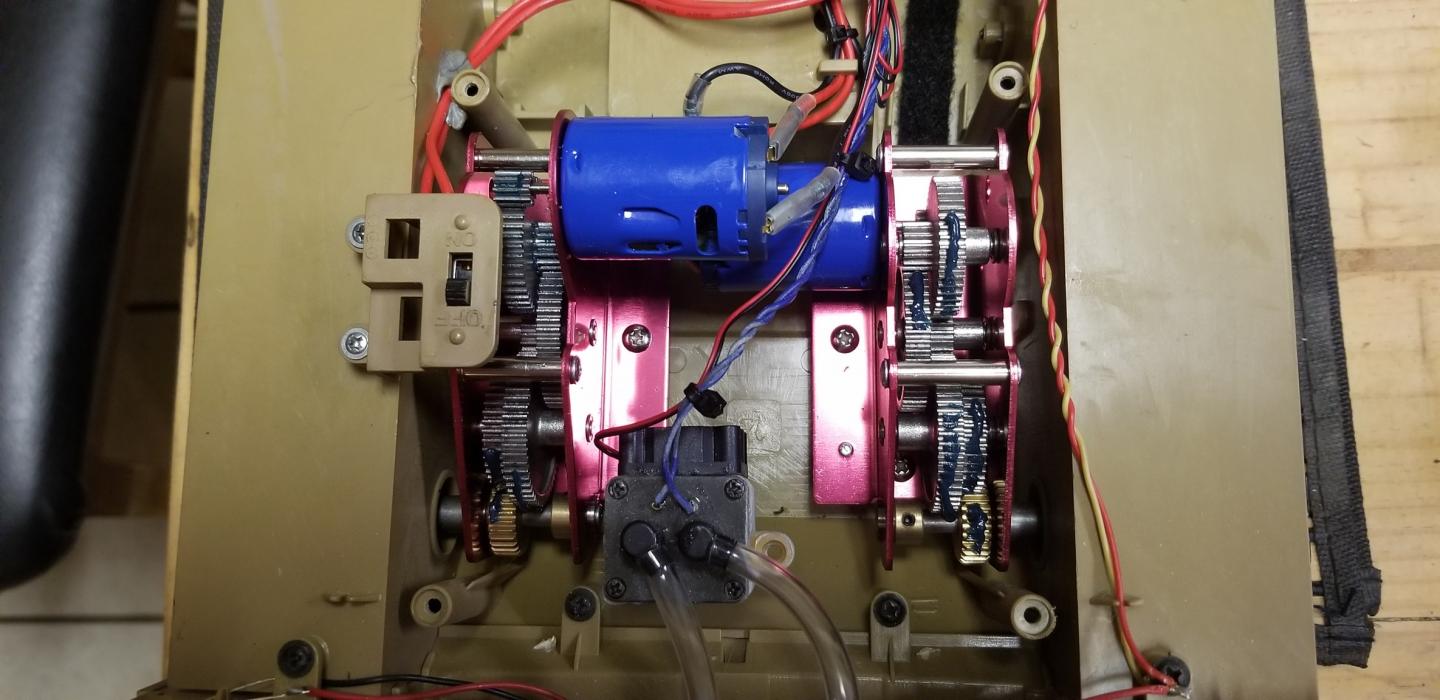

                            I got a wild hair and installed the Ultimate Edition II Gearbox & Motors.....been rainy all day, so havn't had the chance to give it a shakedown..

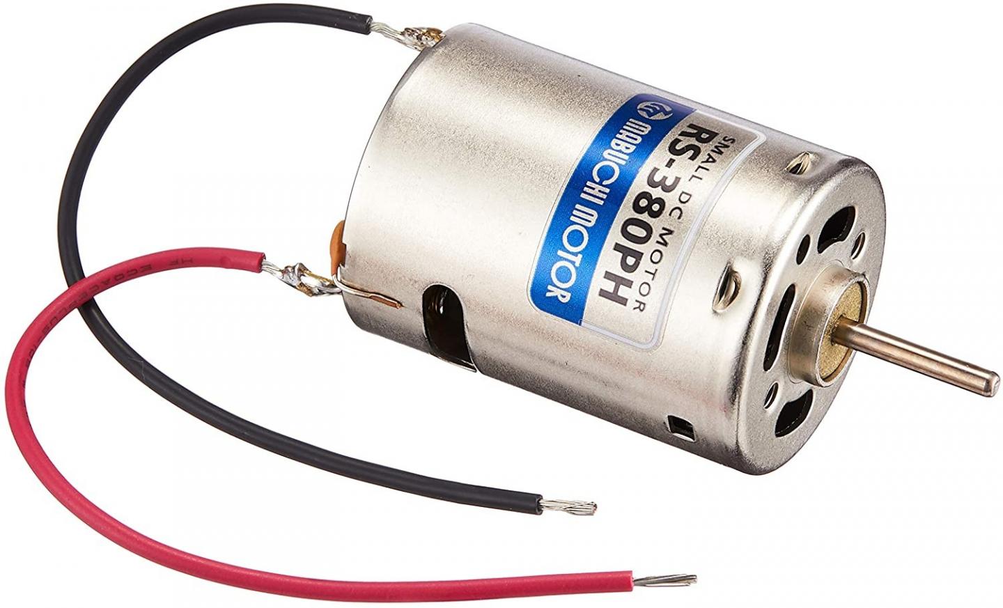

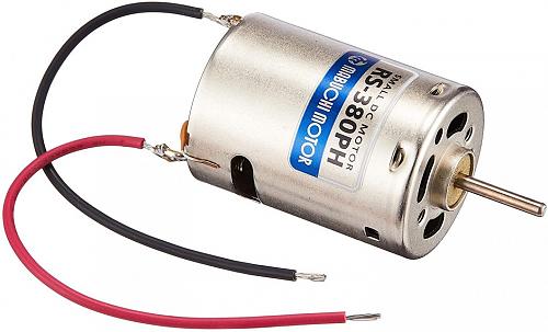

                                      Rubicon99, thank you for the tip. I hope that the TamiyaUSA 380 is the Tamiya RS-380PH by Mabuchi, but I am not optimistic about my chance. The 1/16 scale Sheridan is a static model, thus, has no RC parts. I found one 380 motor at the TamiyaUSA.com site which has no specs. I ordered a pair to find out what it is and cross my figures. I have written Tamiya technical support to verify my purchase. The picture below is NOT from TamiyaUSA.com, but from Amazon.
                                      https://www.tamiyausa.com/shop/7-dig...or-43501/none/
                                      Click image for larger version  Name:	mabuchi_rs380ph-tamiya.jpg Views:	0 Size:	116.2 KB ID:	313687 Click image for larger version
                                      I have tested 14 Mabuchi RS-380 from e-bay or amazon. Most of them are too slow. Some with the RS-380SH designation cannot take anything higher that a 1S battery and will high up rapidly.

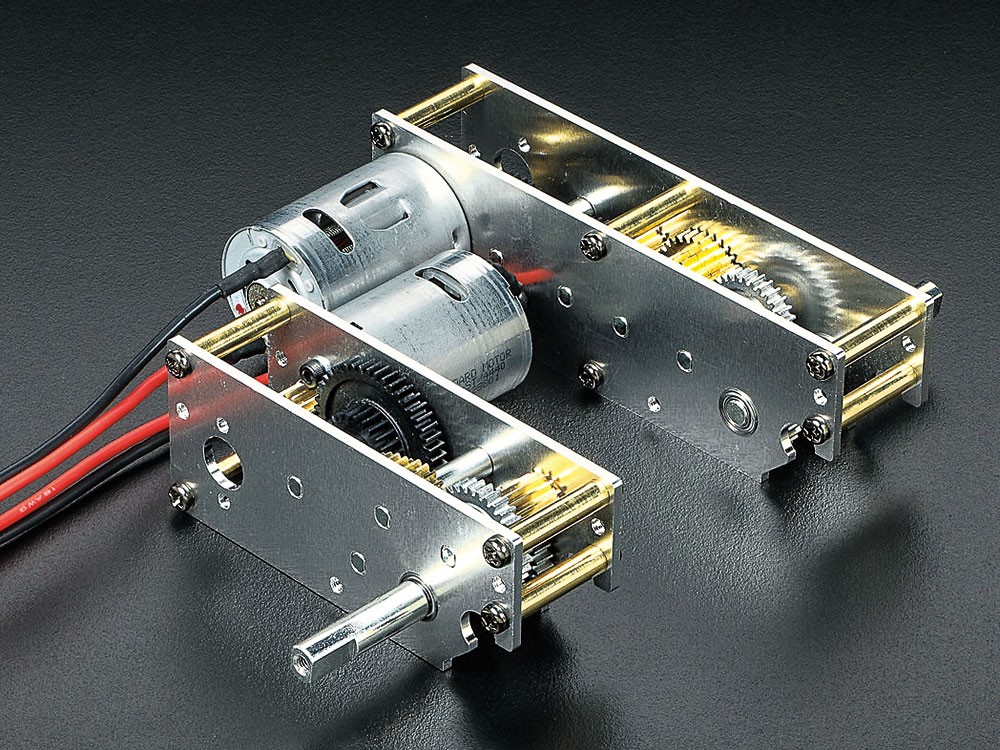

                                          You looked at the static Sheridan not the R/C Sheridan. I assure you the RC version has 380 motors available for it. I own the r/c version of the Tamiya Sheridan that is how I know there are spare motors. I ordered two extra for “down the road” usage.
                                          Thanks again for the update which is very helpful. I found the R/C Sheridan product page and manual. The motor definitely looks like what I want. But the picture only shows part of the motor parts ID which like the same as the Tamiya Grasshopper motor.
                                          So, I went to e-bay again and found a pair of the Tamiya Grasshopper 380 motor. Between these 2 pairs, I am more hopeful now. They could be all the same and good for the HL tank. Thanks again.
