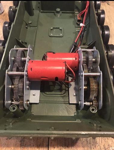

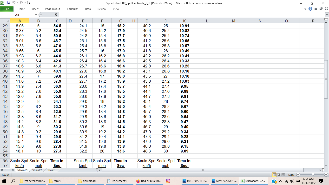

26mph scale for a Pershing is actually pretty good considering the real ones were very rarely driven over 25 mph on road to keep from “blowing up” the transmission. I am assuming you tested the speed using a 2 cell 7.4v (~8.4v peak) Lipo. Push the power to 9.6v or slightly higher and you will easily be at 30mph scale (the maximum published road speed for a M26 Pershing). Using a 3 cell Lipo running on HP and you will be even faster. Used in short maximum power bursts HP should not hurt the MFU or motors. The 7.0 is rated up to 20 amps and 12v.
If you want to safely run 3 cell Lipo batteries for their added power output look at upgrading the MFU to the 7.1. It has a 180 amp and 12.6v rating which is the highest ever offered by HL and far more then even the new Tamiya DMD 11 systems. The 7.1 paired with a 3 cell Lipo battery would make it easier for you to achieve the overall speeds you are looking for.
