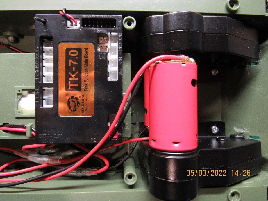

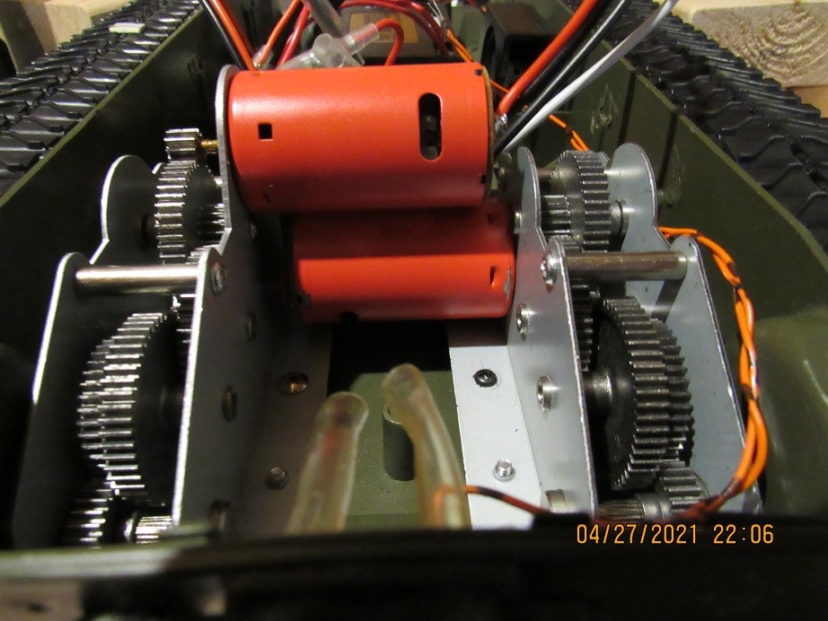

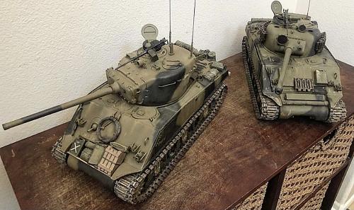

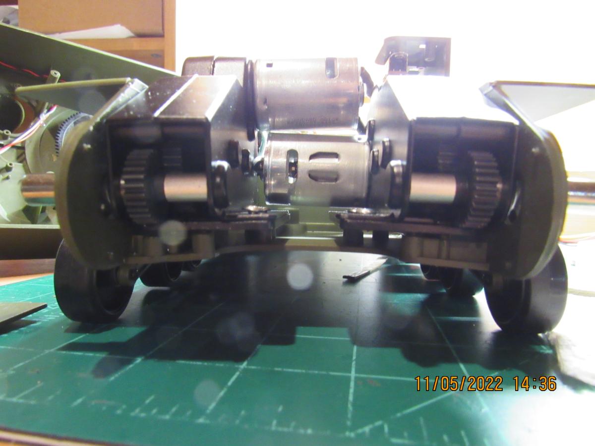

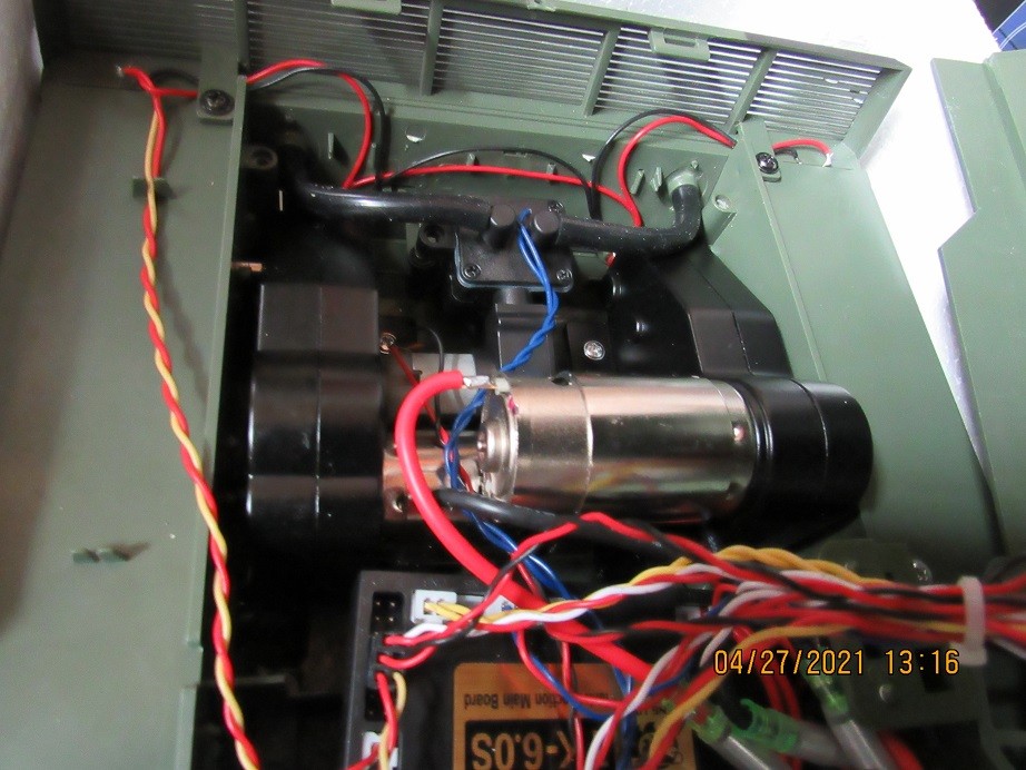

        • My question is changing from "Red or Blue Motors" to "Can you find a 380 motor driving a HL as well as the 390 motor?', Despite my complaint about the quirks of the Heng Xin gearbox, I ended up with it on all four of my operational Heng Long tanks. Its basic design includes tight tolerance on all moving parts. The assembly is good that results in low noise and little vibration. The almost fully enclosed case allows liberal use of grease on the gears. These tanks are German Leopard 2A6, US M26 Pershing, Russian T-34/85 and US M4A3 Sherman. The Sherman is a new acquisition that I just got last month.
ID:	361216Click image for larger version
ID:	361217Click image for larger version
ID:	361218Click image for larger version
          At first, I put a pair of Tamiya 380 that I got on e-bay on the Sherman. They turned out to be defective and stops after a few seconds run. I changed them to the Mabuchi RS380PH/3270 that I mentioned earlier. It runs fine continuously, but too slow. I pair the 3270 motors with a 3S Li-po battery (11.1 volts) for more normal speed. Even though the HL RC motherboard is rated for 12 volts, I don't feel comfortable with using 3S battery extensively.
          For the Sherman metal upgrade, I got the Mato metal T74 track with duckbills. It turns out to be the heaviest of my metal tracks. The cast and paint look beautiful and it does not break like my old Mato Pershing track.
          The T34 with 390 motors is so much more fun to drive outdoor in open space. I found the normal 380 Pershing speed no longer good enough. Thus, the question:
          Ijust ordered 2 pairs of Mabuchi RK380SH/4528 which has 23-25000 rpm at 8 volts. I will test if they can drive the heavy track without overheating. The backup plan is to get a good pair of Tamiya 380

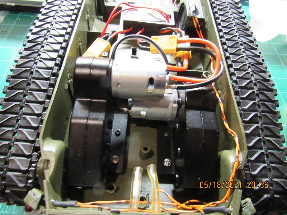

              The WW2/Korean War era tanks were underpowered by modern tank standard. The Pershing can go 30 mph on paved road vs. 5.25 mph off road. Even with the 390 motor, the HL Pershing is a few mph less than 30 mph in scale speed. I will not call this speed chasing, it is not even life scale speed. I have tried the 390 with HL steel gearbox, but I cannot find the HL ball bearing version in US and gave up. The sleeve bearing have too much noise and vibration.
              You should also take a look at Taigen black 380 motors. These tend to run at slighter higher peak RPMs and have more torque then both HL stock, HL blue or Tamiyas.
              Try that a long time ago. Taigen will not sell the 380 alone.

                      When I first started out on metal upgrade, Pershing is my first tank to try. I spent a few days to fit the Heng Xin with 390 but fail. I may try again now. The Sherman is another story. It is physically impossible to fit the 390, period. The Heng Xin gearbox is a drop in.
                      I remember the big disappointment that my HL Tiger will not move when I put it on the grass lawn. It was an indoor only tank. Now, I have several tanks that run well in my backyard.

                              I just ordered a Taigen V2 gearbox. I will fit it with a pair of spare red 390 I have before puting it on the Pershing which will run at about the top scale speed on highway. The Taigen black 380 will go to the Sherman which will give it the top scale speed with the 2S Li-Ion pack.
                              I took the Heng Xin with Tamiya380 off the Pershing tonight. It is more difficult than I expect. It doesn't make sense to try the Heng Xin/390 on the Pershing.
                              The Mato T74 with duckbills track is heavier than anything else I use. But the 380 seems to handle it without difficulty. The Sherman will be slower than the T34 with 390, and both will have about the right top scale speed on road.

                                          I measured the Pershing with Tamiya380 and Heng Xin gearbox to have scale speed of 26 mph. It does not sound too low. The HL T34 with red 390 and Heng Xin drives noteably faster, But I have not actually measure it yet. The Leopard 2A6 should be slightly faster than the T34 due to its longer Tamiya track, but far slower than the real tank speed for modern tanks. Unlike RC airplane or boat, measuring RC tank speed is very easy using basic engineering principle.
                                          I am a backyard RC tank driver which means grass lawn mostly. I have not find a RC tank club in the Chicago yet.
