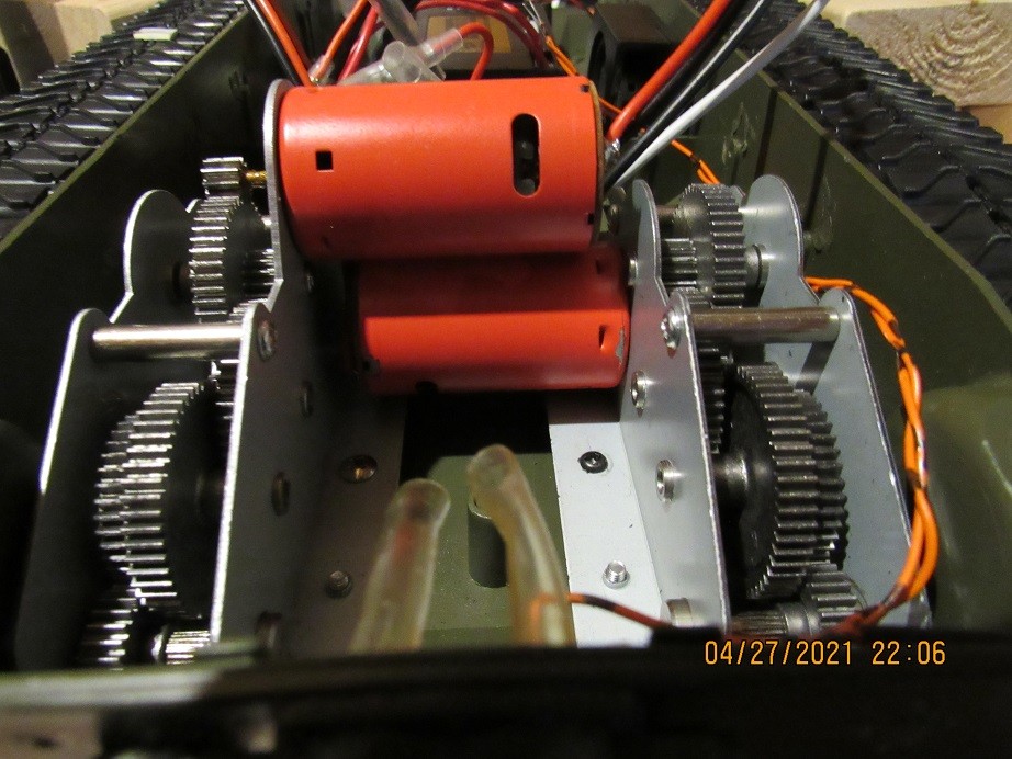

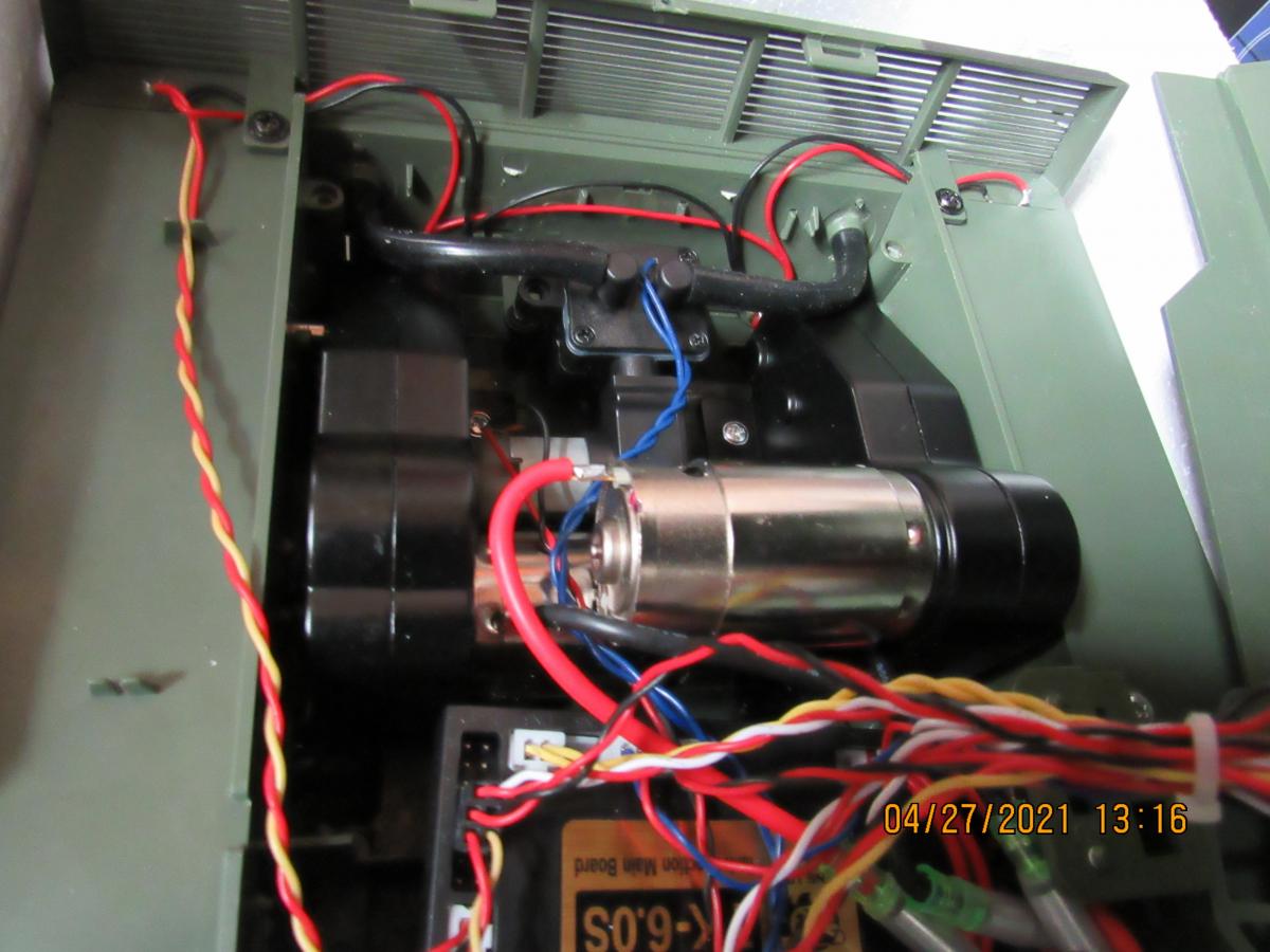

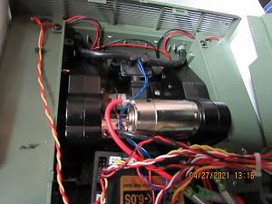

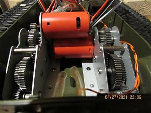

                    Originally posted by keilau View Post
                    I just received my gearbox for the 2005 HL Pershing from e-bay seller, build-for-you, today. Will be working on it the next few days and report my result at the Pershing thread.
                    Click image for larger version Name:	IMG_4964.JPG Views:	0 Size:	121.7 KB ID:	308824Click image for larger version Name:	IMG_4962.JPG Views:	0 Size:	132.5 KB ID:	308825
                    I also got some 380/390 heatsink with fan. But I will have to see if they can fit. If no space for the heatsink, I will remove the smoke generator and put a 40mm fan there instead.
                    Alas, NO Heng Xin gearbox with red motor for M26 Pershing. The Heng Xin has a far sturdier mounting system than original HL and, in most case, is much easier. It requires a 2 dimensional movement of down and out. There is not enough room in the Pershing for the Heng Xin gearbox with red motor! After trying for 2 days, I gave up and took the Heng Xin gearbox to my brand new German Leopard 2A6. It works much, much better than the HL stock gearbox/motor combo.
                    Click image for larger version  Name:	IMG_4980.JPG Views:	0 Size:	105.0 KB ID:	310659
                    I use a pair of Mxfans 390 instead of the red motor. For all practical purpose, these 390 motor are interchangeable.
                    I replaced the stock grey 380 motor on the OEM steel gearbox from the Leopard with the red motors and mounted it on the Pershing. It went in easily. I am also upgrading the Pershing to 6.0 electronics for better driving quality. I have purchased a second Heng Xin gearbox which, I think, can be used on the Pershing with the blue motor. When I am all done, I will post to the Pershing thread.
                    Click image for larger version  Name:	IMG_4981.JPG Views:	0 Size:	163.3 KB ID:	310660
                    An other option of all bearing gearbox with red motor for the M26 Pershing is the HL Ultimate II gearbox.

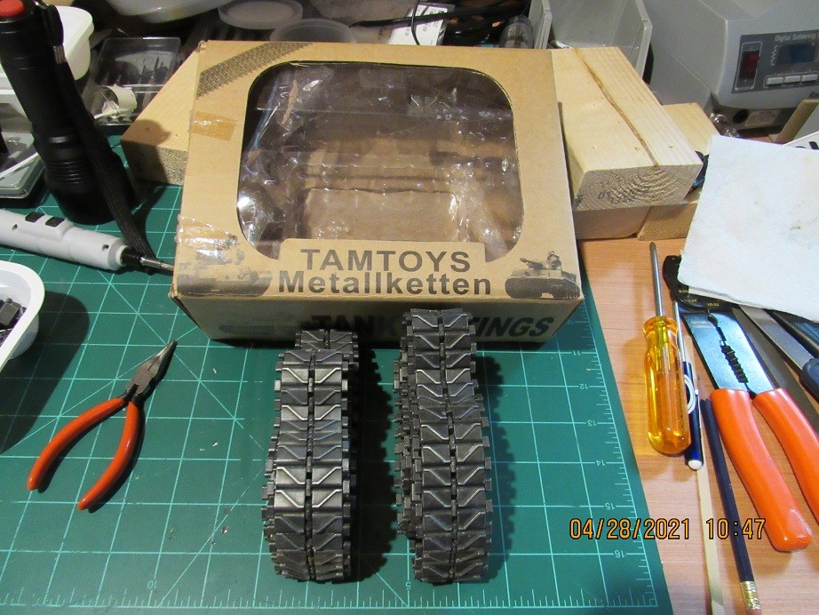

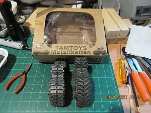

                            For anyone who considers Mato to be quality parts, I refer you to the "High End Castings" thread, post #19 to 23. I expect to have to do that when using Mato cast parts.

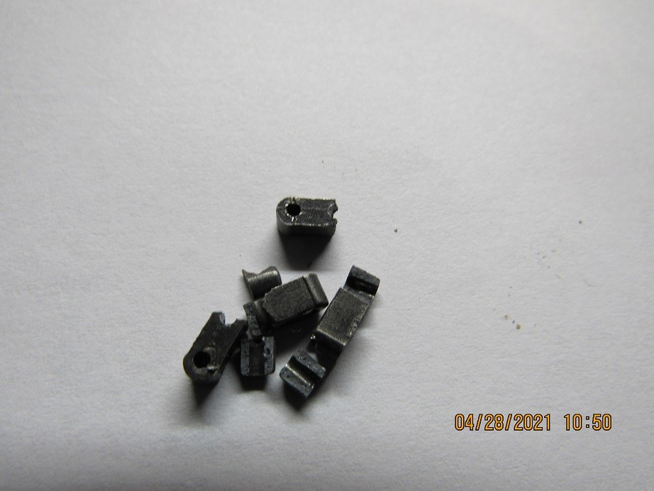

                            I have comment on the quality of Mato metal track too. Consider this to be "inexperienced" because it is based on one single sample of Mato track and one Heng Long metal track.
                            I have been trying to get the Mato metal track to work on my HL M26 Pershing 3838 without any success. After 5-10 minutes' run, it de-track badly and I will start to search the floor for fall-off or broken endcaps.
ID:	310715Click image for larger version
                            Most of the time, the endcap just fell off intact. But there are enough incidents that the endcap fell off broken. I finally have to stop trying after used up most of the spare endcaps. If you have a contact at Mato, I would like to contact them to see what I can do.
                            By comparison, the HL metal track that came with my German Leopard 2A6 3889-1 still works fine after a month. I should be testing it on the new gearbox soon, see Post #49 above.

                              You need to peen the end connectors. It’s not hard it is just time consuming. Mato Pershing, Abrams and Leopard 2 dual pin tracks are well known to have loose end connectors and why most of us that have been in the hobby a while don’t recommend them to those new to tanks.
                              The best tracks made for the Pershing are Tamiya and Kenny Kong / IMPACT tracks. They run about $85 a set.
                              HL Leopard 2 tracks are single pin and not correct as the real tracks are dual pin with end connectors. DKLM and Tamiya make Leopard 2 tracks that put the stock metal HL tracks to shame and are about the same price.

                                    Rubicon99, I really appreciate your information. I have completely forgot about Kenny Kong. How do I get hold of him?
                                    Every time before I used the Mato track, I inspect each pin and seat them properly. But it does not help much. I have to admit that Mato made a very good looking track. For now, I am back to the plastic track. I am thinking using the plastic endcap on the Mato track. What do you think?
                                    I did not notice that the HL metal track is a one pin design. You are right and it looks terrible in detail appearance, but it seems to function ok. I will add this to the borderline crap list.
