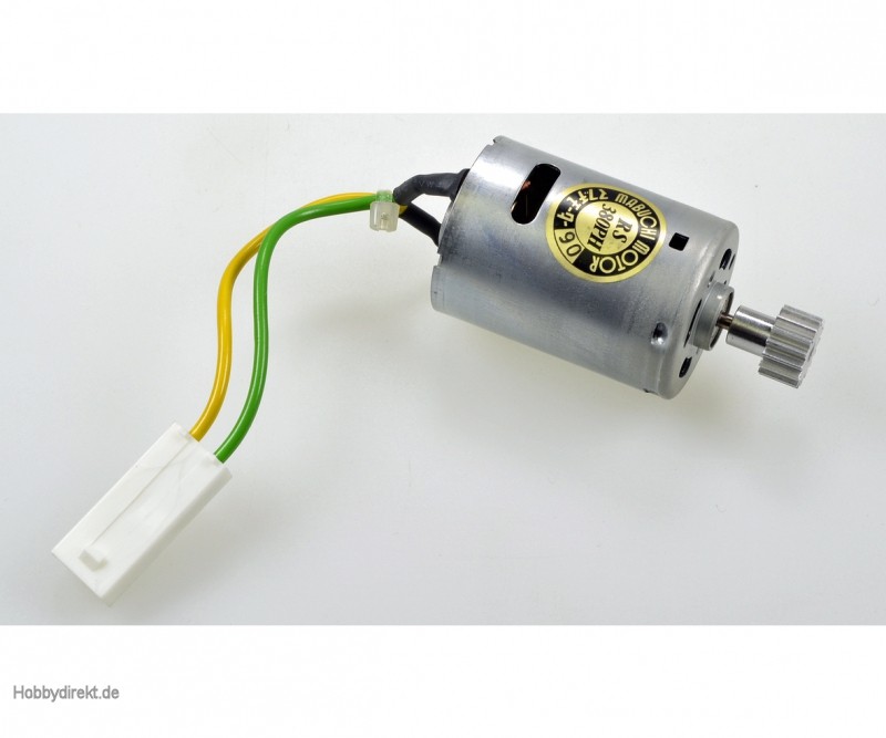

    So, I went to e-bay again and found a pair of the Tamiya Grasshopper 380 motor. Between these 2 pairs, I am more hopeful now. They could be all the same and good for the HL tank. Thanks again.
    Which tank do you intend to use these Tami 380's on? Are you concerned about insufficient torque on larger modern tanks?

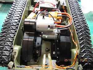

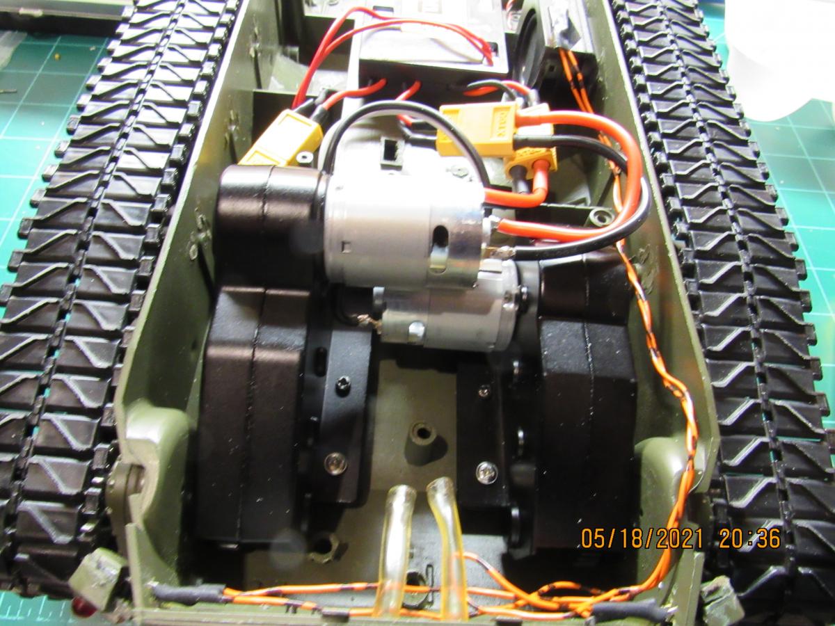

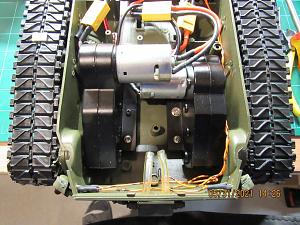

      No. It is for the mid size M26 Pershing. I replaced the stock grey 380 motor on the OEM steel gearbox from the Leopard with the red motors and mounted it on the Pershing. It went in easily. But the HL steel gearbox runs with too much vibration with the 390 (too fast for it). I am also upgrading the Pershing to 6.0 electronics for better driving quality. I have purchased a second Heng Xin gearbox which, I think, can be used on the Pershing with the blue motor. When I am all done, I will post to the Pershing thread. Currently, I use 2x Mabuchi RS-380PH-3270 which have plenty of torque and runs cool. But the rpm is about 20% slower than the HL grey 380.

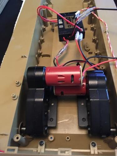

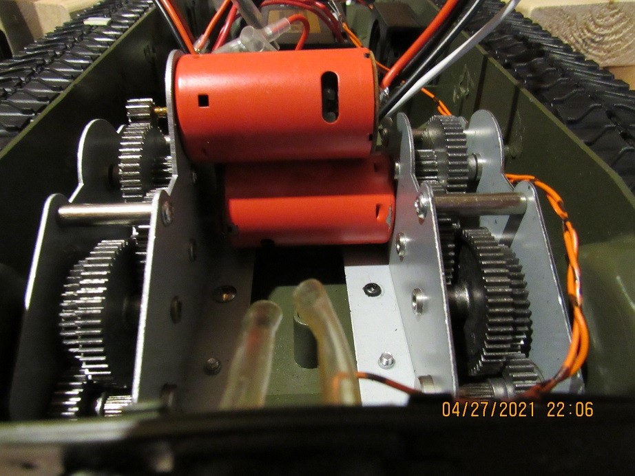

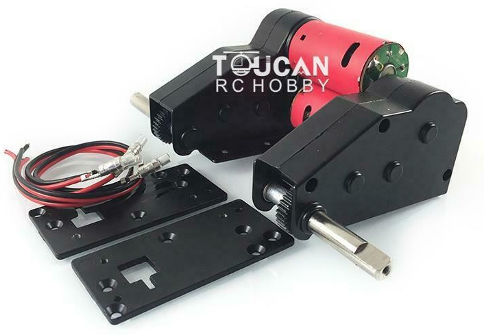

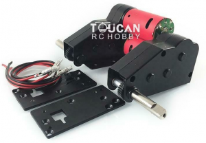

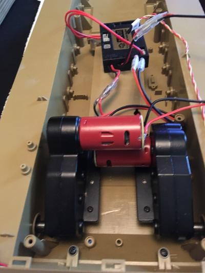

            Question from a new tanker...
            Just installed new Red motors ("Fakes" ??) and gearboxes... purchased from Toucan Hobby
Name:	Red Motors & gearboxes.PNG
Name:	Upgraded motors & gearboxes.jpg
            Is it recommended that I run them without any load to break them in first or are they good to go as installed?

              #86
              Good to go. No run in time needed.

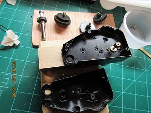

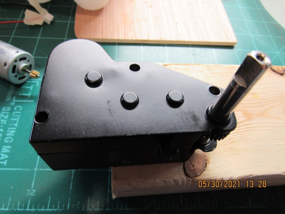

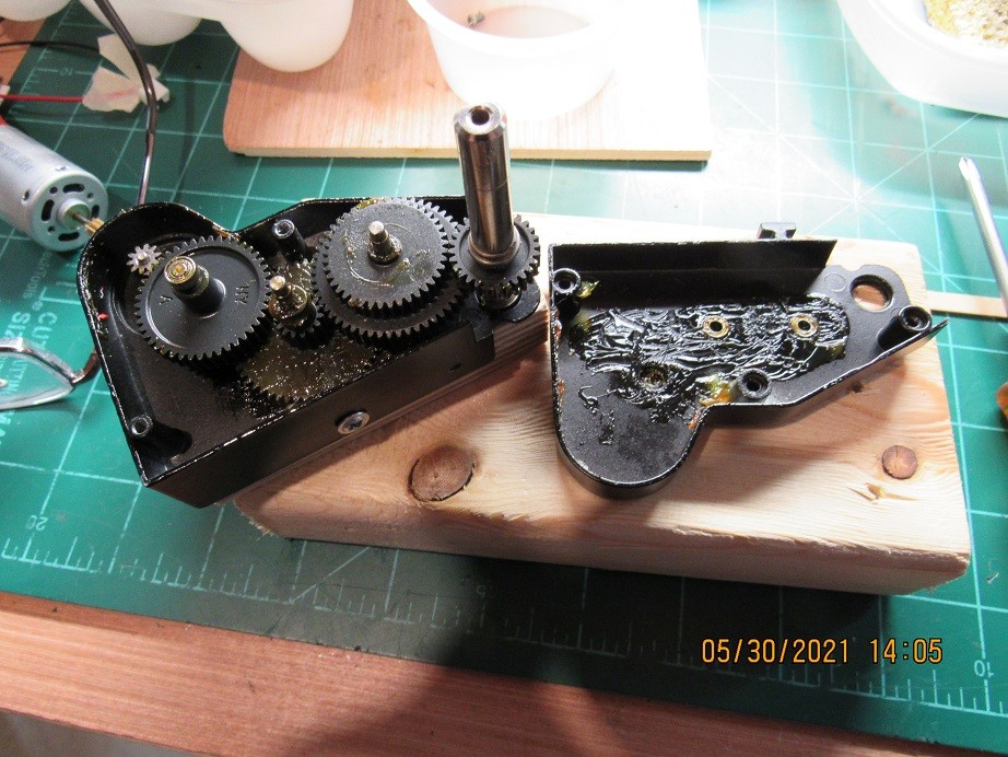

                I have 4 red motors that came with the Heng Xin gearbox. They are excellent motors. If you were concerned about fake motors, run the tank with the upper frame open, If the motor case feels room temperature (<80°F) after a 10 minutes run, your motors are good.

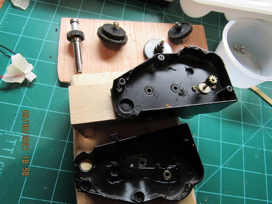

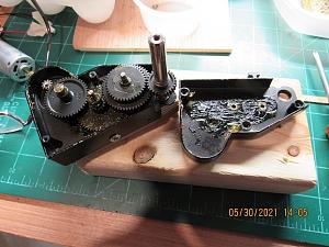

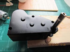

                The Heng Xin gearbox will not benefit from a break-in run. However, in both of the Heng Xin gearbox I received, the lithium gease was NOT spread evenly on the gears. It was just a big scope on the case wall and the gears were mostly dry. I used a craft stick to scope up the gease and reapply them evenly on the gears. If you were not mechanically inclined, I will highly recommend that you get a technician friend to do it for you.
                Since the gears and their ball bearings are all loose, be extremely careful when you open the case. The 2 case half are held together by 3 machine screws. It may be a little tricky to put them back together. Hold one of the case half horizontal with inside up. Put all gears and bearings in place. Carefully lower the other half of case onto it until all bearings are in place. The case slaps close and then tighten the screws.
                I still like the gearbox a lot, but would have expect better workmanship for a $80 gearbox for RC.

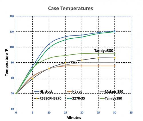

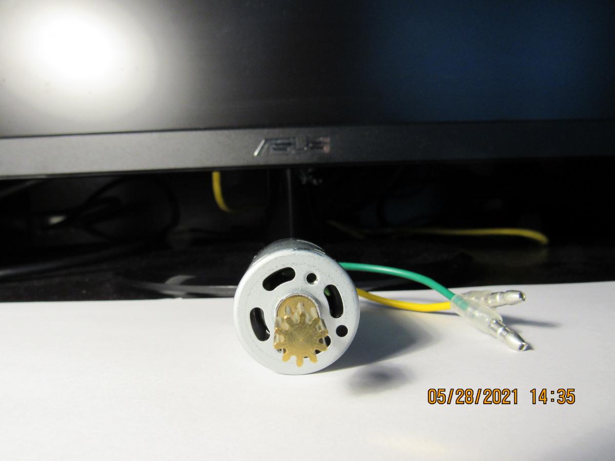

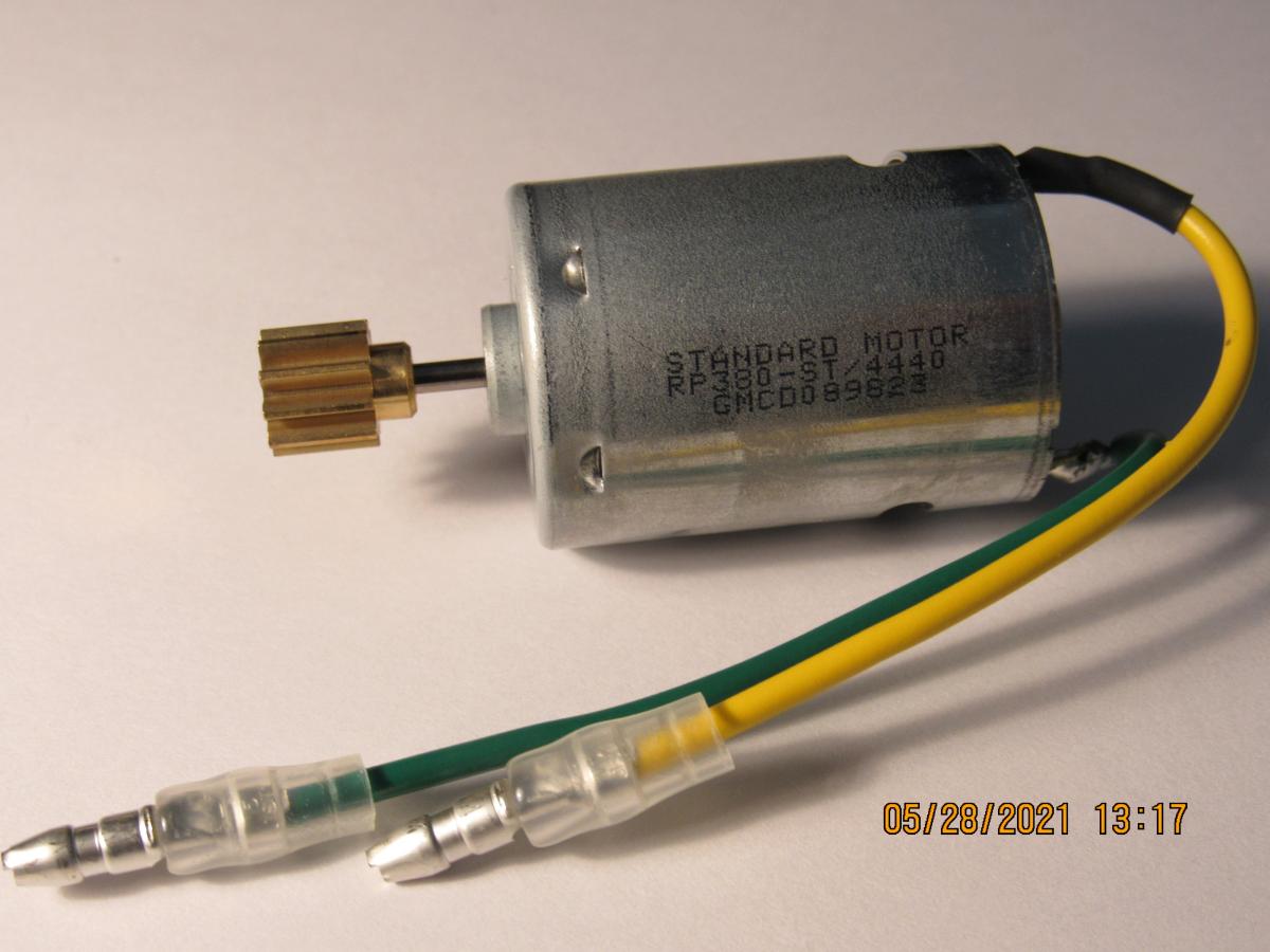

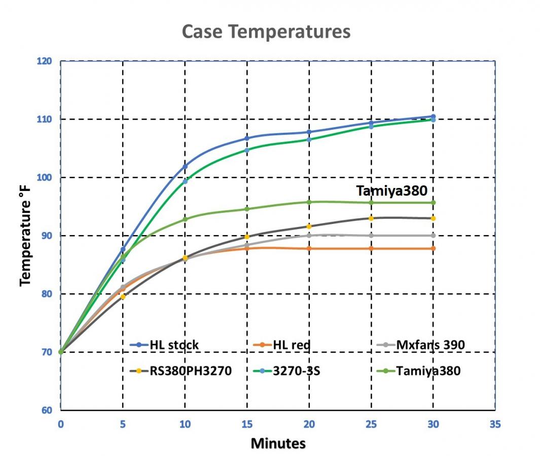

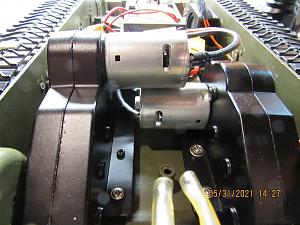

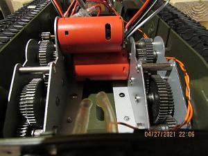

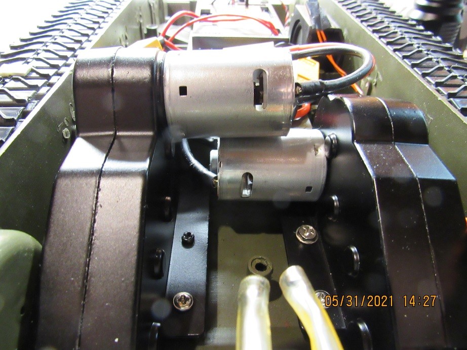

                          I took a chance. I cancelled the RC GP 380 order and gambling that the grasshopper 380 is the same motor. I won. Thanks to Rubicon99's tip.
                          The grasshopper motor arrived yesterday. It has the same "Standard Motor_RP-380/ST-4440" as in the picture of the Sheridan gearbox in Post #80.
ID:	314425Click image for larger version
                          The gear is bigger than the Heng Long one. No big deal? Well, there is a minor problem that I cannot use a gear puller to push the drive shaft out of the gear. The gear is closed ended. I have to build a little gadget to push the motor case out of the gear. The test is the most rewarding part. The motor rpm is 16,000 when cold and 18,000 after warm up, or exactly the range I am looking for. The case temperature stabilized at 26°F above ambient after 10 minutes. It is only 3°F warmer than the Mabuchi RS-380PH-3270, but 30% faster. A perfect upgrade for the Heng Long OEM grey 380 (14 degrees cooler). It is not the Tamiya 7435122, but I am convinced that it is the same custom built Mabuchi motor and the quality is high.

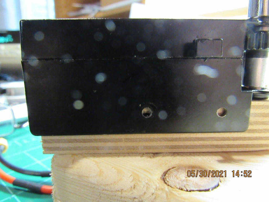

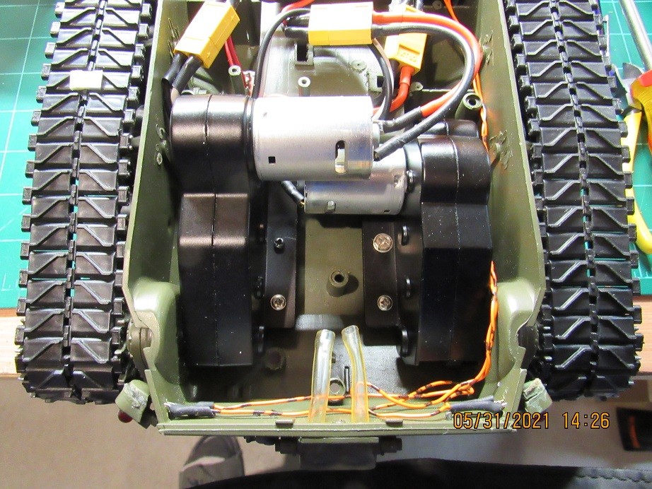

                                  The Heng Xin gearbox will not benefit from a break-in run. However, in both of the Heng Xin gearbox I received, the lithium grease was NOT spread evenly on the gears. It was just a big scope on the case wall and the gears were mostly dry. I used a craft stick to scope up the grease and reapply them evenly on the gears. If you were not mechanically inclined, I will highly recommend that you get a technician friend to do it for you.
                                  Click image for larger version  Name:	IMG_5004.JPG Views:	0 Size:	127.2 KB ID:	314658Click image for larger version  Name:	IMG_5005.JPG Views:	0 Size:	188.6 KB ID:	314659
                                  Since the grears and their ball bearings are all loose, be extremely careful when you open the case. The 2 case half are held together by 3 machine screws. It may be a little tricky to put them back together. Hold one of the case half horizontal with inside up. Put all gears and bearings in place. Carefully lower the other half of case onto it until all bearings are in place. The case slaps close and then tighten the screws.
                                  Click image for larger version  Name:	IMG_5007.JPG Views:	0 Size:	181.0 KB ID:	314661Click image for larger version  Name:	IMG_5006.JPG Views:	0 Size:	133.6 KB ID:	314660
                                  Click image for larger version  Name:	IMG_5009.JPG Views:	0 Size:	222.7 KB ID:	314663Click image for larger version  Name:	IMG_5010.JPG Views:	0 Size:	173.9 KB ID:	314662
                                  The pictures were taken when I changed the motors from the Mabuchi RS-380PH/3270 to the Tamiya 380 (which is really a Mabuchi RS-380PH/4045). The left side gearbox is simple. On the right side, one of the motor screw is hiden under the gear. I have to remove all the gears to access the motor mounting screw. In this process, nothing is difficult, but it does take some care not to lose any of the tiny ball bearing.
