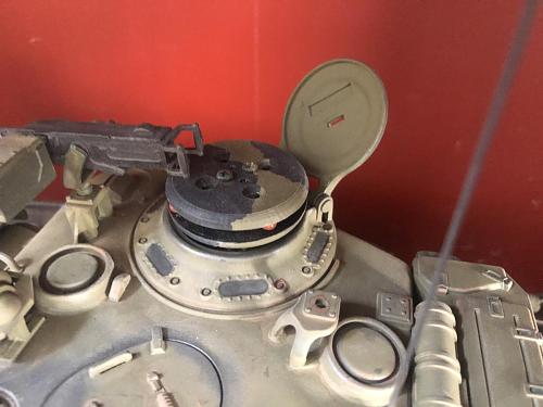

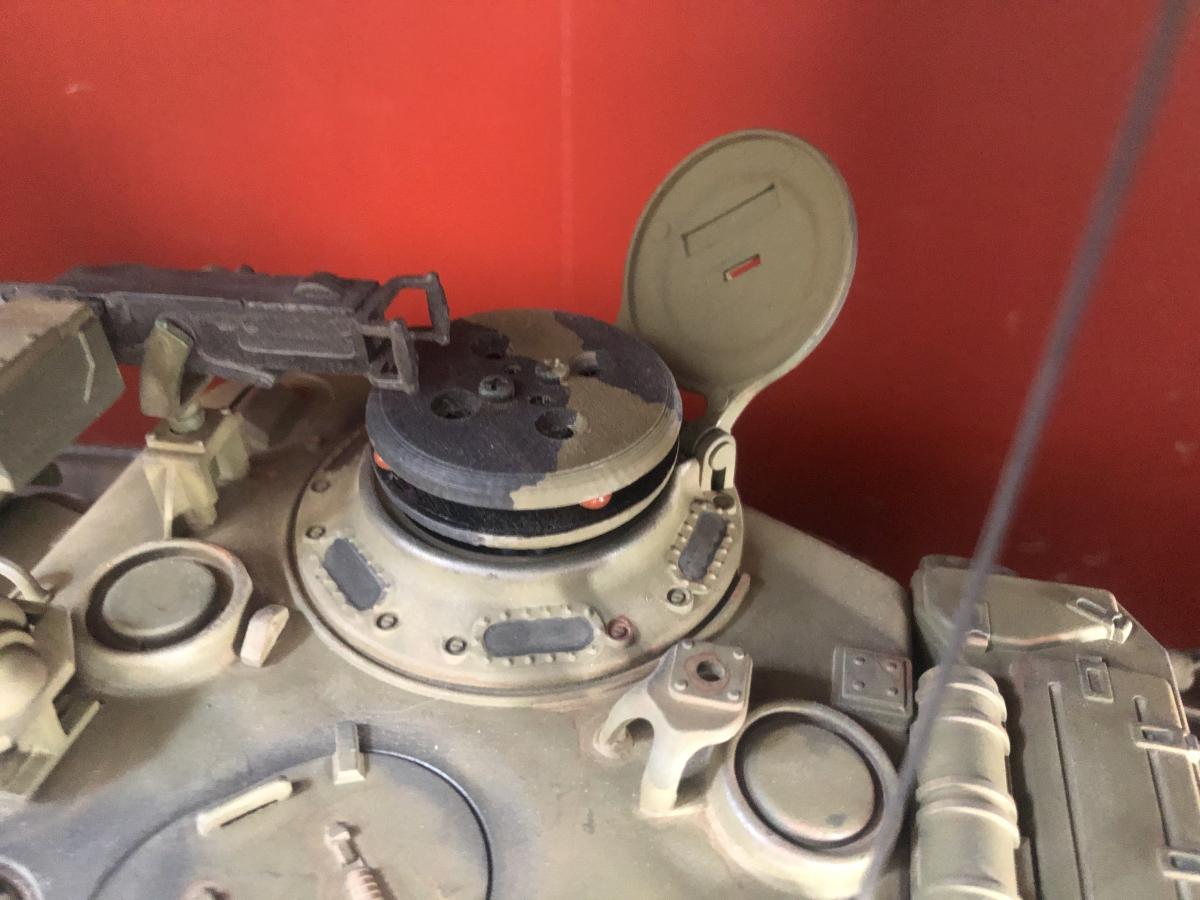

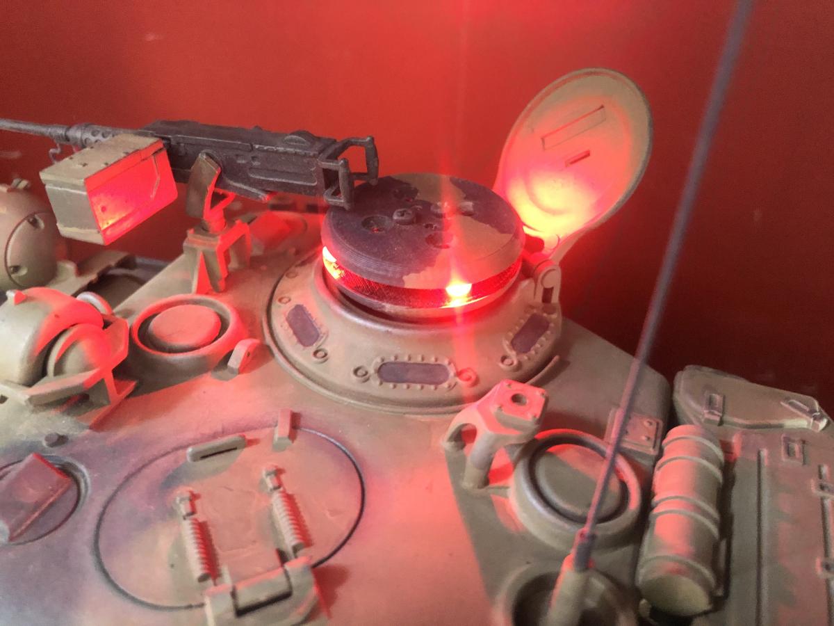

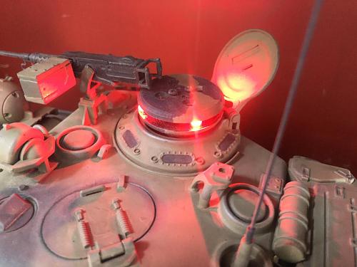

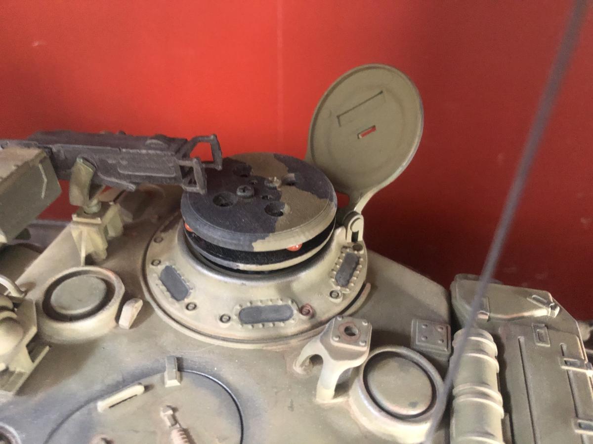

        With your background you will have no issues upgrading to the LegoDEI receiver.
        LegoDEI receivers are not 3D printed files, they are from the company LegoDEI and come complete.
        LegoDEI makes the receiver and sunshade for their receivers.

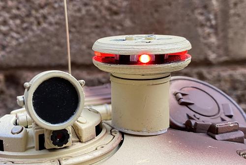

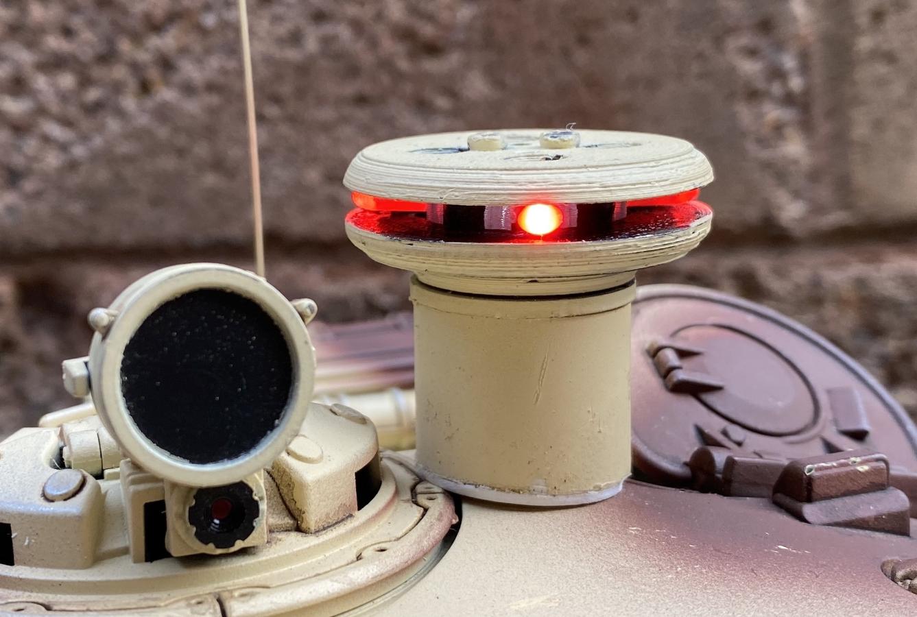

          Welcome aboard, Skyhawk. Regarding LegoDEI mounts, there is a dirt simple solution, just PVC pipe of an appropriate diameter cut to your desired length. I glue a base plate on the bottom of the mount that has a rare earth magnet inside, so you can place it on the magnet inside the tank. Here's an early example, I've since shortened the pedestal. Ultimately most of my tanks are outfitted like Rubicon's, setting the unit inside a hatch.

            Thanks SoCalBobS. I may ended up with the same setup as Rubicon. I am just trying to find a 3d file and see if I can DIY one. I have all kinds of 3d printed material most of the color that I like so if I can print one then that would be great.. I wonder if I can just buy the circuit board and use my own printed shade?

              LegoDEI does not offer their print files online because the shades are included in the price of the receivers. You can purchase extras for a minimum additional cost. Not really worth the time and effort IMO to try and design and then print your own to fit the LegoDEI receiver unless you are masking the look to hid it better.
