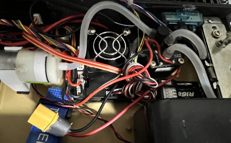

            The unit they use in the Pz3 is indeed with a fan (as opposed to the older "piston" type). as others had indicated, check the wiring and joints. But my sample from Motion rec'd last month had the same weak Taigen/Torro smoker, so I swapped that out with a different pump (cylindrical aquarium) and HL smoker. I used a shorter one due to hull restriction on the 3.
              Do you remember if the stock smoke unit you received made a fairly loud noise when it was turned on or was it silent?
              • sclui56
                • Mar 2021
                • 415
                • LAX
                Fan was near silent, smoker is just weak, can barely see any output. The fan-type smoker was definitely much quieter than the piston-type variety.

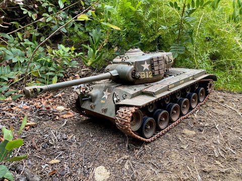

                    I've used the HL fan style smoker unit with success. The fan is indeed quiet. I take a couple extra steps; first, I use the model railroading "Mega Steam" smoke fluid, and second (gotta open up the tank for this, mine are on magnets) I fill the unit directly. Depending on the tank, the routing of the exhaust can make refilling almost impossible. The Panzer IV and King Tiger are two examples of this.
                    Here's my Pershing with the steps I mentioned.
