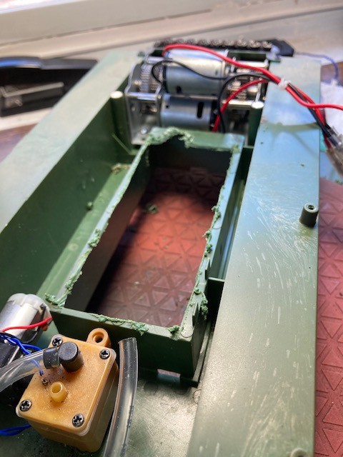

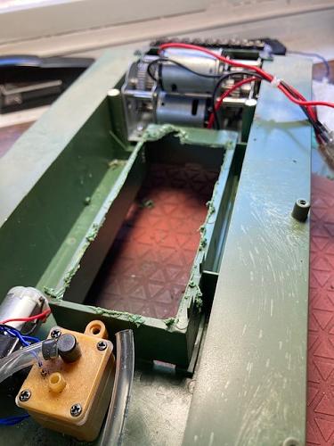

                  Welcome back to our RC tank hobby. For my M1A2, I cut out the battery compartment from the inside and put my board there. It has plenty of room in the front for my battery whatever the size it may be :-)

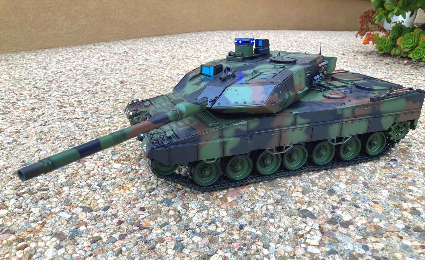

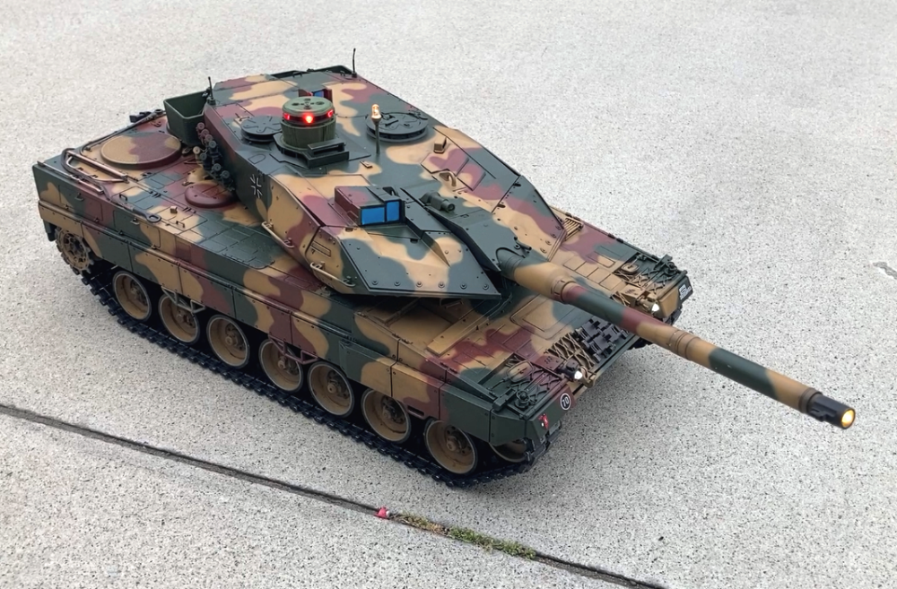

                    For the Leopards. I have 2. They both from HL. One is 7.0 and one is 6.0. One has metal running gears (quite heavy and a little slow). One has plastic running gears (except the gearboxes). They both had the same green camouflage color. I repainted the metal one to the yellow-red/brown color. I am about finishing them up for the SD battle on 7/31. They both run great and durable too.
ID:	350644Click image for larger version

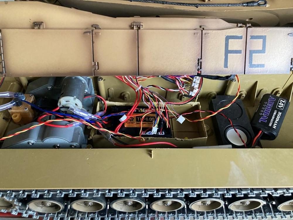

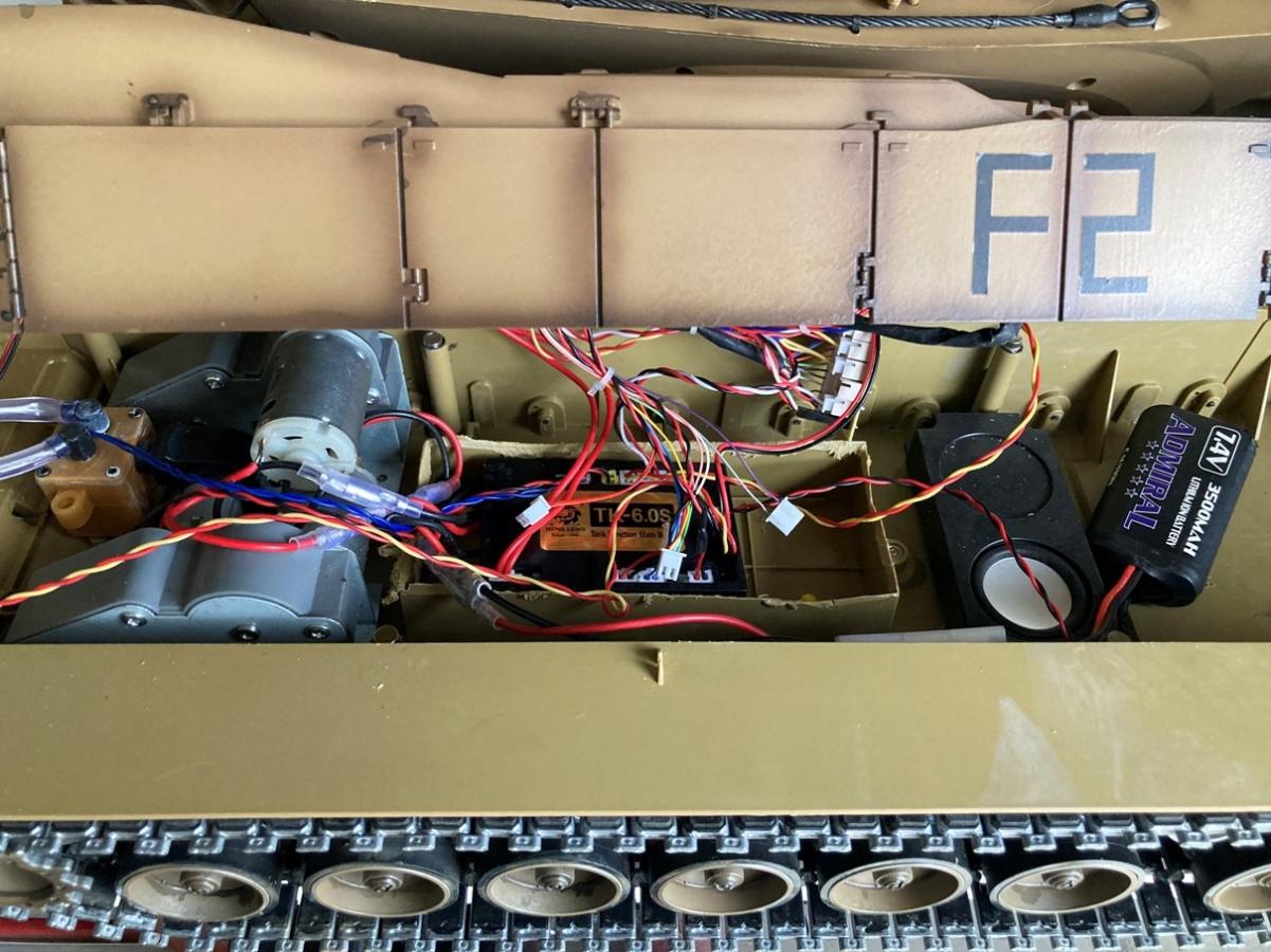

                      I am in the process of doing the same to the Sherman. I have magnets on the upper hull and do not want to deal with the battery screw in and out.
                      • #12
                        image widget
                        • #13
                          working on it
                          • #14
                            Stage one. Click image for larger version
