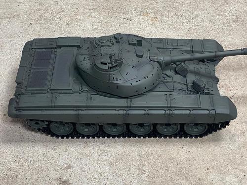

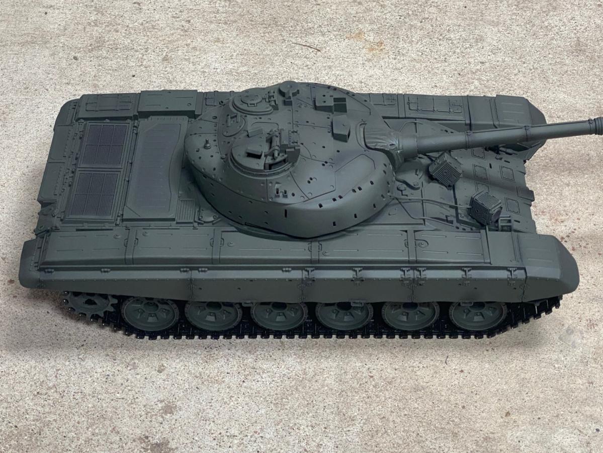

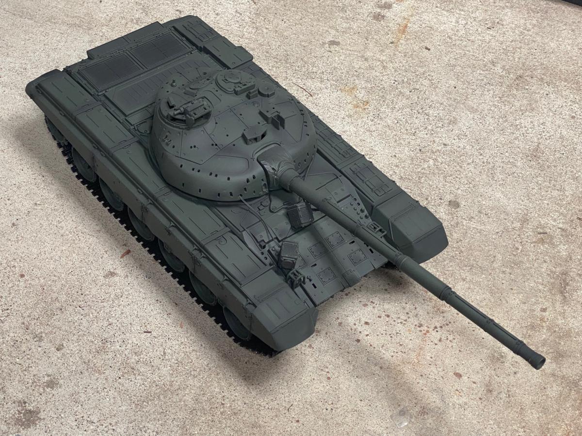

    I received my T-90 today from Toucan Hong Kong; four days from shipping to arrival via DHL. (Don't ask the shipping cost, but the heart wants what the heart wants!) I wanted what Toucan called the "blackish-green" scheme. They make three; tan, tan camo and the green. I also wanted the Red Eye feature, neither of which feature was available in US stock. I like to photo-document some of my projects, so here is the 'out of the box" state. It'll be fun using real time color photos and videos of the originals as reference.

    As is recommended at the top of this forum, I did a 2-minute check. Glad I did, because unnoticed by me, it also featured a 360 degree turret. Good news, bad news. Yes, it spins all around. But, and some of you already know what I'm going to say, there is a slip ring that keeps the turret wires from twisting and tangling from rotation. That slip ring is problematical, I highly recommend NEVER to add or get one. The IR system was non-operational. Ship it back to Hong Kong? I think not! What I did was bypass the slip ring for the IR emitter and receiver, and lo, all worked!
    There are some nice features I'd like to share. The on/off switch is on the back side not underneath. It's so invisible I couldn't find it until I'd opened the hull. The battery connectors are now XT60 type, no more godawful tamiya plugs.

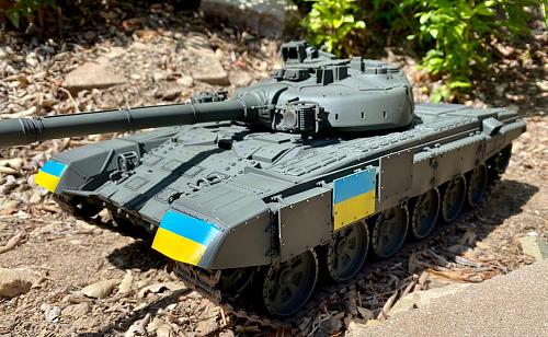

                  Just a teaser snapshot. The Russian tanks have Shtora-1 "red eyes". They're basically part of an infrared missile jammer system, but aren't apparently very effective against modern ATGM's. They look cool though, which is why I got them.
                  Why the tan camo netting? My battles in Southern California are mostly in desert'y areas. It's all removable.

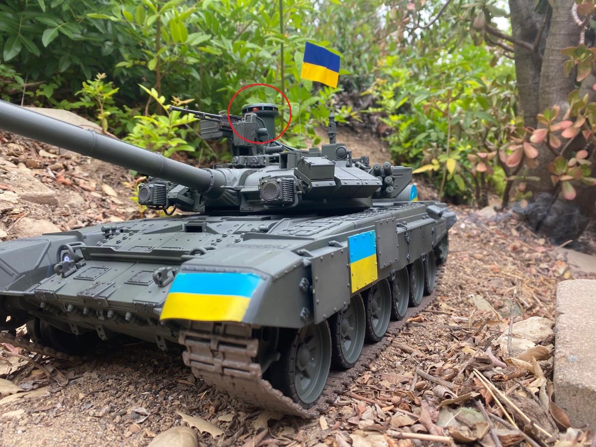

                              I found a neat way to attach the netting, without glue and easily removable. Carpet tape. very thin, nearly invisible, with a weave texture that if seen looks like it belongs there.

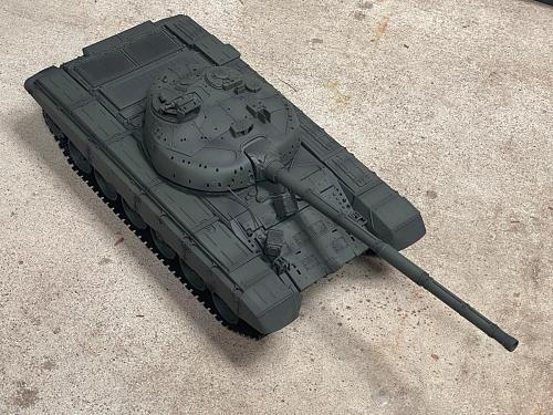

                                  #17

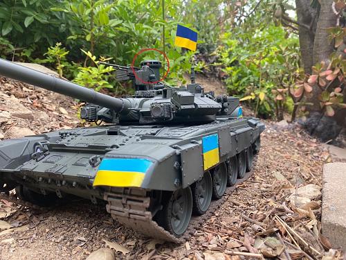

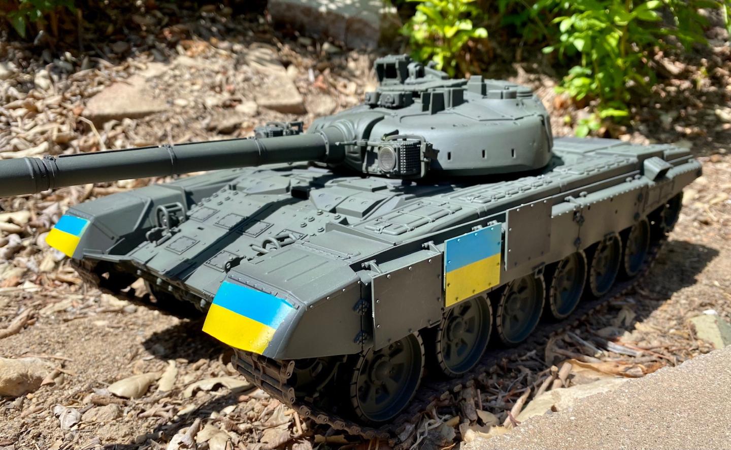

                                  Fight Ready. I've been hurrying to get this tank ready for the 7/31 SD battle. One never know at the start what might take a while to finish, but in this case no issues. It will of course require more detailing, but it's ready to rumble. There are so many external structures, I had to build a special pedestal for the IR receiver. Maybe that's why the jammers on the real ones are up high!
