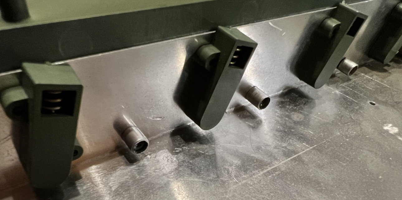

      Zip, my version is the BB, but if you do get this from Taigen/Torro, do note that you will want to do a few things to make her run better and last longer. Of all the Taigen/Torro I have, this one has one of the weakest designs in the lower hull IMHO, not directly the lower hull but the "swing-arm" implementation where they are mounted through the 2 side plastic pieces which bear the stress, so when the wheels are under compression, that forces the side plastic pieces to separate ever so slightly from the metal tub (only attached with screws and some areas are thru the suspension/spring towers).
      This flex alone can be eliminated by epoxy, and BTW, the factory doesn't sell the 2 side plastic pieces alone, if broken, they sell the complete lower hull with gearbox. Once you have the side pieces securely mounted to the tub, then you need to change out the washers to larger ones (I think #4) to fit at the back of the swing-arm to the plastic side, though you would need to grind the back of the swing-arm to remove the "key" casted in for smaller washers.
      Once this is done, she runs like a champ.
      EDIT: BTW, since the swing-arms are mounted to plastic boss (some may be cracked when new from factory), I sleeved all of mine with aluminum tubing (epoxy/glue) to keep them from splitting since the swing arms are mounted with a tapping screw. Some people went with a machine screw+washer+nut though.

          Couple pix to help visualize

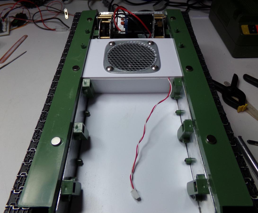

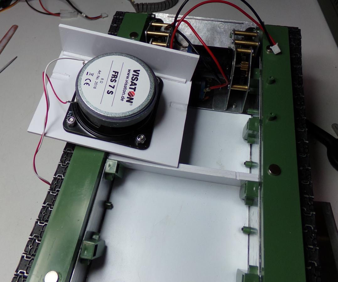

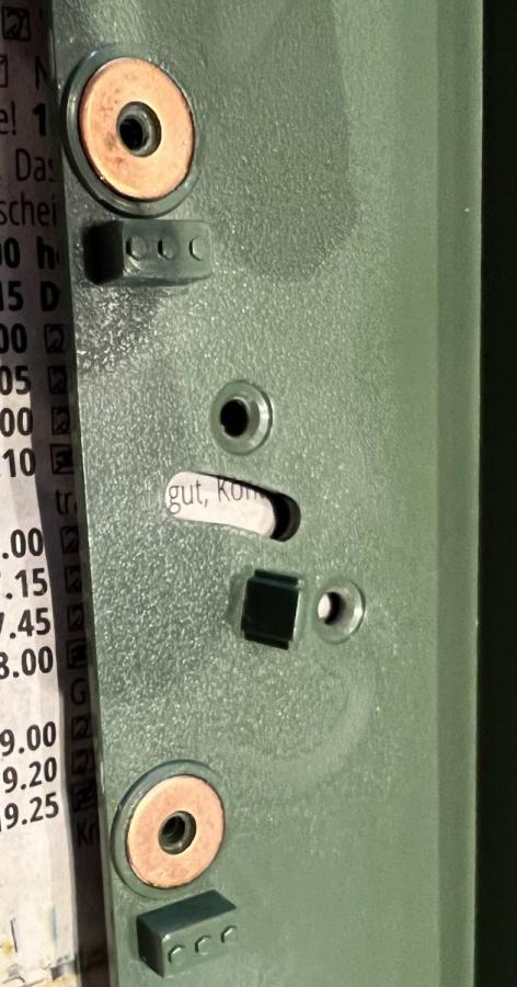

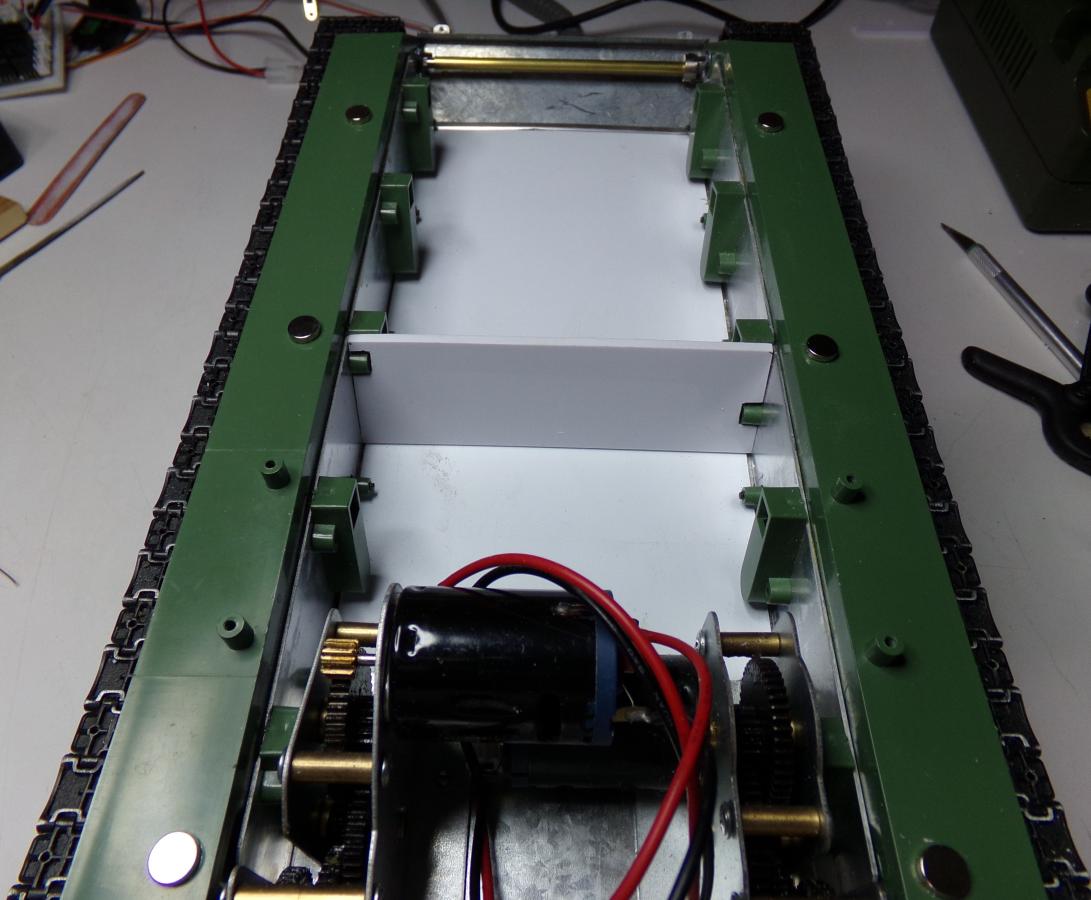

                  I started epoxying the chassis together, filling the final drive area with Miliput, removing the metal tab from the suspension arm, and adding the #6 washer to the hull when I started my T34/76 build back in 2018. I saw the same issues with the chassis flexing when the suspension flexed. I also don't like plastic on metal contact. I'd rather it be metal on metal. I had considered sleaving the plastic boss on the inside like that, but to this point I haven't had any issues with them pulling out.
                  I documented it here in 2022 as I've done this procedure to my SU-122, SU-100, T-34/85, T-34/76 1942, and T-34/76 1943 builds: https://www.rctankwarfare.co.uk/foru...p?f=23&t=33059
                  All of them are on Taigen T34 chassis.
                  I've also started building the speaker enclosure so that it spans the hull and therefore gives it some extra bracing. I used some 4mm ABS I ordered for a different project, but it's nice because it can easily support the weight of the Visaton speaker.

                    Looking back at the various notes I have on the Taigen T34 chassis, one of the more comprehensive posts for the remedy came from Tank_me from rctankwarfare, thank you! Also appreciate sharing the use of a speaker box as an additional brace.
                    Zip, while this chassis will require some work, but once modified, she is a solid runner, so don't let the shortcomings put you off.
