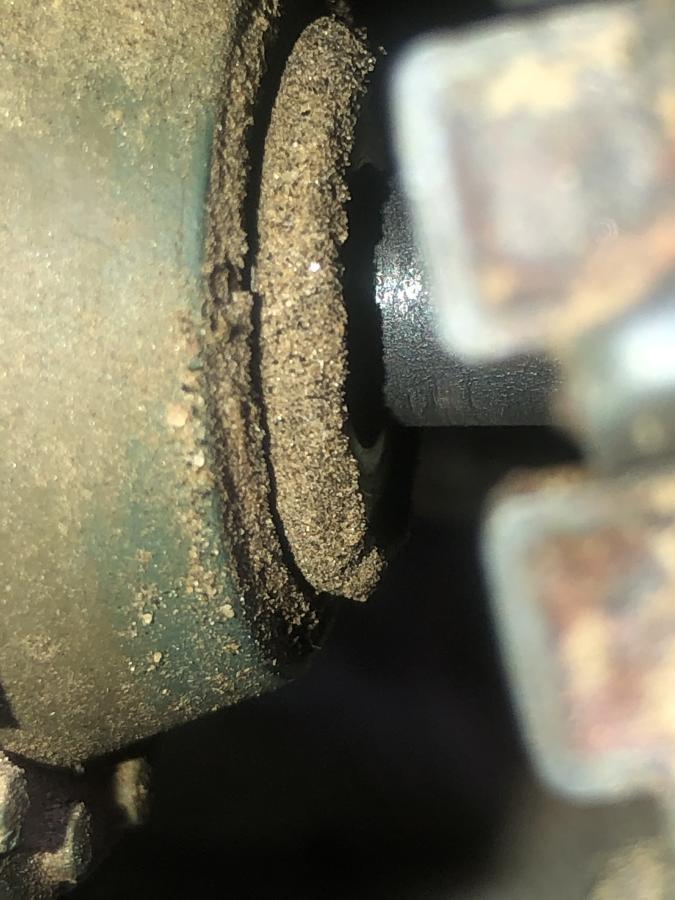

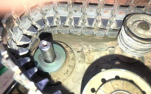

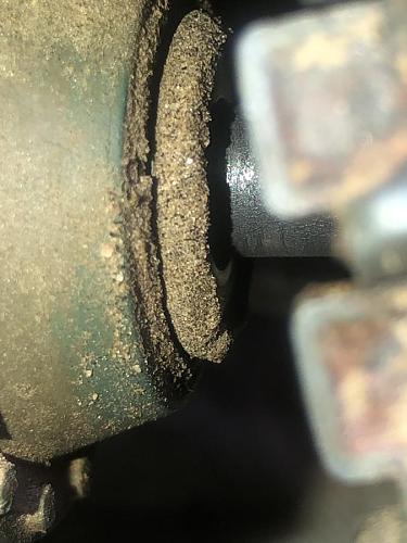

            First photo is of hull with no washer. Notice there is very little wear to the hull plastic. This is because the washer typically tend not to turn. It’s dirty grease I did not fully wipe off that you are mostly seeing. Click image for larger version  Name:	9FAB338C-D801-45D4-891A-C1C64952D350.jpg Views:	0 Size:	238.0 KB ID:	357511

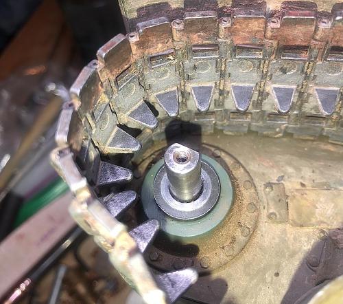

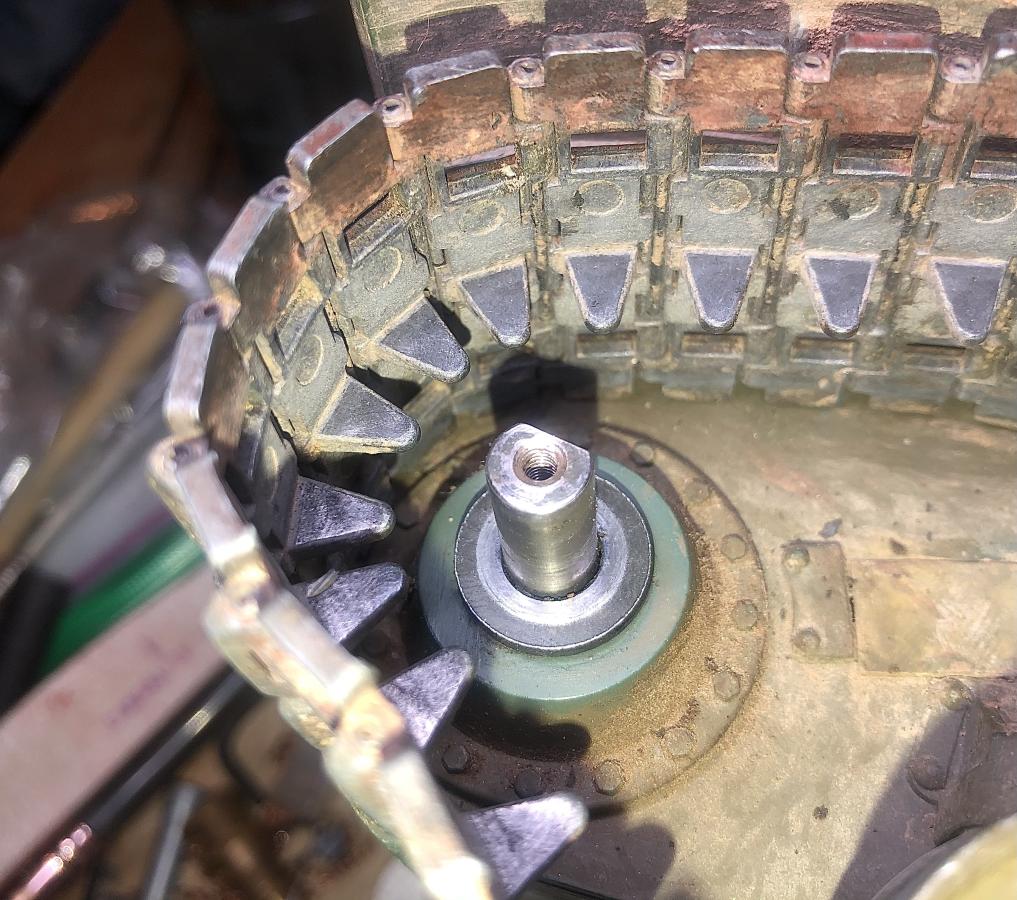

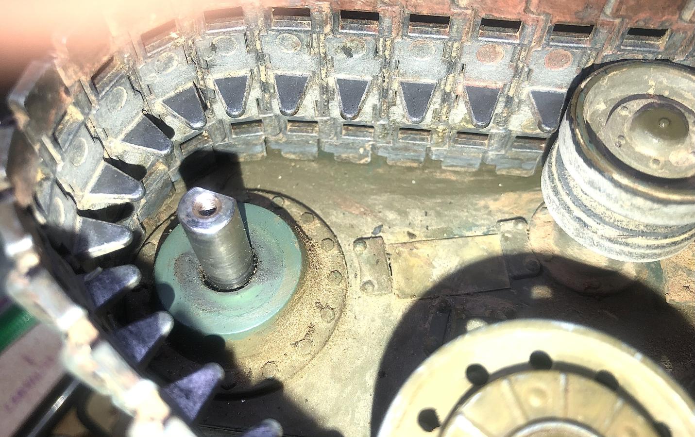

            Second photo is with washer installed with no grease. Notice the light wear on the washer from the sprocket turning in contact with it. This washer is SS because it is on my hardest run KV. In fact this KV is my most abused tank. Click image for larger version  Name:	3B7749CE-971E-4B3D-9E7D-66621EFB816F.jpg Views:	0 Size:	153.9 KB ID:	357510

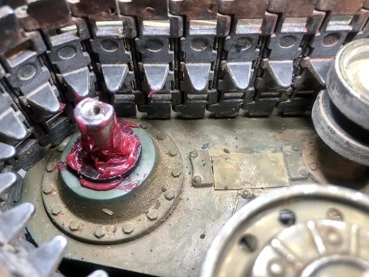

            Third photo is of the grease I use when reinstalling the sprockets. I exaggerated the amount in the photo and much less can be used with nylon washers. Yes dirt will stick to the outer edge of the washer where grease is pushed out but this has NO effect on the tanks operation. Click image for larger version  Name:	BFA98588-BBD2-473A-840E-3E3A51672FA5.jpg Views:	0 Size:	182.4 KB ID:	357512

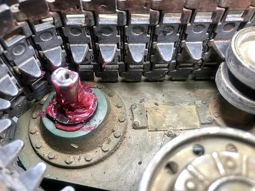

            Fourth photo is of dirt adhering to the excesses grease on the outer edge of the washer. Again this dirt has no effect on the operation. Click image for larger version  Name:	3EC035B2-8A37-446F-A5CD-B932EDA6F0B2.jpg Views:	0 Size:	75.0 KB ID:	357513
            • #7
