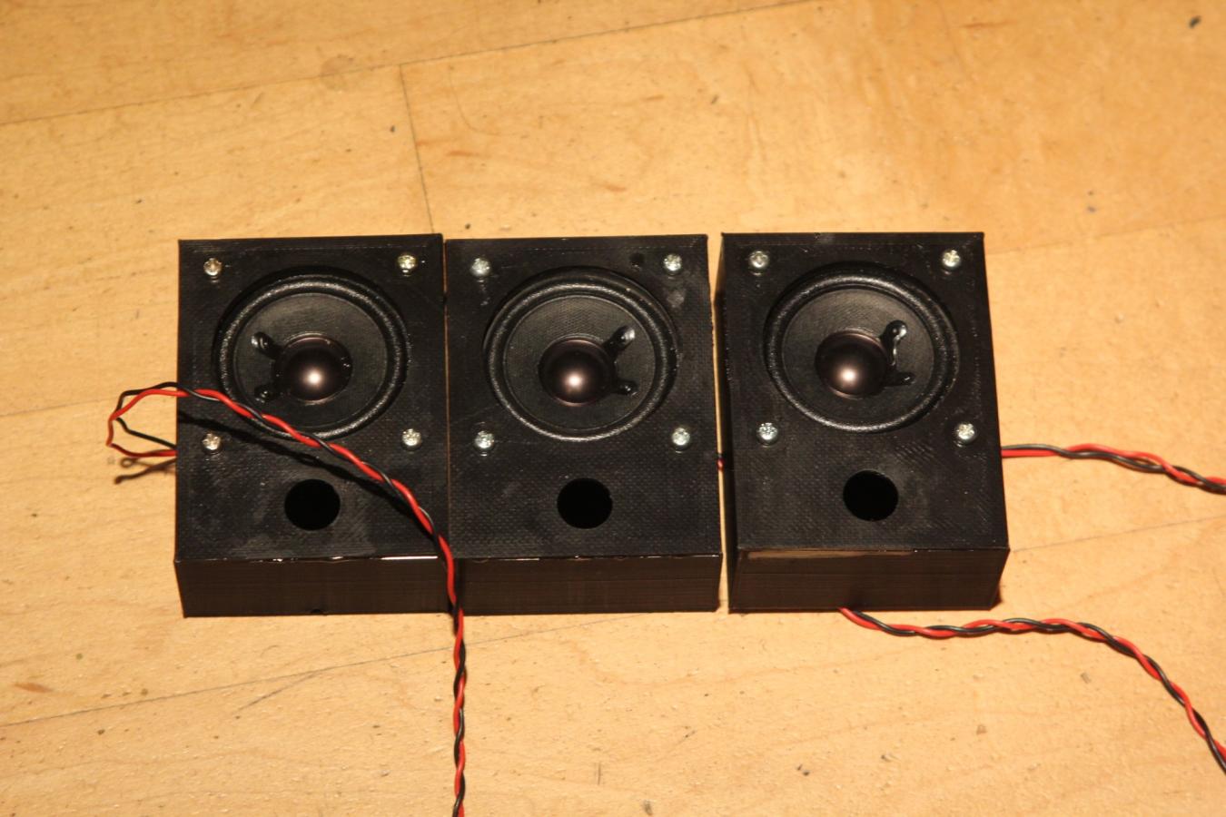

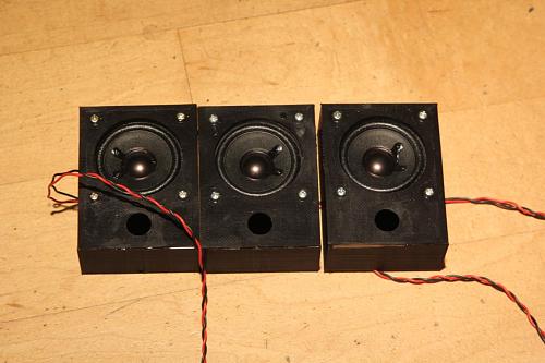

                                I second that! I got some of these Visaton speakers from Kenny at Dakrctank. I am very happy with them.

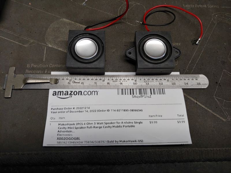

                                  So the stock speaker that came with my heng long t90 is a 4 ohm 3w 2 inch speaker.
                                  The speaker that I removed from a bluetooth speaker box was a 2 ohm 3w. the result was a lower weaker sound not to mention the speaker blew. LOL
                                  so i ordered these on amazon. The t90 is very limited on space inside the tub due to its low profile design.

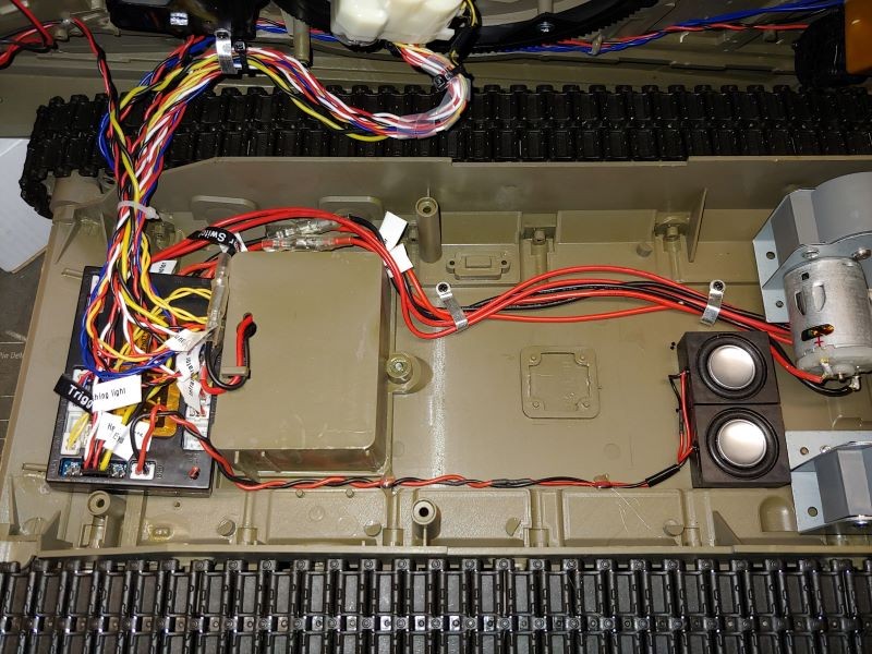

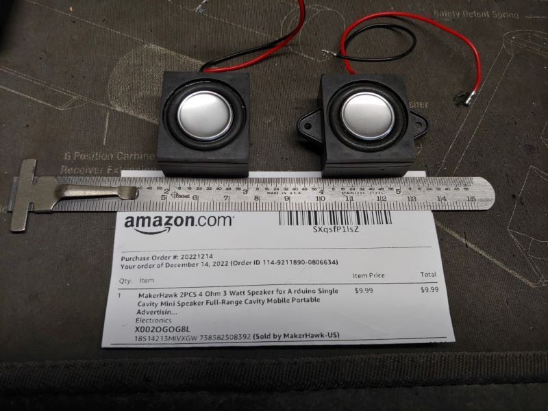

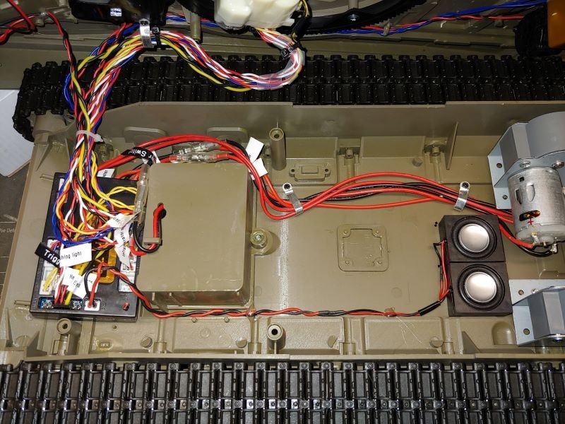

                                      #19
                                      Well I ordered and installed the two MakerHawk 4 ohm 3watt speakers I got through Amazon in my T90 with the TK-7.0 board. I trimmed off the two mounting tabs on each one, hot glued them together, wired them in series and hot glued them in place at the rear. They are louder on full volume than the OEM speaker that came with the tank. The low profile of the speakers was excellent for clearing the wiring harness & turret rotation. I'll keep you all informed how they hold up under constant full volume applied.
                                      Click image for larger version  Name:	1219221125.jpg Views:	0 Size:	115.4 KB ID:	364511
                                      Click image for larger version  Name:	1219221250.jpg Views:	0 Size:	155.5 KB ID:	364512
