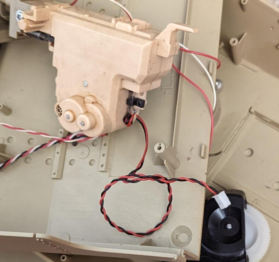

    - I have a 2-wire connector hanging off the Airsoft recoil switch that has nowhere to plug into;
    - The gun elevation motor won't activate;
    - Not sure everything is plugged into the right places...

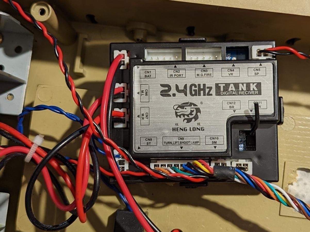

    - And there's a sketchy looking cut wire sticking out of the MF unit (see picture below)... antenna?
    Orphan wire connector (lower right), with no place to plug in:

    My old multifunction board:

    From the looks of the MFU, it is a HL 5.3 2.4Ghz system. That black wire coming out is indeed an antenna. I believe the orphaned wires are the airsoft trigger wires, but I could be wrong as I typically dump the BB systems out of all my tanks. There are differences in the wiring, but if you can change some connections it should be able to be converted to a 6.0/6.1/7.0, or 7.1 system. You will need both a new RX and TX as none of the 5.3 stuff is compatible with the newer systems. If you are going to keep everything stock as it is, get the 6.0 or 7.0. If you are going to convert some stuff to servo control get the 6.1 or 7.1. Being an Abrams the 6.1 comes with the Abrams sound set installed and I believe so does the 7.1. The 7.1 is newer and does have some newer features the 6.1 does not have. Keep in mind that they also use different transmitters. You can't use a 6.x transmitter with a 7.x board and vis versa. There are wiring diagrams of both systems available. The 8-pin daughter board will probably be different for the newer systems also, but you can rewire around it or convert to the newer board.
