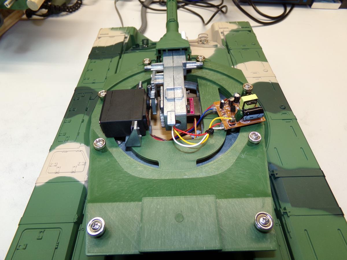

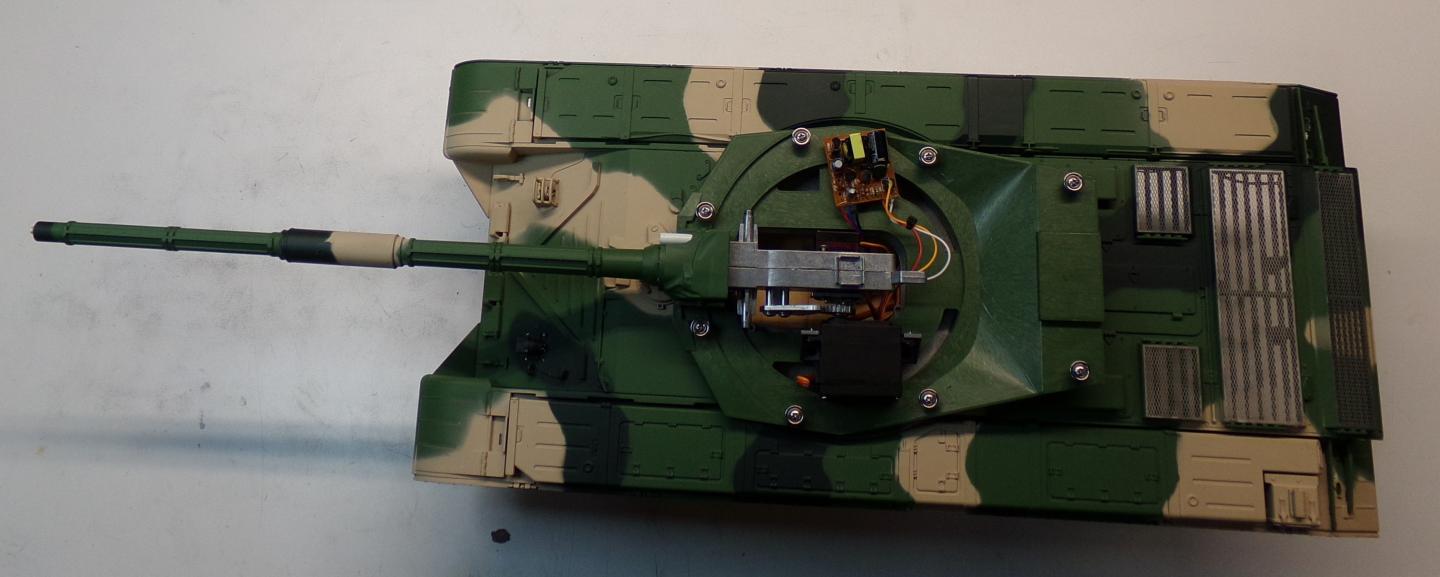

I have one of these units in my Heng Long ZTZ-99. It is quite nice, but as you said it wasn't a straight forward install. Works really well though, but it is quite bulky. I wouldn't use it in a tank with a small turret. Modern tanks would be more suited to using it.If your McGiver skills are up to snuff, I bet you could get this to work..

Roger that. More than likely I will be ordering one for another of my current tanks in need of fixing. The Torro barrel elevation/recoil unit sux and doesnt play well with the IBU2. Thanx for the feedback.
Let me ask, with that servo unit would you be able to run a tube down the barrel? The pics I see dont make that clear.Comment
Thank you my fellow Texan ! I purchased (Along with the IBU2) the barrel smoke / flash kit from Stanlley. I already have one outfited in my King Tiger, and wish to add it to the Jagtiger. The tube for the smoke is a tad over 5mm in diameter. Think I can make it work, even if I have to enlarge the hole? I purchased the unit last night-no turning back now. Looking at your picture, Im thinking I should be good.Comment
