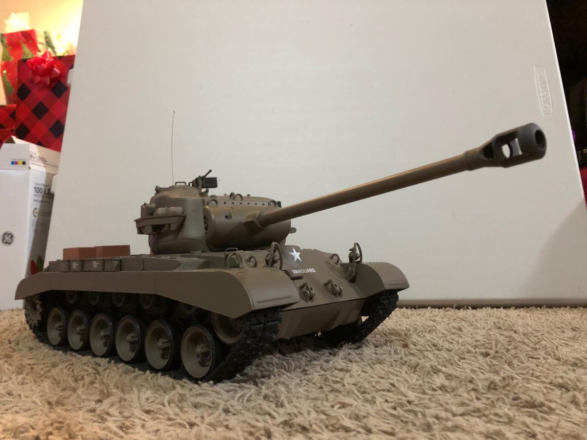

    Alright, I did it; I've ordered parts from here or there and they've arrived. I've got some work ahead of me now.
    Kenny (DAK) sent over the electronics for my Pershing; the Clark TK50E, and the FlySky radio system. I had already ordered the connector kits suggested in the other thread which has been a huge help so far (thanks tank_me!). I've also received a longer recoiling barrel and a barrel smoke/flash kit. I'm going to switch the recoiling system over to a servo though. The barrel came from Toucan on ebay but is a few inches longer than what is on the tank now; I have heard that the original barrel is too short for scale, but this might be closer. I did also receive a LegoDEI IR receiver (for this and at least 1 for another tank) and some of the high output IR emitters.
    As I go through this conversion I'll be taking photos of the process, and will definitely get video once it's complete. There's a lot of wiring to do... and I'm still on the fence on re-painting the tank. I'd like to make it more "my own" for sure but at the same time I want to end up with something that is somewhat realistic looking. There will be some other bits & pieces I need to either purchase or make during this process but I gotta say, I am happy that I went with the Clark board at this point. Not only for the sounds, but so far as I'm testing things out there seems to be better (finer) control over the turret and main gun as well. Kenny hooked me up with the new E variant for the M26 and it's got some cool additional voices, and 1 track of parade music...

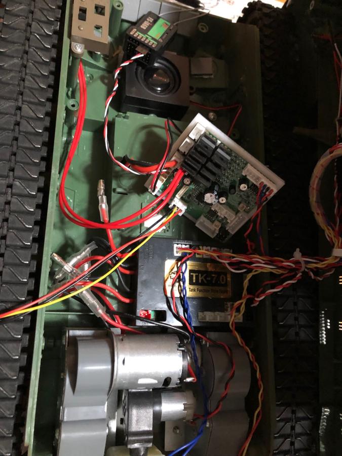

      I made some progress but this is time consuming (along with other holiday projects). Photos from yesterday, just getting started.
      Click image for larger version  Name:	IMG_0717.jpg Views:	0 Size:	90.3 KB ID:	363909
      What I found today though is that the Clark board does not fit where the HL board fits; it's too tall. It's now sitting next to the battery compartment, on the Right side. The receiver is double stick taped to the Left side. I located a pair of volume control pots on Amazon although the wiring is backwards; not a big deal, just needed to switch a couple wires in the connector to make it function. The drive motor wires had to be lengthened and it appears I plugged them into the wrong sockets as left turn = right turn, and vice versa. Easy fix that I should be able to get to tomorrow...
      The small speaker is handling the output just fine but with the hull together it reduces volume a bit and muffles the output. I may end up going with a bigger speaker later on just for more volume 😎
      So I need to disassemble the turret and see what I'm going to do for the smoke & flash unit still, before connecting any of those wires, in addition to swapping out the IR emitter. I still need to modify the new gun/airsoft unit for the servo recoil as well. I've been reading the "manual" online for the Clark board and I'm excited over all the features and adjustability it has. The more progress I make, the more interested my daughter is now as well!

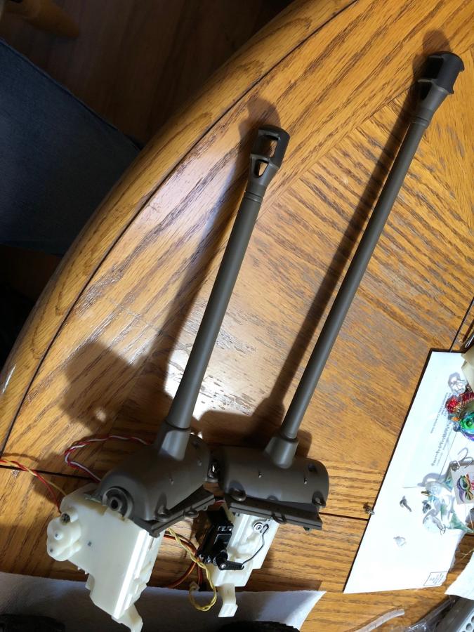

        Your not going to use the airsoft-Right? So get rid of it or chop off the bottom half for more clearance. I modded my Mantlet to fit the aluminum Hellcat barrel and then used the Clark recoil. Works flawlessly. Click image for larger version

          Some progress last night.
          I disassembled the airsoft unit on the new gun and cut the bottom off. I also cut off the nipple from the firing mechanism but kept the large cylinder, but removed everything else. The barrel still connects to the large cylinder which seems to keep it stable and gives it positive stops, as well as the small return spring, but I will mount the servo on the side and connect it with a small servo rod to try and get the right travel from the servo arm. I didn't get photos last night but I will tonight of that progress.
          Hopefully, removing the nipple from the firing mechanism will allow enough room for the smoke tube along with the LED wiring to pass through the loading port into the barrel. I was thinking that it probably doesn't matter how far down the barrel that silicone tube goes, but it may be beneficial to trim the length. Not sure on that yet but hopefully I'll have time to test that out this weekend, of course before installing the new assembly :)

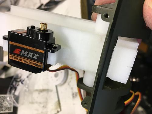

                I was thinking something like the old coffee stir sticks (that look like tiny straws) could be an option. The nice thing with this tank now is that I have a "spare" main gun assembly, including mantlet :)
                I worked on the recoil last night and apparently after getting my covid booster didn't get all the photos I thought I was going to get 🤔

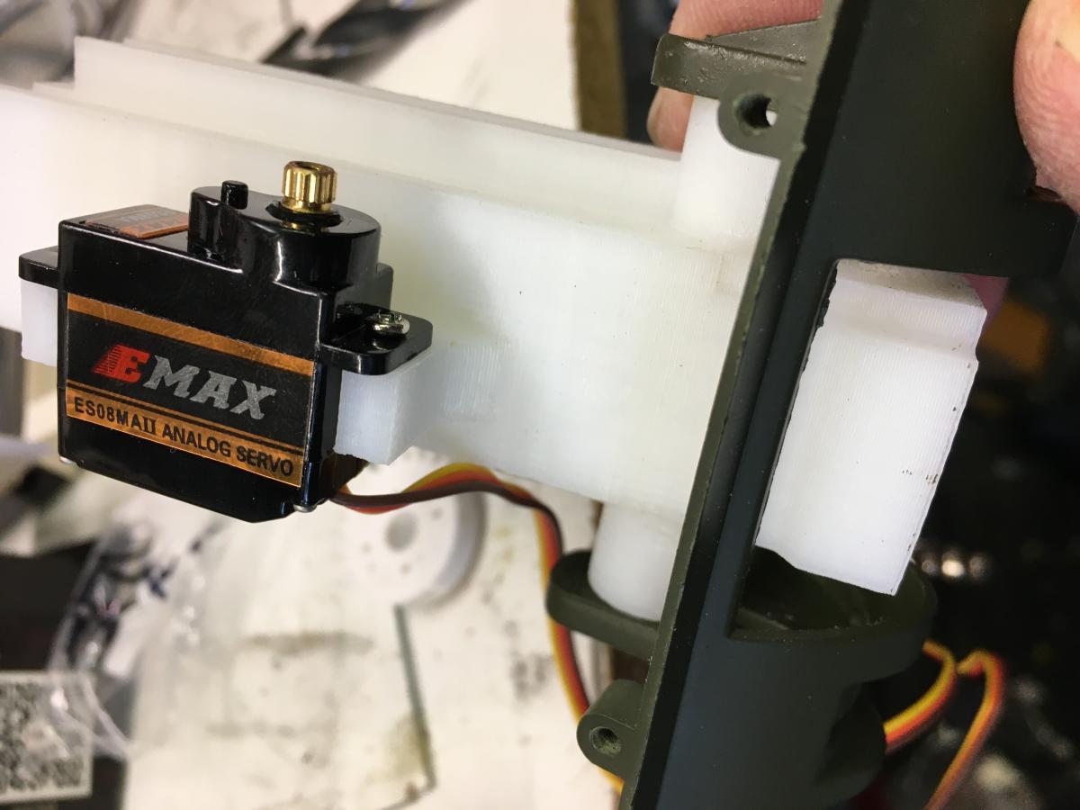

                I used the remote to adjust the servo direction which worked great. For lack of a servo mount, I gave it a suitable location on the side of the breech and drilled 2 holes to pass a zip-tie through, and added 3M double-sticky tape (the gray stuff). Drilled a small hole in the arm for the gun recoil but left the arm connected to the cylinder with the small return spring. I added some bends to the linkage between the servo and the arm, for adjustability and it works well. I did have to trim a lot from the airsoft loading channel to make room for the head of the servo, but since it's not shooting airsoft that doesn't matter. The loading channel is used as support (a pivot point) for the main gun though and is necessary.

                  looks good...an easier way to add servo recoil.......
                  • ccarley
                    • Jun 2022
                    • 158
                    • Rohnert Park, CA
                    That looks like a much better method Zippersnapper, the servo has a lot more support mounted that way for sure! I'll remember that for next time.

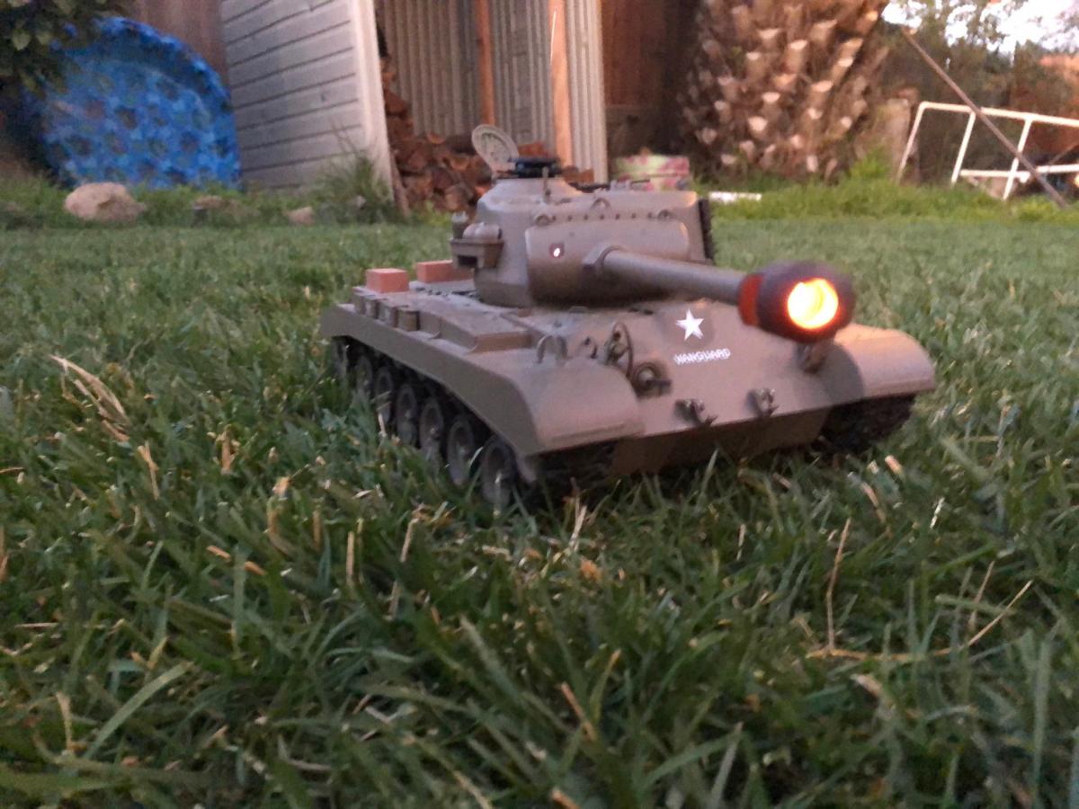

                    I was able to spend some time over the weekend on the tank and got the muzzle flash LED and smoke tubing in the barrel, trimming more of the loading channel to make room for the tubing to exit. The smoke unit and control board seem to not work as intended unfortunately. Any time power is applied to it's power plug, both the smoke unit heats and the air pump starts going. It doesn't matter if the trigger wire is "triggered" or not so I need to see what else I can do there. On the smoker topic, can I give the heating coil full battery voltage for engine smoke (and barrel smoke)? The TK50 appears to not have an internal switch for that, but looks to require an external manual switch to activate the blower motor.
                    I had placed the LED right at the end of the barrel in hopes that, while not really poking into the muzzle break, the flash with smoke would give a nice effect anyway. Well, even without the smoke, I found that as the barrel recoils, the LED is exposed making it brighter, and then once the barrel returns it's basically hidden again. I like how that ended up 😎 and will be getting video of course soon.

                      Clay, I wish I could give constructive advice on your setup as it pertains to the Clark style of boards, but I never was able to wrap my head around them and traded off all that I had.
                      I have however installed many barrel smoke/LED setups. If you have a Henglong board lying around, step one would be to verify if its in working order. If it still wants to run without being triggered, then the unit (control board) is probably defective. If bought from Toucan or one of thier sellers, ask if they will swap it out-chances are they will. As far as the LED poking out the barrel when fired, Its going to do that unless you put a tiny dab of super glue on the LED itself, place the LED where you want it while the barrel is fully extended.

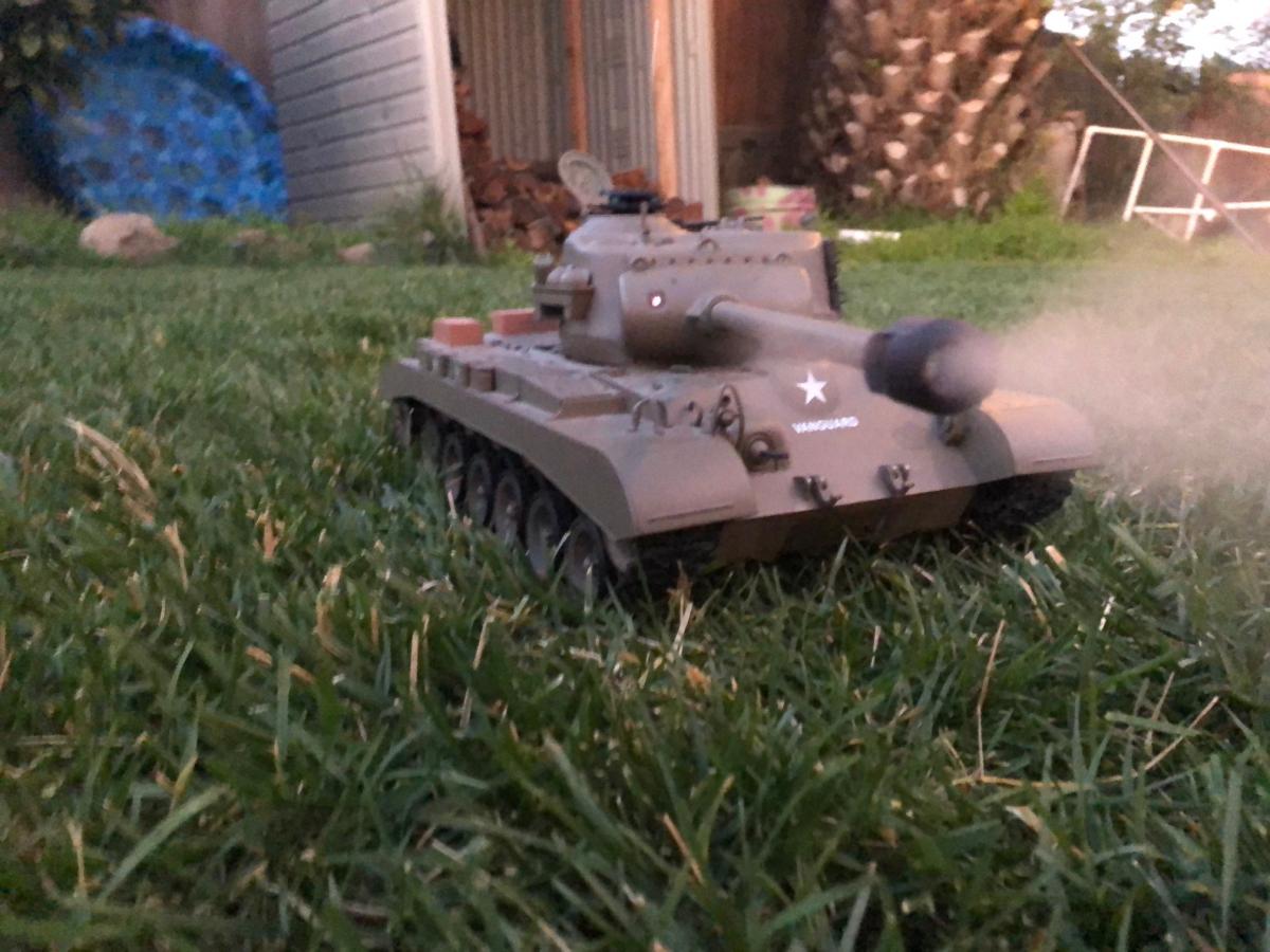

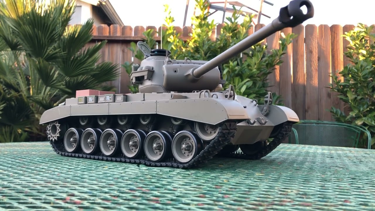

                                    We've had some sun for a bit now to dry things out, and I was able to mow the grass after work and do some "testing" in the back yard. No photos or video unfortunately but wanted to share the results of the testing.
                                    Hidden across the yard 20' away was my HL KV-1. Only mod it has is the LegoDEI receiver mounted on top. As I was by myself the enemy tank just hung out hidden next to the wood shed.
                                    Firing up the Pershing, the engine smoke goes well enough (although, it may have too much fluid in the tank but it's not over the heating element). Driving it with the Clark is different especially since I disabled the tight turn feature; the tank only turns if you have the stick pushed left or right and throttle is applied. Pushing the stick left or right with no throttle results in no movement; expected behavior. The Heng Long with disabled spin does turn if you push the stick left or right, it just won't do a 360 in place anymore. Anyway, shots across the yard to the KV-1 work well. The high output IR emitter in the original location still needs to be aimed pretty much dead on to register a hit. The flash and barrel smoke are much cooler in "battle". I noticed in the instructions that the Clark has "momentum", and I can see that when traversing the turret. Not only will the turret traverse faster (or is it just smoother?), it takes a moment to slow down after movement.
                                    I need to get some more paint thinner before I can start weathering but I think, aside from the recoil not functioning at the moment, it's ready. I haven't opened it up again to try re-programming that or test with another servo just yet for the recoil. I'm going to "need" a new tow cable... probably something like an actual cable and not just the molded plastic thing. One of the tow hooks is missing in the grass somewhere as well, so I'll have to figure something out that works better there. Audio... I will likely be picking up one of those Dayton speakers and attempting to see what kind of box I can fab up for it on the 3d printer. There's really not a lot of room in the hull at this point; the air pump for the barrel smoke is in the front of the hull which limits space for a speaker but maybe I can make a box that is small on the bottom and gets larger where there is space, so then the speaker could mount in it. I am super stoked though with the way this tank is running now
