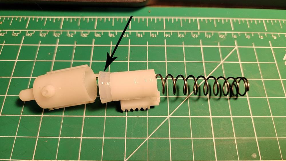

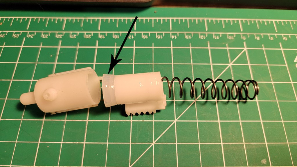

          Make sure the BB plunger cup thingy isnt screwed up somehow. Henglong airsoft uses compressed air to fire the BB....rare granted, but if the cup seal wasnt lubed then it could have distorted/ripped and lost its ability to compress the air.....just a thought.
