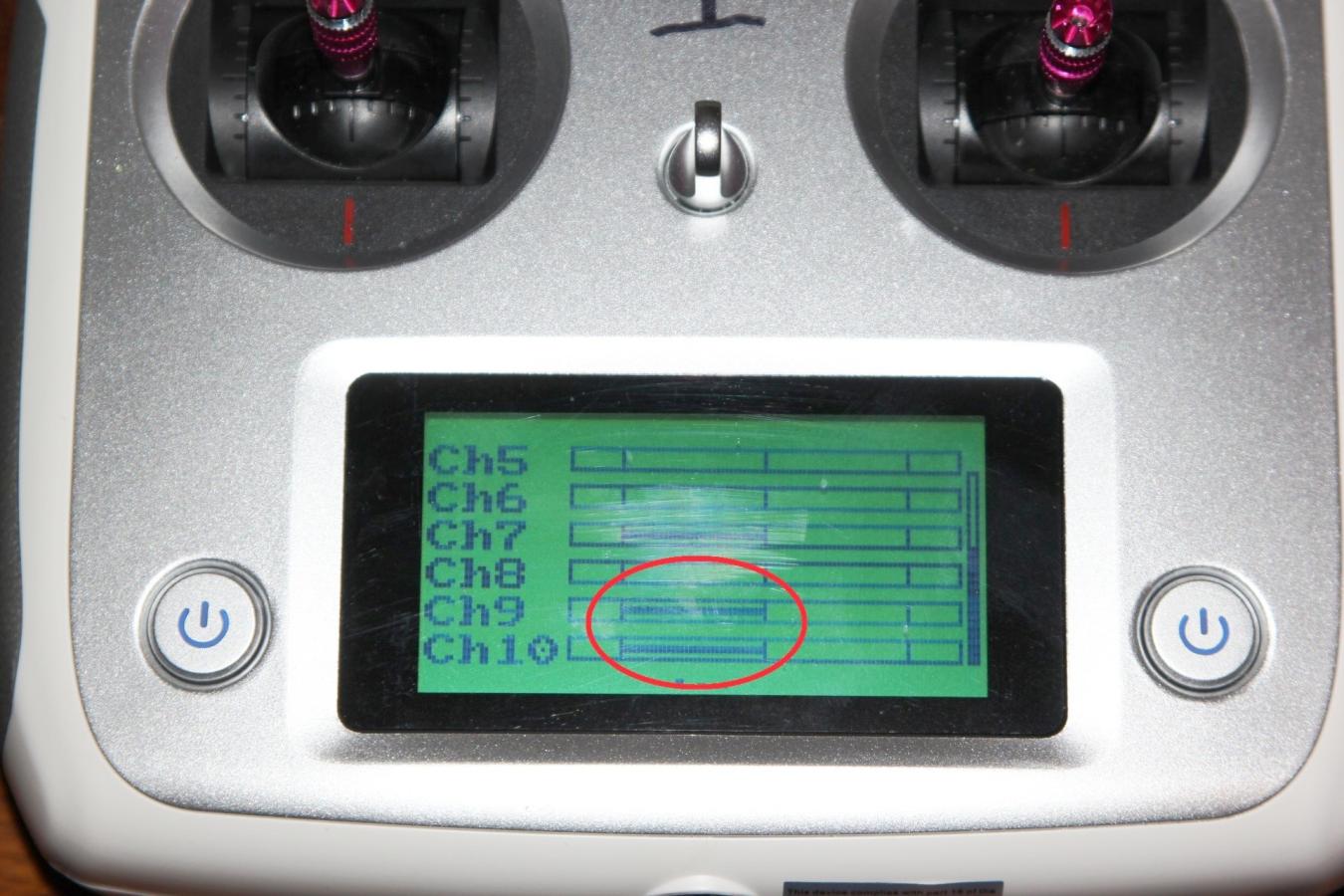

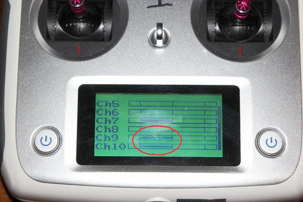

    I got my FlySky Tx from Kenny DAKRC. I installed the Clark's board in my tank. The VrA and VrB was assigned to the 2 MGs and canon fire. Everything ran well. The problem I bumped into was that the two rollers VrA and VrB. They did not return to their centers and the MG/canon features kept firing. Does any member knows how to correct this? I did the check in the menu screen I saw that the bar just went to one side and stayed there after I let go of the roller. Once I turned the roller to the opposite direction, the bar stayed at the opposite direction and did not center itself. This happened to both side of the Variant rollers at the top corners. Thank you!

              The bars of the signals on both channels remained on instead of returning to the mid-lines.
