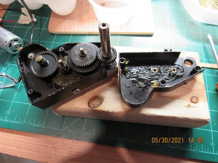

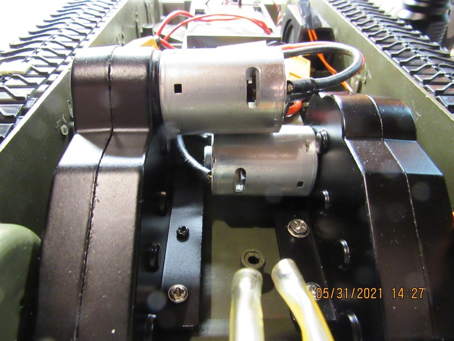

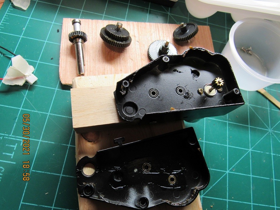

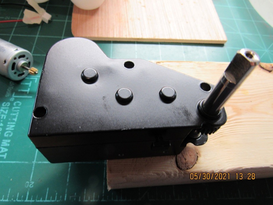

          Please, do not put any liquid oil or lubricant to your RTR tank. only grease can be used in certain way. Oil vapor will make a bigt mess of your tank internal. Worse yet, it is corrosive to electrical contact and some electronic components. (I know because I worked in aerospace industry for many years and retired as a technical fellow.)
          A good gearbox should be mostly enclosed. I use the Heng Xin gearbox here. The very thick wall construction and sealed ball bearing make it very stable and extra quiet. Some heavy grease was applied to the gears. The ball bearings are sealed bearing that does not need lubricating.
          Click image for larger version  Name:	IMG_5004.jpg Views:	0 Size:	127.2 KB ID:	365018Click image for larger version  Name:	IMG_5005.jpg Views:	0 Size:	188.6 KB ID:	365021Click image for larger version  Name:	IMG_5007.jpg Views:	0 Size:	181.0 KB ID:	365020Click image for larger version  Name:	IMG_5010.jpg Views:	0 Size:	173.9 KB ID:	365017
          The Heng Xin gearbox uses a separate mounting plate. It adds to the steadiness of the gearbox, but makes installation of the gearbox a two directional movement, thus more difficult. You do not need special tool or skill, but do need a lot more patience to maneuvers the gearbox in place.
          Heng Long knows better not to use oil. They use cheaper open frame gearbox without bearing to save cost. But they never apply light machine oil to their gears.
          There are several options for enclosed gearbox. I chose Heng Xin for its tight tolerances and cheap price. I like its approach and result a lot.

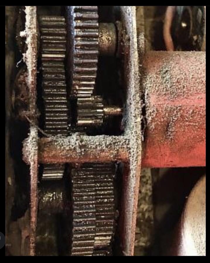

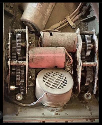

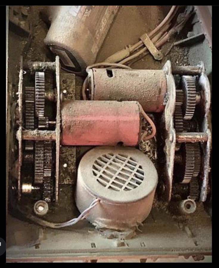

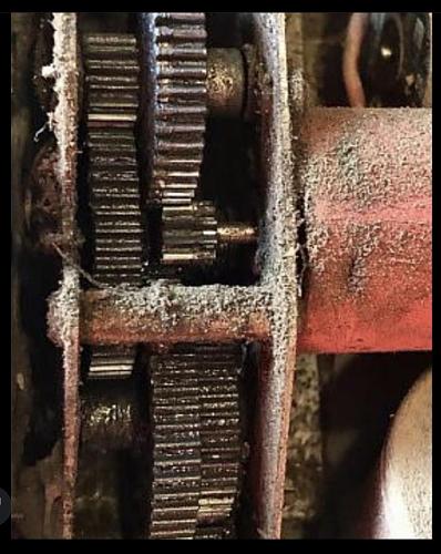

            I would respectfully disagree with your assessment of open gearboxes and have photo proof below proving so. The HL basic “open” “steel” gearboxes or other such as the Taigen blk, HL red and most of the several different types of Tamiya gearboxes are rather forgiving of dust and dirt and will run extremely well even with a light oiling.
            Picture below are typical representations of all my gearboxes and also many of those with whom I run tanks with. The below gearboxes have been in service for more then two years without clearing or re-greasing. Like all my tanks they are run in rather dusty desert like settings of the SouthWest US. In more then a decade I have never had even one of my many open “steel” gearboxes have issues caused by dust and dirt like that shown below.
            Sealed gearboxes might keep your “engine bay” looking nice and quite the gear noise a tad, but they really do little more then that. HL only started adding the plastic covers to their gearboxes to reduce the noise of the newer “silver” steel gears (a major complaint early on) being used and NOT to protect them from dirt. I know because I was involved in the process and was the one that brought the noise issue of the new “silver” gears to their attention.
            Click image for larger version  Name:	5D166817-C786-43B9-8258-E811D3E266C3.jpg Views:	0 Size:	92.0 KB ID:	365039Click image for larger version  Name:	E06F571E-0046-4197-BE18-500E9373BCB2.jpg Views:	0 Size:	88.0 KB ID:	365040

              Rubicon9-9, I agree with your assessment that HL and other open frame gearbox are fairly tolerant of dry dust as long as you do not mix it with oil. I run my tank mostly in the backyard. It pulls grass and other debris into the chassis very easily. That's one reason that I also prefer sealed ball bearing over sleeve bearing. I do not see that we have any disagreement.
